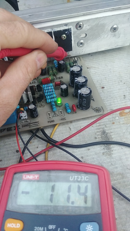

my a40
hello this is my a40 configure the bias in 35mv and adjust in 10mv. with a transformer of - + 45v without load and with low load at 35v- +
Thank you

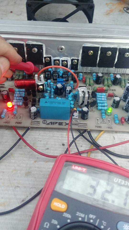

my a40
Thank you
a40
for the bias in the 2sc it is - + 30mv with a cc 10mv, however in the 2sa1943 it does not exceed the average 10mv I was testing it and it sounded good but there came a time when the heat sink was overheating too much
What is the problem that I cannot regulate even both power transistors. any recommendation thank you very much
sorry for my english just google translator

bias misaligned in negative stages with respect to the positive
please help

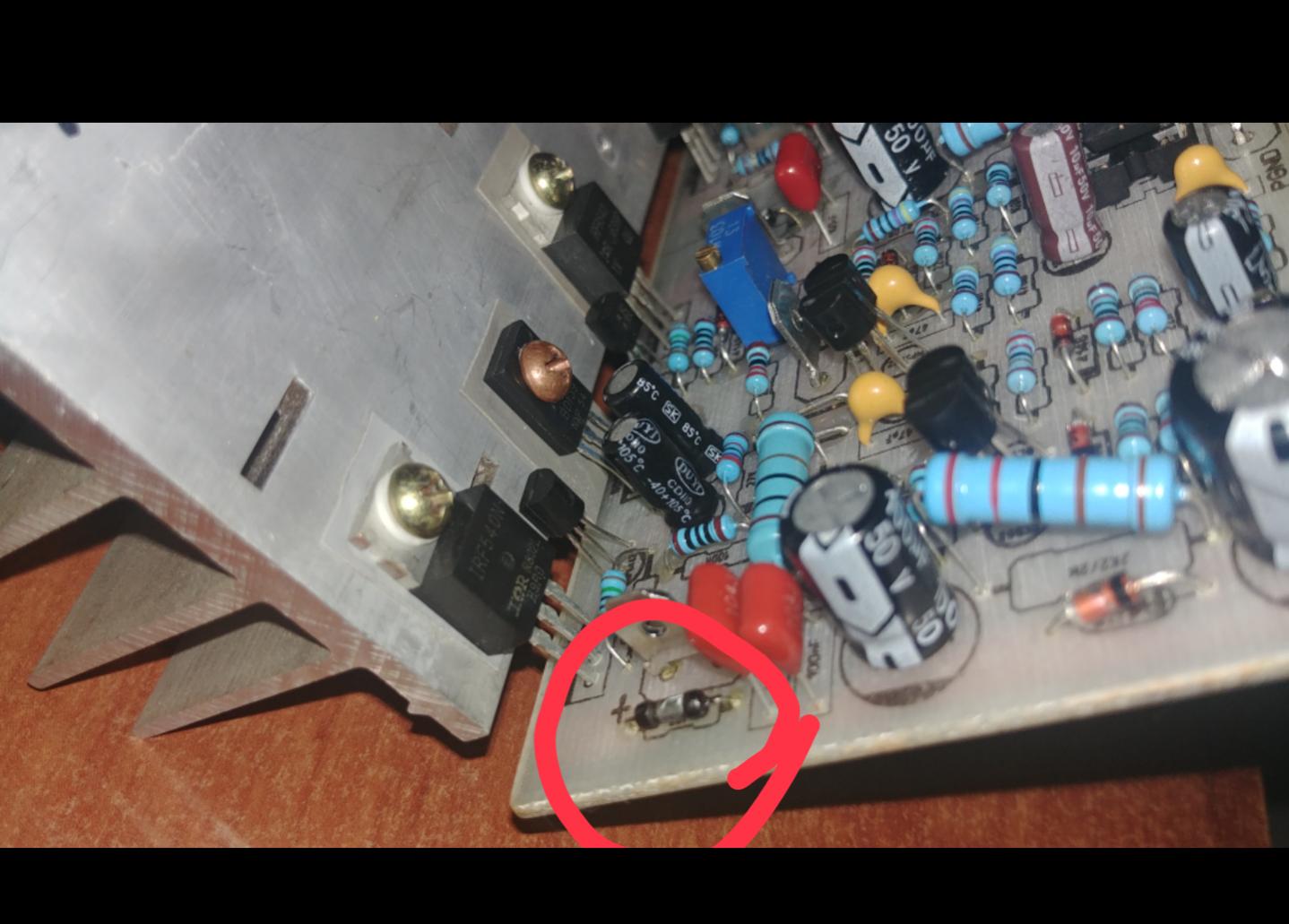

can i use in apex ax17 instead of 2sc/2sa ,tip41c/tip42c?
