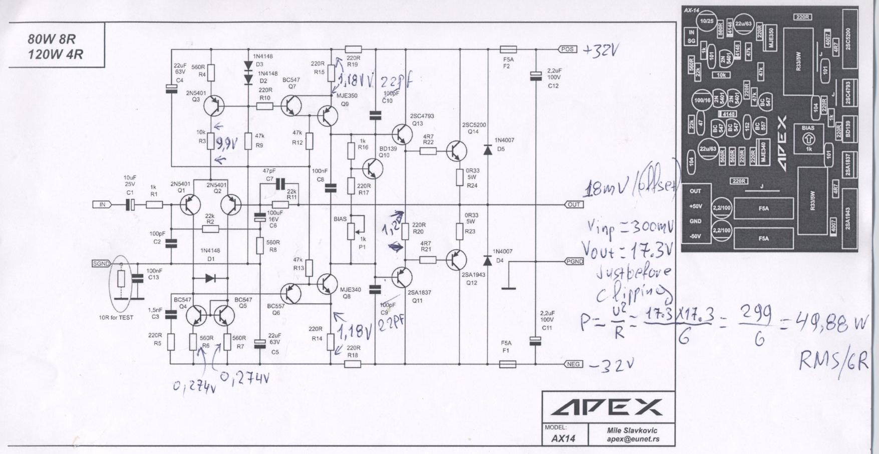

hi.
i check voltages from 5200 to c4793, mje350, bc547
and from 1943 to a1837, mje340, bc557
bc547 Vbe: 32V
bc557 Vbe: 557mV !!!!??????
i think bc557 gone i am not sure but i cannot test it cause i dont have that transistor right now.
can i use 2n551 and 5401 For bc547 and bc557 ?
Use bc547 and bc567
Seems to me, that bc557 Vbe 557 mV is correct.
32V on the 547 indicate either reverse voltage or the transistor is blown. There can´t be 32V on a be.
3 times check all transistors it dont show short on them. i will change 547 first and test it again
ty soo much.
Use bc547 and bc567
ty i will check stock again but i dont think i have them too. the problem is wekend and if i order too it dont come untill monday. so i was thinking to use 5551 and 5401 for that.
ty soo much.
It´s not a short. It´s open circuit 🙂

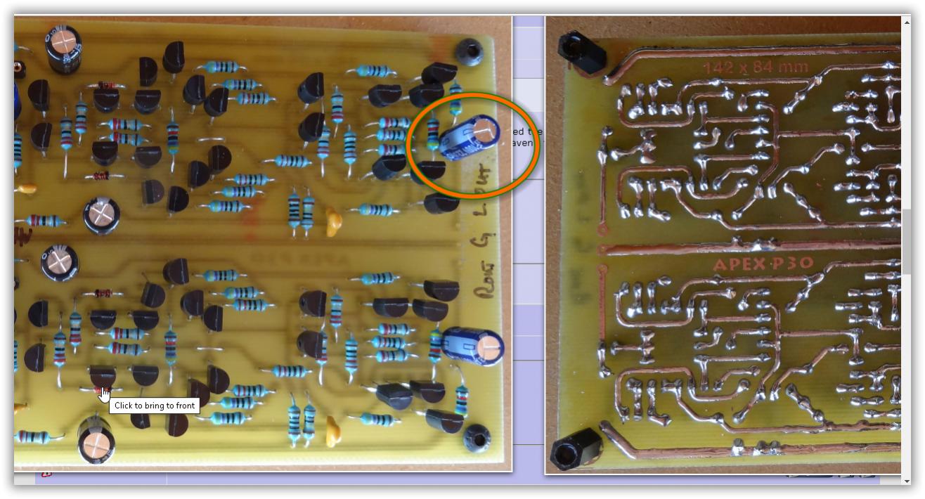

Well, this morning while I was waiting for answers I went ahead and etched the dobrivoje layout. I wanted to try it with different transistors and I had a pile of BC456C/556C transistors so I populated this one with those. I haven't tested yet but here are some pics.
Blessings, Terry
hello, does it have something or affects the polarity of the capacitors at the input and output
That was from post #4626 BTW.
I don't understand your question. Can you word it a different way?
excuse me sir this polarity is correct
Per schematic those are reversed. That is how the layout shows them and they seem to work fine like that. It is an AC output so I'm not sure how that is affected. Maybe someone more knowledgeable than me can answer that.

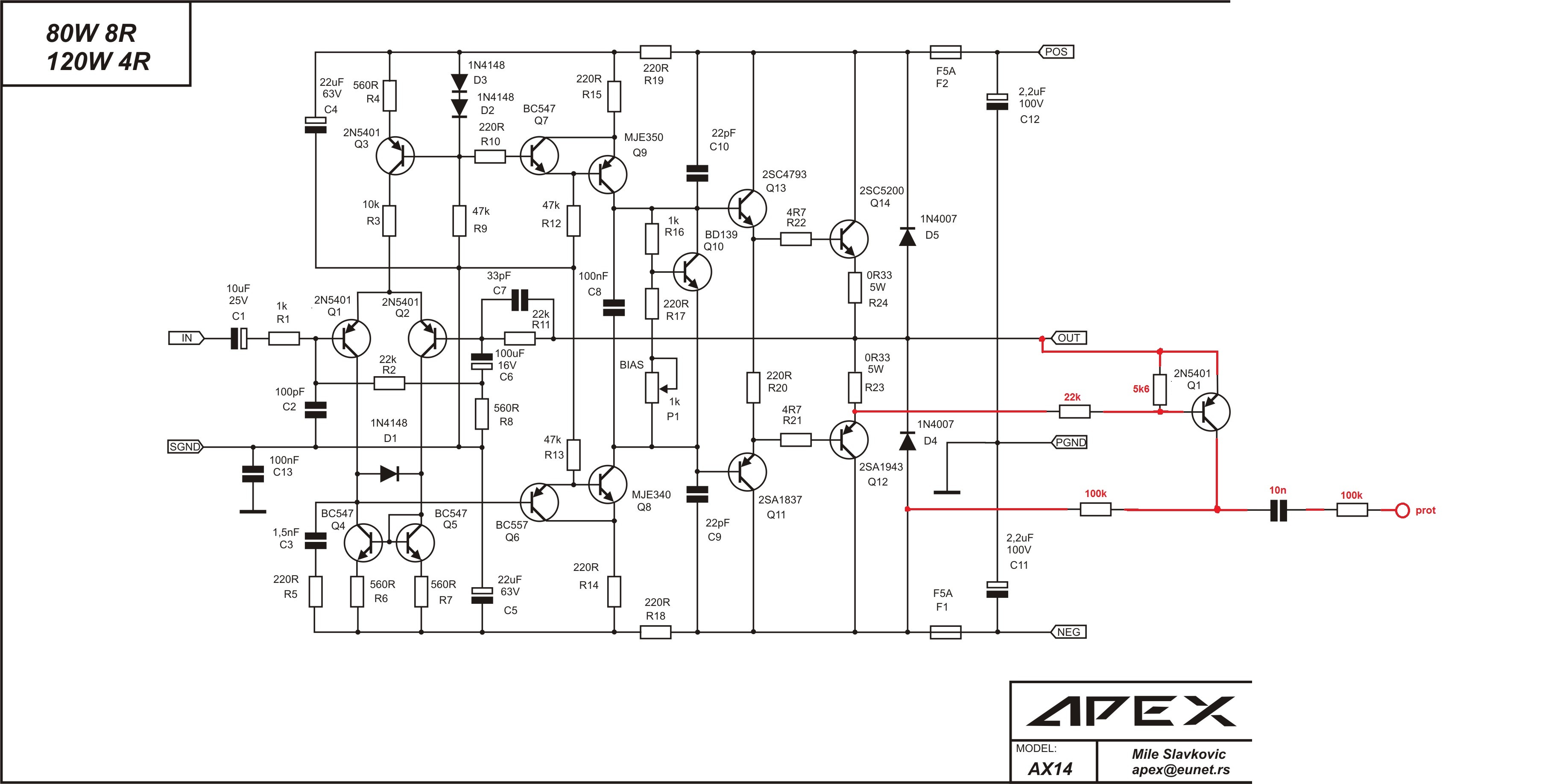

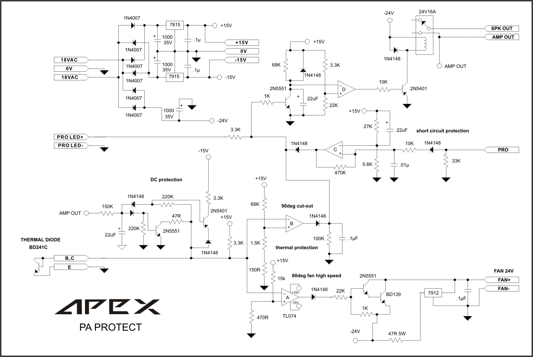

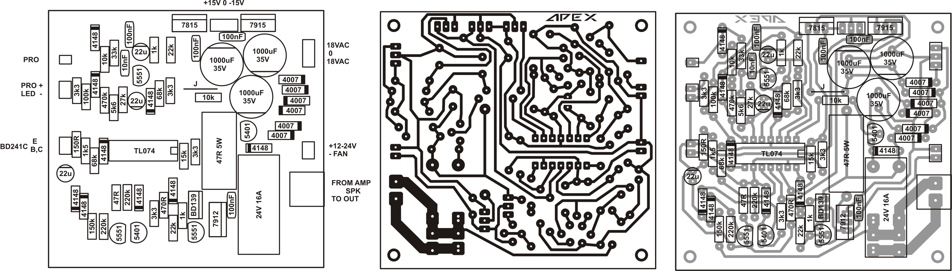

This is protect from my PA amps, can be used for Hi-Fi amps also.
hi i want to use this protect on ax14. but ax14 dont have protection out.
so i try to take it from b500 schematic but i am not good on it and need to some one check it please
the resistor values and capasitor is right? and if i make mistake pls tell me where. thank you
