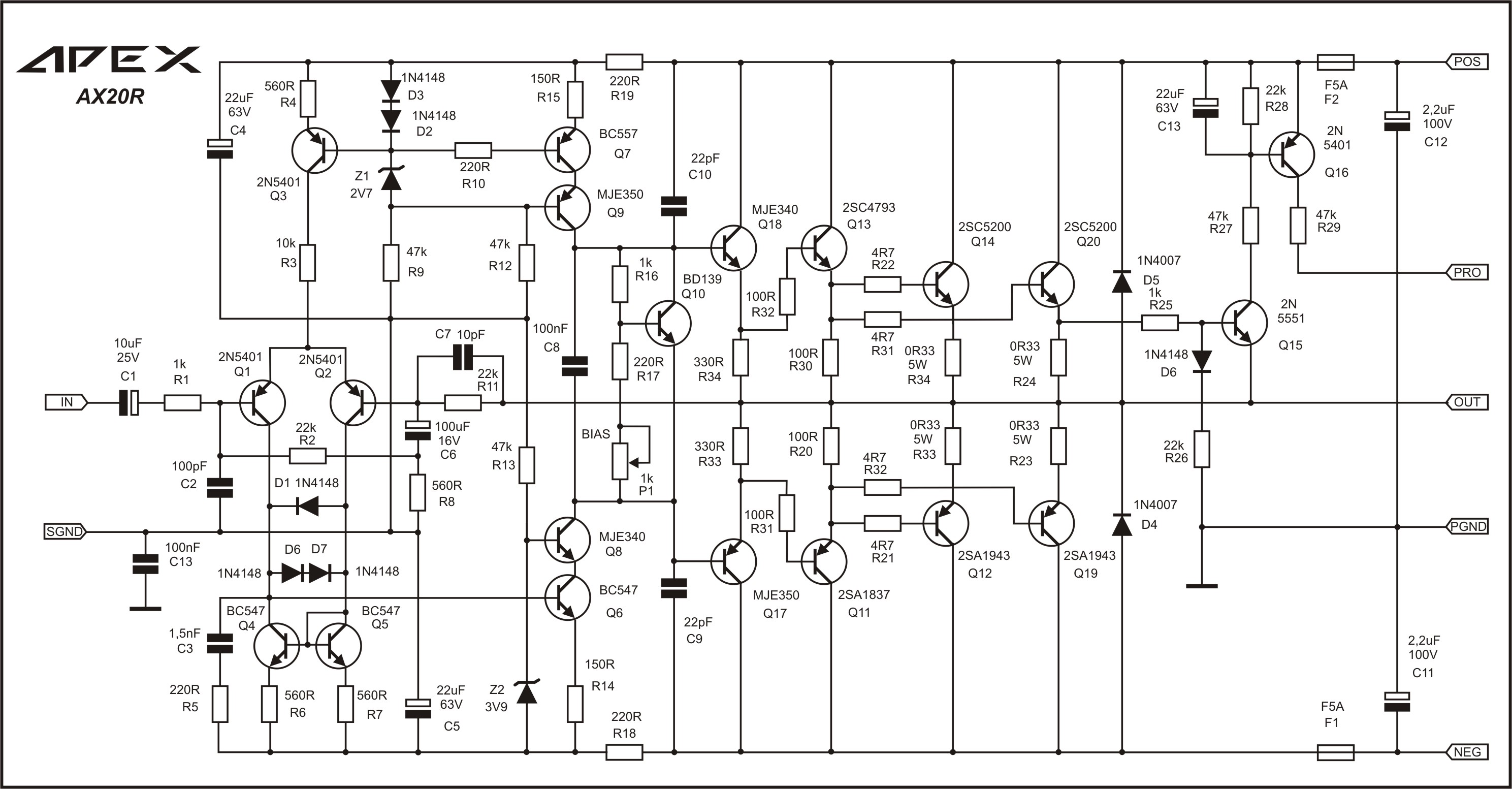

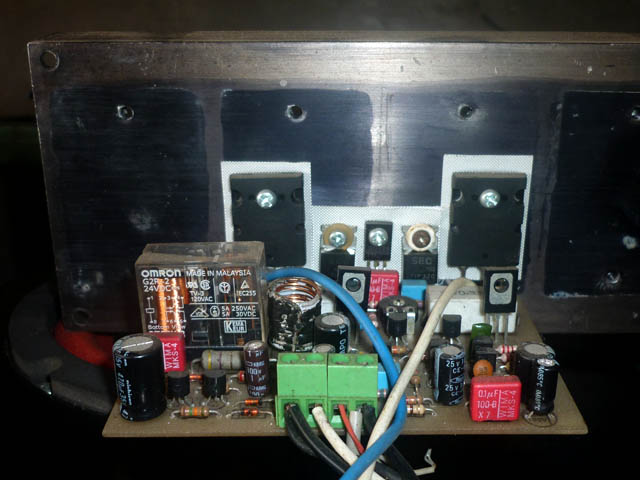

I collected and listened to the so-called APEX AX-20,
about which I want to share here. In fact, this is a classic amplifier
with all the improvements from Douglas Self’s textbook (and recommendations from local colleagues).
Compared to Apex AX-14, this amplifier sounds much more adult:
More dynamic sound, excellent control of 4 pieces 8 "bass. Bass is excellent.
Clear low. In the 14th, in comparison, a little tightened, just a little because of what
it seems that it’s even a little more.

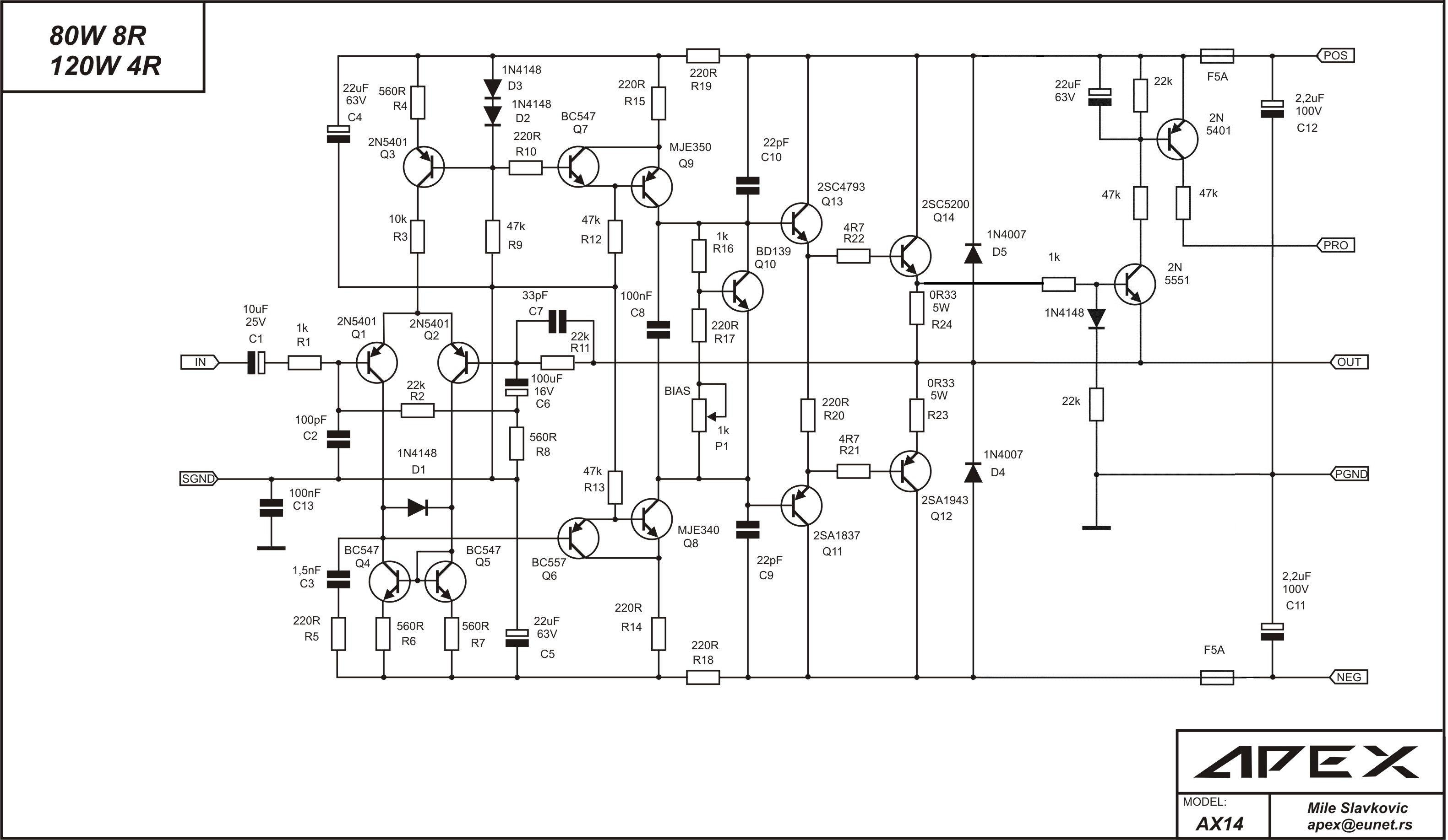

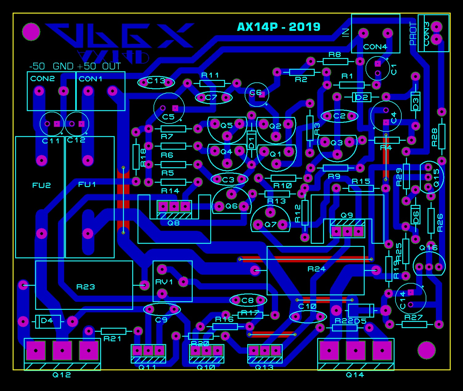

hi i want to use this protect on ax14. but ax14 dont have protection out.
so i try to take it from b500 schematic but i am not good on it and need to some one check it please
the resistor values and capasitor is right? and if i make mistake pls tell me where. thank you

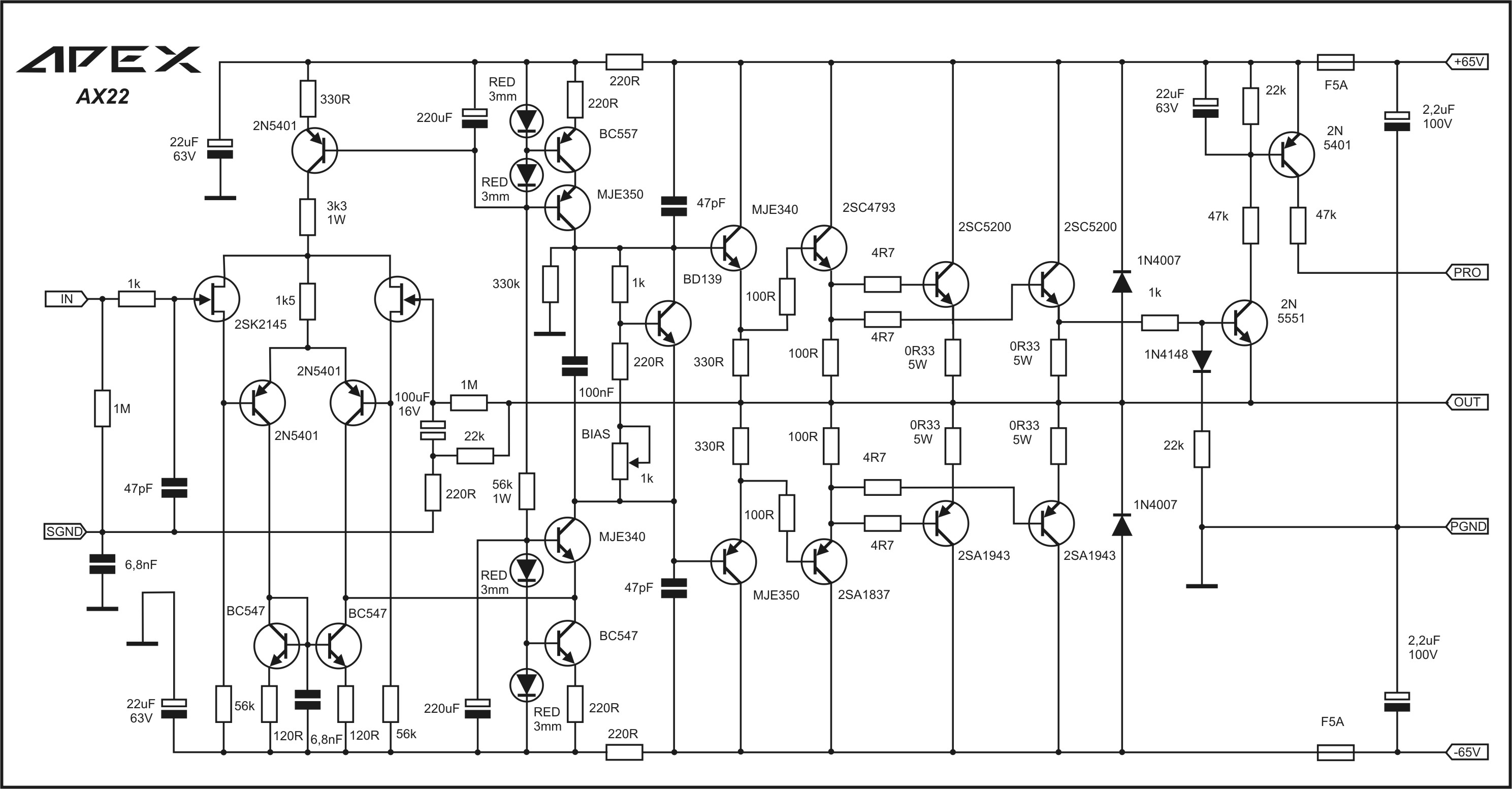

Use protection out from AX22 and use DC555S protect...
ty for answer mr mile. you mean like this?
but for protection i cannot use pa protec? i was like it for 15v for xlr circuit and thermal protection too. and i want to use regulated amp psu one of yours is that all can be use together? sory for many questions and for my bad english. thank you
ah i forget my transformer giving me 2x50vdc and 2x20vdc. i rewind secondary. thank you again for all your help.

Re drawing pcb for protec. tomorrow i can finish and start pcb ty mr. mile

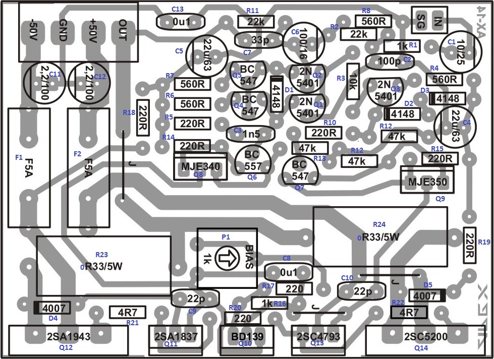

i start for ax14 man ty just there is that cap is different on pcb and on schematic. i dont know which one is right. i made before this ax14 its not work i throw away cause thin lines and repair make them trash. so i making again now but i will draw new pcb with protection.
so i need to know which polarity is right. on schematic or on pcb.
On your sch, it's connected the correct way.
Edit: mistake in typing

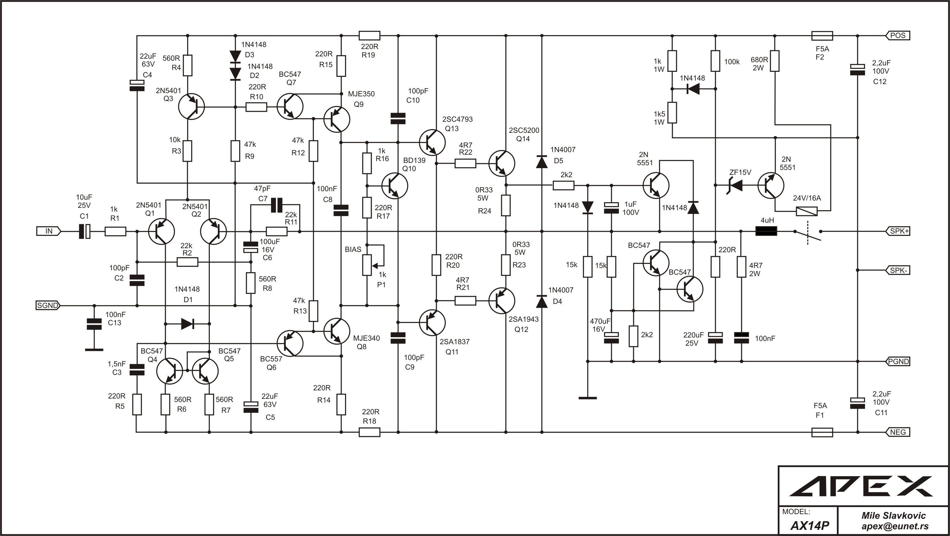

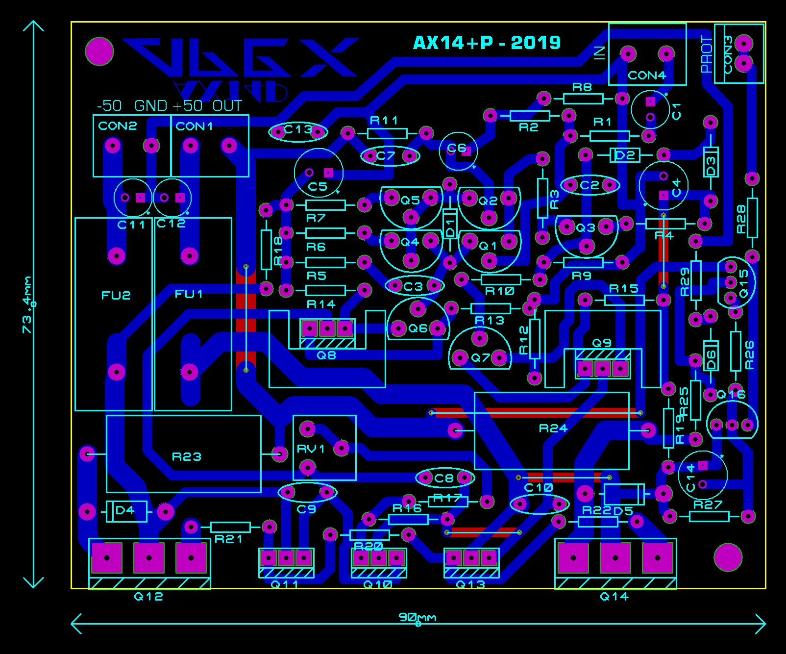

i finish redrawing. pls have a look. i take out line under the R24 for protec. this can make a problem on it voice? or any desing faults if you see pls write here so i can learn more. thank you for all helps.
i will make it next week so i am just waiting for your answers...

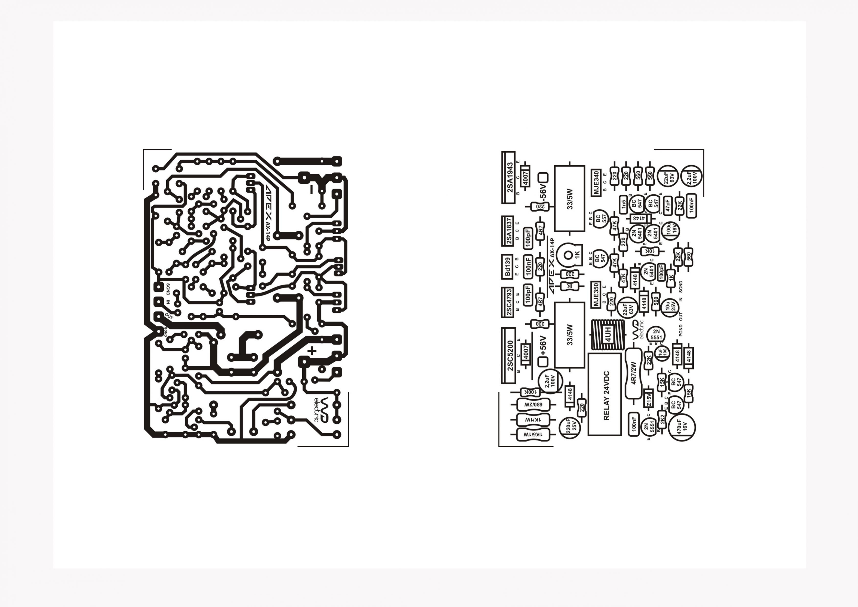

hi mr mile pls can you just look a little to that pcb i trying to make, maybe you can see some mistakes. thank you .
and you said different voltages abouth it.
some where you write "Circuit was tested on +/-90V rail voltage,
but with single pair 2SC5200/2SA1943 +/-56V is maximum."
and another page you write "I suggest rail voltage +/-45V for single pair".
i need rewind transformer cause i read wrong too and make it 50-0-50vac before. now i opening again going to make it 40-0-40Vac. is this too much for ax14?

I think that is too much for a single pair. You can get by with that for 8ohm only but you will need good heatsinking. I doubt you would notice any benefit from the higher voltage.
ty for answer my friend. i just trying make what is suggested. some times i misunderstand cause of my bad english and making mistakes.
what you suggest for transformer for single pair.
You should have 33-0-33 VAC on your transformer.
