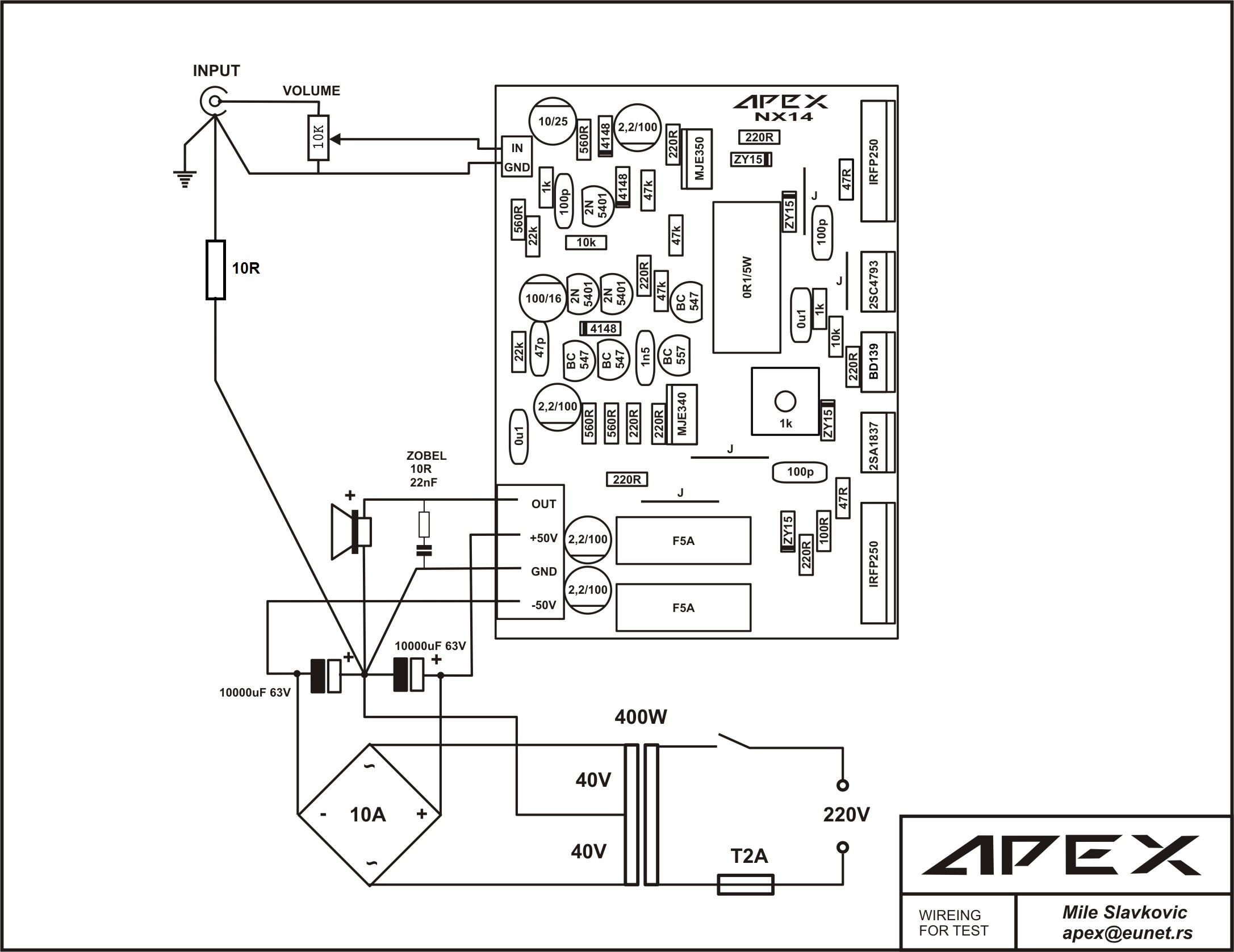

100W Ultimate Fidelity Amplifier
still no audio coming out just strong hum.
bias 0,6mV
out Vdc -9,2mV (when in and sgnd short)
out Vdc 7,6mV to 11mV changing (when in and sgnd separate and in is not connected any where)
45-0-45 Vdc rail voltage.
nothing change when i remove the 10R from sgnd to gnd.
i will come back with more mesurements. if any compenent need to be known mesurement please let me know for losing time for mesure other components.

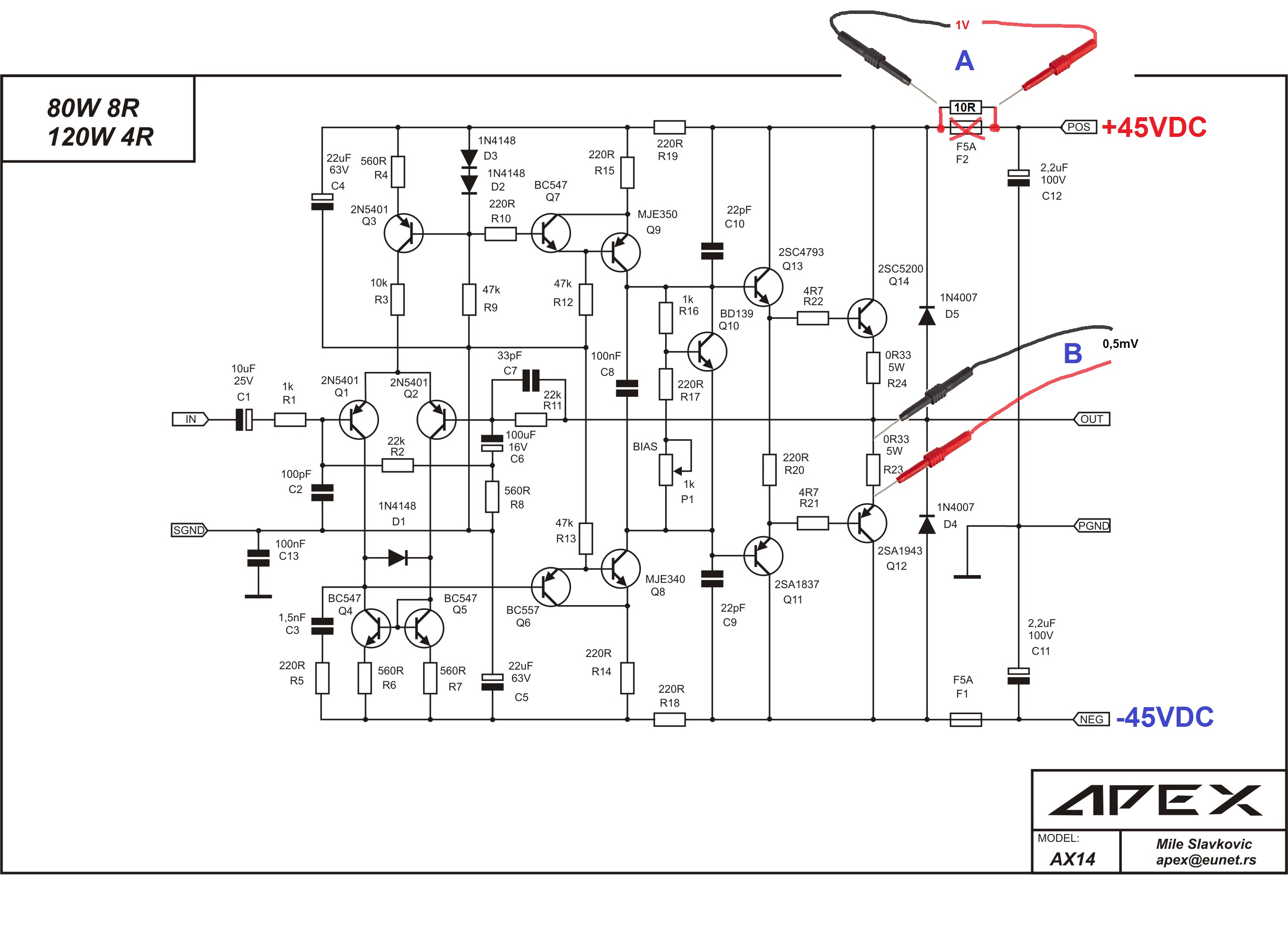

Bias too low ? 0.6mv=1.8ma
Look at these.
ty for answer, this cn be happen cause of the wrong bias setting?
thank you, i think i read set that 0.33ohm 5w resistors 0,5mv. i am going to check again but now i see apexaudio write in here somewhere take out fuses and put 10R and set 1V on them. i just see his this write.
i am confused and trying to learn. BIAS not setting on 5w resistors which ones connected on the emiter of the power transistors?
which one is right A or B ?
It's the samething, measure over 10e gives you a total current. Measure over 0.33e 5w gives you current through output TR. Most of the current flows through output TR anyway. For ax14 I set v over 0.33e 5w to be 30mv.
hi ty for your explane. before i read your write i change the bias on 5w resistor up to 2mv. now its working realy clear bass and mids but high freq. are i think broking. i will try now 30mv.
another thing is if i disconnec audio signal. then the problems coming out. big humm coming. i will try 30mv and come back thank you again
i left it open witouth signal it get warm..
i checkthi bias on 5w resistors its rising and when it warm now its 28,3mV

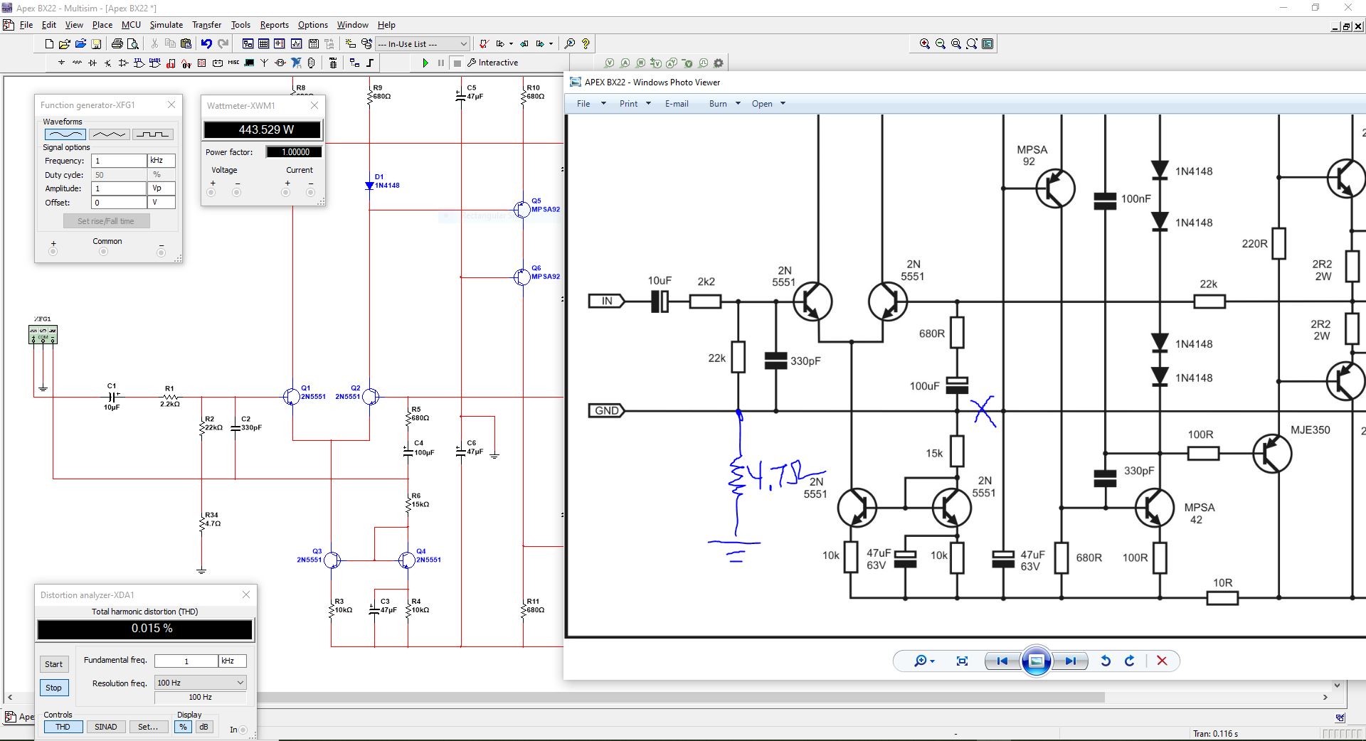

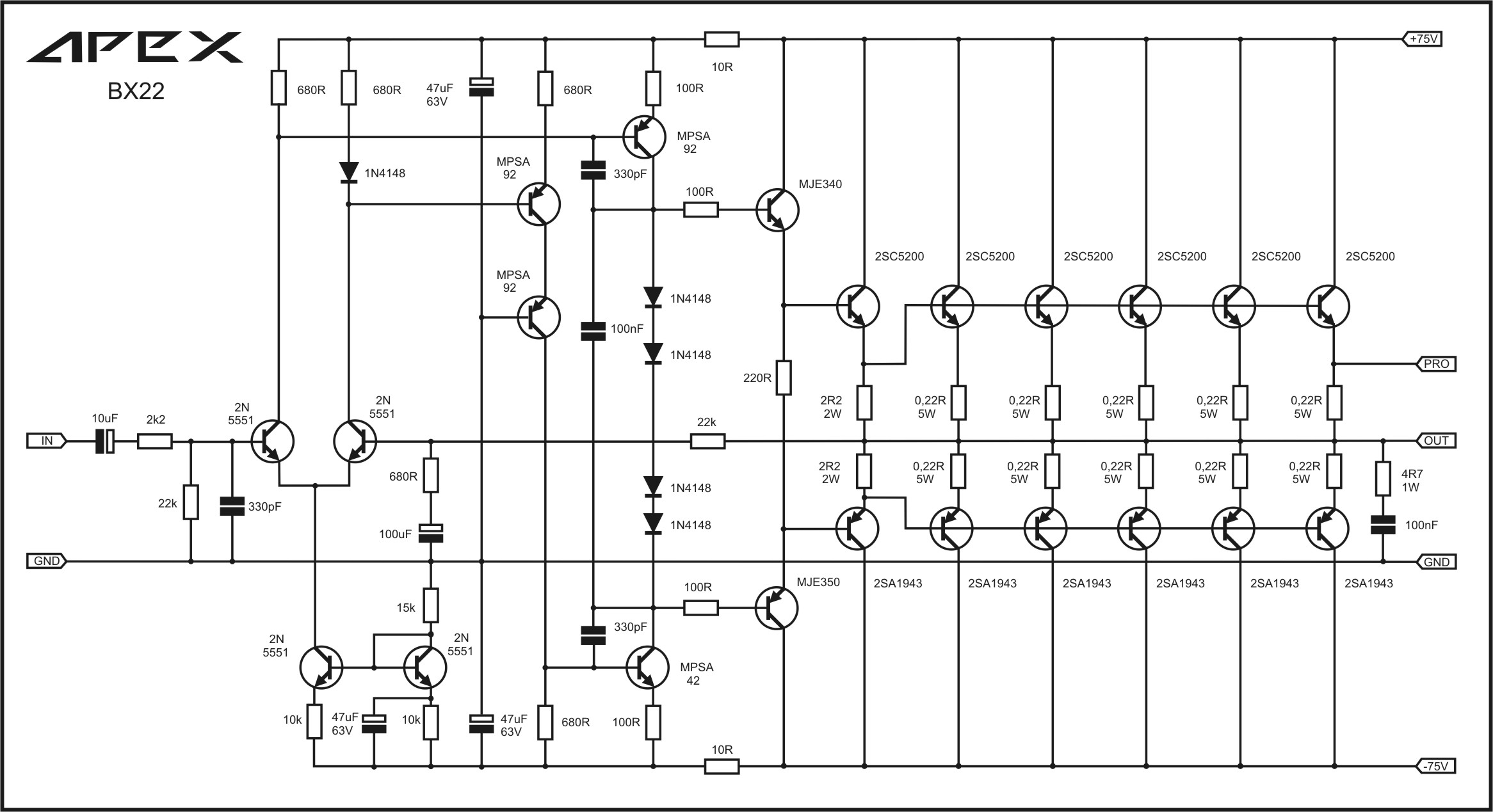

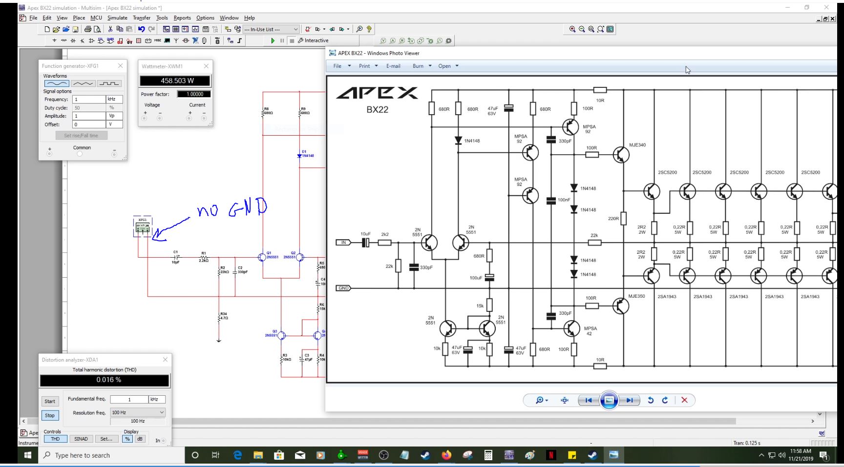

hello guys I made the simulation of the Apex BX22 and I notice something weird if I connect those components as GND I lost power but if I disconnect them it will amplified normally or maybe is my simulation that is wrong I'm confuse? I fallow the schematic as accurate as possible for testing I add that R34 4R7 only for testing is not part of the original schematic
