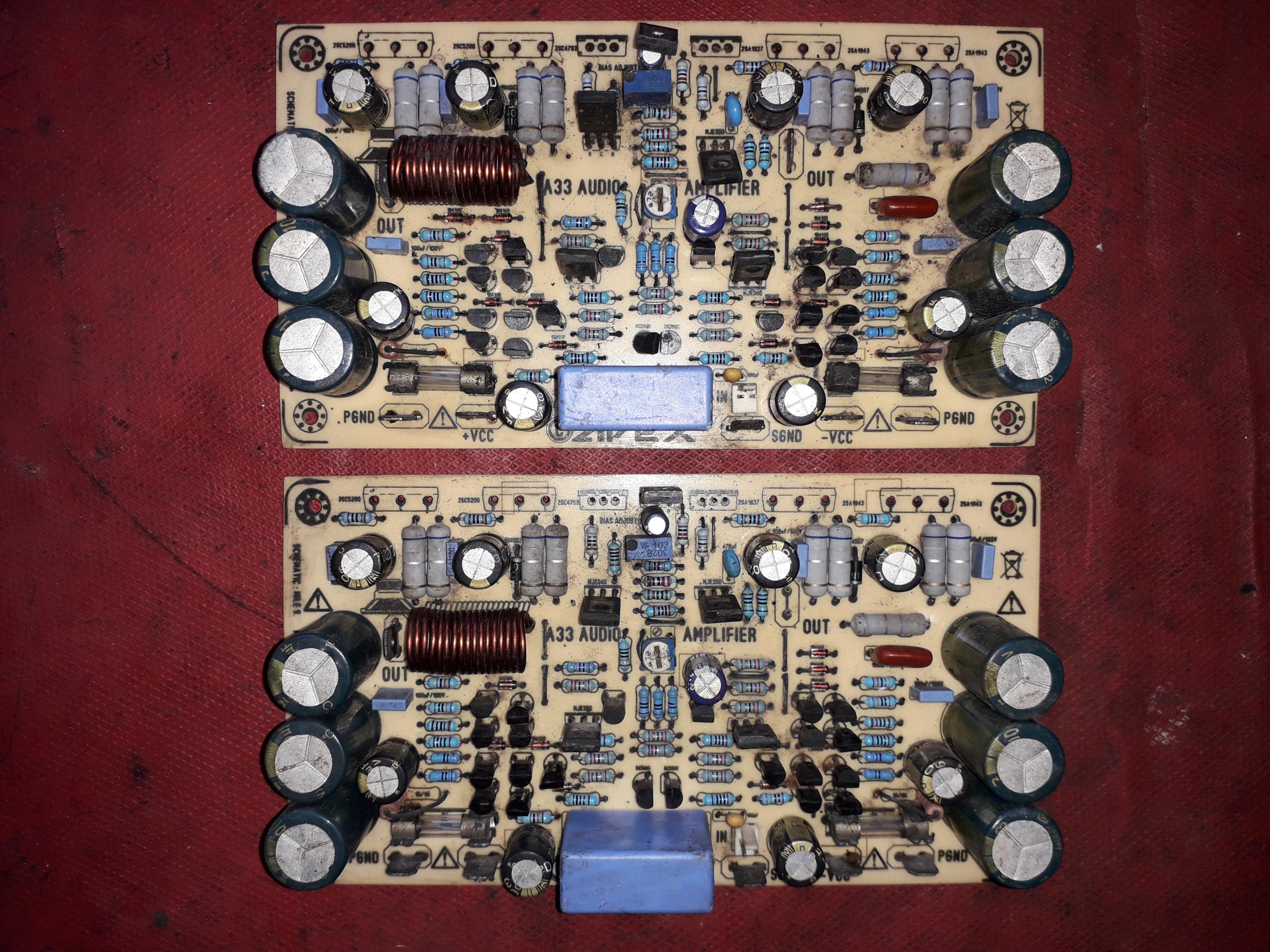

I'm back I see what I did wrong on the function generator I was connecting the GND so after I disconnected then is working normally see image is that correct? 😕

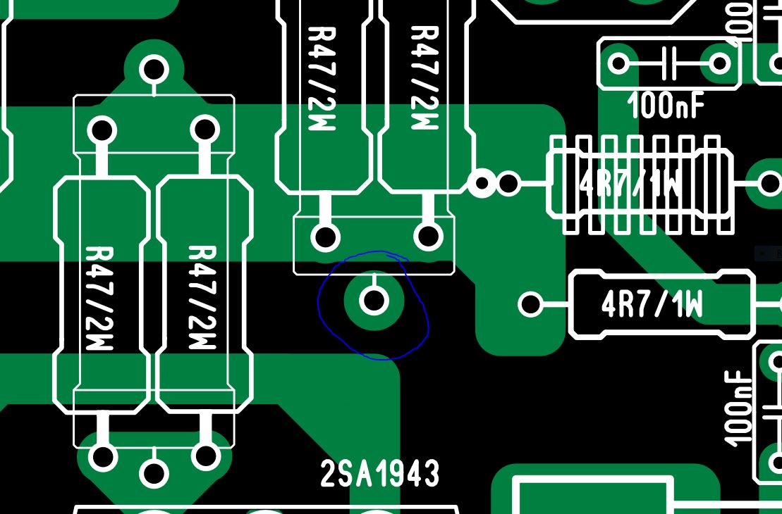

hey bro I was checking your layout and there is a missing connection see image 🙂
thanks eagle-eyed

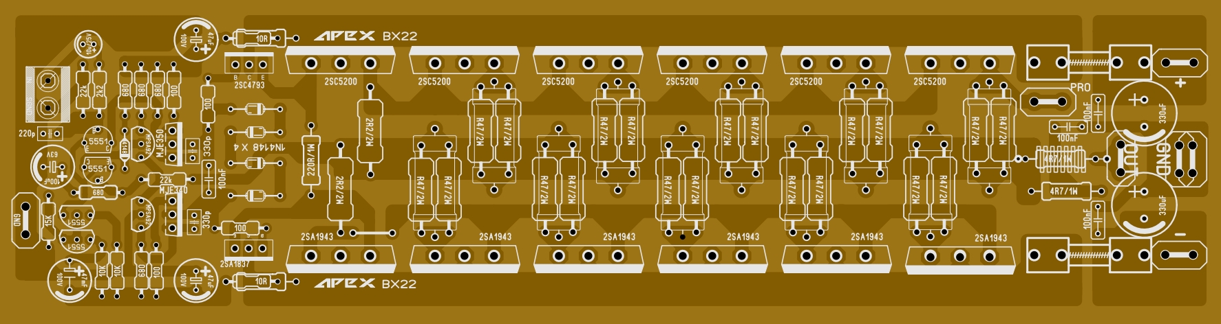

Im going to use 100 vdc + / - with 7 pairs of C5200 ang A1943 ...
thanks eagle-eyed
I think that each power out transistor must be have it's own base stopper resistor.
Better ask Mr. Mile.
agree they should have base stopper resistors 🙂

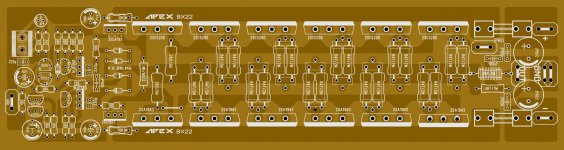

hi mr mile...i complet fh11 with3pair irf640/9640 and its very good...
now i want made apex ax17 and i have queschen....
can i use 3pair 2n3055/mj2955 with 50 volt suplly...?
can i replace 1837/4793 driver's with tip41c/tip42c or bdw93/bdw94 for more power when i use 2pair c5200/a1943 in out put?
what maximum suplly for apex ax17?
apexax17 is better or ax20?

i'm desingn ax17 with 2pair out put and 1pair...and this projrct give many time as me....i most finish this ax17 then i go for a23/a33/a40...ans sr200 with sanken..but step by step....my pcb for ax17 is very nice when i finished it send pic for you...
now can i replace 2sc4793/2sa1837 with tip41/tip42 ?

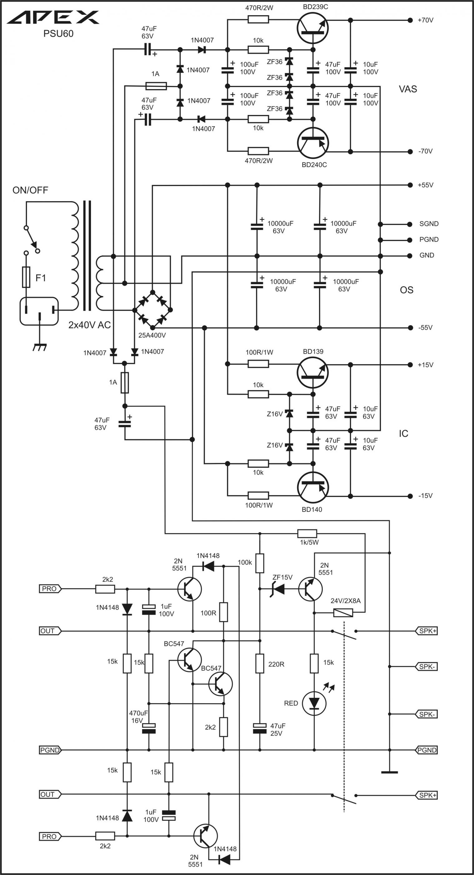

PSU and Stereo Protect for A14, A33, A40...
hi mr Mile
do you have PCB for PSU60?
