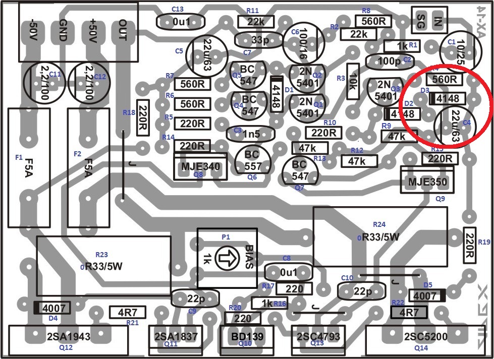

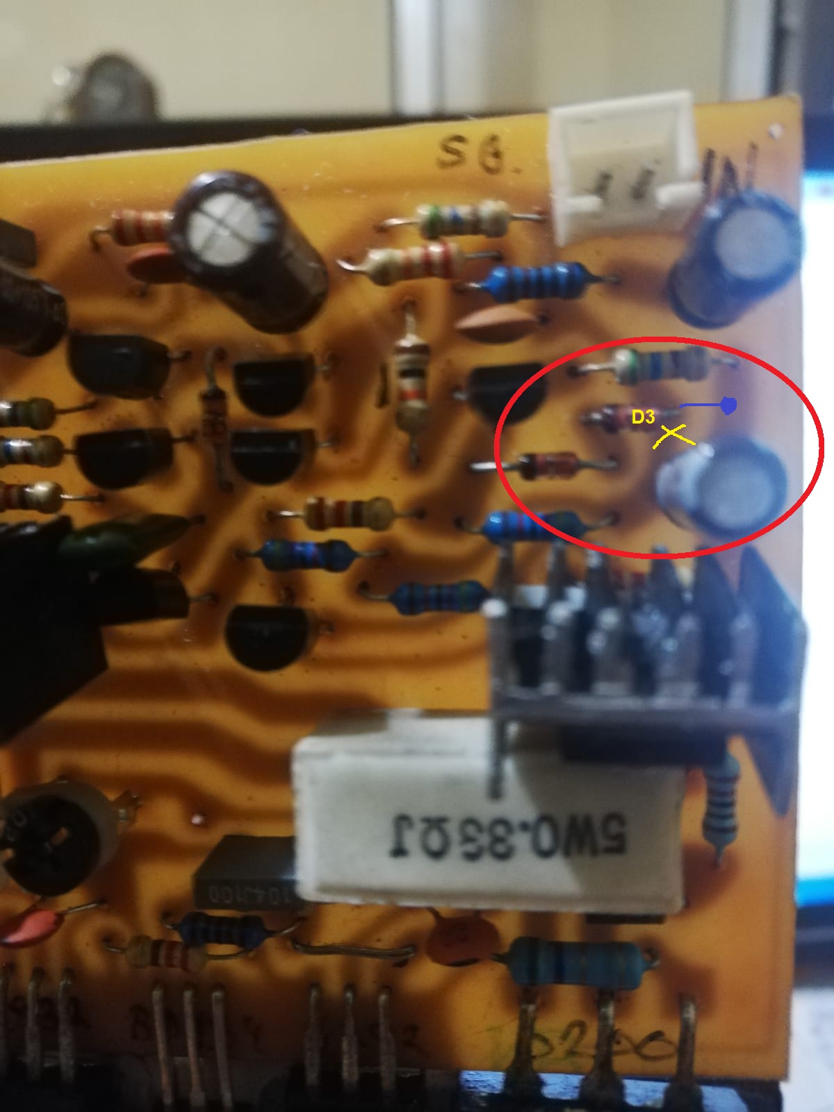

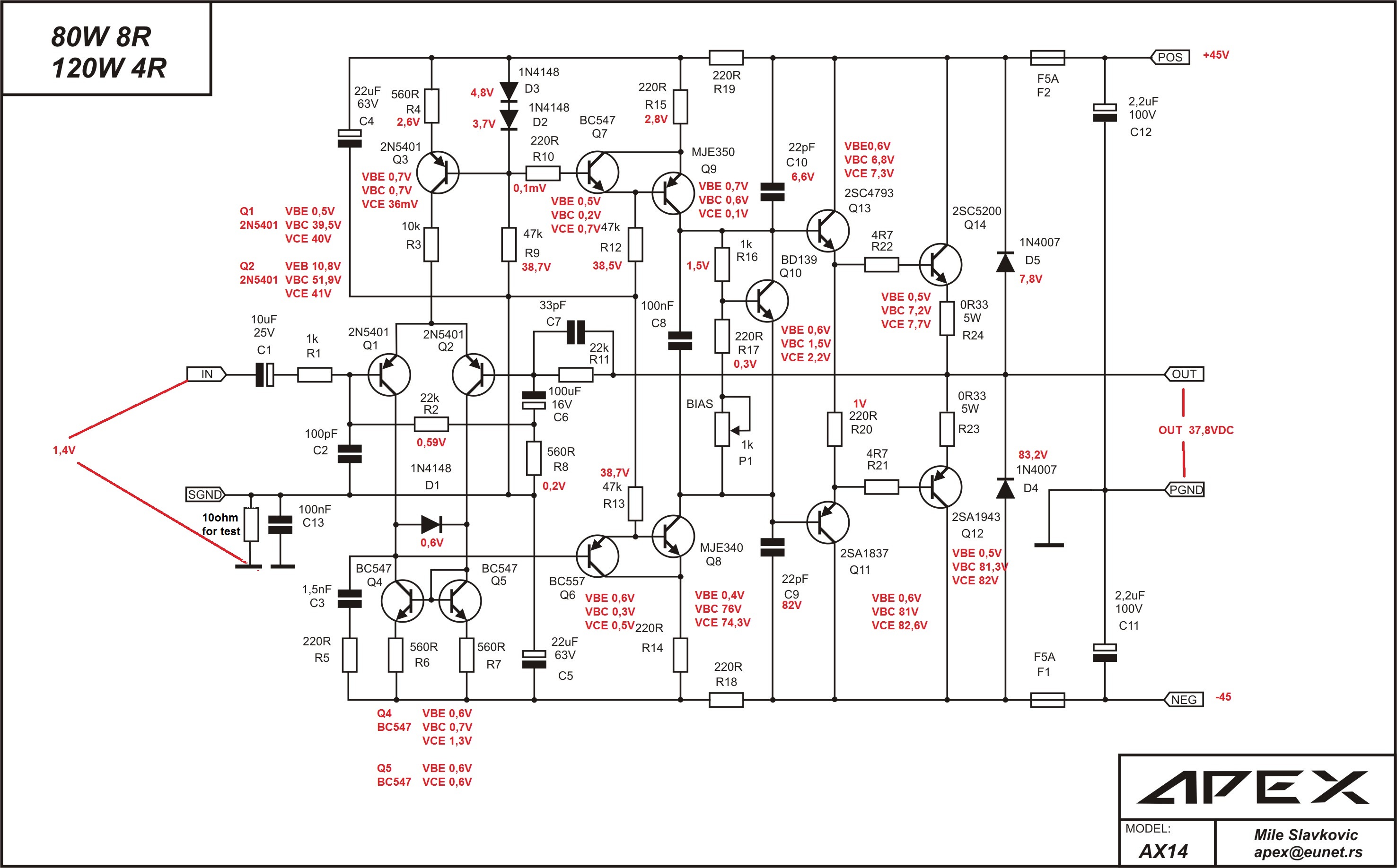

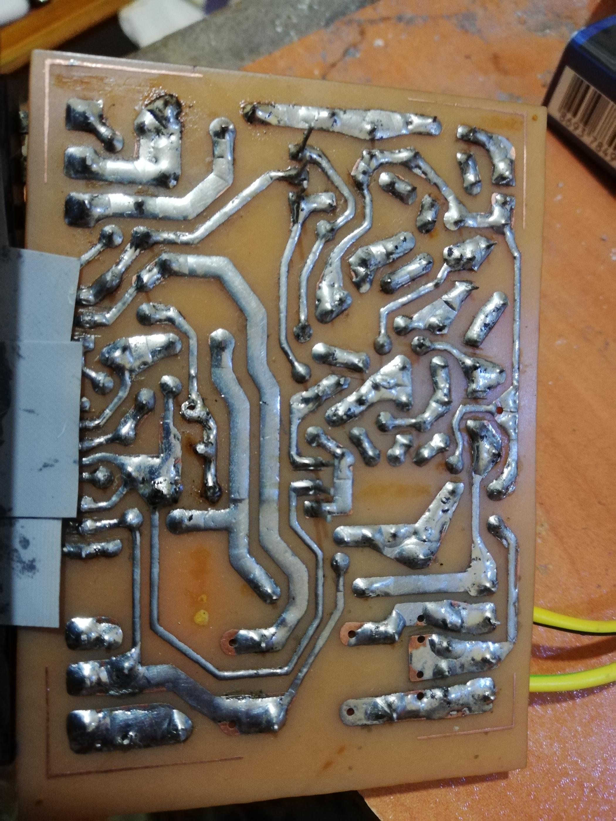

hi friends any idea why not working and getting dc at output?
Edit: İ take out cables for get clean pictures.

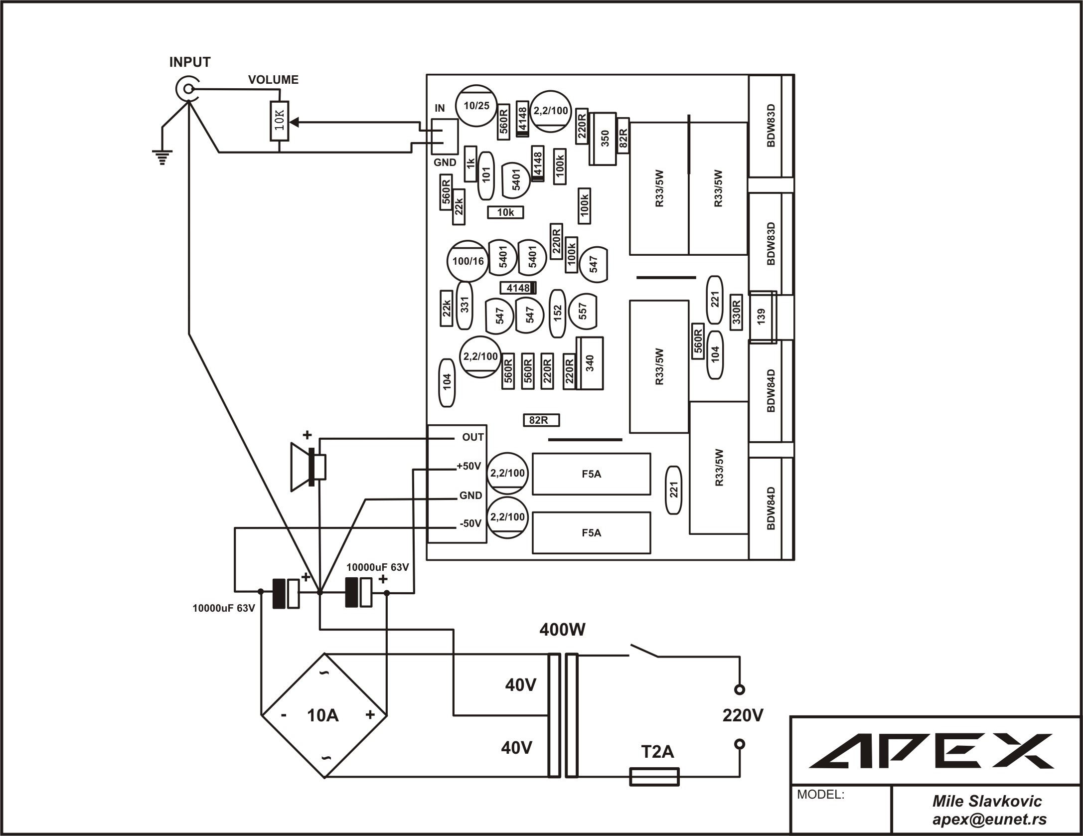

ty Prasi, i can rewind transformer its not problem for me. i did like that cause of kandimba said i should use 2x33vac.

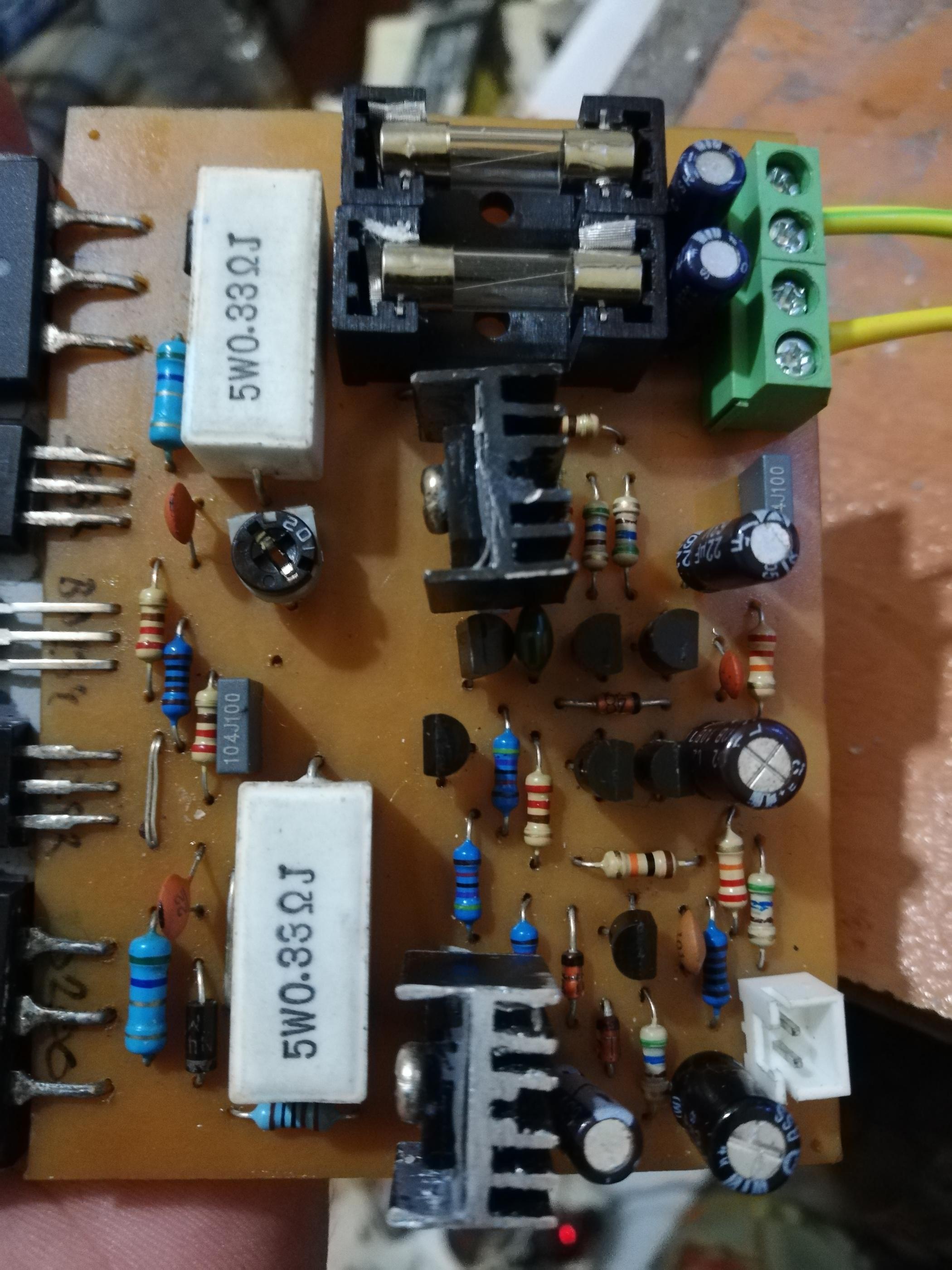

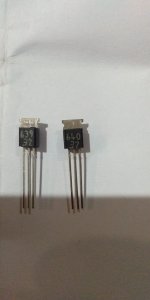

Initially check pcb print wire connection if all are correct then check mje350 and mje340 base and emitter because some transistor base emitter changed to each other
hi ty for answer me,
i check lines on pcb all is ok.
i check mje350 and mje340 they are ok and legs are ECB.
i take out and check Q1, Q2, Q3 2n5401 and Q7 bc547 they are ok
i juat didnt check Q3 Q4 and Q6
i will check resistor values again to day maybe i make mistakes abouth it but i dont think it can make this problem.
dont ask i dont know how to make that kind mistake.
i make the change now many things normal just no audio coming out 🙂)
sgnd connected on pgnd.
really strong humm coming out but no audio signal..

edit: psu that i test not on board i take ac turn to dc and give to capasitors 2x8500uf and get 2x45v. maybe that hum coming out from that? in cae i will use psu protec from apexaudio cause of chase really small and it will feed 2 ax16. this is what is my plan.

Q7 BC547 pins are reverted on your amp...
hi mr mile,
yes i was thinking maybe its bad so i replace it with 2n5551. i will change after get bc547. thank you for checking.

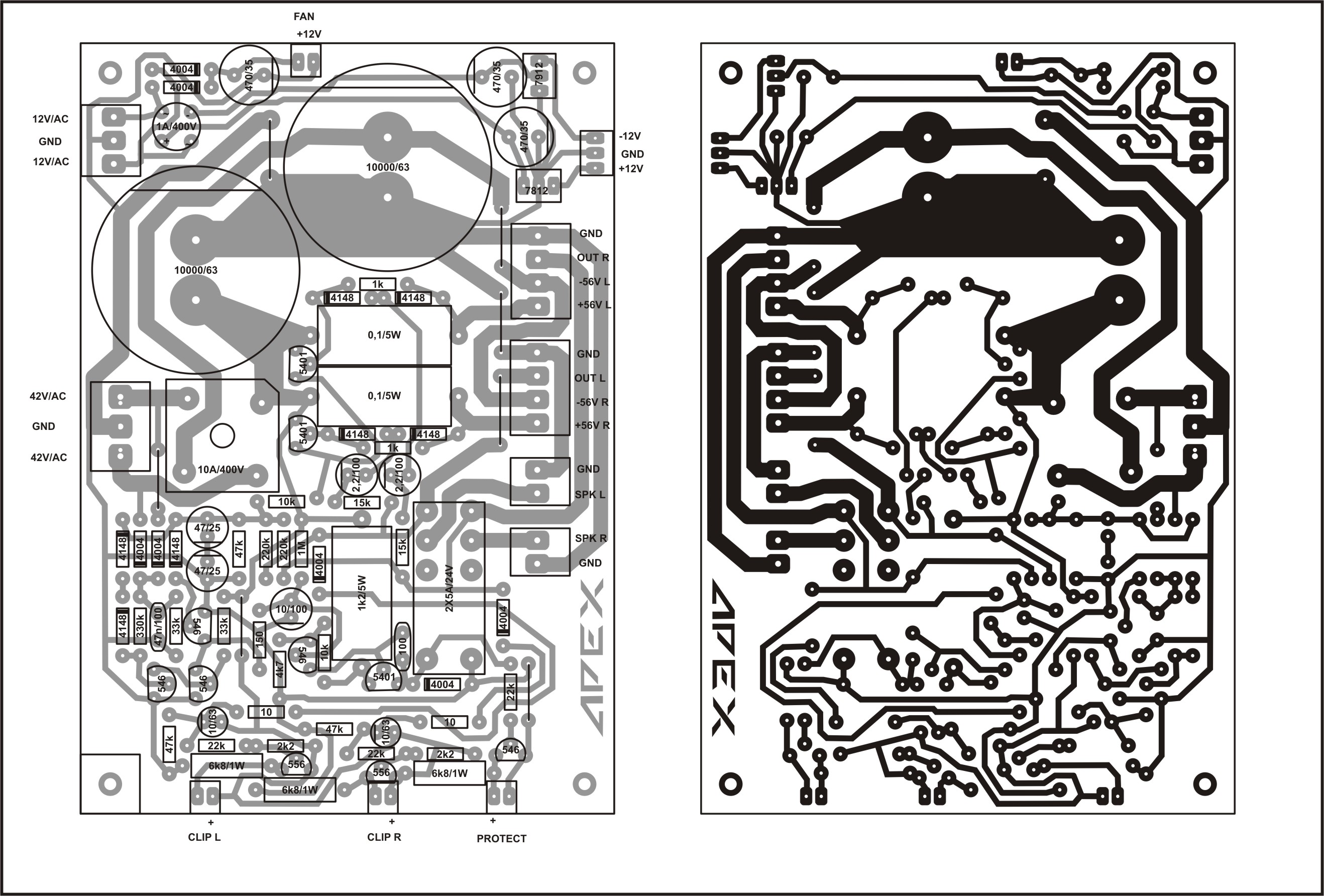

there is another question i was going to write you. psu with protect have dc protect too? if its like that i will change plan and make psu+protect and 2 pair ax14. this cause of my chase small.
