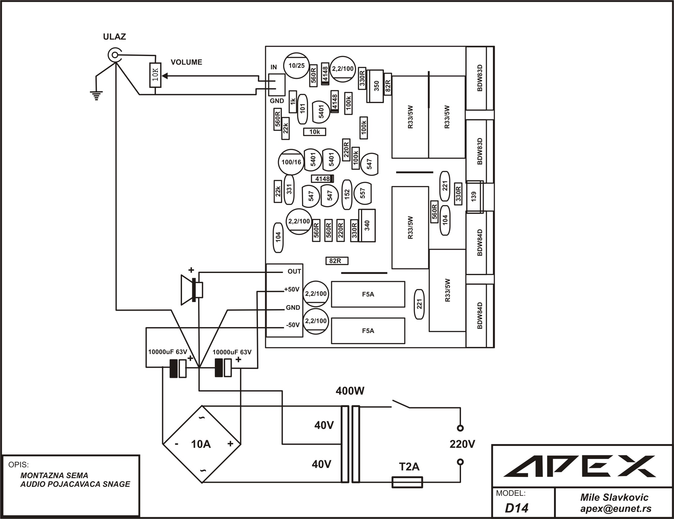

Run the wiring diagram exactly as you can see here.
Take care what Prasi say.

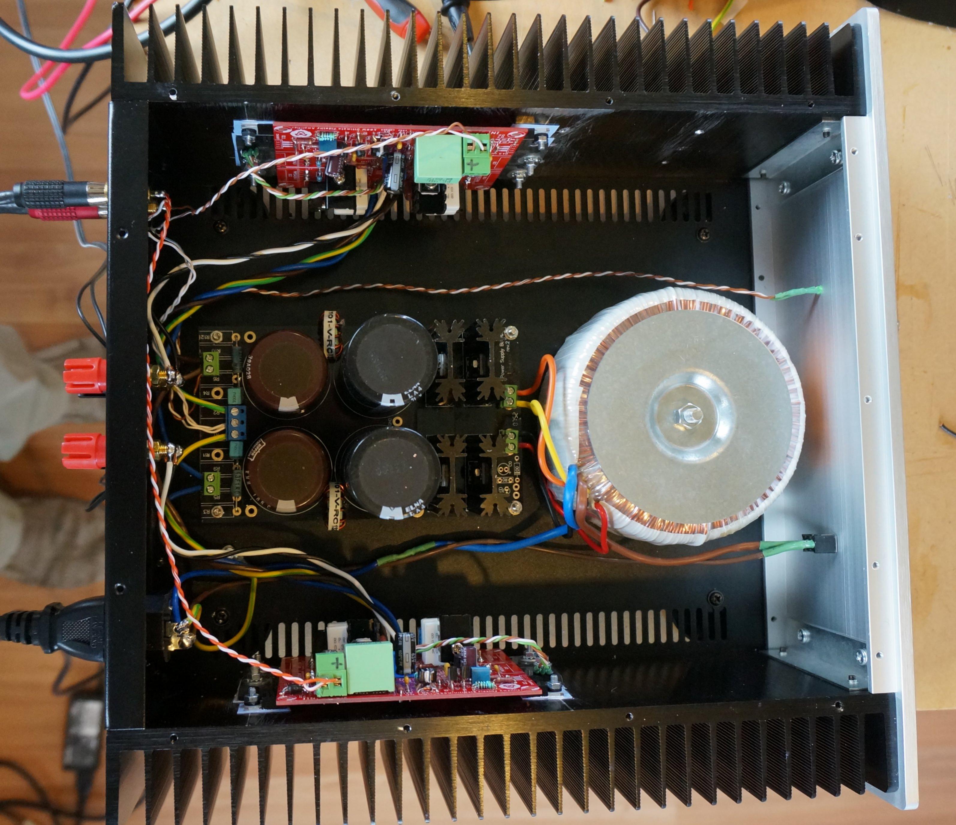

As you can see input wiring is well away from mains, trafo etc. Always use CAT5 twisted pair for input wiring, never been an issue.
Nice!Sorry, pics not loading, think they are too big.

Did you reareange the wiring as per photo?
I am leaving the earthing as it till I do some tests with different sources. My feeling is that the hum is more to do with the source given how quiet it was with the tablet as a source, possibly to do with the load on the input.

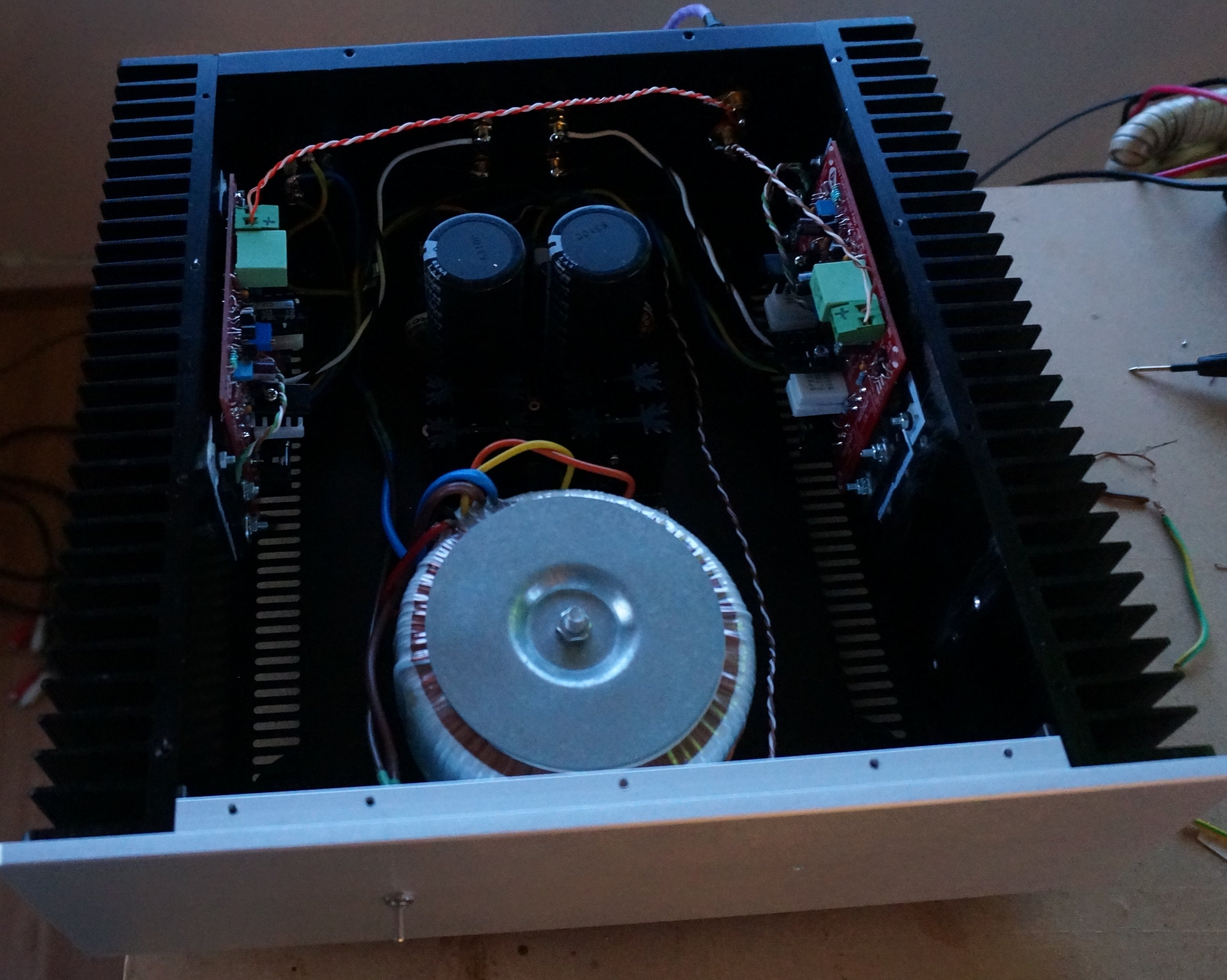

After running 4 hours in case I checked the temp of the heatsinks, they were considerably lower than before, probably because the fins are now upright and the rest of the case also sinking some heat. So checked voltage across the .33 resistors and found it had dropped 2-3mv. Tweaked it back up to 12mv each. Heatsinks still barely above ambient temp.
