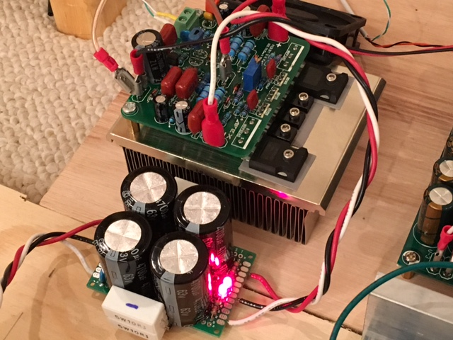

I switched back to BC546's after having some trouble getting the amp to work with the 2n5551's. The KSC3503 and KSA1381's are still there instead of the BD139/140's though. Bias current set at 175mA as measured through the pair of 0.47R source resistors. 52v rails provided by Abletec SMPS and CRC filter.
I mounted the FH9HV onto an old Pentium solid copper heatsink and connected a 100w dummy load comprised of four 8R 25w aluminum shell power resistors in series parallel. They measure 10ohms when hot though.
Amp connected to 52v SMPS and CRC PSU filter, small noiseless fan used to augment cooling:
Closeup of amp connected and playing music:
Stress test using 1kHz sine wave at max input before clipping gives 34.5v rms. For a 10R load that is about 120 watts. It was steady from 30Hz to 10kHz (tested at 20, 30, 100, 1000, 2000, 10kHz). At 20Hz it drooped to 34.1v, otherwise rock steady output rms voltage output vs frequency. The amp was able to sustain this level of output no problem. I ran the test for 15 minutes. The resistors were giving off a smell, and the heatsink was outgassing some of the leftover grease/cutting fluid used for the tapping operation. But heatsink could be touched for 10 seconds or so when fan is on.
How does it sound? Excellent - still one of the best sounding amps I have. With 52v rails, I have to say, the bass is very powerful and crisp. Clean, undistorted bass with a deep reach. Very nice. Mids and highs still clear and no sibillance or fatigue.
I think this HV version is a pretty compact 120w class amp. The Chinese hexFETs held their own - which leads me to believe they are real. No mini-die fake can hold up to that kind of test.
I highly recommend this build - easy amp to make and swapping out the drivers and using 63v rated electrolytic caps gives it some much needed power reserve.
I guess Jay was right - this amp and hexFET shouldn't have any problems running at these voltages.

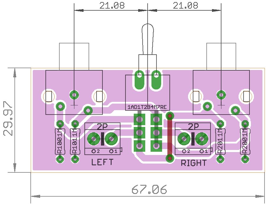

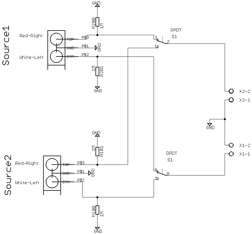

Can this be used as a passive source selector for preamps?
Based on B1 buffer schematics.

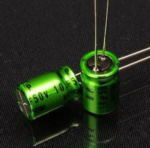

Started of with one channel, have doubt regarding the C1 - can I use 10uf 50v capacitor ?

yes, the muse non-polar caps are good and especially made for audio.

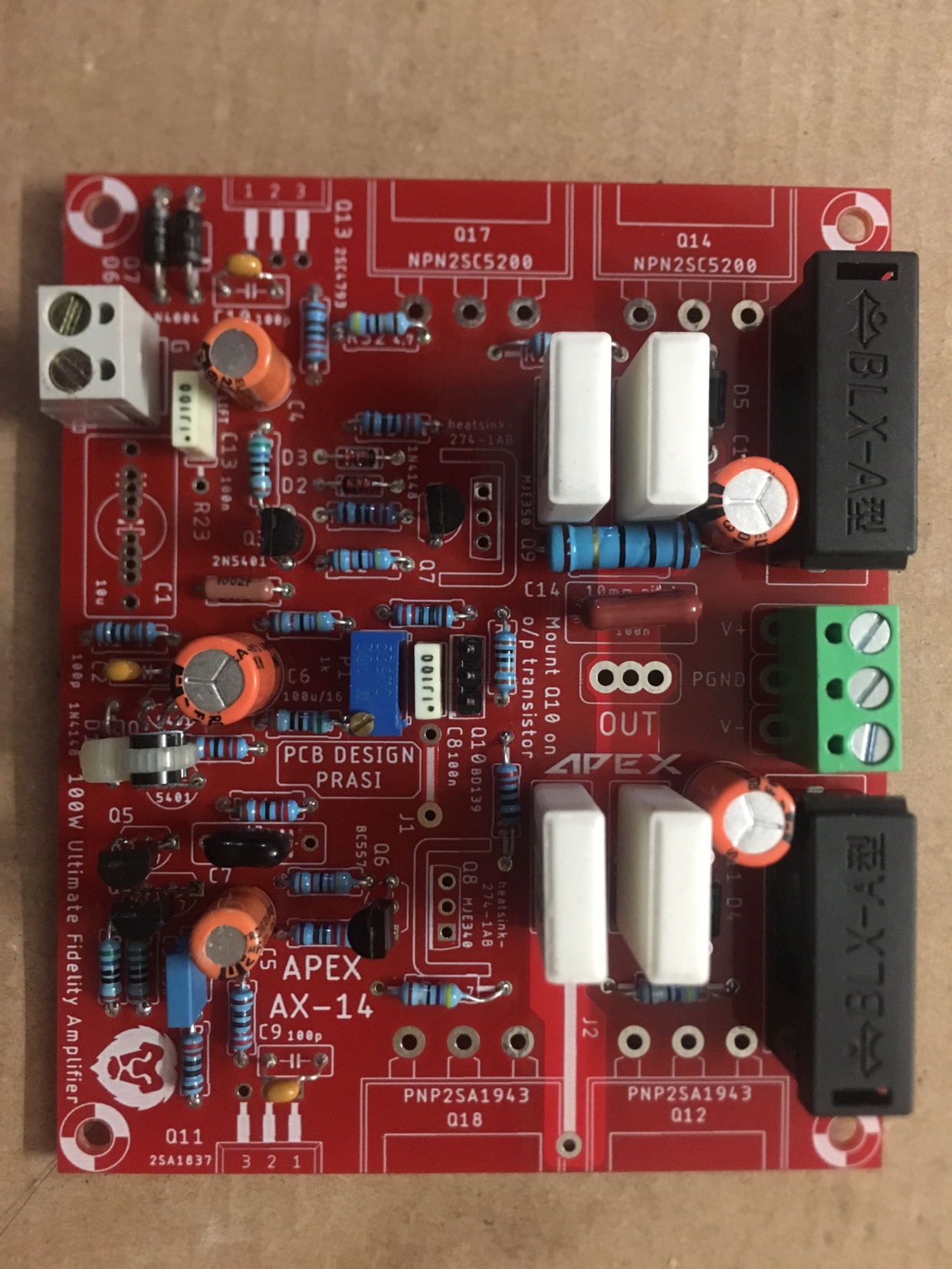

AX14 now complete and in a case. Makes music (just some cheap test speakers at the moment) but also rather a lot of hum.
I am using Prasi's board with D6/7, C13 and R23 all installed. Looking at the options for earthing that Prasi supplied, shorting R23 with a link is probably my best option. The easiest way to achieve that given my setup looks to be running a wire from the input earth connector to the earth on my power supply board. As a test is this a reasonable thing to do?
