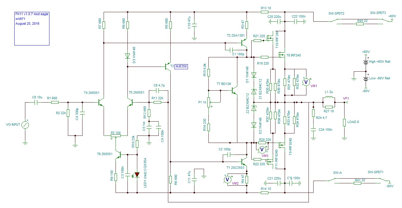

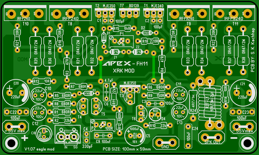

hi mr mile...my prroblem about fh11 be solved.with replace 150R with 470R.fh11 is good an stable.

This 150r to 470r stopped the power-on noise? To clarify, you changed R9 from this schematic/board layout? I am having similar issue, but negative DC for about 1-2 secs, pulls the woofer in. Hardly any real noise, but if I can avoid I would like to.
i can not kill popup noise.but when replace 150R/R9 with 330R or 370R mje350 and 2n5551's dont be hot....and circuit be stabl.but with 470R sound be very bad...because drivers can't work properly.you use 330R.
i dont know that how kill popup noice...mr mile just can help us.mr mile if you hear me heeeeeeellllpppp us please.
