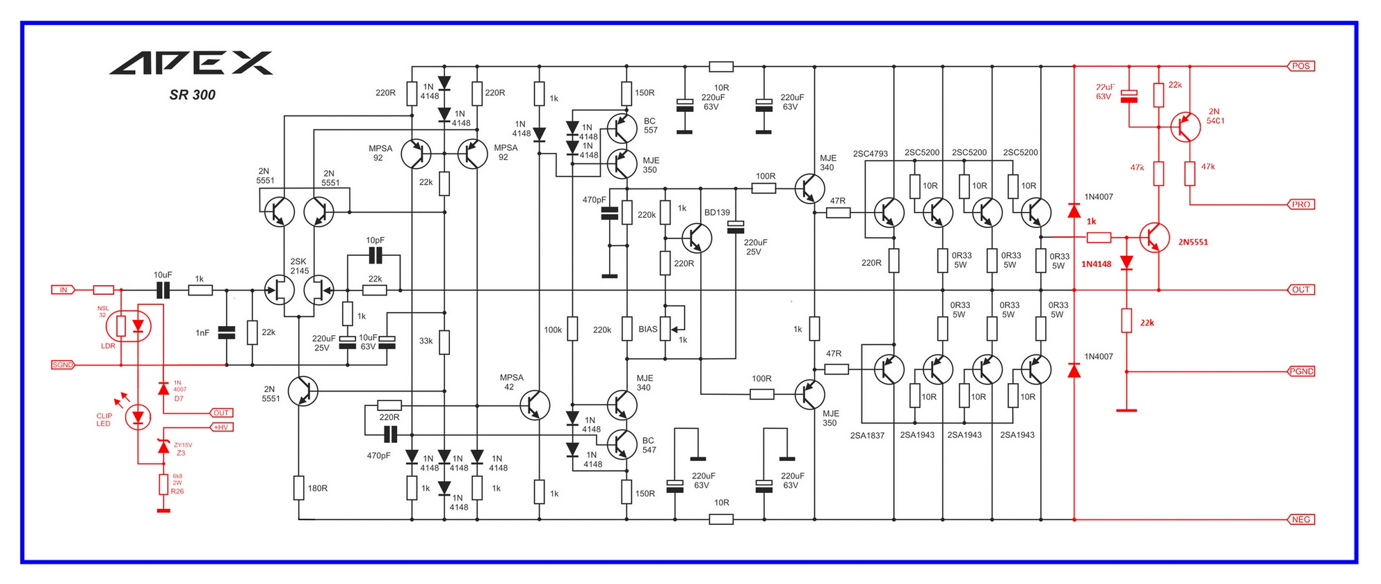

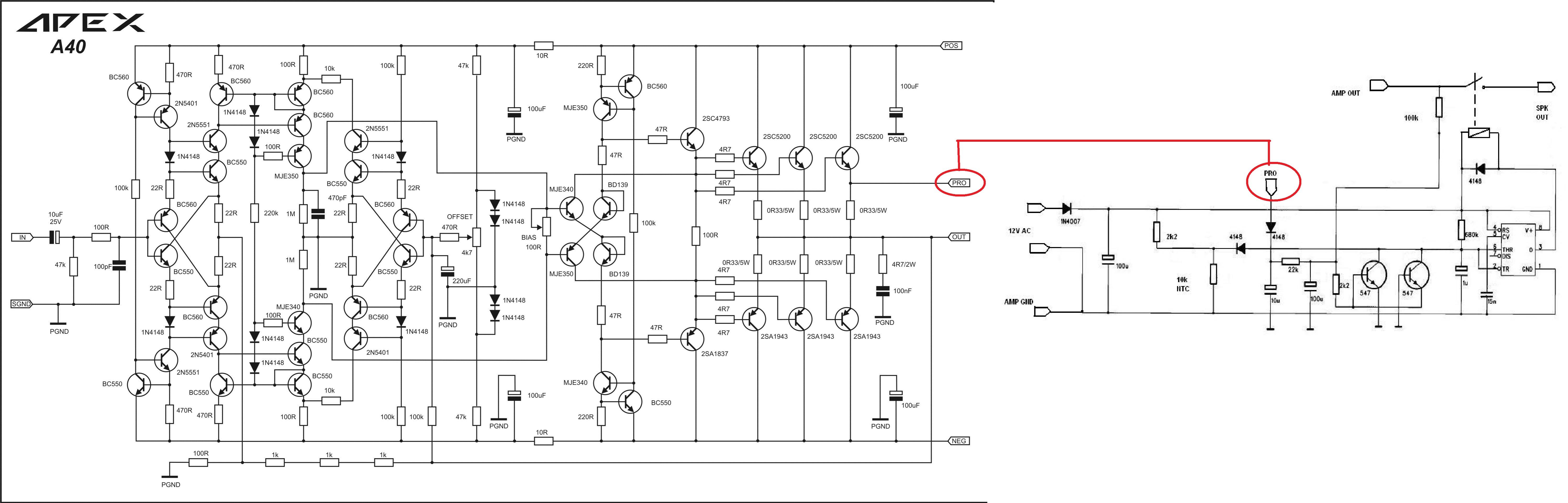

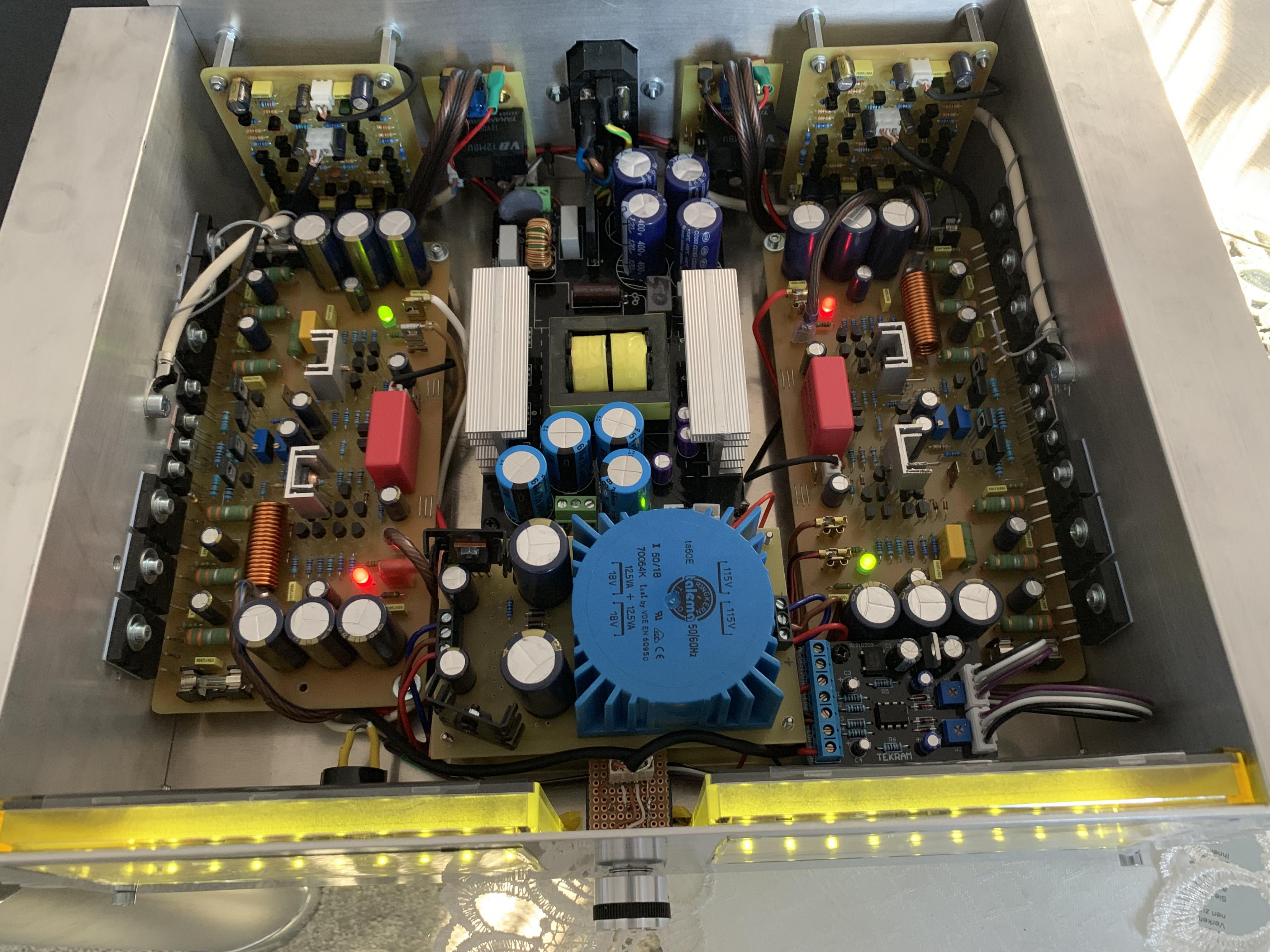

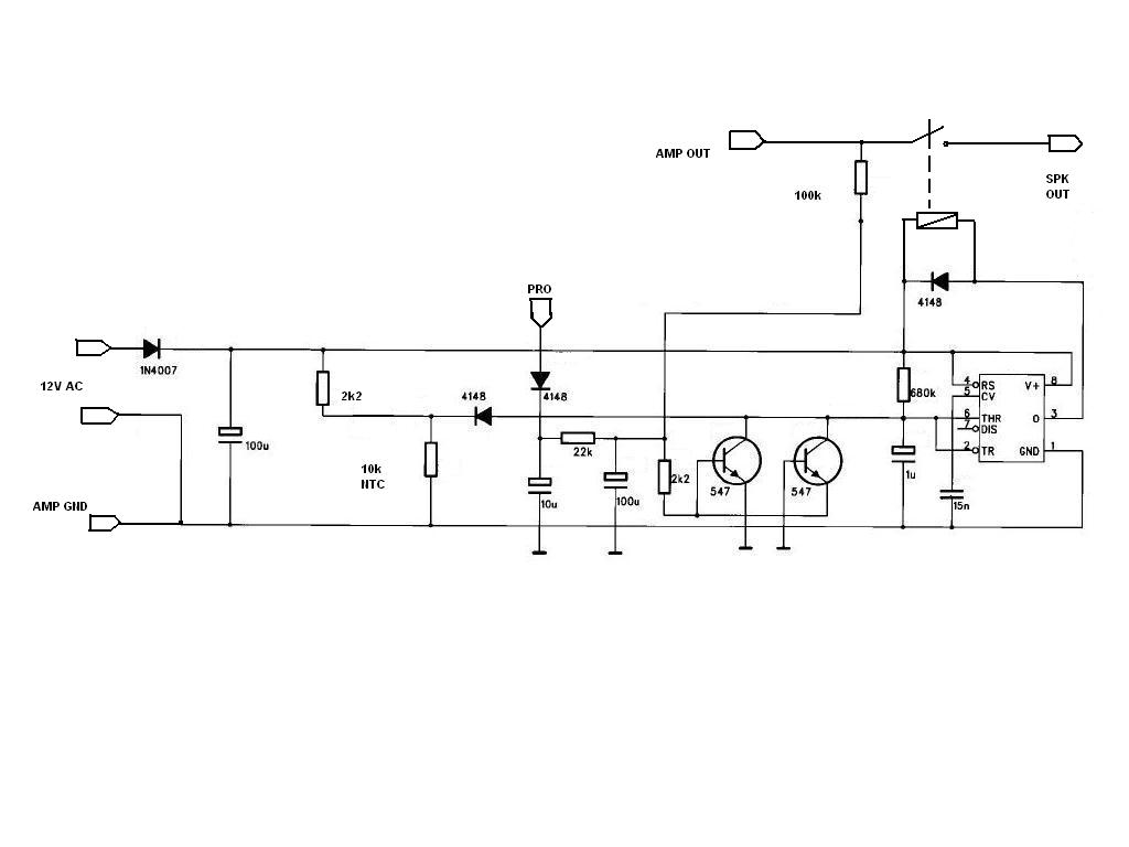

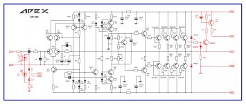

I use NE555 together with the A40 but protection it's too sensitive
to ten percent of the volume goes into protection
without connecting PRO everything is OK
what changes should I make to reduce sensitivity?
Thank you!
