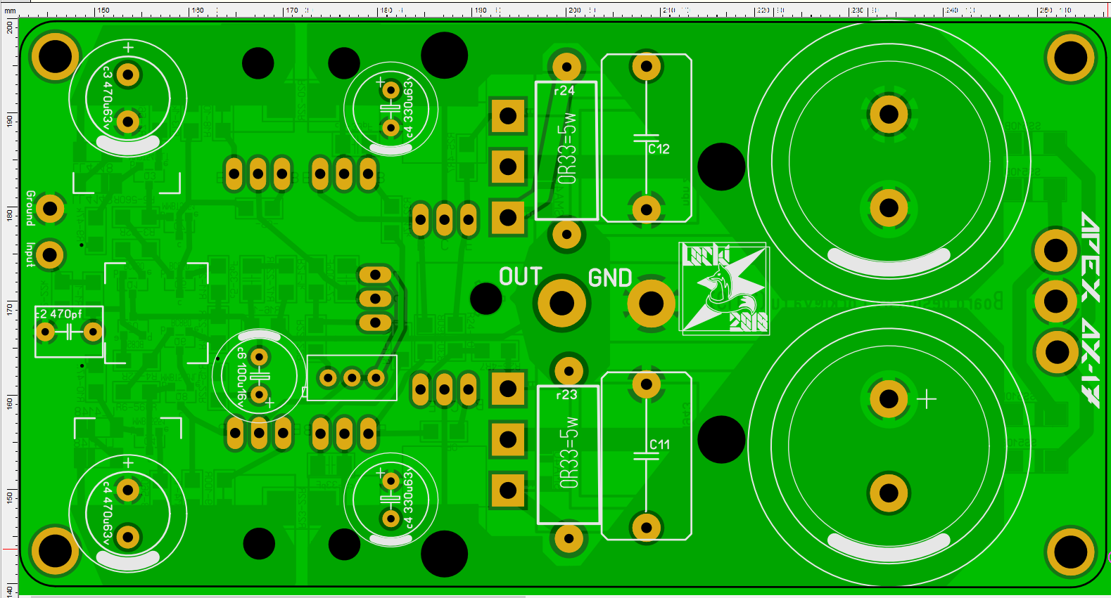

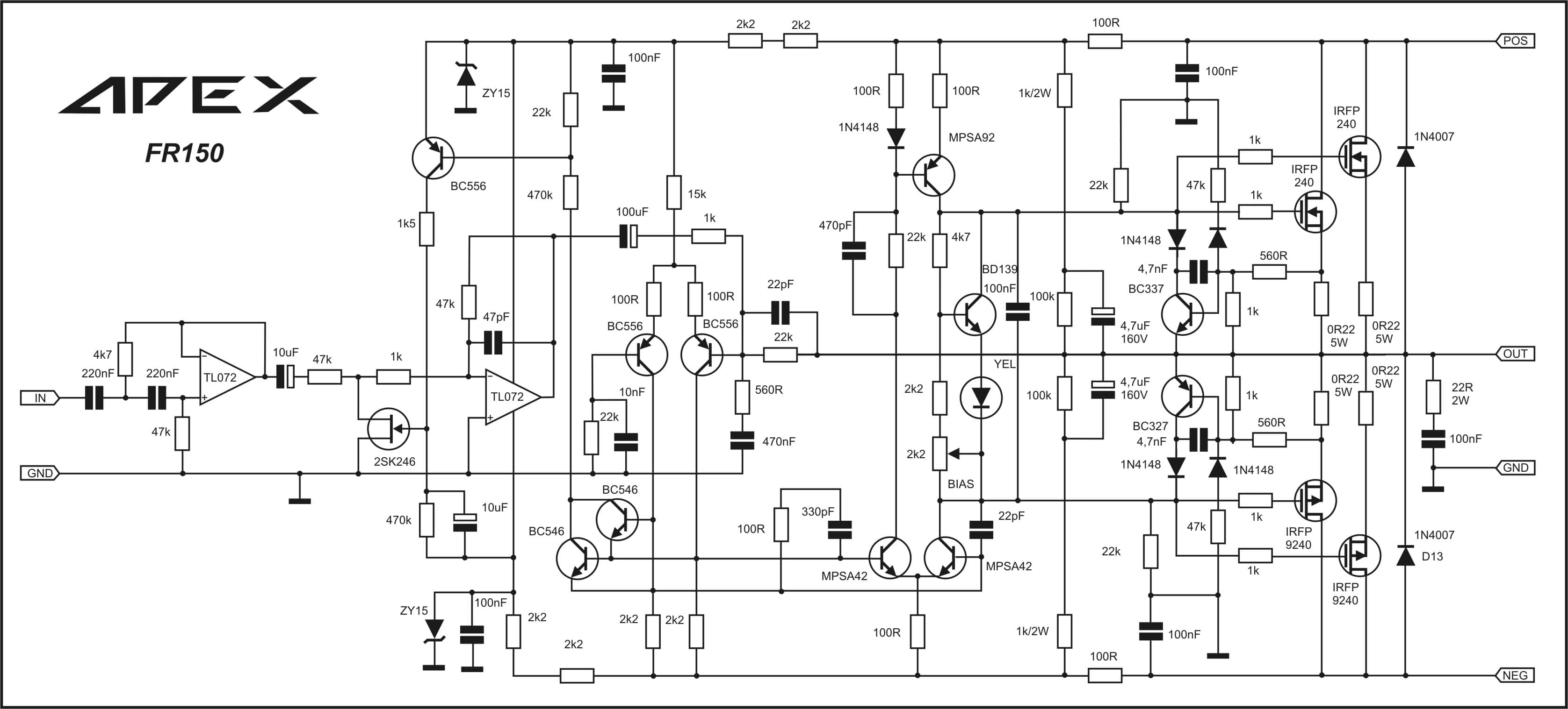

You are doing everything right and using top components. It may be oscillation then at higher powers. Try increasing C6 to 15pF or 22pF NP0/C0G or silver mica.
Try increasing the large 2W source resistors to 0.68R in an effort to squash it. Change one thing at a time.

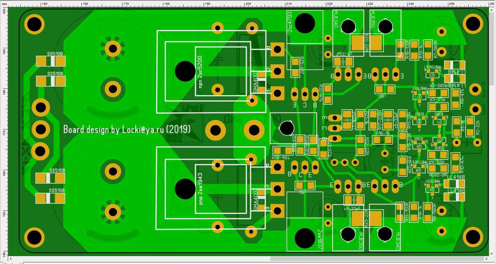

First thing I tried - changed the washers holding the MOSFETs to the heatsink to 1/8x3/4" and used the #4 washers too, making sure even pressure.
Then I measured the voltages across the Source resistors on BOTH boards to compare - interesting results:
Bad channel - lowest bias setting of 8.5mV on 37V, and 22mV on 65V)
(with +/-38Vdc PSU) measure left to right
--- 8.8 / 8.3 / 8.8 / 8.2 (so pretty equal)
(with +/-65Vdc PSU) measure left to right
--- 22 / 19 / 22 / 20 (again pretty equal) changed DMM and lost decimal
Good channel - can lower bias to 3.5mV on 37V, and 8.5mV on 65V)
--- 8.1 / 8.2 / 8.5 / 7.2(???)
--- 19 / 18 / 18 / 14 (???)
Measured heat sink (max was 87F) and MOSFET/transitor (max on 95F) temps - nothing went over 100F anywhere I could read a temperature. This was after I ran both amps on the +/-65Vdc PSU for ~30minutes.
I will get you some pictures, but since they both work, I use the same process and it is only the bias trimming that seems short of where I need - I'm fairly confident all the parts are installed and soldered correctly.
So what’s my next option? I changed the source resistors to 0.47r and it has less bias at a higher measured mV across them (35mV across a 0.47= 0.074. Previously I had 22mV across 0.235= 0.094)
Is that still too high of bias?
All this was done with both channels run on same heatsink at +/-65Vdc and same bias on both channels (~75mA) I played loud music for almost an hour and could only get temps up to 115F, which was only during very bass heavy parts - FYI bias would go up to 135mA during these loud bass sections.

Been busy today... tried it out with a single 0.47r source resistor per MOSFET and still couldn't get the bias low enough for me to feel "safe" at +/-65Vdc. Best I could get was ~75mA (35mV across 0.47r)
Google and youtube searches came to my rescue on how to take a too high trimmer and "adjust" to the closer value. Hopefully I didn't break amplifier rules, but it kept coming up on guitar amps, so figure it was worth a try.
I was going to order a 2k trimmer, which @hassan4119 said he used on his version of an APEX amp.
So I took the 5k I had on hand and put a 3.3k resistor across the outside pins to get a 1.9k trimmer.
I can now get the bias down to 0.001 at it's lowest. I set it for 8mV, or ~34mA and I ran it for well over an hour and the heatsink stays at 100F and all the transistors and MOSFETs can have a finger on them for ever without being uncomfortable. Let me know if this is too low, just don't want to create heat if I don't need to.

Glad you got it sorted out and it’s not blowing up now. It was too high of a bias current then.
