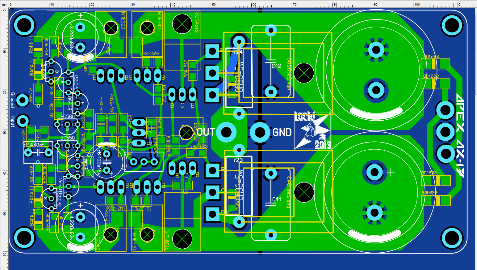

i made fh11...in first i see that mje350 & 2n5551 be very hot...i have hi bias sound not very clear....but mr apex tell me replase 150R with 330R...i do this and result be very good....it work properly and sound be clear and good ..
but i have just a few hom nois
pleas see my pcb design in this link:
http://s4.picofile.com/file/8363574750/IMG_20190403_192542.jpg

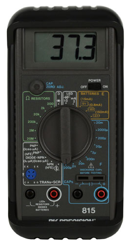

Is there a way I can check to see which is the current "hog" (without a curve tracer, or similar)? I would like to pull and test to see if I can replace easily.
Especially since I plan to populate 2 more boards over the next month or two.
I have two DMMs, a Chinese transistor tester and a B&K Precision tester (which has settings for Hfe and other transistor parameters - see photo) at my disposal.

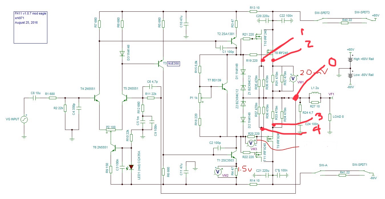

With amp running measure the voltage drop across individual source resistors to see which one has excessive current vs the other. Measure current between test point 0 and 1/2 and 0 and 3/4 (see sketch). When you match the MOSFETs use the tester that tells you Vgs with MOSFET removed. Buy a bunch of them (like 12 or more - you will use them so don’t worry). Write the Vgs value with a sharpie or pencil on the mosfet for future reference. Values will be from 3v to 4.5v, tru to get within 0.2v or better. Perfect match is luck of all from same tube or some times need to buy 50. There are places that sell matched MOSFETs. But generally if you get 12, you will fine 4-6 that are close enough.

Well, probably not a "current hog" situation then. But do measure the current anyway. Very puzzling since you repopulated a new board and the problem remains. Are the thermal contacts on all the MOSFETs good? An IR thermometer (or your finger) will tell you which one is hotter than others. Are you using silicone insulator pads, or mica and thermal grease? Either should work fine. One final thought is the quality of the 0.47R source resistors. Cheap no name bright painted blue ones from eBay/Aliexpress can often be unreliable and blow like a fuse (go open circuit). Best ones are Panasonic ERX series, or Vishay/Dale. They are like $0.6 ea though but worth it as they also will reduce distortion.

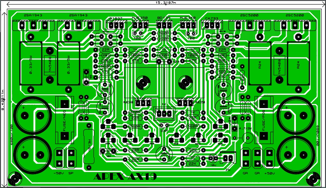

Please post a closeup detailed high res photo of your amp that is giving problems. A bottom side phot as well. Finally, double check all your resistor values to make sure you are not off somewhere. Slipping a factor of 100 to 1000 is not uncommon (like 470R vs 470k etc).
