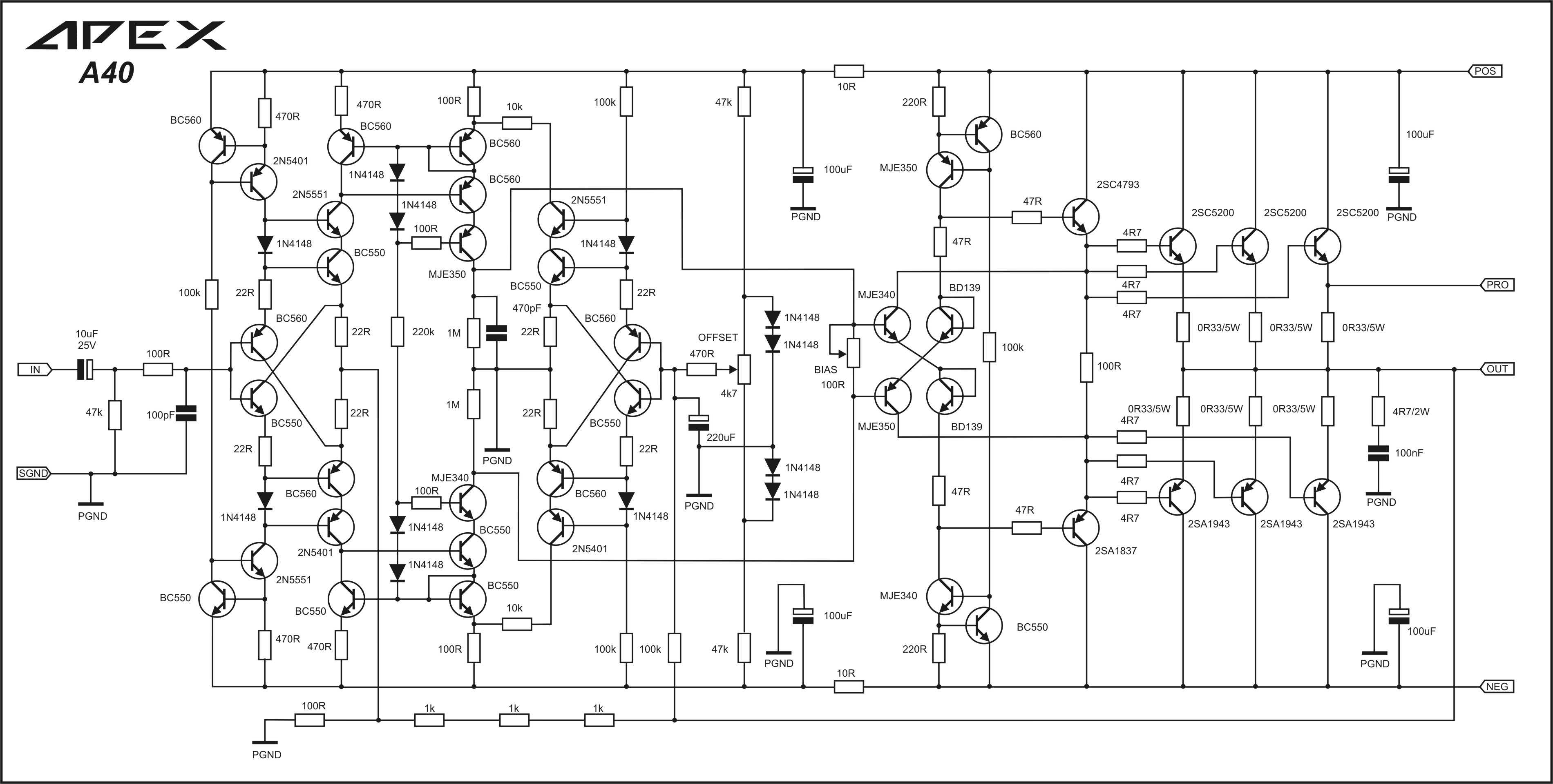

hi i need your help. i build a40 today when i connected supply there was 28v dc at output i adjusted the offset pot, nothing happened at this moment 100k resistor burned which is connected between output and offset pot. there is 470R resistor with offset pot in schematic that i used. but i have seen schematic with 470K resistor. i don't know which one is correct. also i have used 200R bias resistor as 100R was very hard to find in local market.
Is the signal gnd connected to power supply 0v?

Hi Rehman,
The series resistor to offset pot should be 470K.
Regards
Sha
