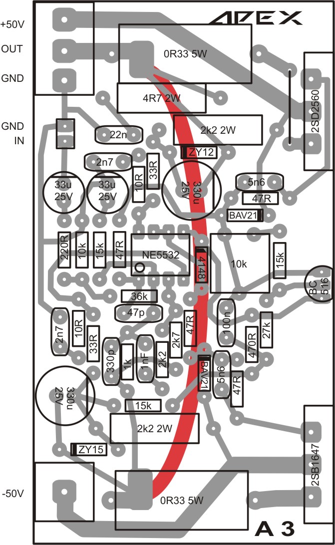

A3
A3 Pcb size 50x90mm.
Hello Mr Miles, What is output power of A3. I can't found shematic of A3, please can u post the A3 amplifier shematic.
Regards
Gurpreet

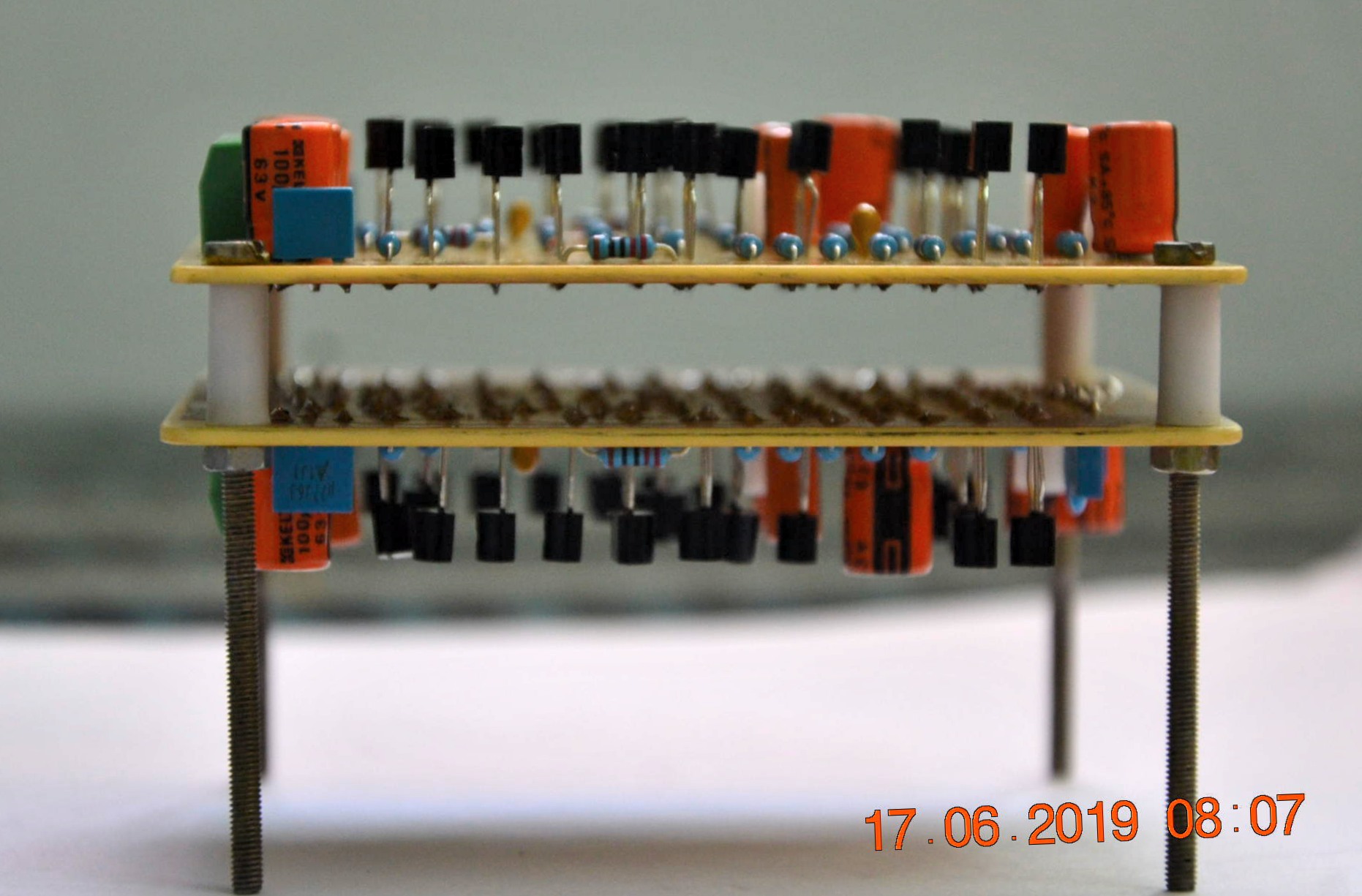

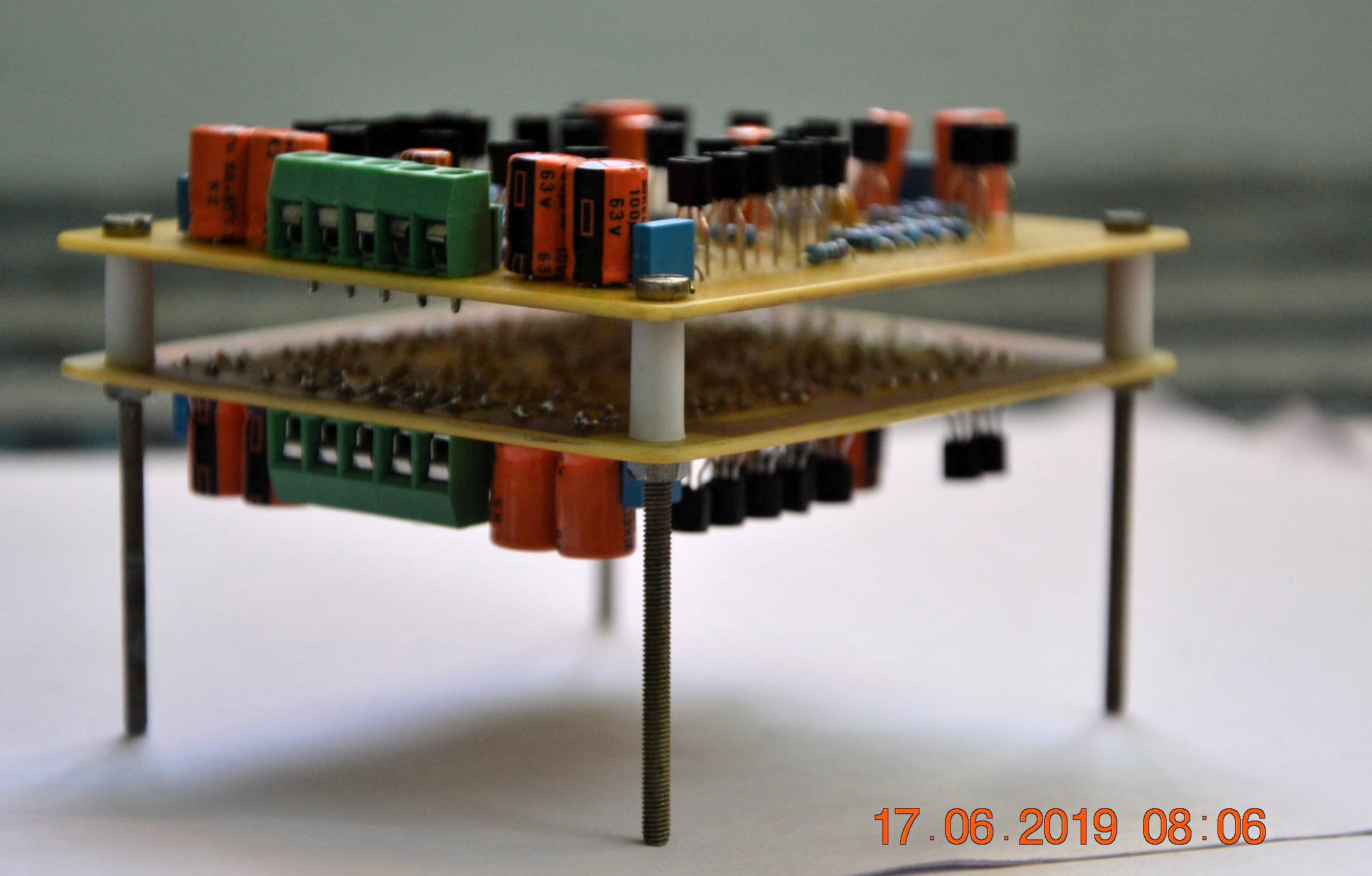

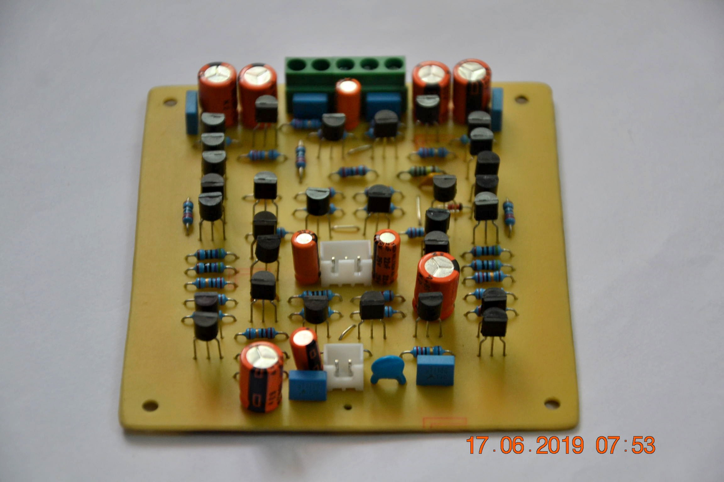

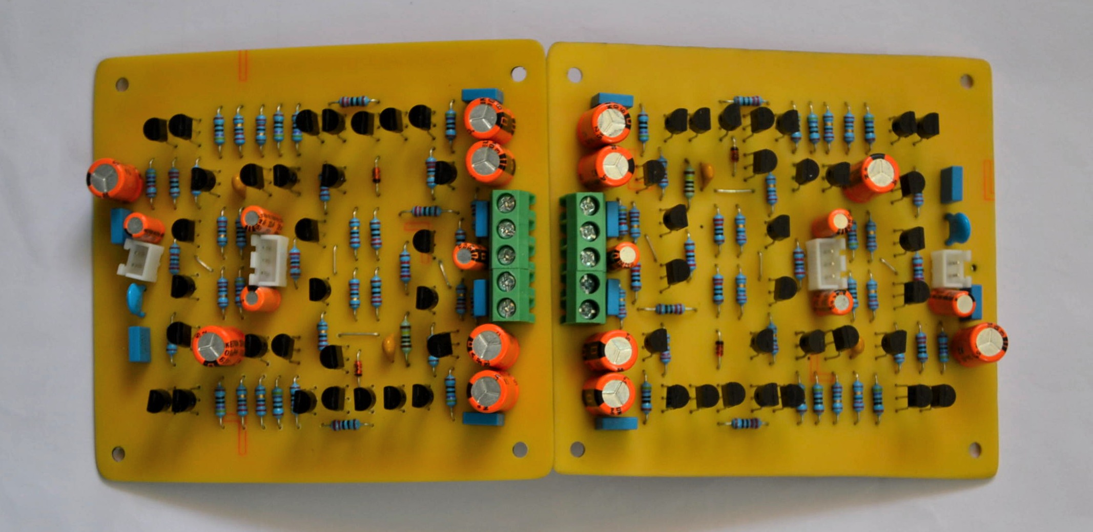

i made fh11...in first i see that mje350 & 2n5551 be very hot...i have hi bias sound not very clear....but mr apex tell me replase 150R with 330R...i do this and result be very good....it work properly and sound be clear and good ..
but i have just a few hom nois
pleas see my pcb design in this link:
http://s4.picofile.com/file/8363574750/IMG_20190403_192542.jpg
