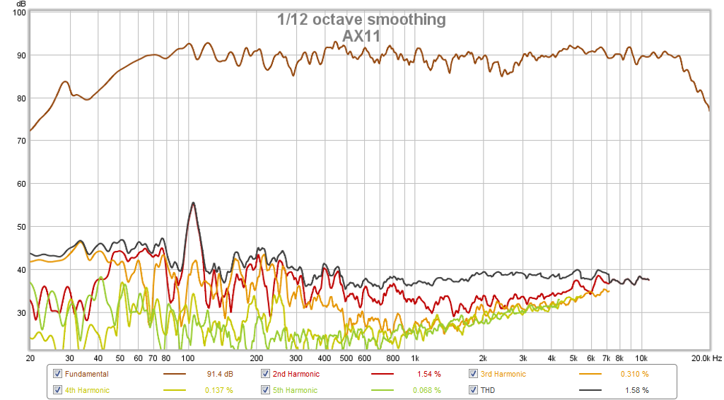

Here is measured distortion from speaker:

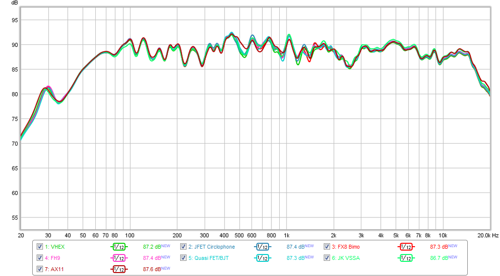

In comparison to other amps:

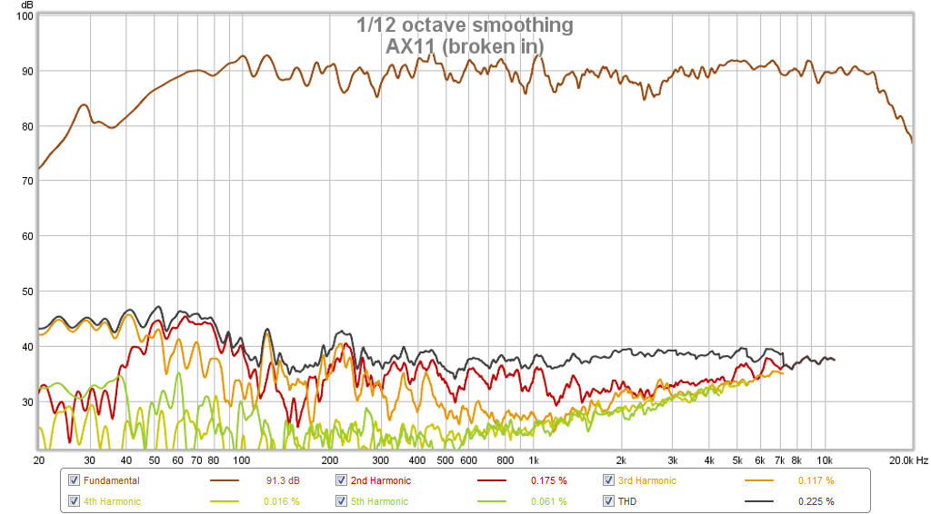

Edit: maybe there is something to burn-in or breaking in, after playing for good 30 minutes, the 104Hz H2 peak is gone now...
After playing loudly for 30 minutes, I remeasured the response at the speaker and the 104Hz peak is gone:
