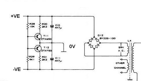

You can use transformer without centre tap but you nee double voltage 48vac.
Interesting any alternative for ztx?You can use transformer without centre tap but you nee double voltage 48vac.
You can use any similar transistors and with this psu you don't need DC protect but you need separate psu for each channel.

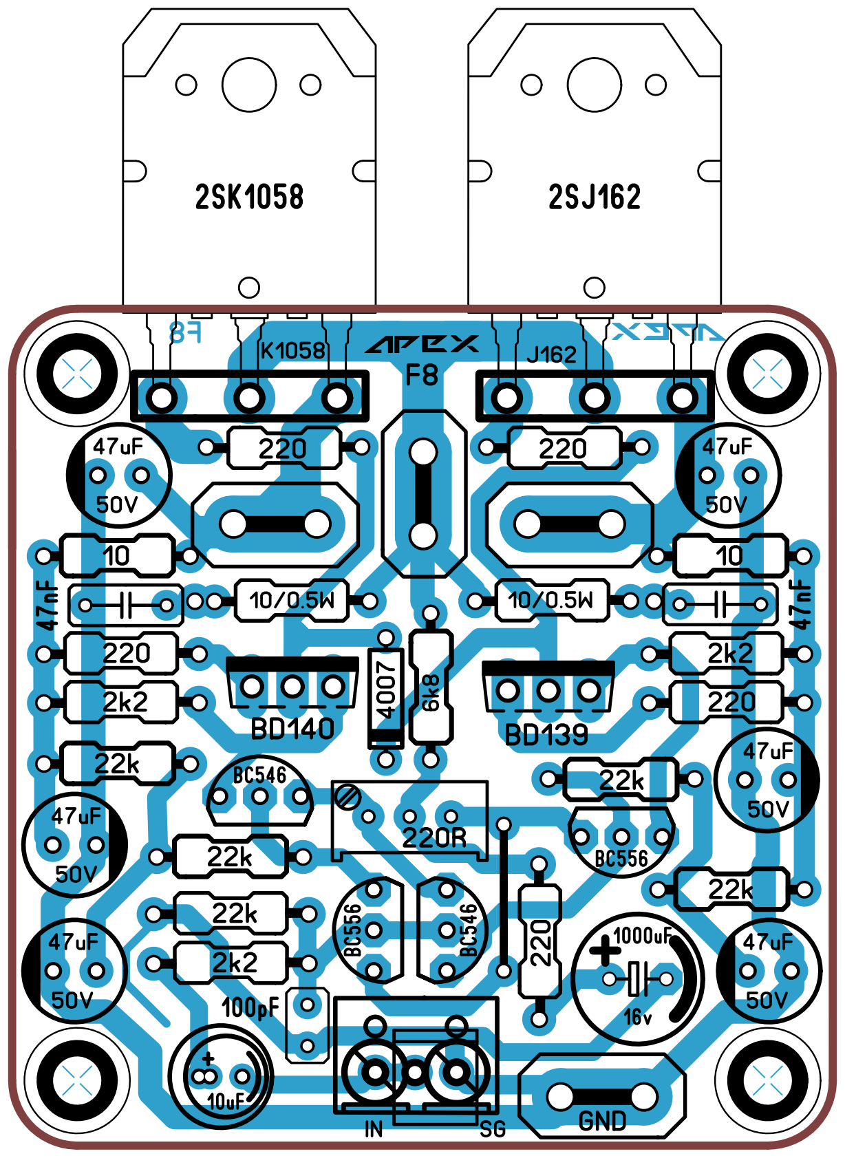

Apex F8 50mm X 50mm compact version. I removed diode zener protection because K1058 and J162 have them in built.
That a neat tiny one?
Amazing!, a real compact, symmetrical looking, very nice...

Is F8 topology totally different? Looks like a complementary input rather than LTP:
Reminds me of the earlier 50mm FX8 layout you did:
Nice work,

F8 is CFA topology with diamond buffer input stage, yes it is totally diferent.Is F8 topology totally different? Looks like a complementary input rather than LTP:
Ok, kind of like VSSA with CCS's and BD drivers - cool. Which post is schematic on?
Edit: found it...
This looks like fun. Sort of along lines of my CFH7 amp but with latFETs rather than hexFETs?
