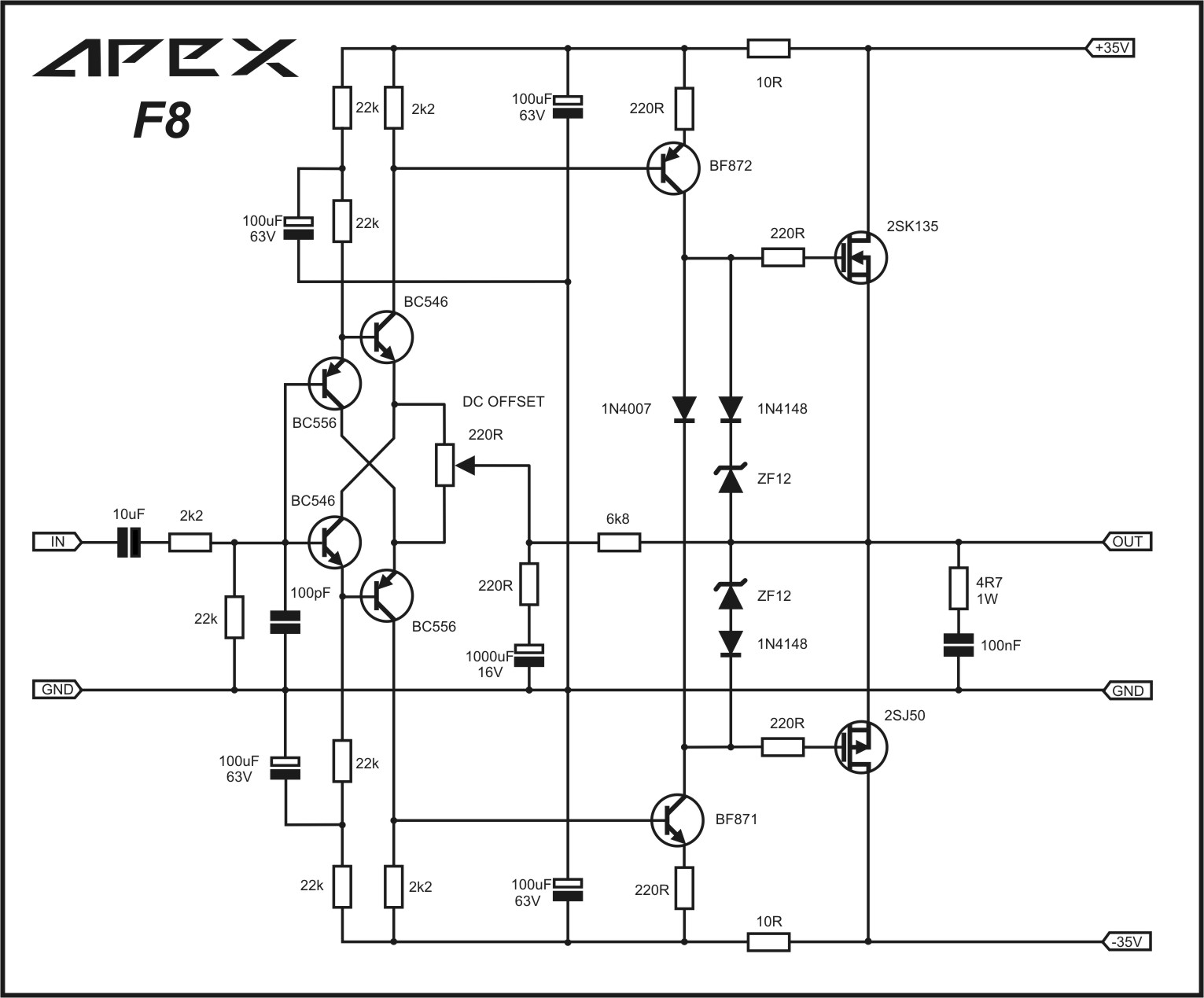

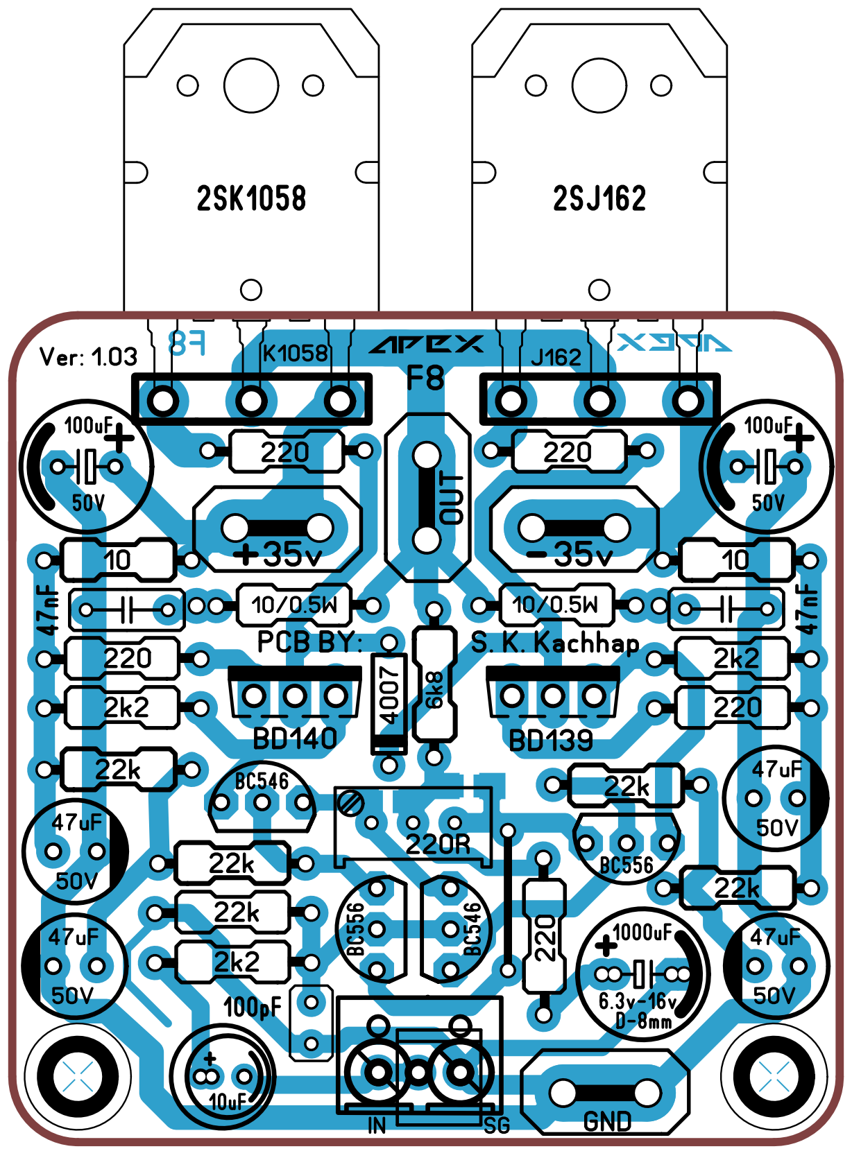

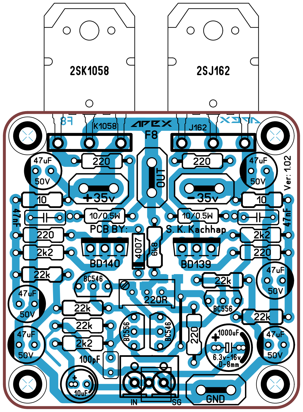

Revised version of Apex F8.
I have made changes in layout by adding smd resistor parallel with trimpot to increase reliability in case of trimpot failure.
Value for trimpot will be 1k and SMD resistors 150Ω, both 805 and 1206 package will work.

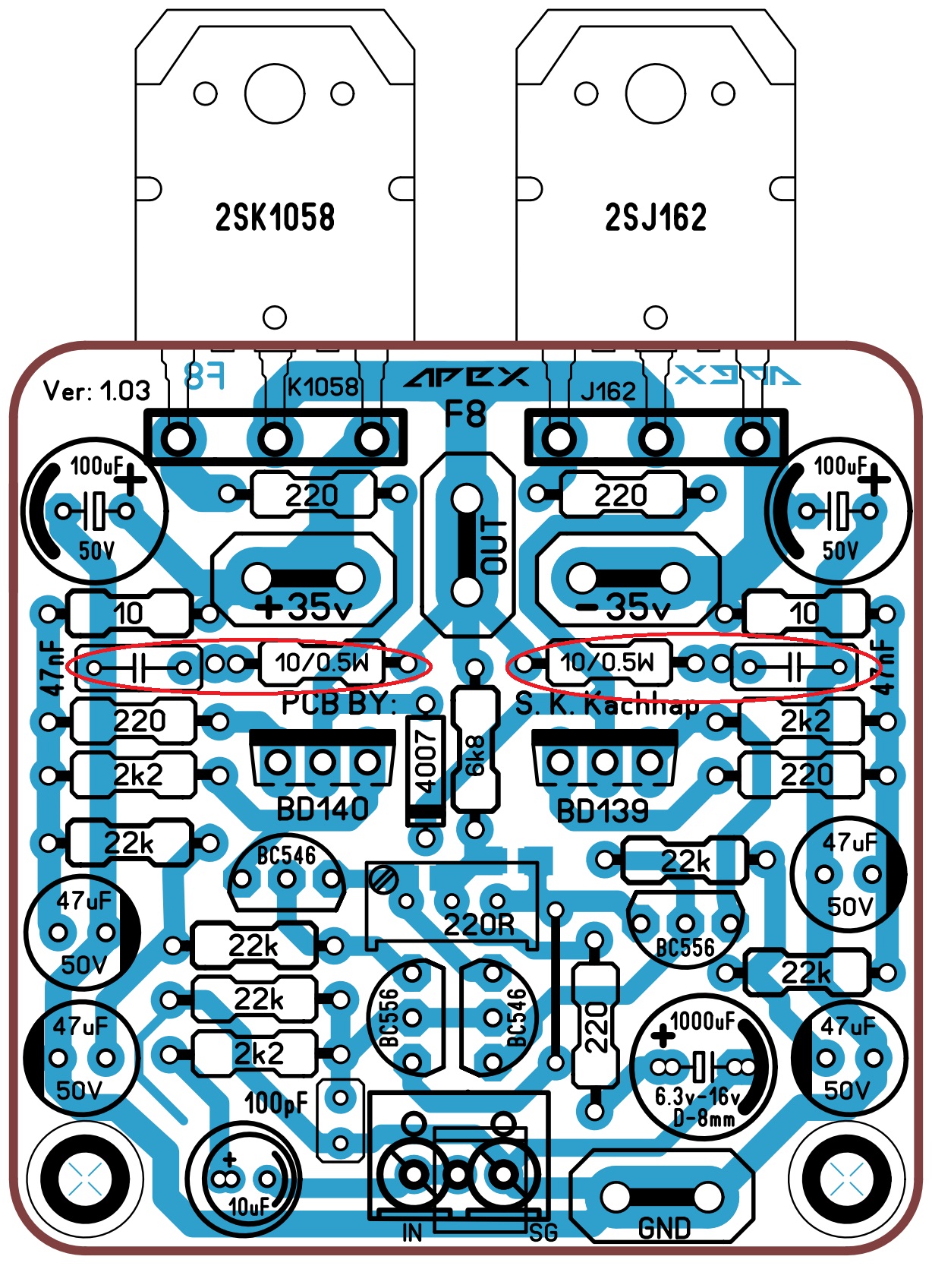

Quick question, is this F8 really an FX8? I can't find the F8 in either directory. Also, the schematic differs slightly from the pcb, marked in red. Also, the 1N4148's and 12V zeners are missing on the pcb. Ok, nevermind. I found it in the 100W ultimate fidelity amp thread.

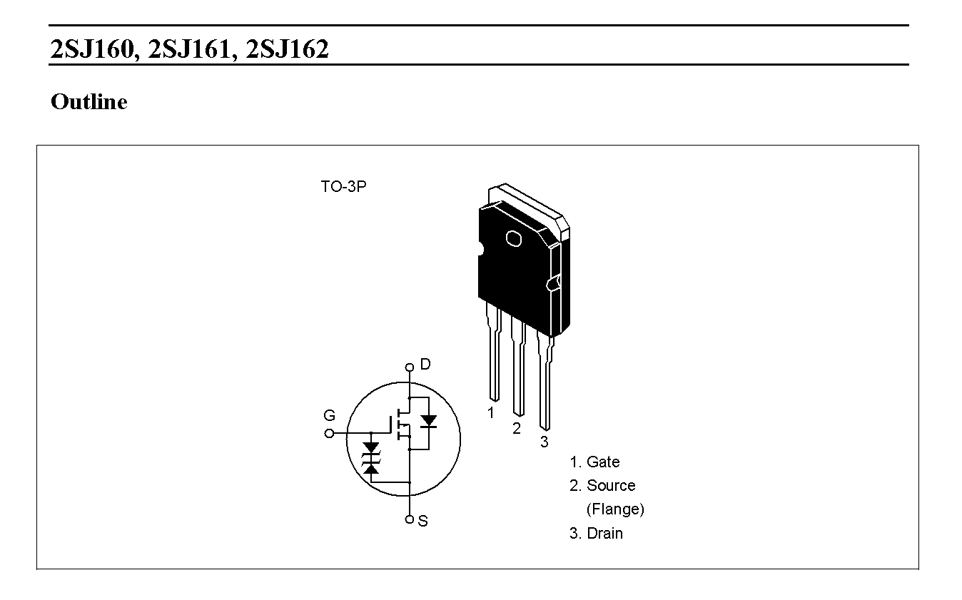

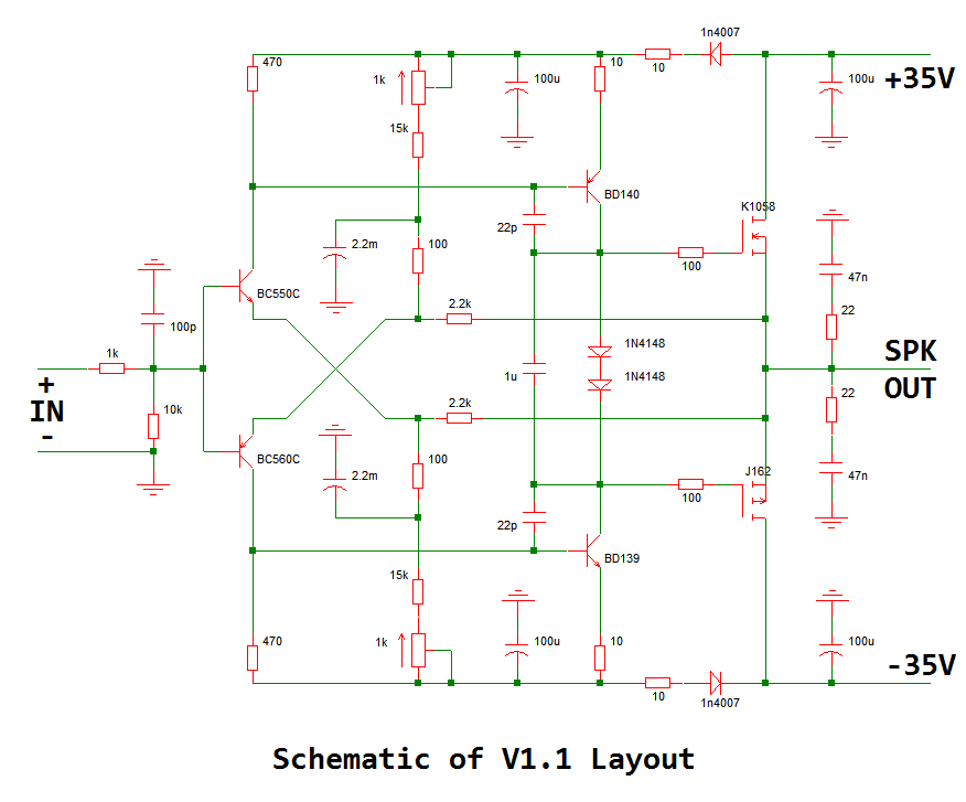

There is no need of diode, zener protection when using K1058 and J162 because both device have them in build. This layout is only compatible with lateral fets with in-build diode, zener protection.
As for zobel, I used way Shaan implemented on PeeCeeBee V1.1 for better pcb space utilization.
the red marked components are just the zobel being split in two 10r and two 47nF in parallel .
