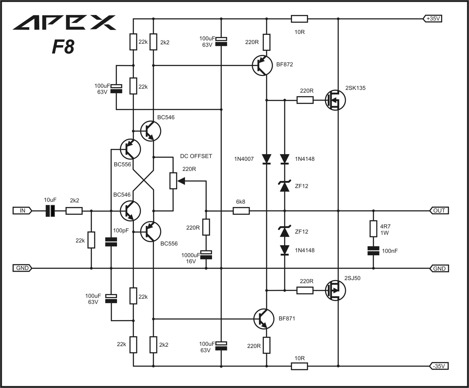

awesome ... could draw with HEXFET and VBE ?
Regards
Thiago
Then it might resemble the CFH7 +2 with another driver stage.
Regards
Thiago
Or with BJT and bias fixed by LED

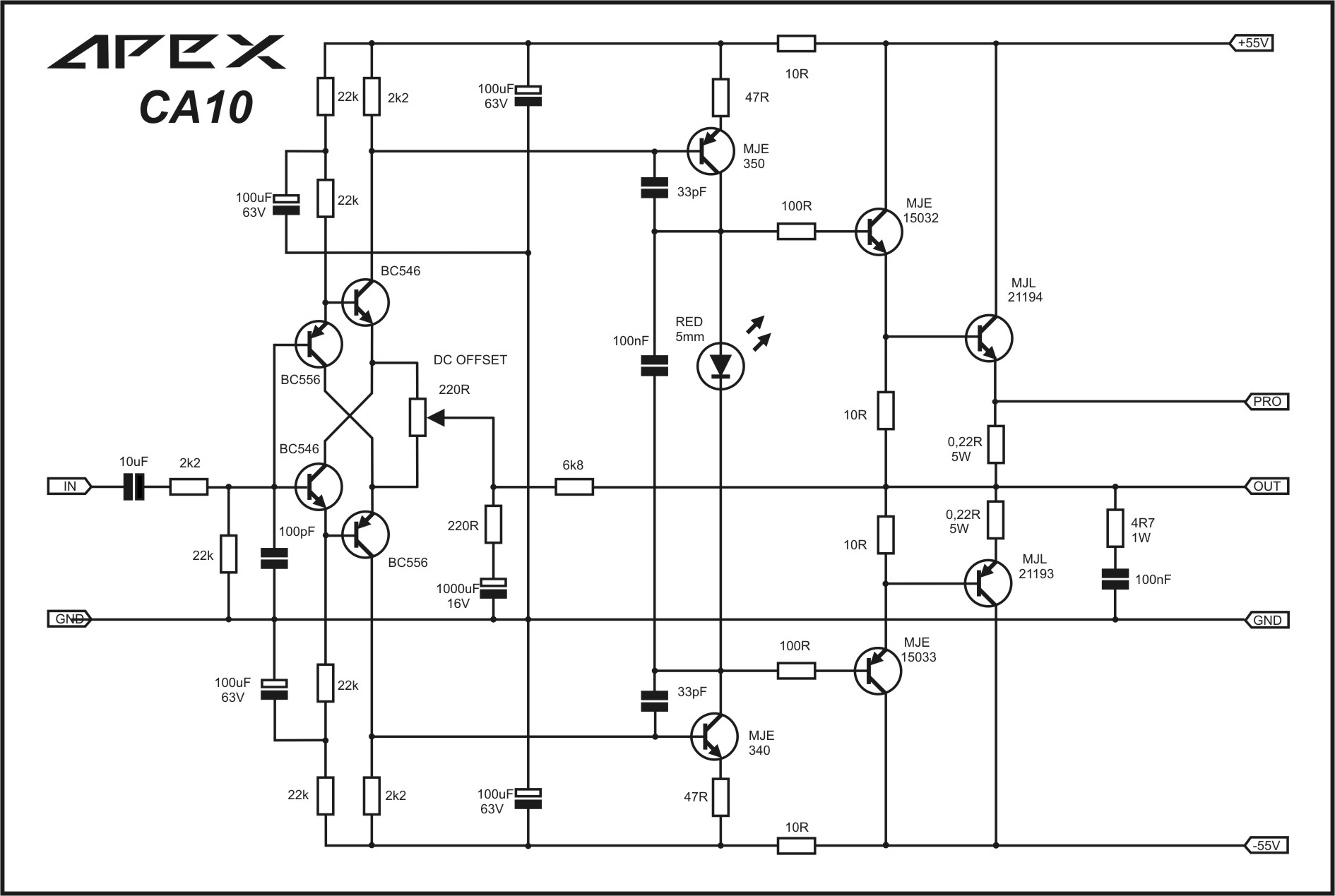

Hi Apex,
CA10 looks really cool. I like it a lot. Is this something from past post or brand new?
Hi Apex,
It is new and not tested.
With a trimmer pot for DC offset in the CA10, does this mean the BC546/556 don't have to be matched?
