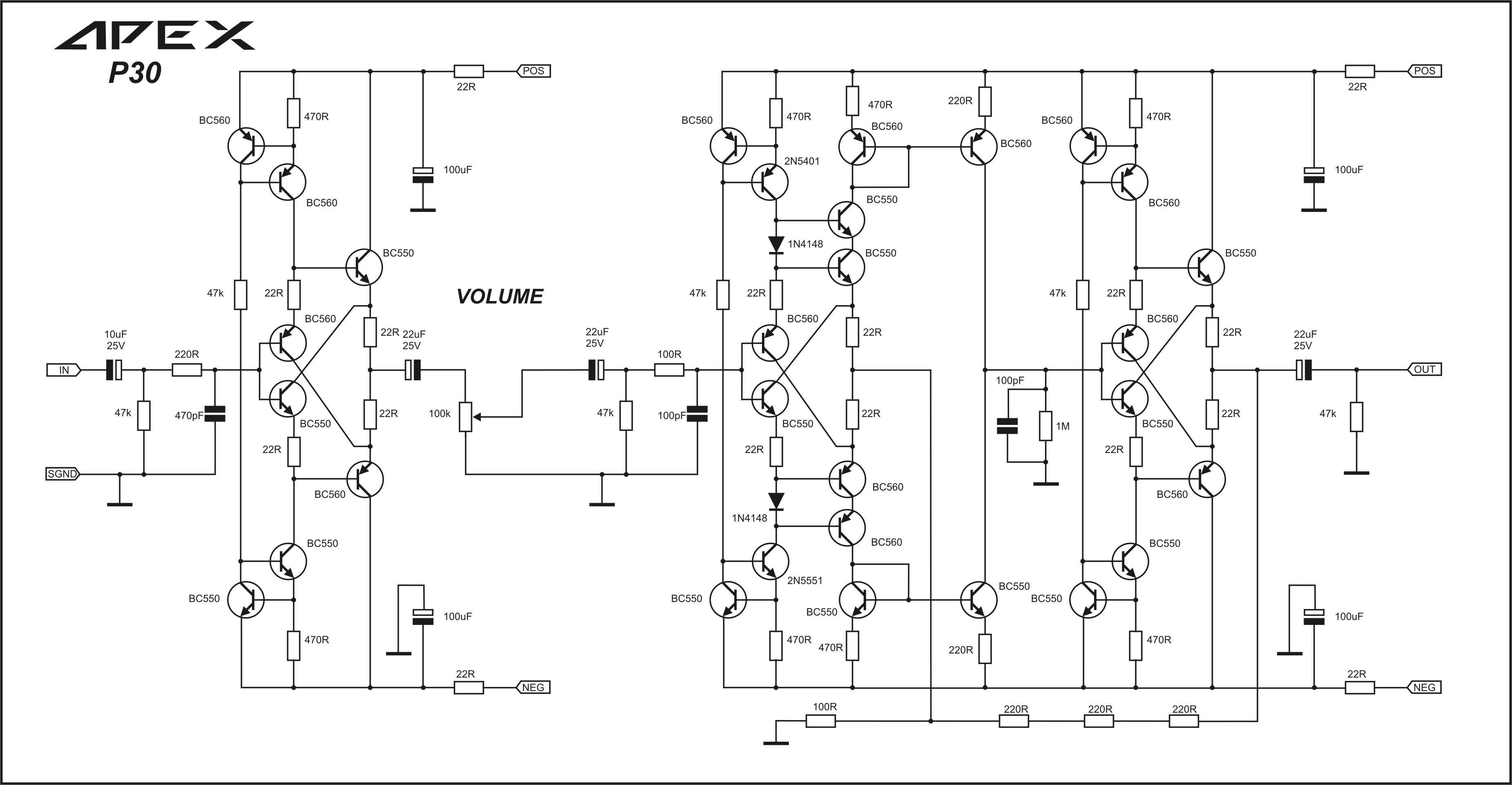

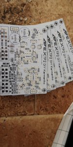

The P30 preamplifier can be powered on +/-15v?

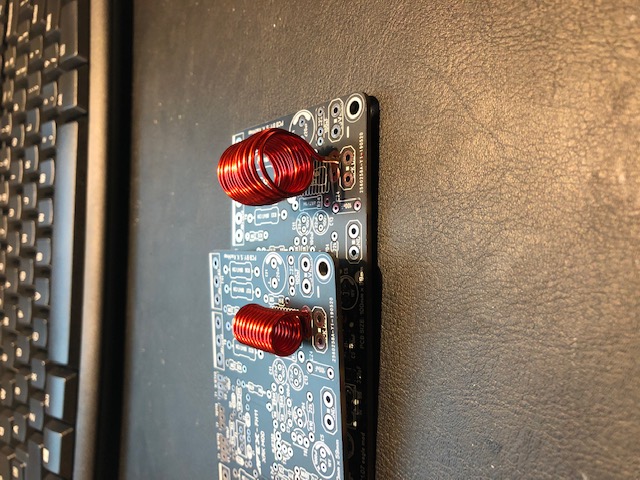

Inductor Help

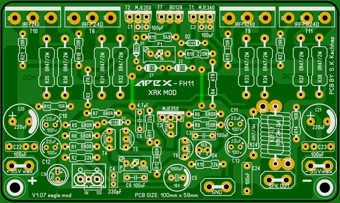

I am putting together all the parts to build the FH11 (Mouser order came in today) so I'm trying to get everything laid out.
I am working on the inductor - which the silkscreen says should be 2.0uH, but other threads are from 1.0 - 2.0uH (how low is still ok?)
Questions - (using 16Ga 1.2mm enameled wire) I made two different diameter versions, both with 10-11 turns of wire:
- one around a pencil, approx 7mm internal diameter
- one around a AA battery, approx 11mm internal diameter
Pencil version measures 0.6uH (on left in pics)
AA battery version measures 1.6uH (on right in pics)
Which one should I use? I like the look of the pencil version since it fits the designated area on the board with out crowding surrounding components, but don't want to comprimise the quality just because of that.
