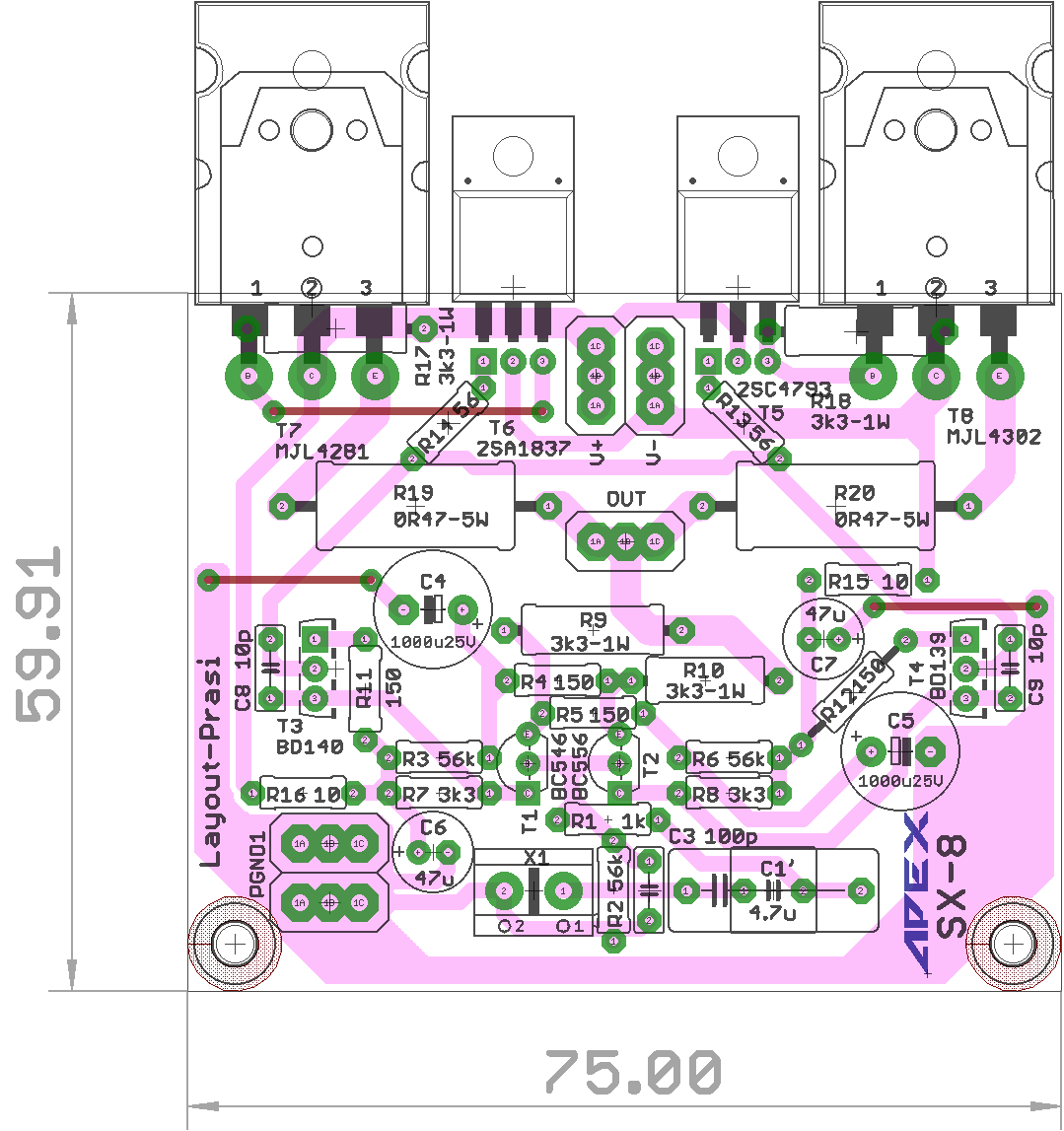

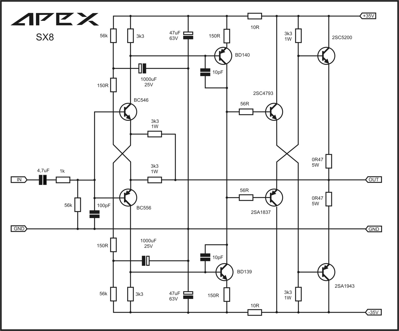

SX8
Simple amp idea.

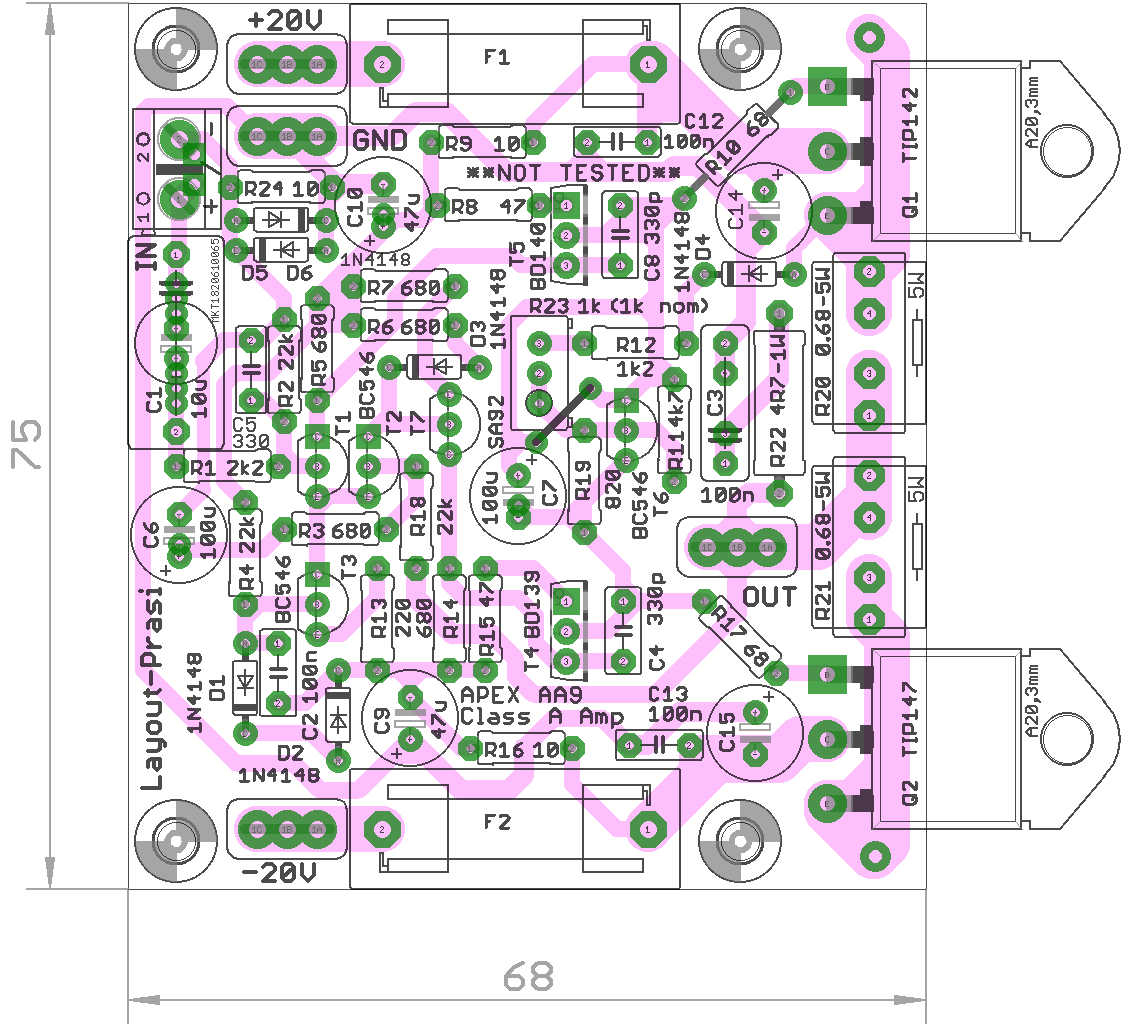

APEX AA9
Mr. Mile,
I have added rail decoupling near the o/p device and also ground lift.
Is it recommended?
+some reduced the PCB size to 68mmx75mm
reg
Prasi
PS; many revisions, but i want to make it as good as possible.
edit: the black jumper is optional jumper to reduce the trace length from C7 to C of T6.

Simple amp idea.
You can't use the output stage diamond buffer in a power amp that way.
It's basically two symmetrical SE stages that go to current clipping very fast (if you don't bias it to pure class A) . Simple version from your sch. works for small signals but if you want to make it push-pull you'll have to use a big cap to connect the bases of output transistors. Then it will work but not very good - pair of lateral MOSFETs will do much better job, and then you get old F5-gone-BJT with addition of source follower output stage...

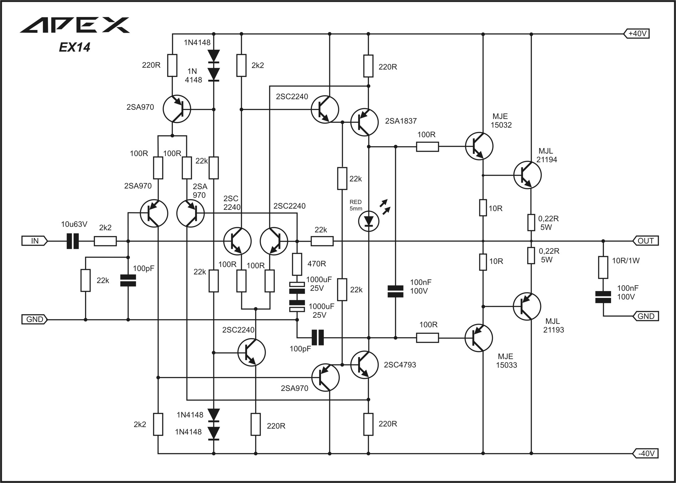

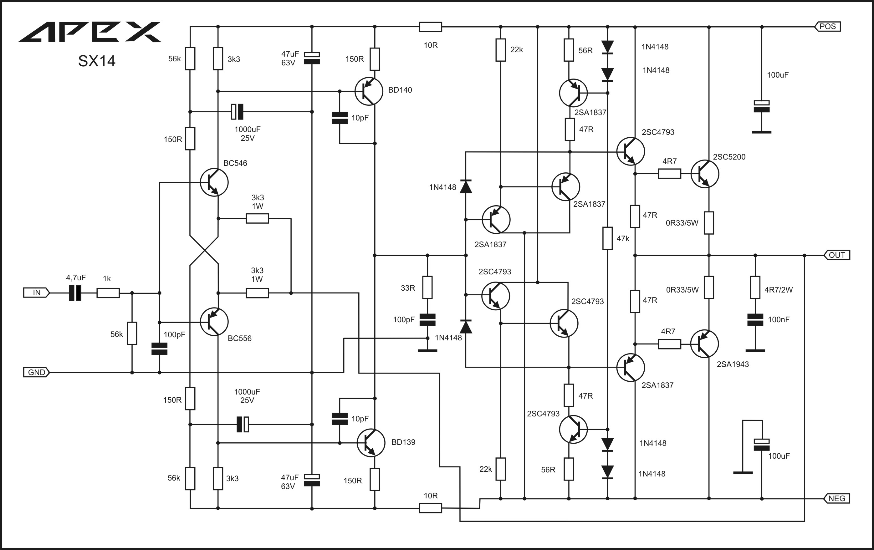

Little improvement.
Hi, here are some measurements. I've corrected the offset by changing the 470R resistors. But I think now the amplifier is underbiased.
Advice are welcome 🙂
But the sound is very, very good. Deep, powerful bass, well balanced mids and transparent beautiful highs.
Regards Olaf
hi i also have made fx12. sounds just as olaf described, and i have vssa to compare. 😀
how do i increase the vas current tho? change out 22k resistors or the 220ohm?
