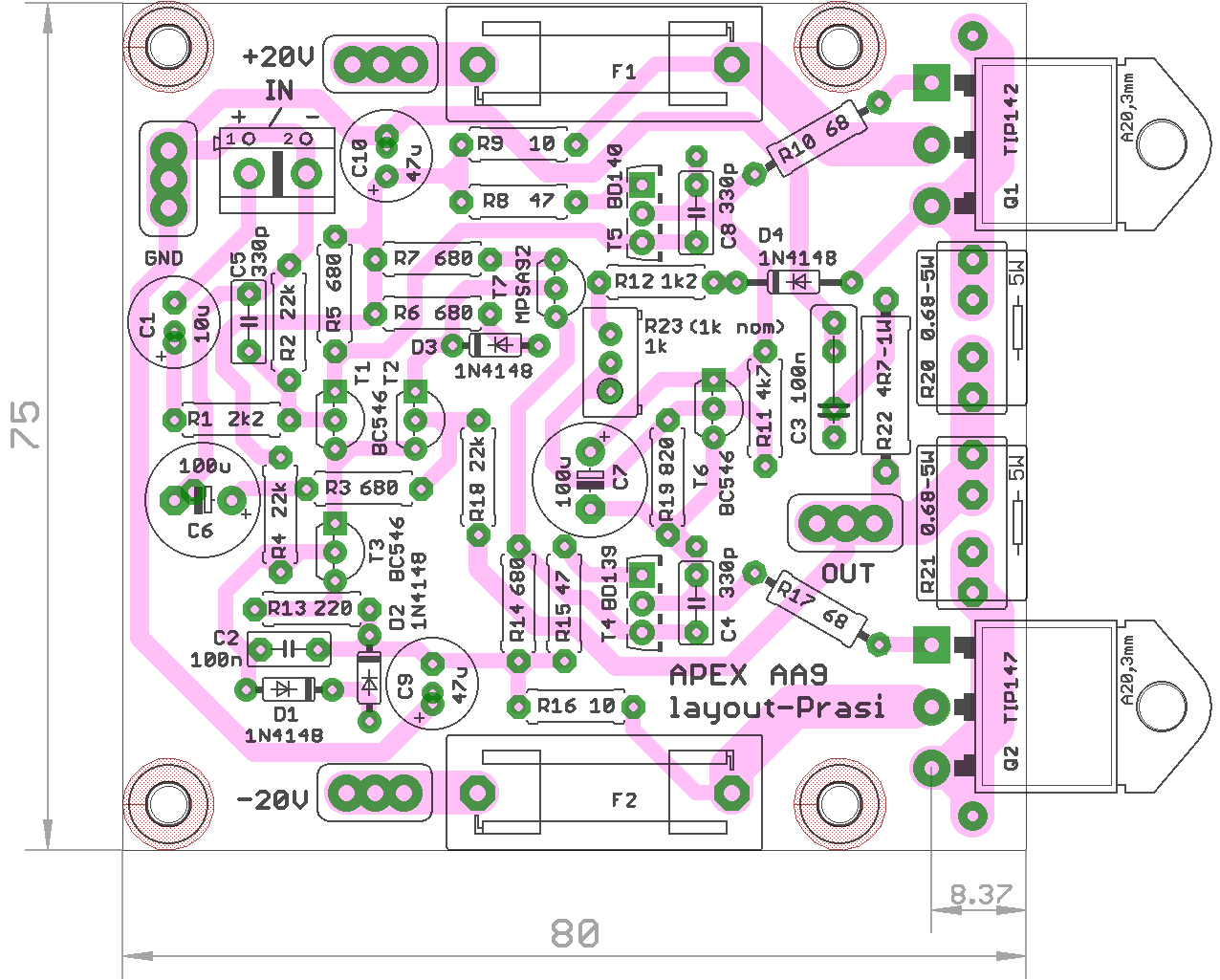

here you go! still many things to learn from you..Mr. Mile, have you simmed this amp?, interesting to see the sim..
It is done,
Mr. Mile pl give your go ahead for sch and layout...
attached is the pdf looking from component side and also the gerbers...
Also how low can be go with values of C4 and C8 and also the i/p filter?

waiting for the schematic and PCB print files >>
how the gain is adjusted?

Looking nice Prasi! I actually have all these parts on hand. It would be a fun quick build.
Thanks for your appreciation.
I am waiting for Mr. Mile to have a relook at his sch again because of the concerns raised by AndrewT.
Once my Laptop is back I can rework to improve it.

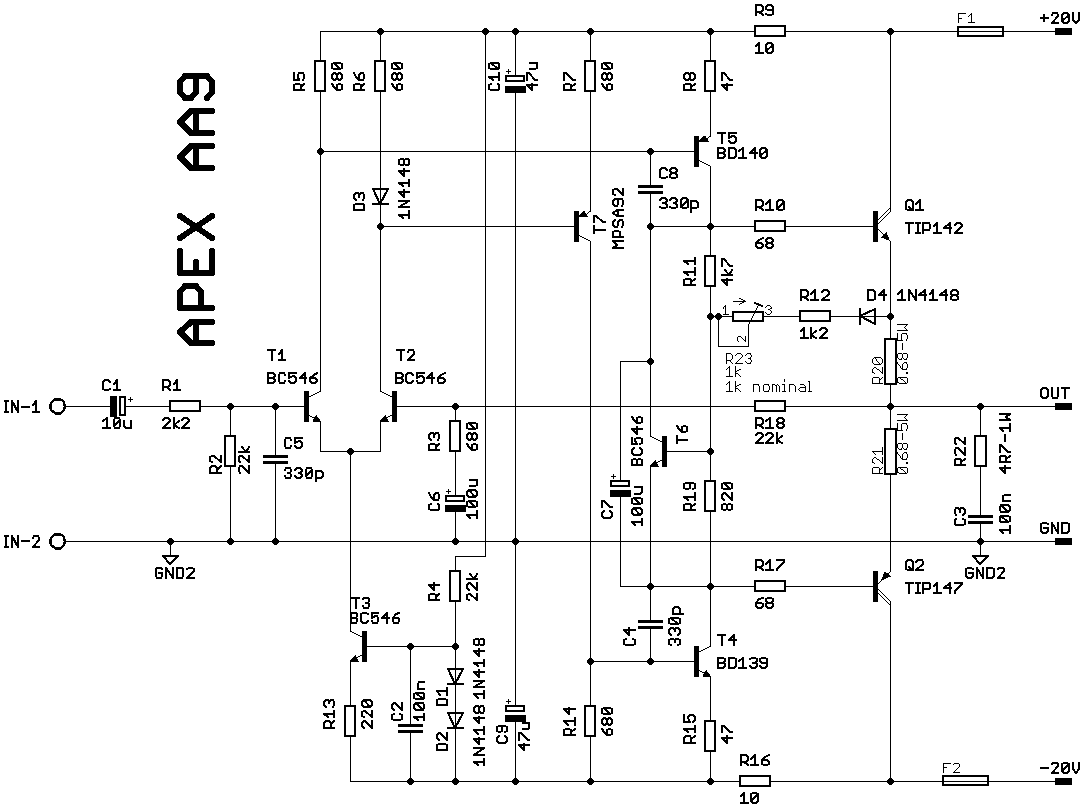

Prasi, I'm interested in your aa9 class A and I think I'll be tempted!It is done,
Salut Project16,
Sure Mr. Mile's AA9 looks interesting. But I am not as capable as some of the builders here. So I post my layout for such active gentleman.
Do let me know if you decide to build and I will help in whatever way I possibly can. .
Reg
Prasi

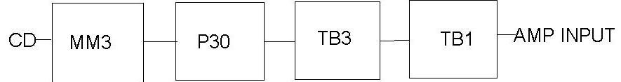

hi apexaudioTB1 volume preamp with loudness for use with TB2 and TB3.
please check the tone control setup.
is this setup ok
hi apexaudio
is this setup ok
No need to use P30 in this setup.

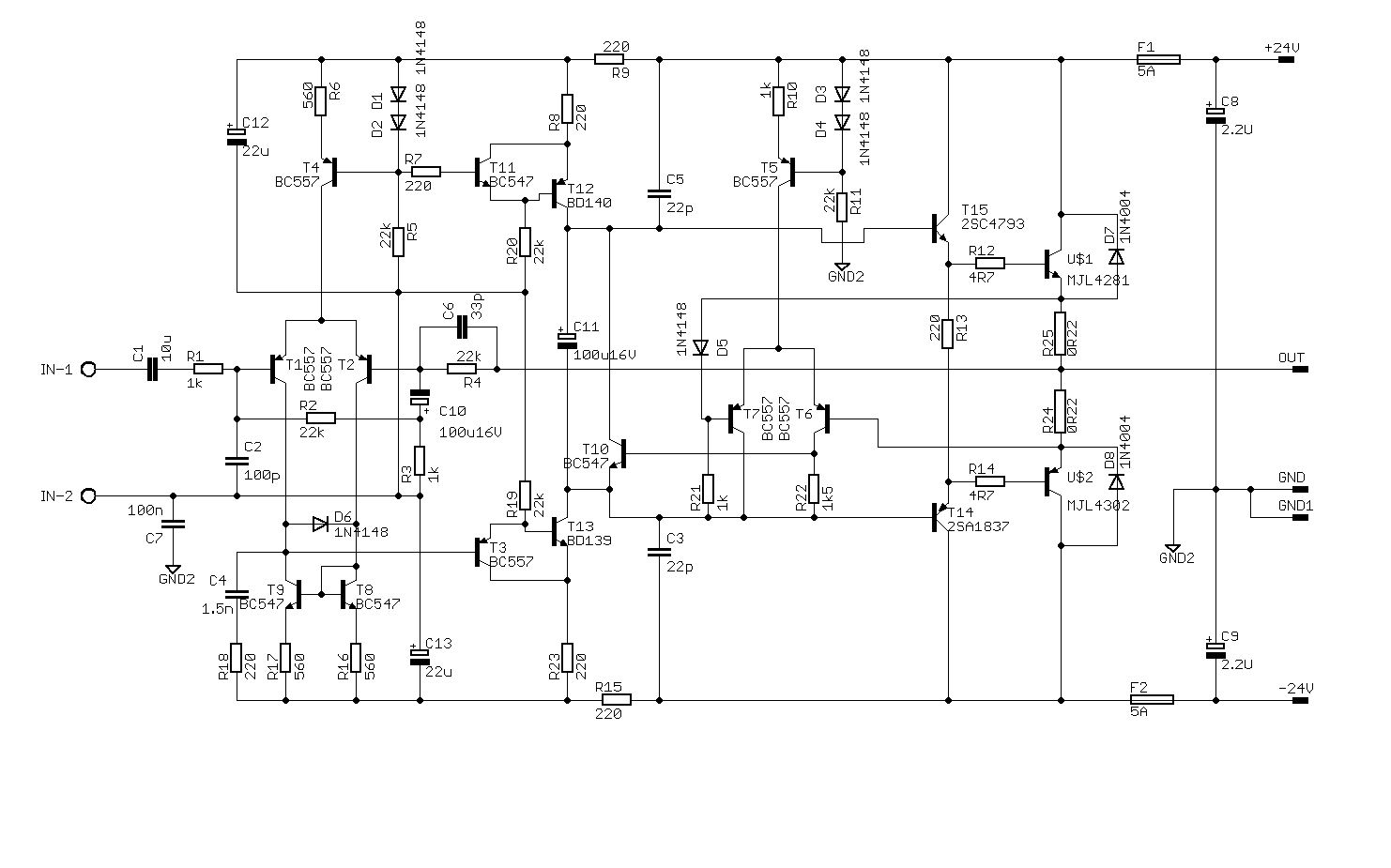

Mr. Mile, I know you are a busy person handling so many threads and requests by builders, but a small request; Could you kindly take look at AA14 sch and layout ? and subsequent comment by andrew T?. My laptop's burnt, I will rework AA14 whenever its repaired... Post no. 9423 and 9424.

Input GND on AA14 must be connect to power GND from input therminal... like on AX14.

I've been reading this thread with huge interest but I lost myself in all the different versions of the amps posted.
I suppose there is a logic in the naming of the versions:
AX14
AX17
A30
AA9
AA14
Would anyone be so kind to explain the difference (AX for class AB, AA for class A, ...)?
AX14
AX17
A30
AA9
AA14
