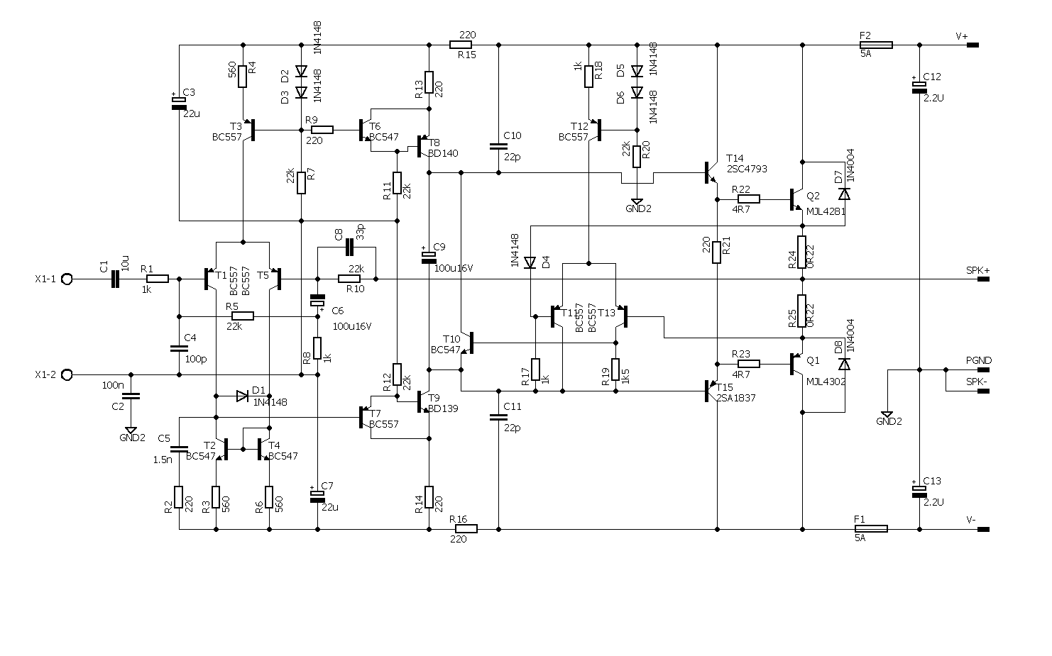

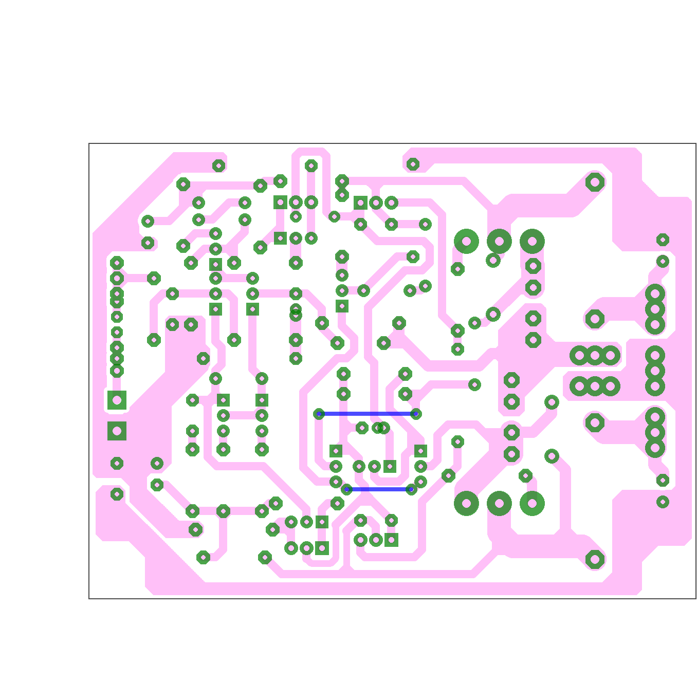

Apex AA14 just a quick draft as I had a moment today. not yet optimized, for comments. its late here, almost 1.00AM

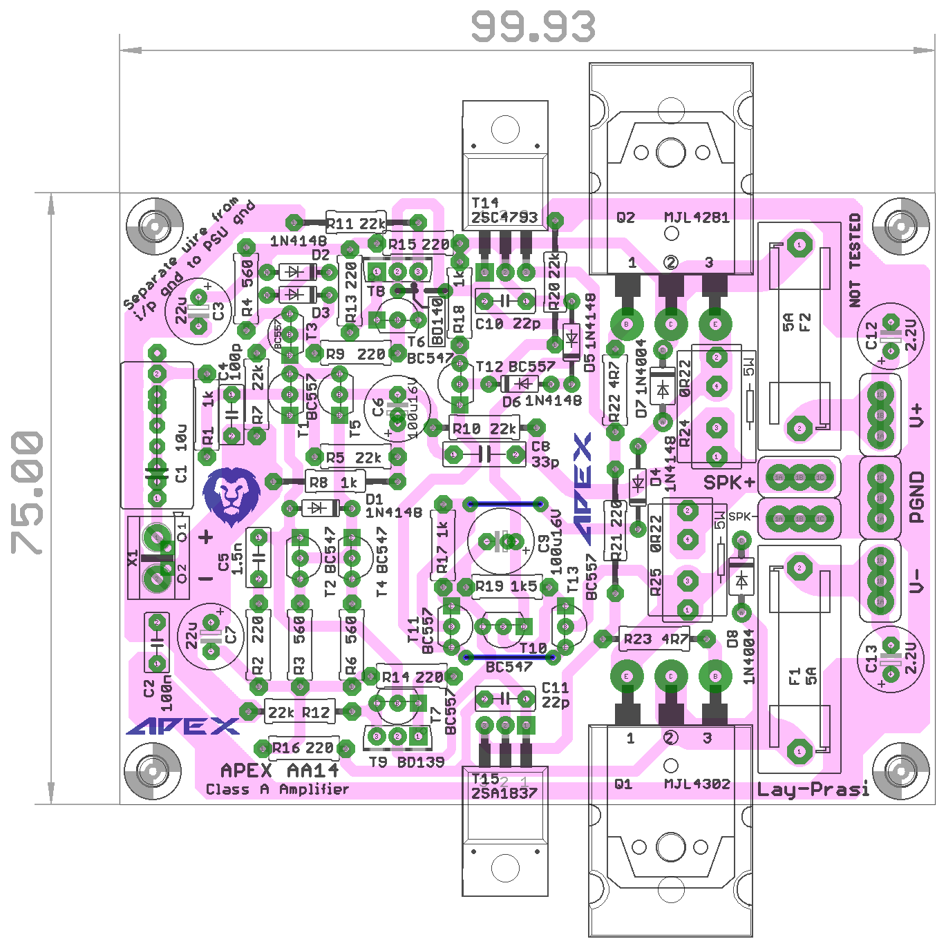

Here is a much more refined layout for AA14... 'Ultimate Fidelity' in Class-A?😀

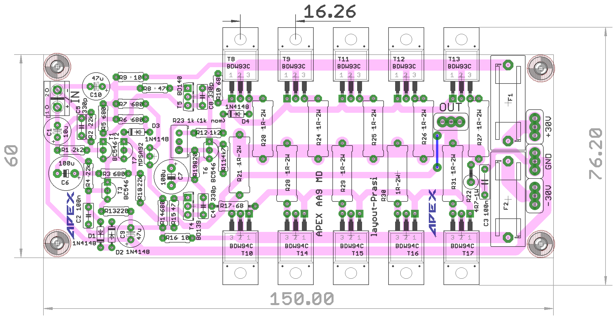

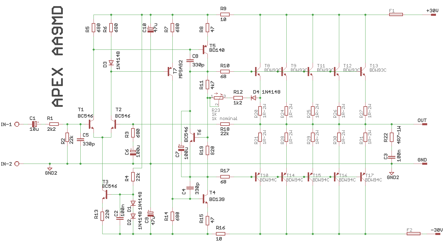

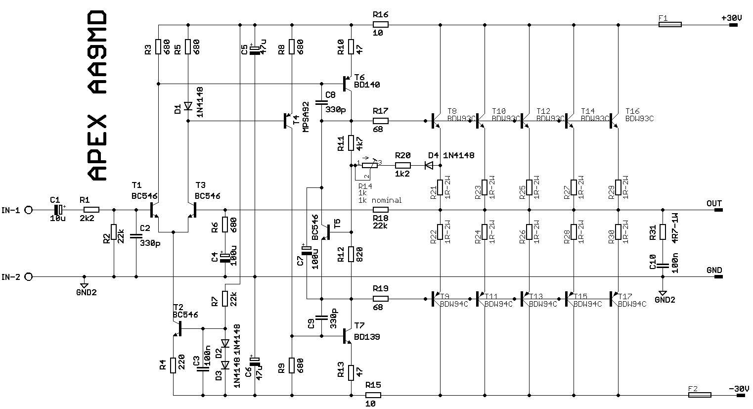

AA9 MD layout..
too late to edit, but here is the consideration.
I could have avoided the jumper for feedback but i want to take it right from the output connector...
Also it is possible to increase the distance between bdw's, but pcb would become too large...
also i kept the width of pcb as small as possible so that a 2U (ideal 3U and above) cabinet could be used to build the amp with adequate heat sinking..Pl confirm Mr. Mile..

Beautiful work there Prasi. 🙂
:cheers:
May we please have PDFs for home etching?
Thanks!
Thanks X. here are all the files and gerbers for APEX AA14 Class A Amp.

Here are the pdf files for AA9MD and gerbers.

Very nice layout, interesting schematic thank you!
My question do the power darlingtons need to matched (usually when we use multiple power semis need some matching)
If yes how we can do that?
If I do not find BDW darlingtons can I (we) use the more available TIP142 & 147 here in N. America
Thank you

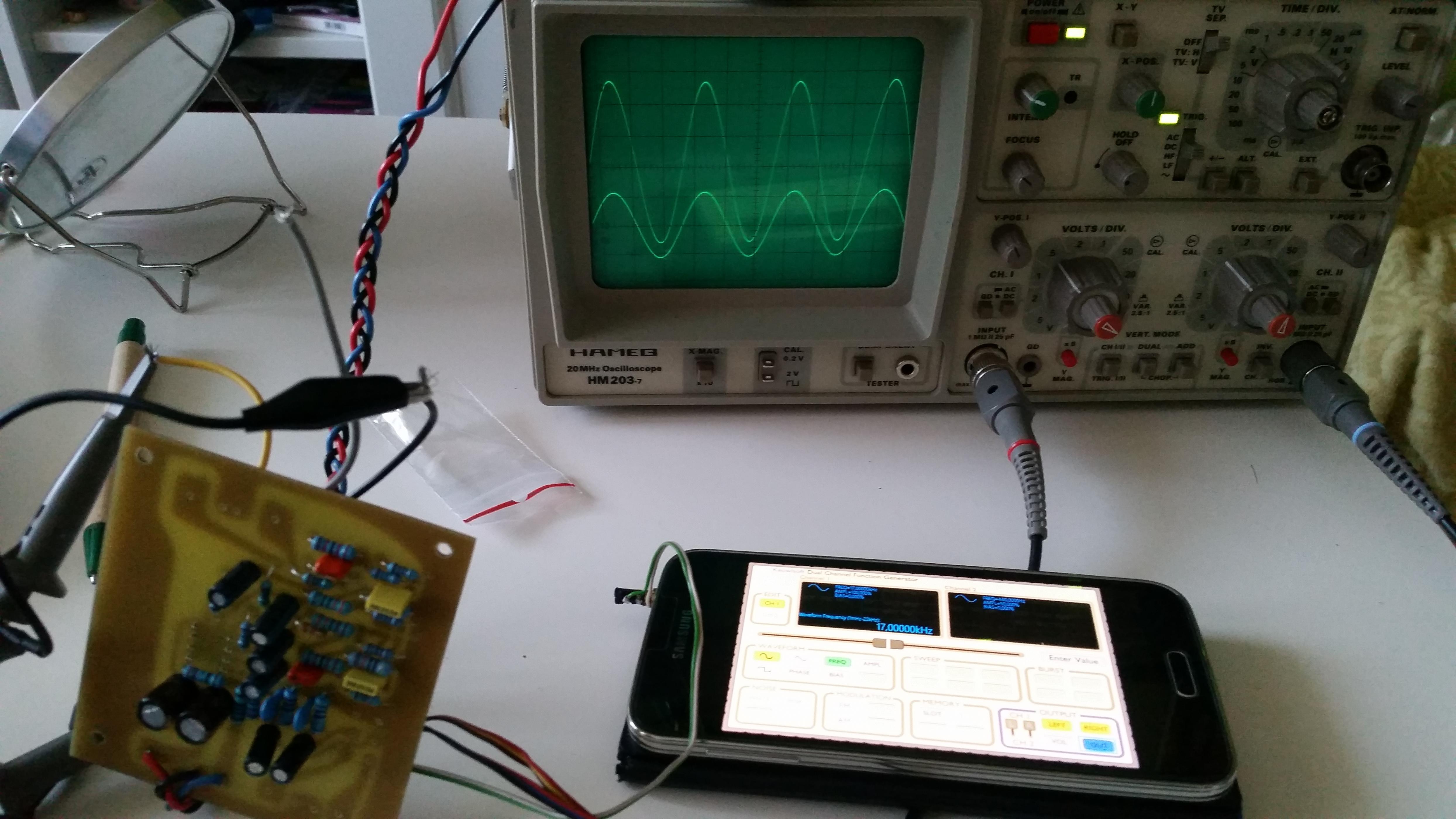

Apex TB1
I know I messed up a little with pcb, but Mr. Apex's TB1 works perfectly. Frequency from 5Hz up to 17kHz with absolutely no distortion, perfect sine. I don't have a proper signal generator, so I use my phone as it. All wirings are temporary. I'll post again when I connect it properly.

Hi Gabor,
AA9MD has the same sch as AA9 posted few posts ago except for o/p stage. And AA9 has TIP142,147 as o/p .
You could take a look at that.
Also BDW are available in mouser.
Although Mr. Mile can answer, but I think his ckts rarely call for matched transistors especially o/p.
The large emitter resistors would also help in this regard.
An eBay transistor testing ckt might work, although to be honest I have not tested a Darlington transistor on it.

Nice work, did you use loudness switch?
