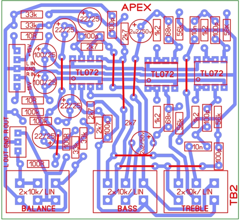

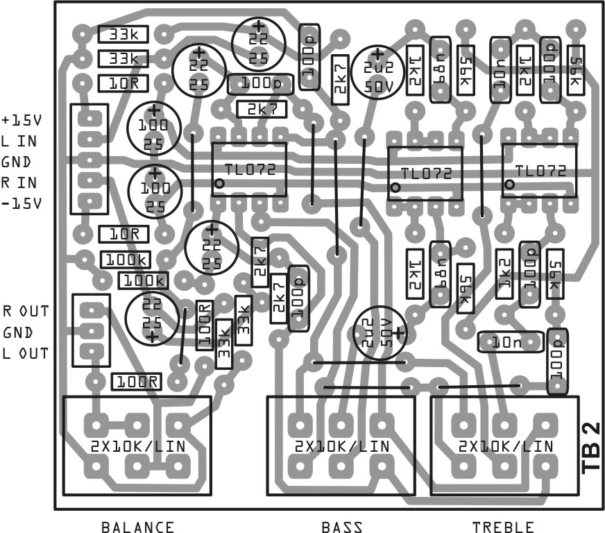

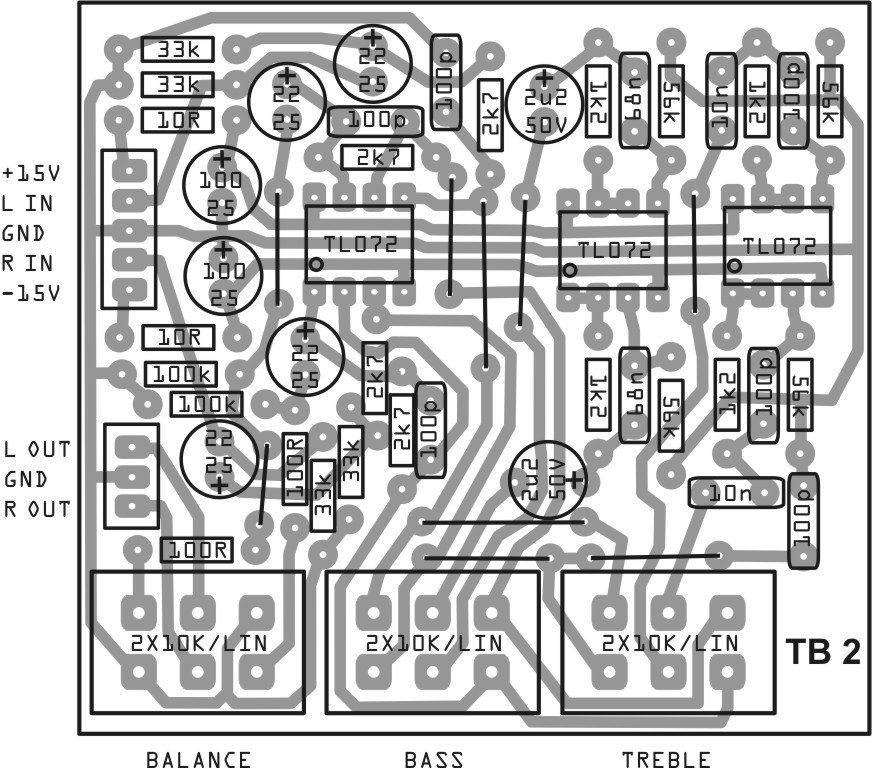

For who want here is the pcb for TB1 not so professional this is my first pcb copy. If i do any mistake please corect me.

On TL072 pin 1 is not connected...
Thank you sir I will corect that.
Sir do you have the pcb for TB2
Use this TB2 pcb design.

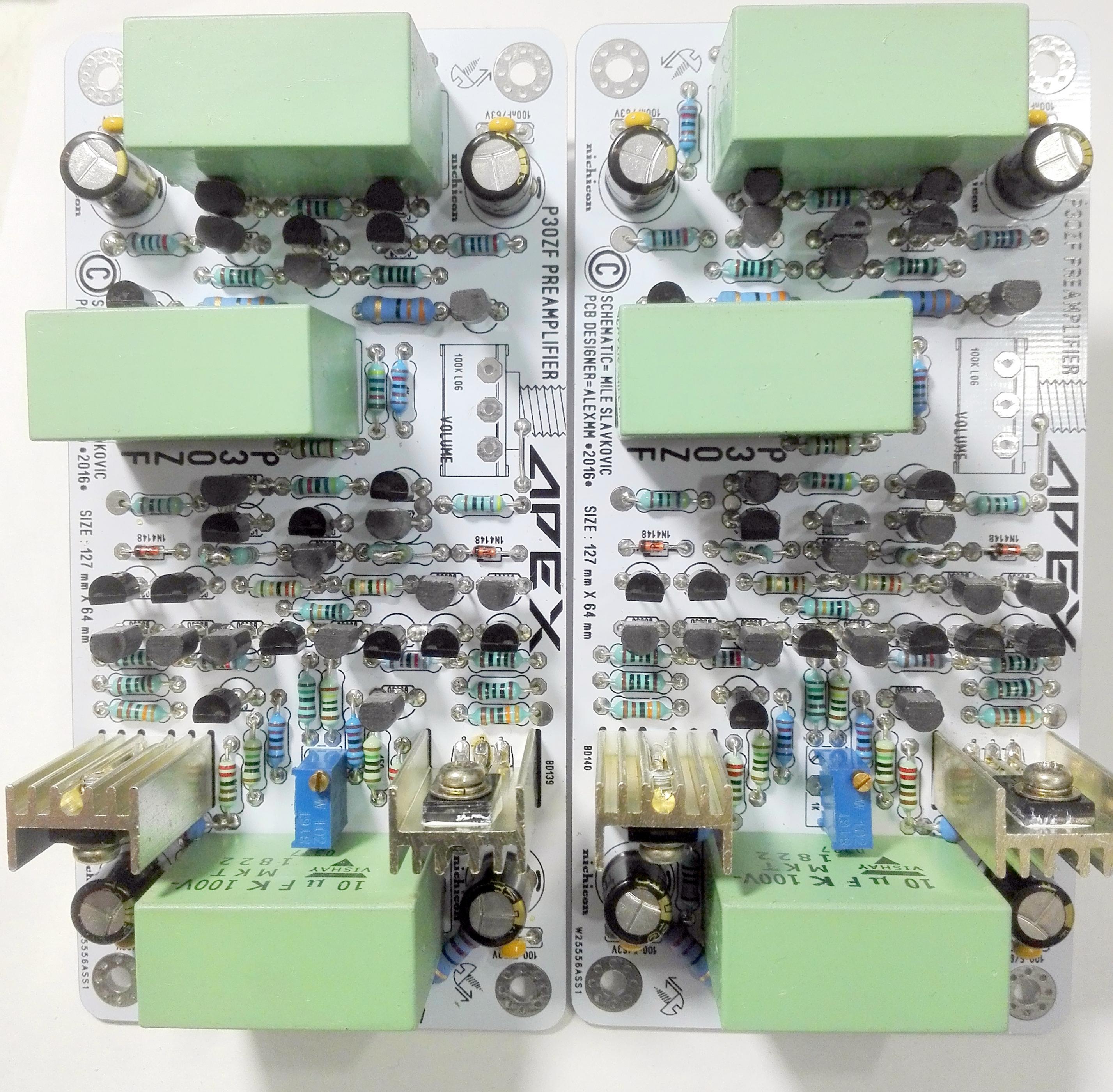

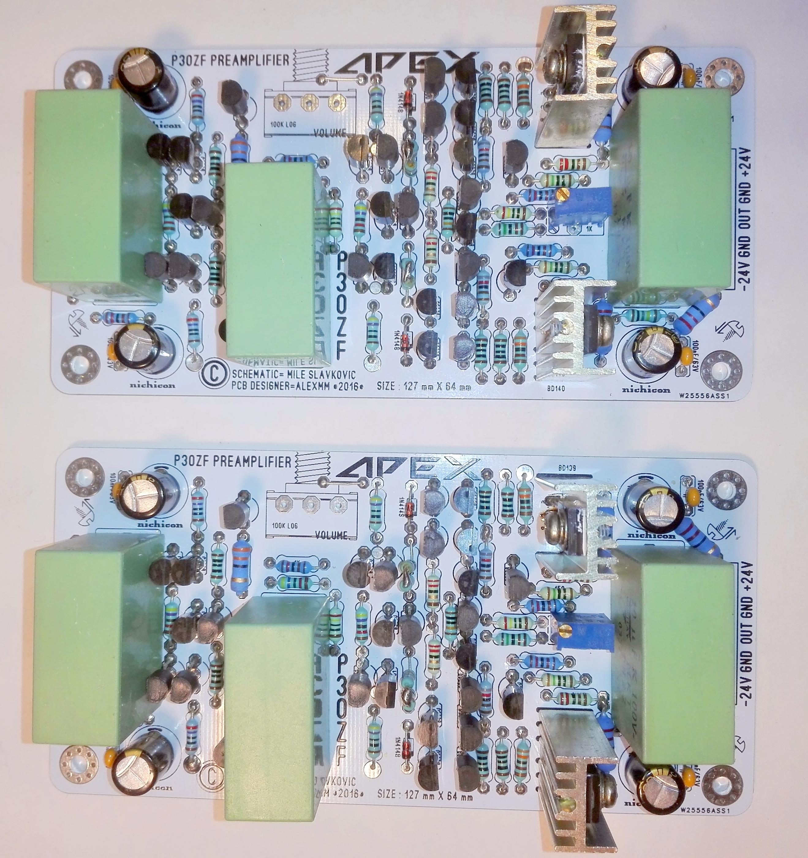

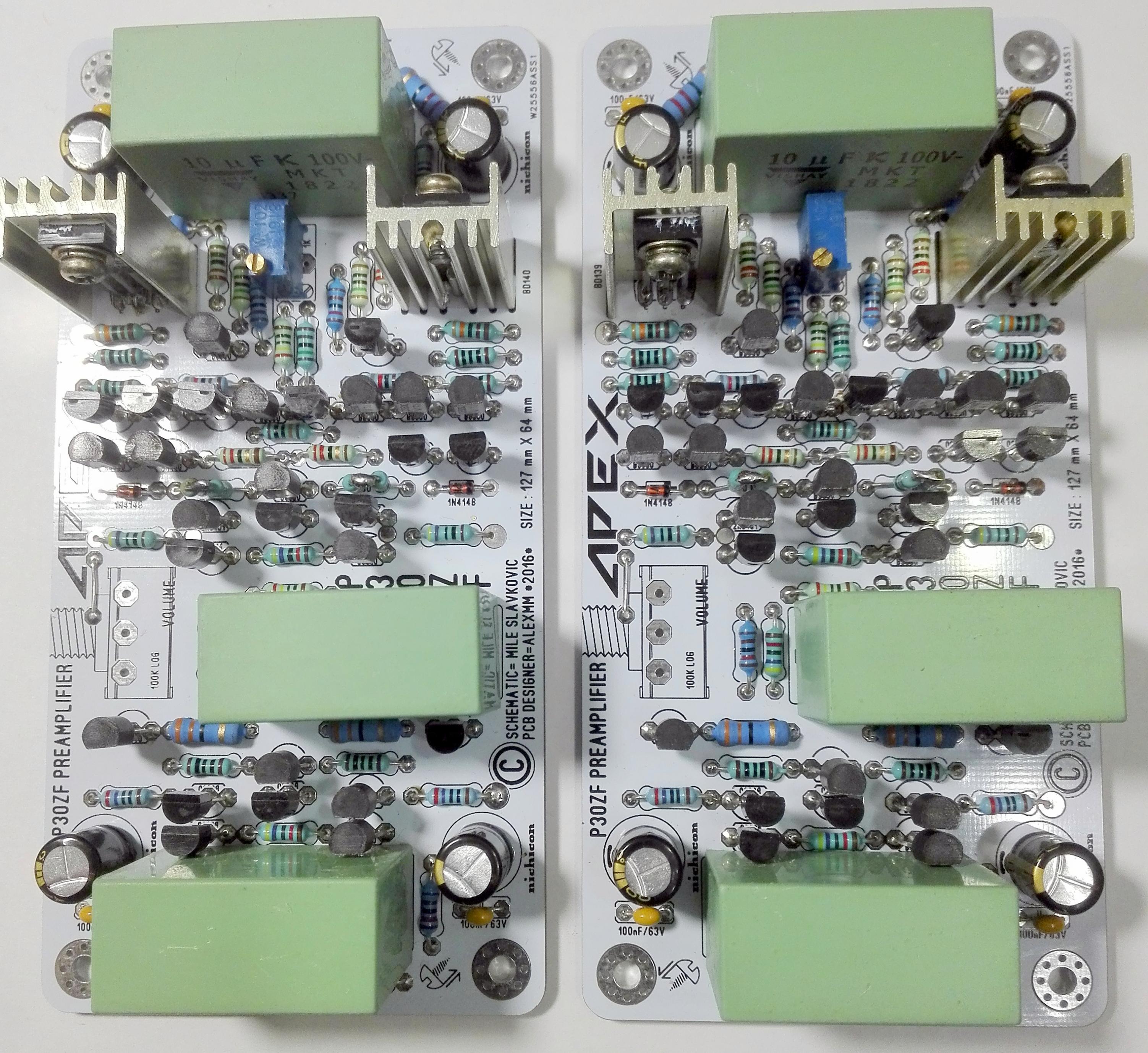

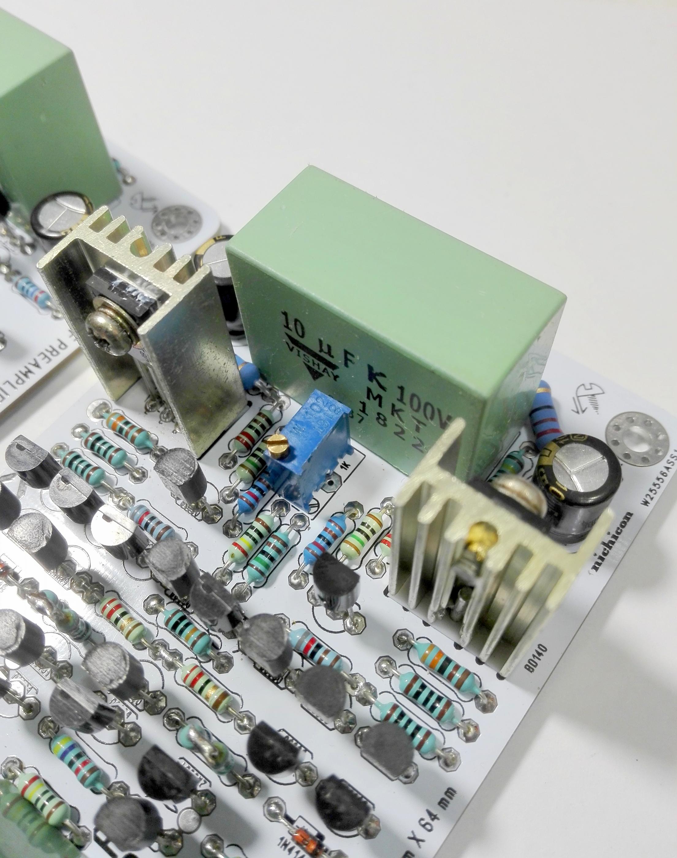

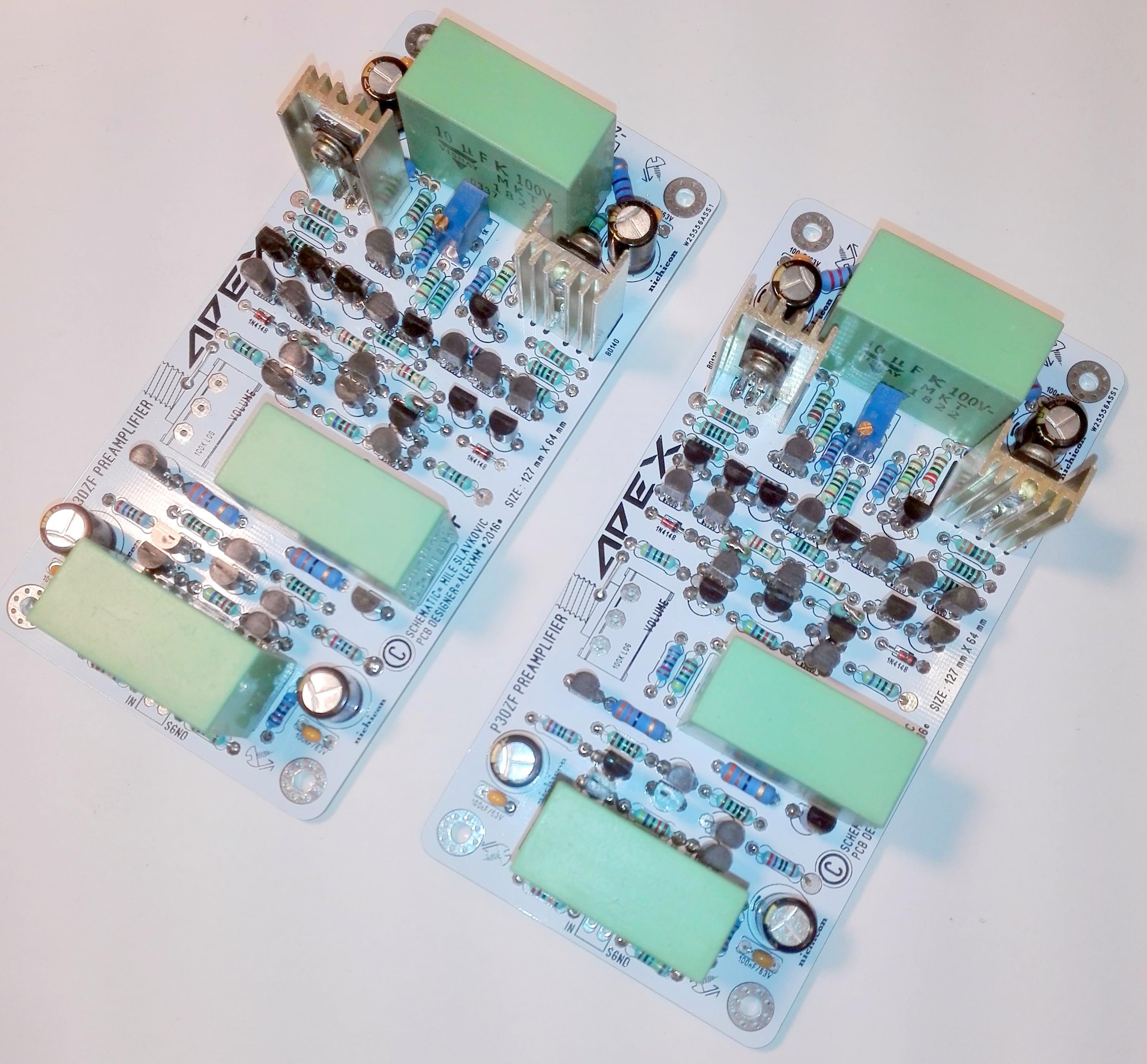

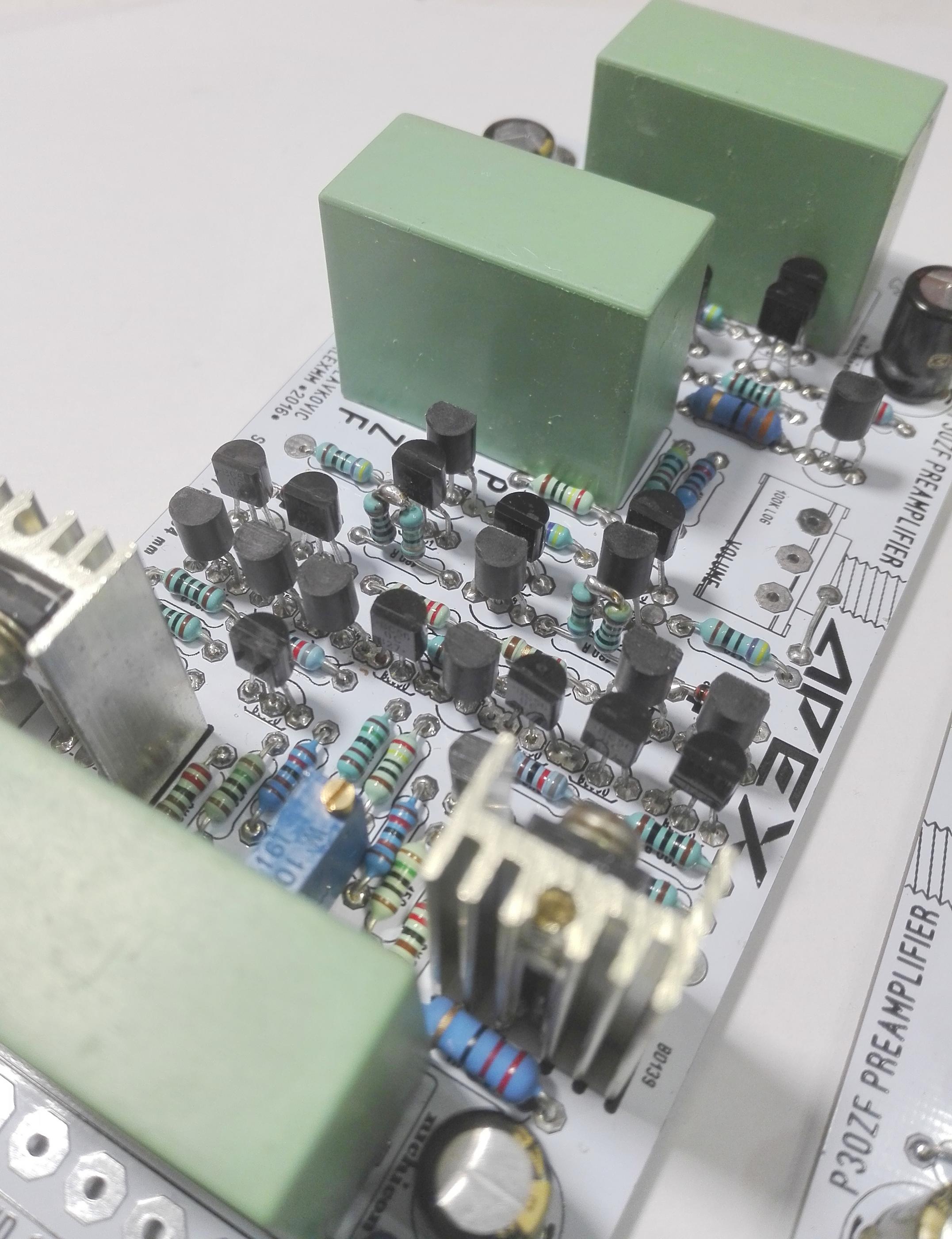

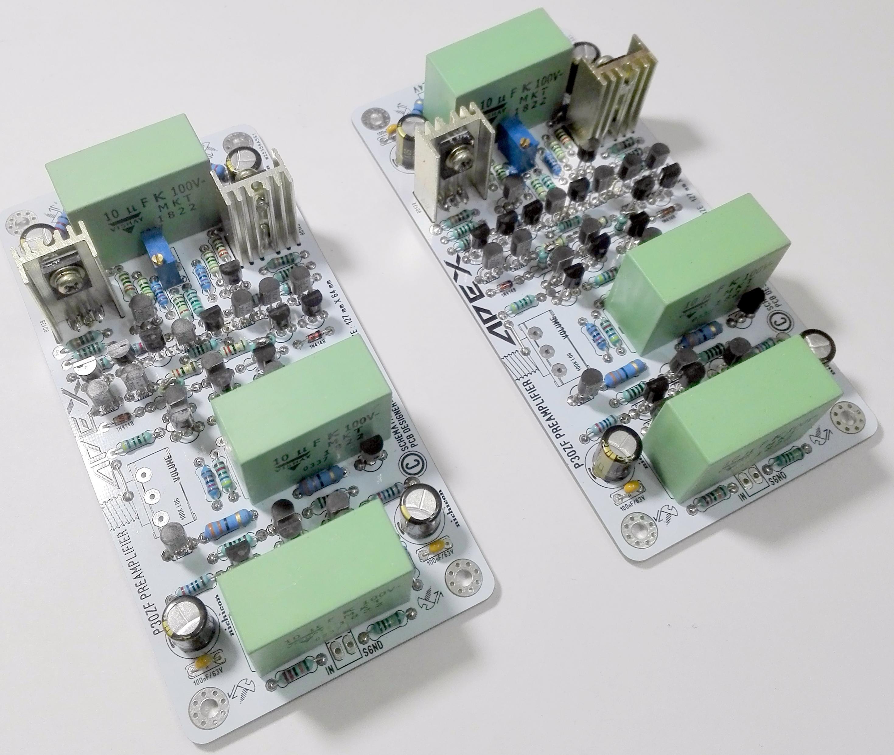

P30ZF preamplifier ...... ready for testing !
Regards,Alex

Nice work!
Let us know how it sounds!

Nice work, olaf test P20 with same zero feedback topology and this will be first P30ZF test.
Regards

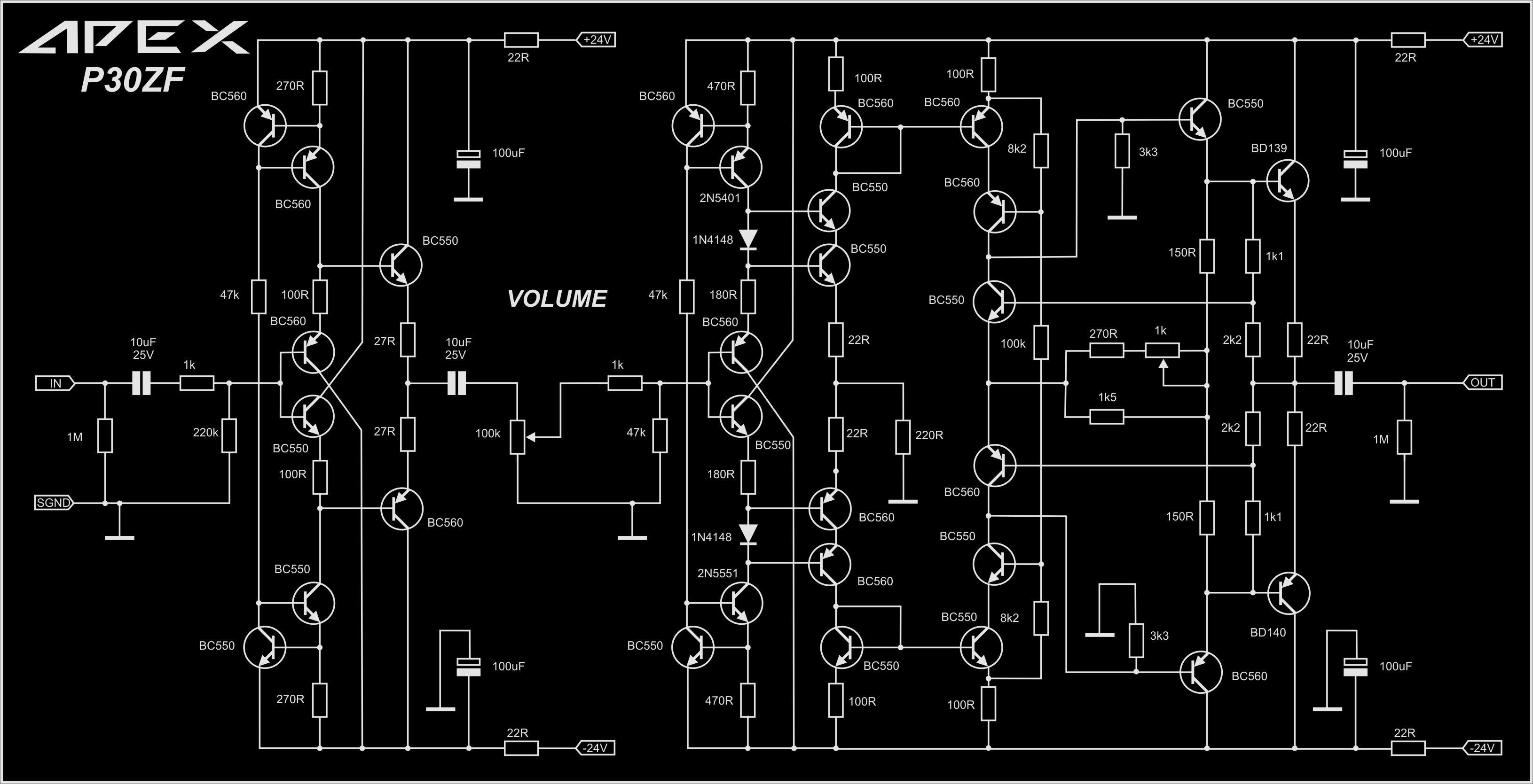

Dear Alex,
Can you kindly post the schematics also?
--gannaji.
Schematic P30ZF
Schematic right here 😉
Dear Alex,
--gannaji.

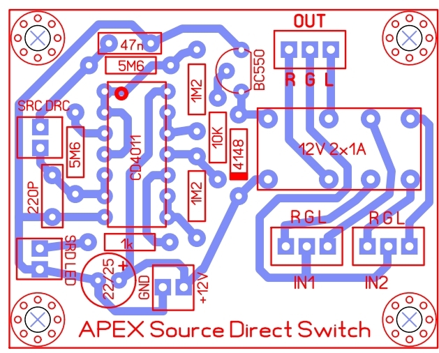

I made TB-2 layout (Apex clone) in sprint in case anyone wants it. checked it, its fine.
Thank you Prasi you save me. I work two days on that pcb but nothig good. I don`t have so much talent. You pcb looks great.
Do you can make a copy of these pcb`s if you have some time free?
Thanks in advance!
Thanks in advance!
Its very easy to make clone in sprint. Go to extras-Scanned Copy.
Then select the image of the PCB.
Then simply make tracks on appropriate layer (silk on S1, copper on C2, outline on O, etc)
I have attached, both TB2 and source direct switch. you can make TB1 following above procedure.
