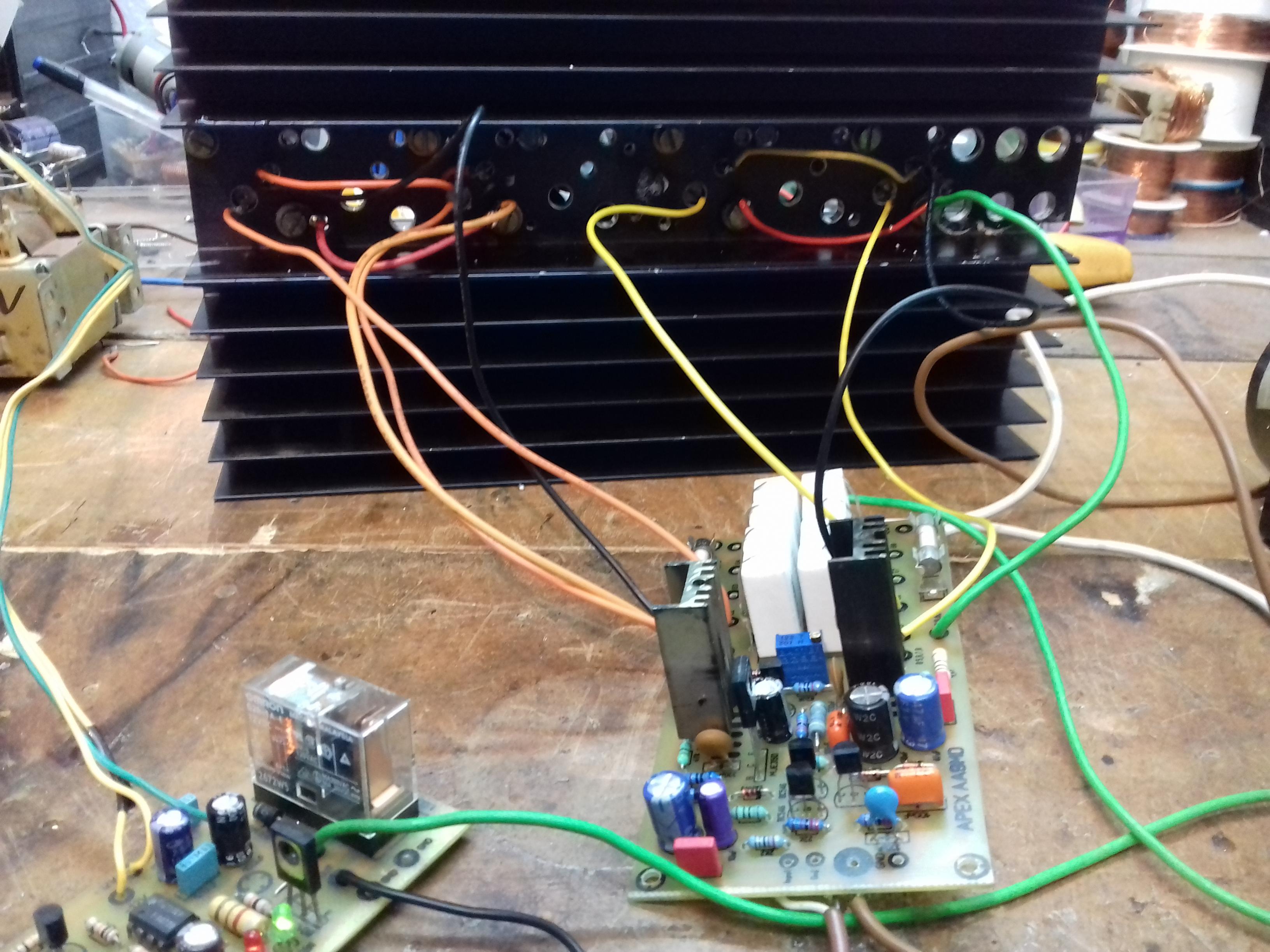

AA9MD tested
Nice! How does it sound?
It is not my work, 'sound very nice...' is answer.
AA9MD 1,2A bias 56 deg on heatsink +/-30V rail 15V RMS output (50W/4R)
https://www.youtube.com/watch?v=UFtUSWniSPE
why 3 to-126 devices? i see only 2 to-126 devices on your original sch...with which i made a layout.
if the sch is revised with new devices, pl post here Mr. Mile.
It is not my work, MJE350 is used instead MPSA92 this is not my suggest.
