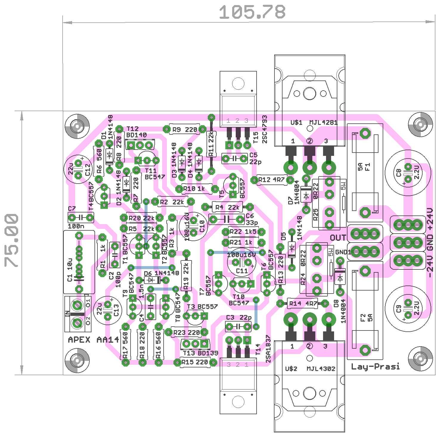

attached is the pdf looking from component side and also the gerbers...
Also how low can be go with values of C4 and C8 and also the i/p filter?
Apex AA14 just a quick draft as I had a moment today. not yet optimized, for comments. its late here, almost 1.00AM

Yep. I thought so too... But since APEX sch called for that, I made the layout accordingly.
Mr. Mile can only clarify.

I am waiting for Mr. Mile to have a relook at his sch again because of the concerns raised by AndrewT.
Once my Laptop is back I can rework to improve it.

Mr. Mile, I know you are a busy person handling so many threads and requests by builders, but a small request; Could you kindly take look at AA14 sch and layout ? and subsequent comment by andrew T?. My laptop's burnt, I will rework AA14 whenever its repaired... Post no. 9423 and 9424.

Input GND on AA14 must be connect to power GND from input therminal... like on AX14.
