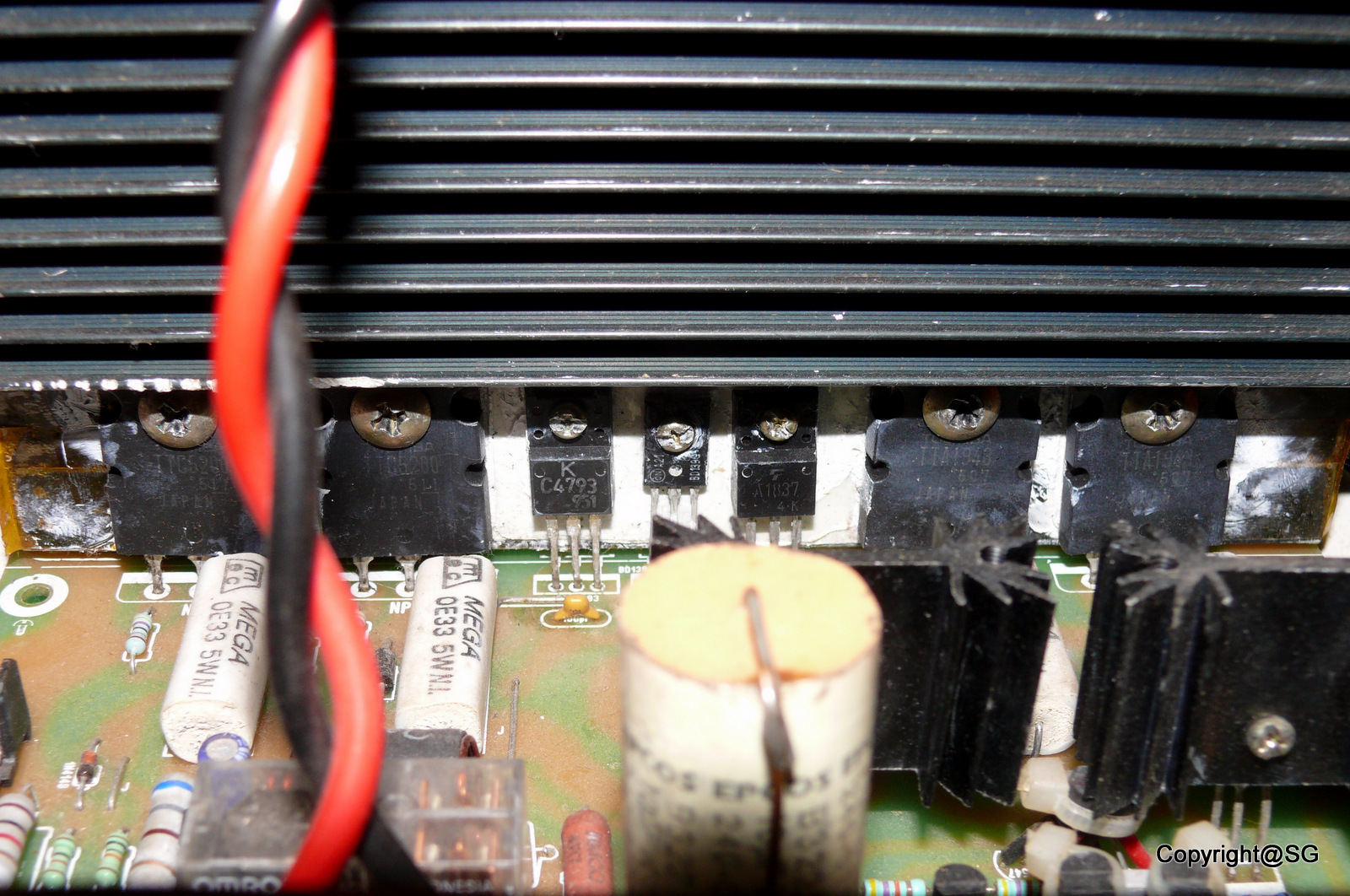

Just wanted to update on the thermal coupling, As per suggestions I changed the coupling devices and have had it now for 4 days.
The Offset has come down by a wee bit,It now stands at -2.5mv (earlier -2.8 to -3mv) on one channel and -1.8mv (earlier 2.2 to 2.4mv) on the other.
Also one thing I have noticed over the period of a month or so since the Amp was built and was to put to play,The Bias keeps decreasing.
I had kept the bias approx 81ma (27mv) and it keeps dropping to 25-26mv,I have set it multiple times but it still continues to drop,Is it normal ??

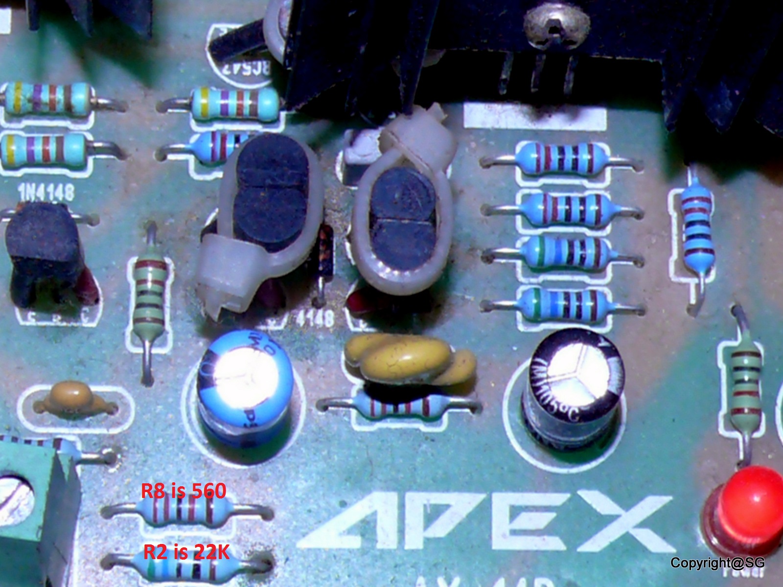

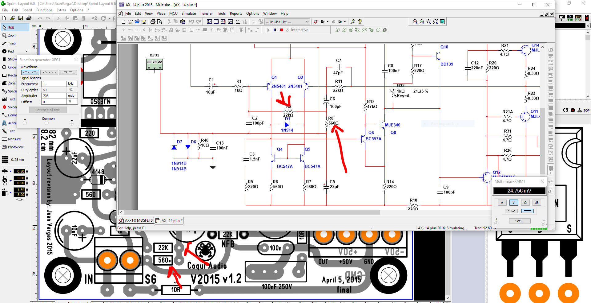

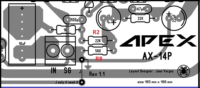

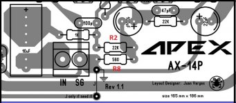

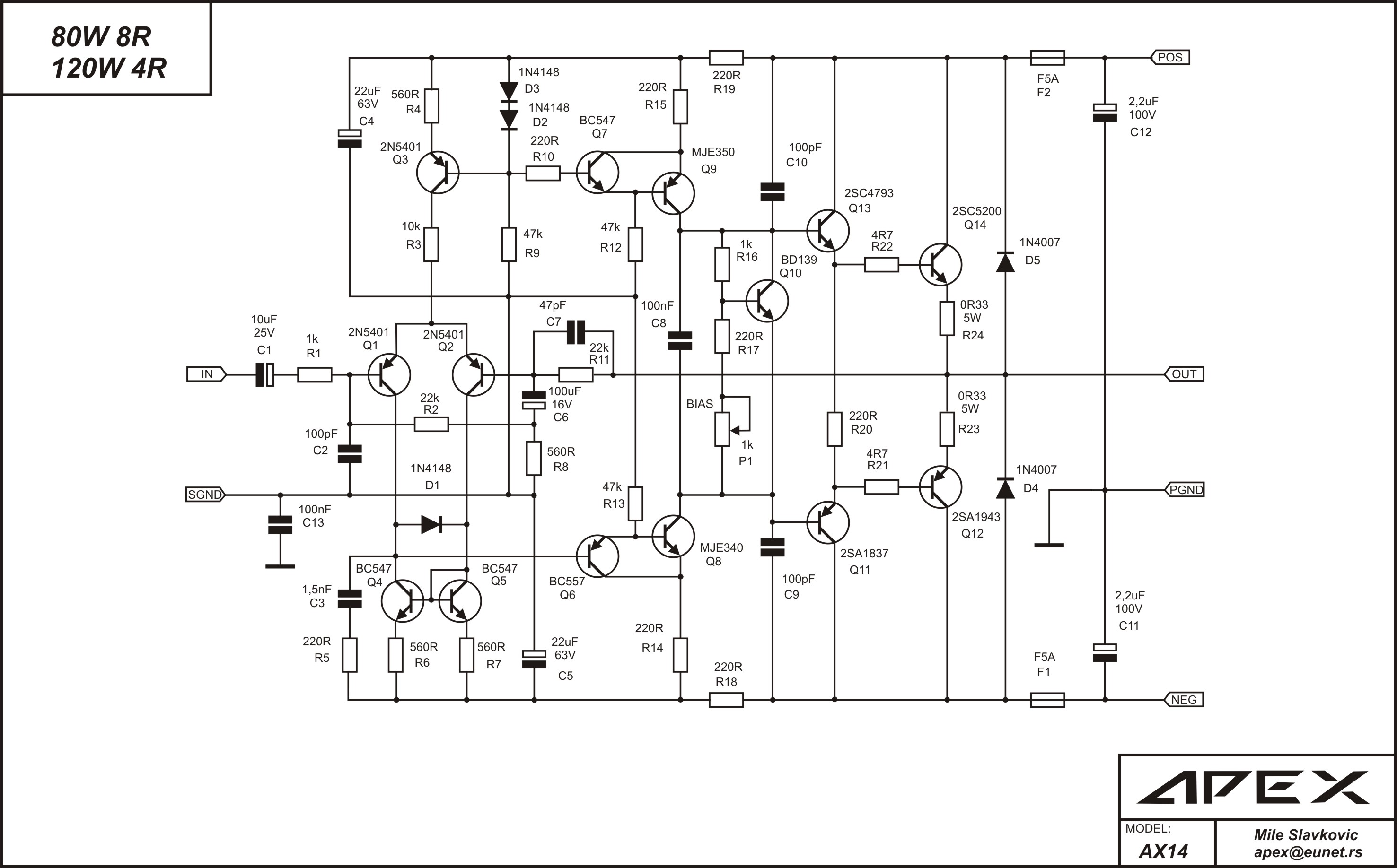

R2 and R8 are reversed that is my fault sir I guess I was fallowing the older AX-14 schematic later on they fixed on other post number and that was a long time ago, change R2 to 22k and R8 to 560 ohms you will notice you will get more power sorry for my mistake sir

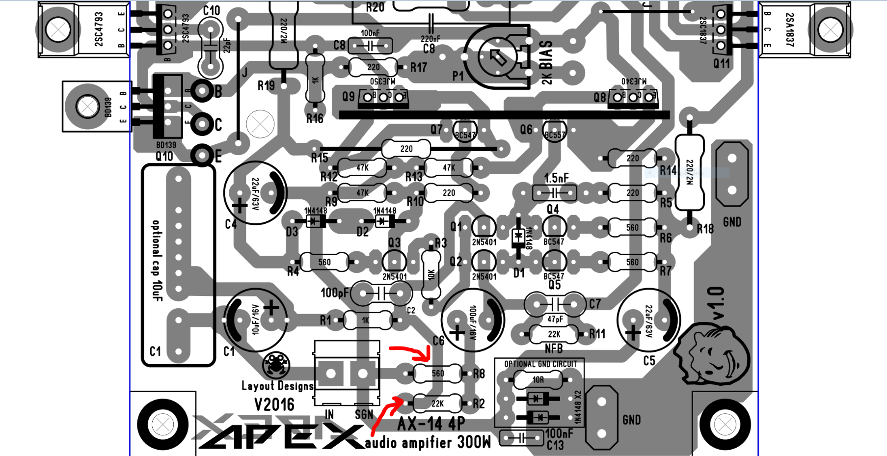

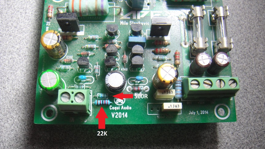

I doubt that juan, I checked and double checked it's correct on the PCB,as its in the circuit you posted above. I have even checked Willys and other as well,R2 22K goes neagtive pin of C6 after R1 1K and R8 560R goes to negative pin of C6 from signal ground.

question sir does Q10 BD139 well attached to main heat sink ? I mean nicely secure with insulation and thermal compound
errata yes sir you were right I did changed and it was correct before I made a mistake I apologize

yes because BD139 track temperature and according to heat sink temperature it will have and internal resistance that will fluctuate giving different bias results
That's the very reason I asked the question,I will in some time change the heatsink to a bigger one and then see how it goes.

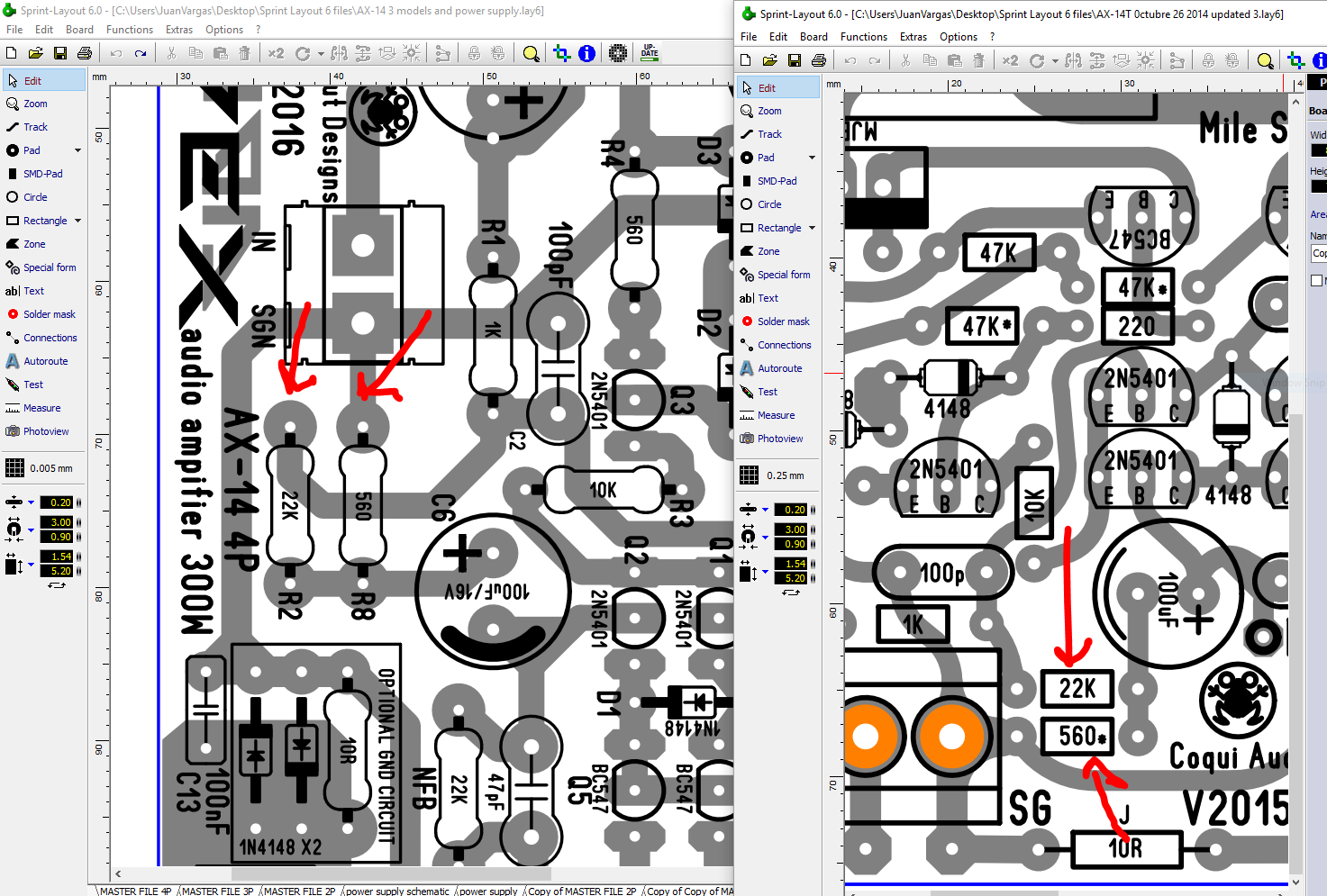

I see what was my confusion when I re-draw the layout the 22K and 560 ohms I change position from the first PCB I order in 2014 to the new layout I'm doing now oh lord jejejejeejejeje :faint: ufff man I have a short circuit in my brain 😛

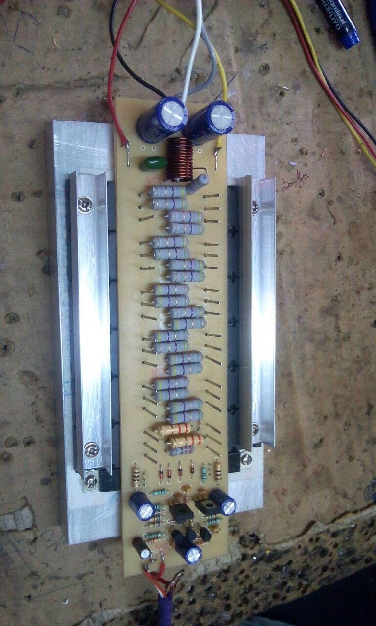

Change(s) for 12V Output.

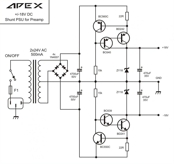

I'm wanting to try Mr. Mile's simple shunt supply for my op-amp based preamp. Terry was nice enough to share his layout with me.
Are the 2 zener diodes all that need to be changed so it will output 12V instead of 18V?
I'll be using BC550/560 and A992/C1845 for the TO-92 transistors and BD241/242 for the larger transistors.
I am not familiar with shunt supplies having used only LM317/337 supplies, so I have a couple more questions:
1) Will the BD devices get really hot powering 3 op-amps like the NE5534?
2) Is it true you have to have a load on a shunt supply or it will get very hot?
3) What wattage zeners will I need?

1W 12V zener diodes is all that need to be changed so it will output 12V instead of 18V.
Load with 3 op-amps or without load BD will have same themperature.
