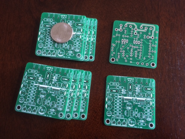

FX8 Boards Arrived
It took a while but the micro 50mm x 50mm FX8 boards arrived. It is tiny!
Thanks to Apex and all the folks who designed and tweaked the PCB. I am still waiting for the BOM to arrive from the slow boat from China.
Looking forward to this build though. Looks like it will go fast given the simplicity of the design and small form factor.

thats compact!. smaller than most chip amp pcbs😀

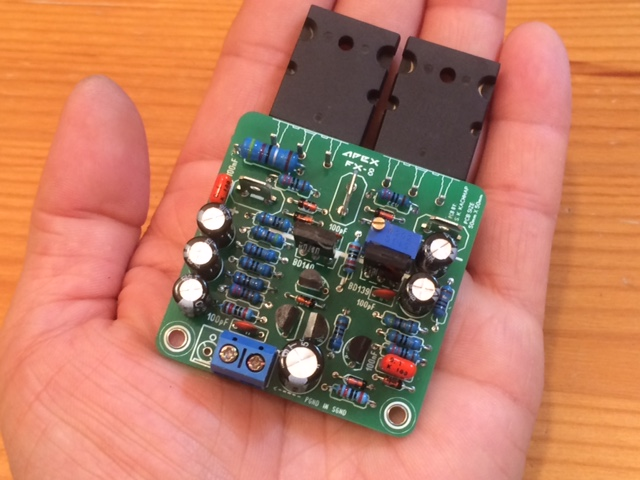

Would FX8 work with swapped in BJT's?
This amp is super easy to build - went together faster than any amp I have built. I am still waiting for the output stages but have some 2SC5200/2SCA1943's slipped in their place to get a feel how big this amp is. It is small! Smaller than a typical TPA311x class D amp.
I am a bit impatient waiting for the MOSFETs to get here...
Is there anyway this amp can work with BJT's rather than MOSFETs? What would happen if I powered this up with the PNP on left and NPN on right.
The MOSFETs are G - S - D and the BJTs are B - C - E.
Would it be PNP on left and NPN on right given Vcc(+) is on left and negative is on right side.
