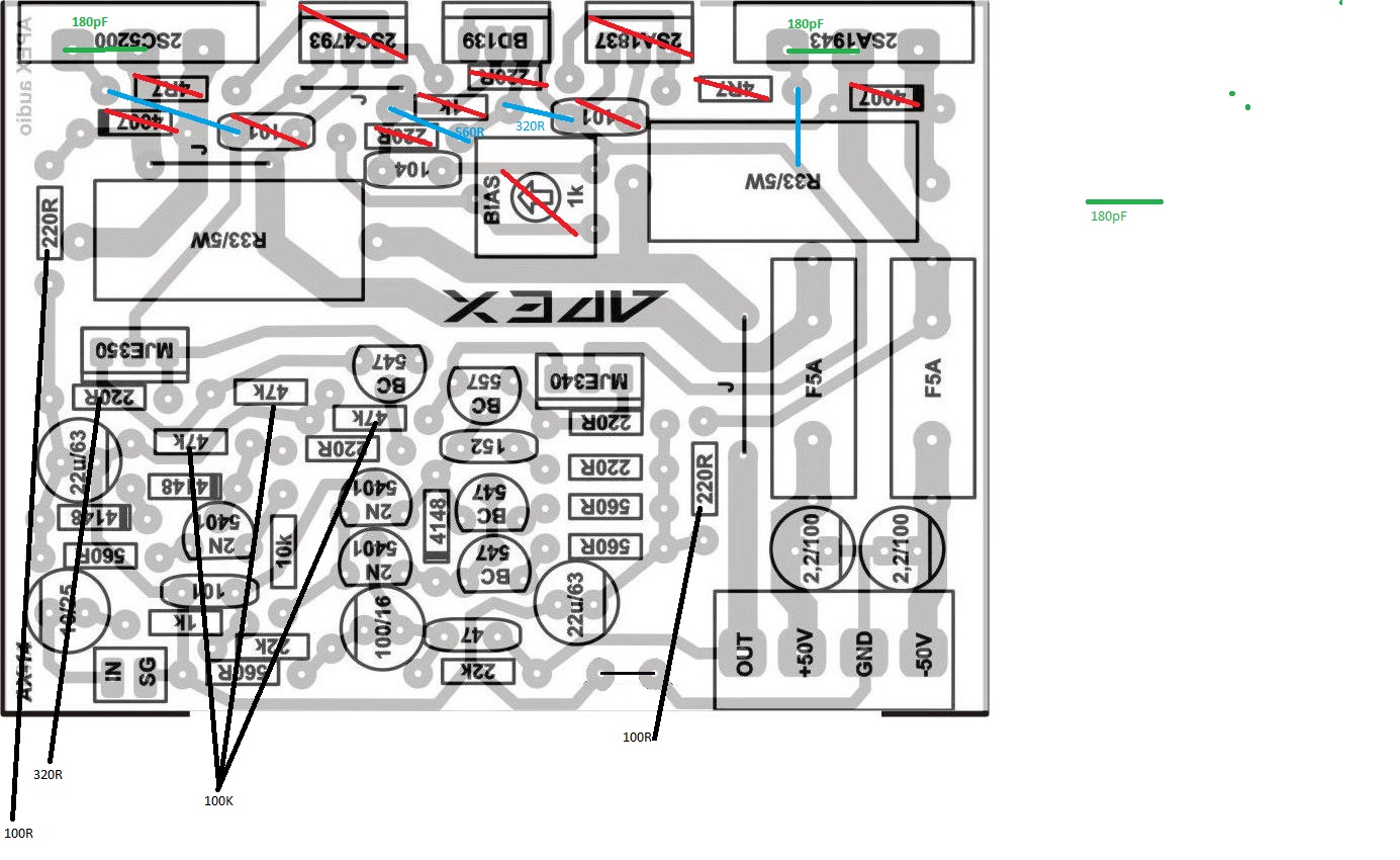

Nice work, if you want use 2SC5200/2SA1943 go to AX10.This amp is super easy to build - went together faster than any amp I have built. I am still waiting for the output stages but have some 2SC5200/2SCA1943's slipped in their place to get a feel how big this amp is. It is small! Smaller than a typical TPA311x class D amp.
I am a bit impatient waiting for the MOSFETs to get here...
Is there anyway this amp can work with BJT's rather than MOSFETs? What would happen if I powered this up with the PNP on left and NPN on right.

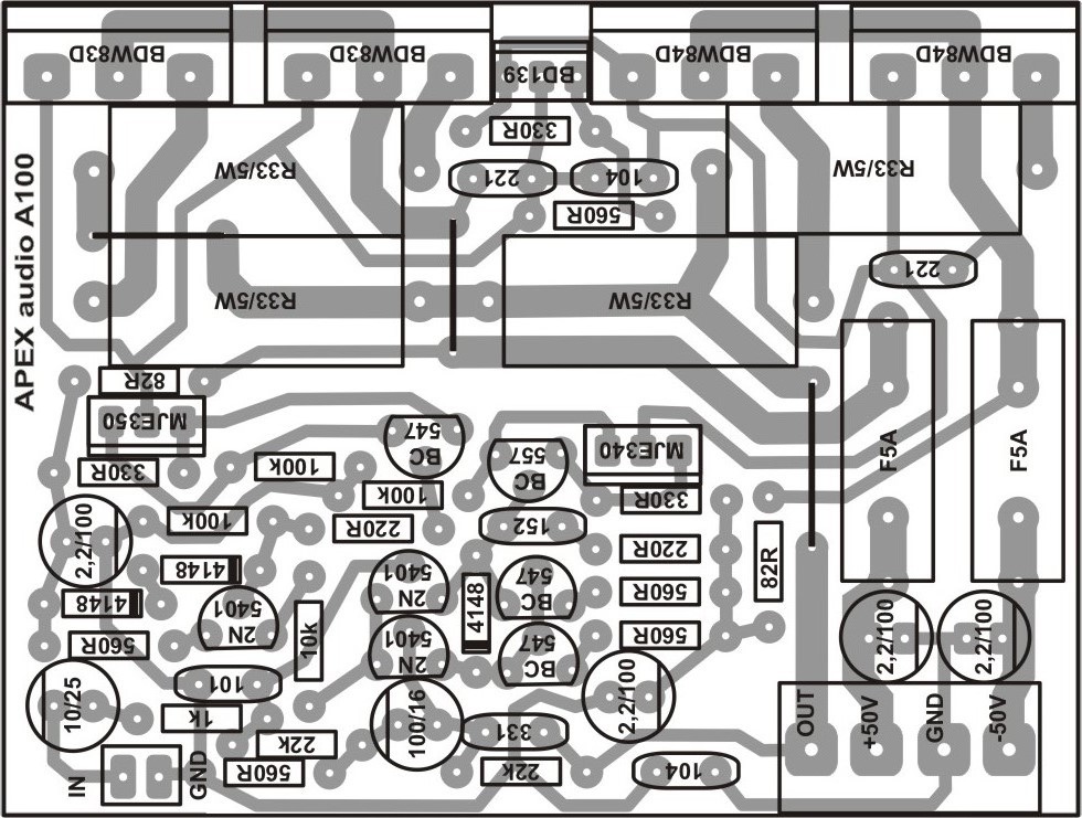

Apex i use PCB from AX14 to A100
2SD2389/2SB1559
And have DC in out... (43V DC)
If fast on-off trafo there is sound distorted ~ 2 second and quiet
0.33R - 1mV
Connected like that...
2SD2389/2SB1559
0.33R - 1mV

Please make sure that SG is connected to the main star GND point in PSU. For a quick test You can connect SG to the GND on the amplifier board.

DC problem gone i put 32R about 320R to MJE350 😉
Work good, I got the bass 🙂
0.33R - 0.8mV DC
Out - 3mv DC, 65mV AC
It's OK ??
0.33R - 0.8mV DC
It's OK ??
Apex A100 (AX14 PCB) 2SD2389/2SB1559 +/- 47V DC
