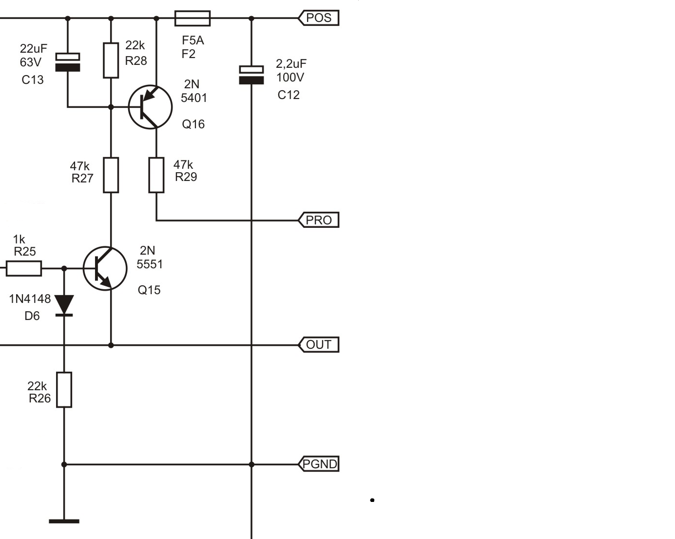

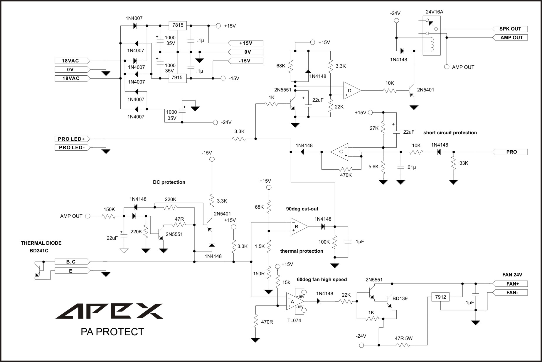

Apex i can use PA Protect for A100 ??
Some like a A33 - connect to emitter
And any sugestion for BD241 - i don't have :/

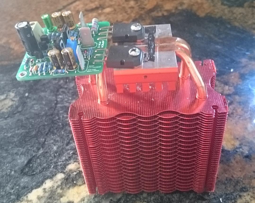

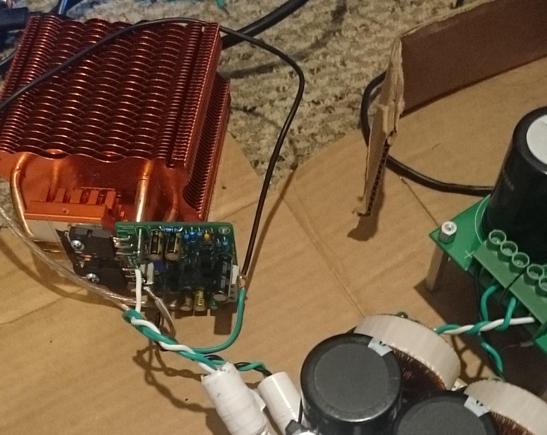

This amp is super easy to build - went together faster than any amp I have built. I am still waiting for the output stages but have some 2SC5200/2SCA1943's slipped in their place to get a feel how big this amp is. It is small! Smaller than a typical TPA311x class D amp.
Since I don't have the latFETs in hand yet, a good friend of mine who does have them just built the FX8 with boards I gave him and it works well I am told. My Hitachi latFETs should be here in a few more days. In the meantime here are some images of his build. Anyhow, it can now be confirmed that the 5cmx5cm FX8 PCB works.
Using CPU heatpipe heatsink:
With 32v rail supply:

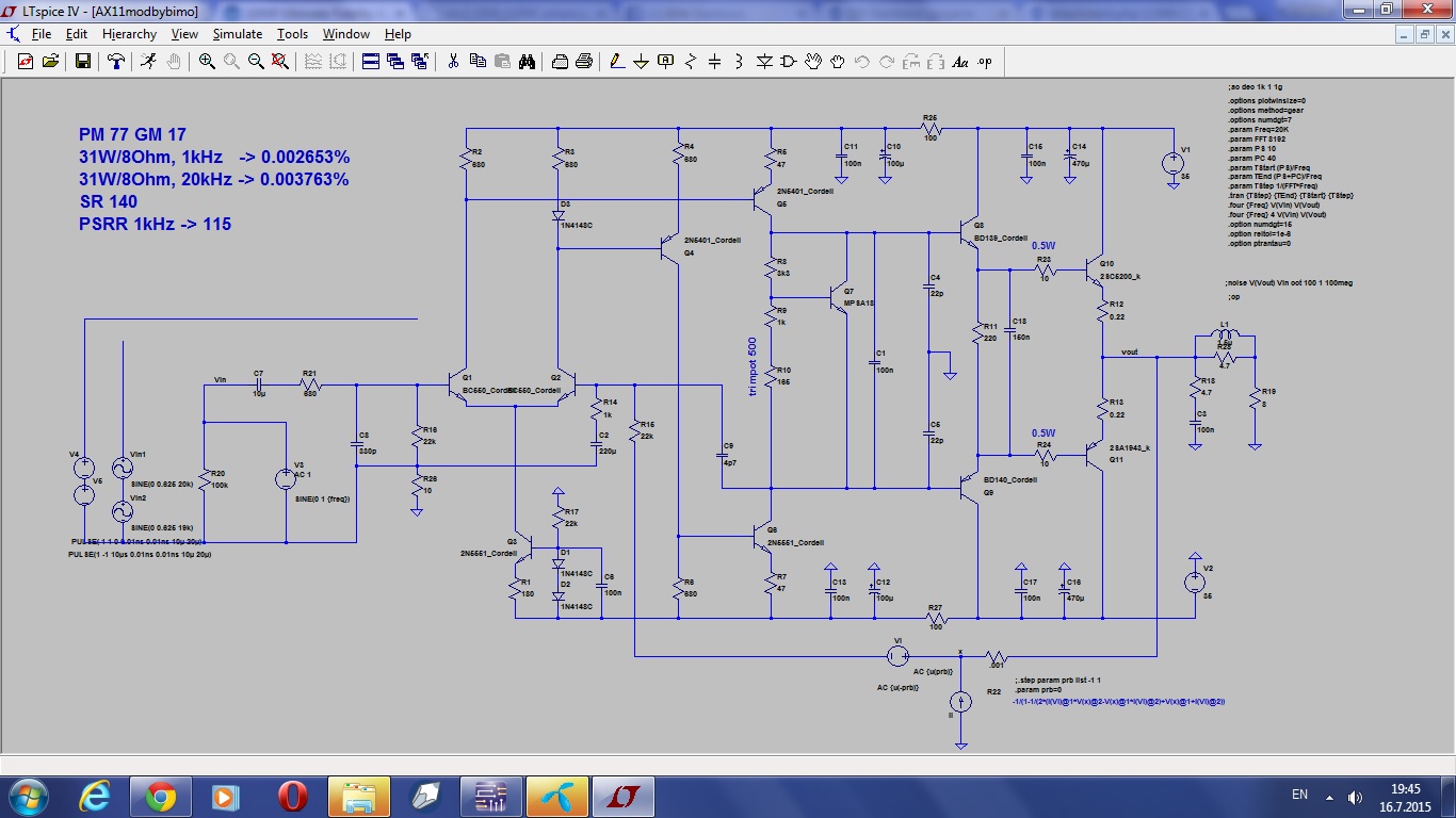

FX8 mod
As I know bimo made some modification on AX11. Ivanlukic wrote "Bimo's De Luxe version of AX11.
I changed the values of few components. PCB design is original Anistardi's. This is the best version
of AX11. Highly recommended!" The modified circuit shows pretty impressive result, see the picture above:

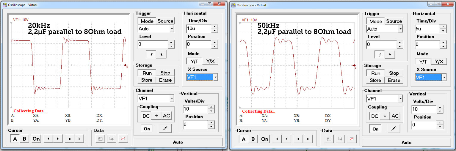

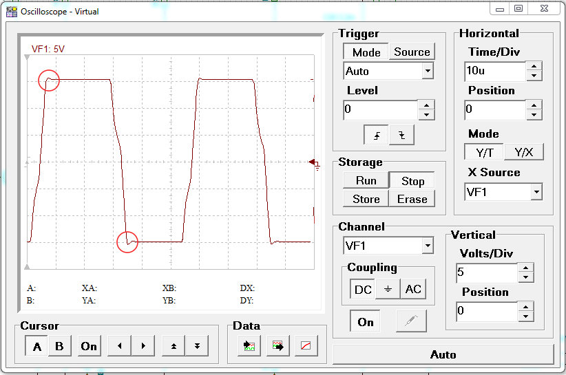

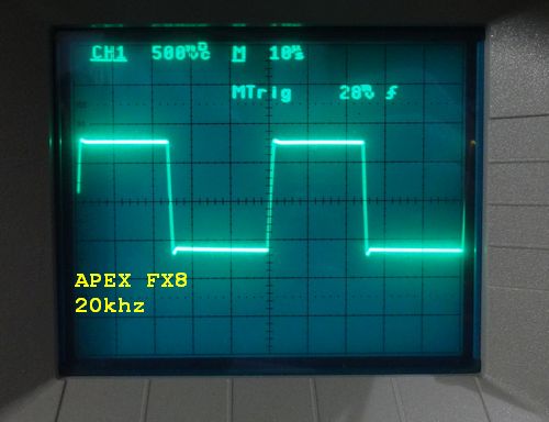

I'm really curious how this mod will work for FX8. The basic simulation of FX8 clearly indicates the overshots
on the edge of squarewave what Terry measured earlier. So the problem comes not from the layout.

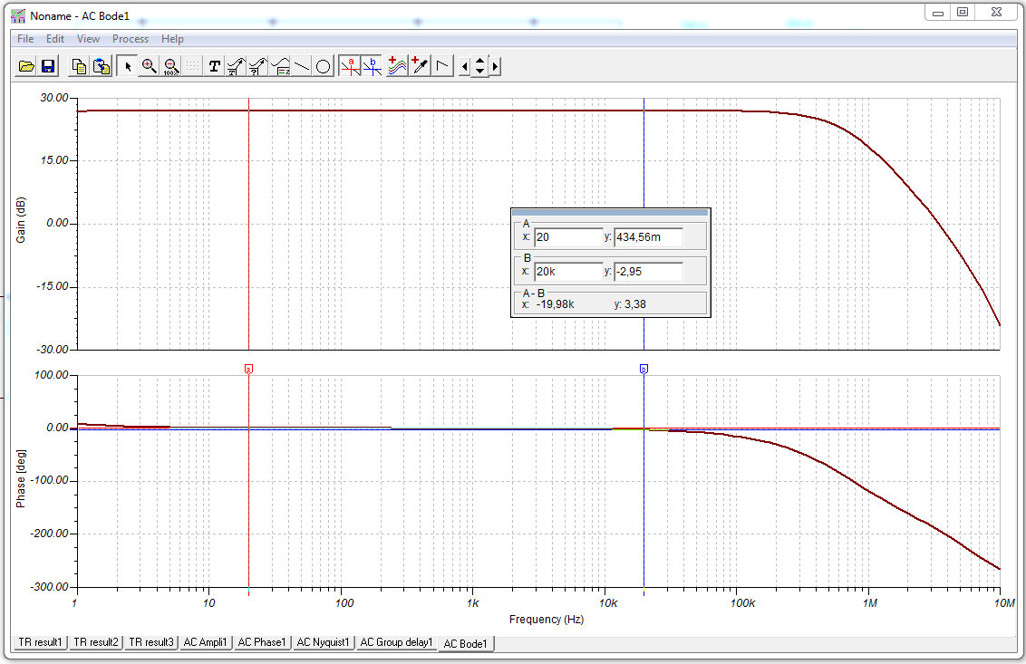

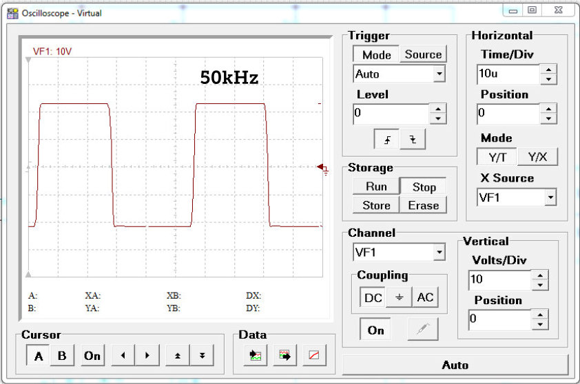

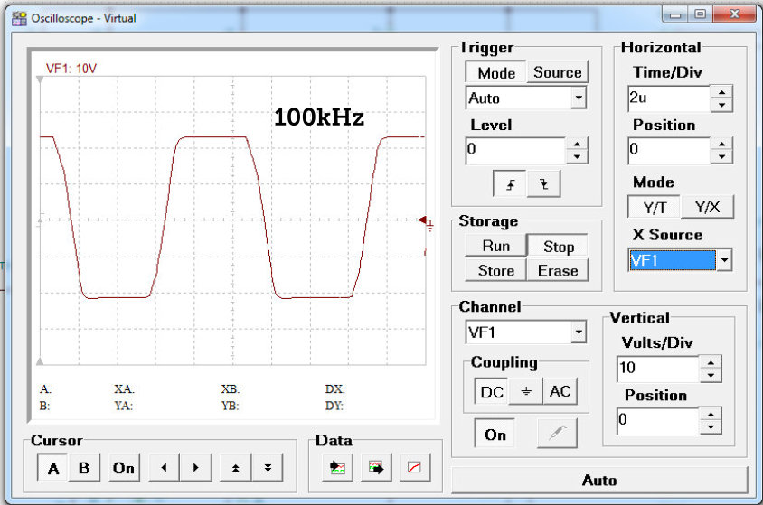

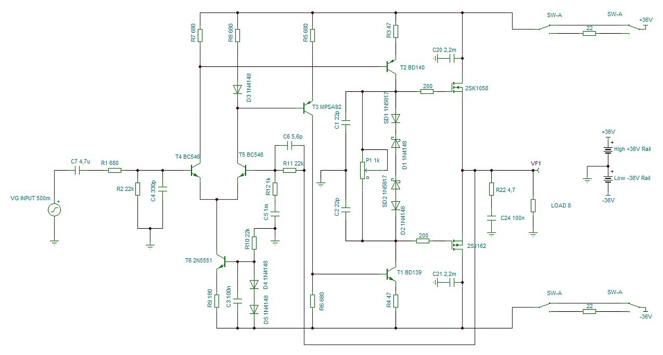

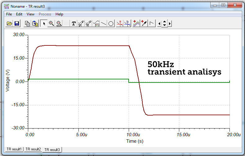

Bypassed the 22k feedback resistor with a 5,6pF capacitor the overshots are gone. Simulated squarewaves and AC bode:
Here is the modded version of FX8 based on bimo's concept. Will this mod work? Any opinion? Can anyone make
a more accurate simulation using LT Spice? Thank You.

1)Schematic values not visible. Please post a visible one.😕
2)Where is the pcb that you using?🙂
