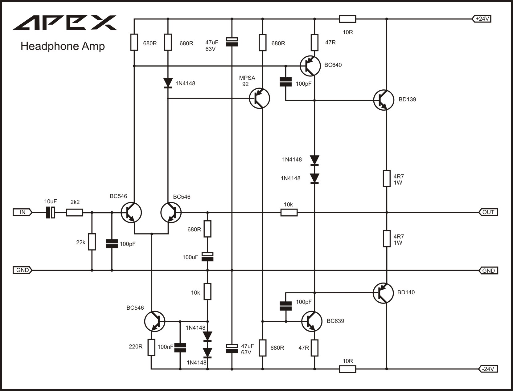

Btw, the Apex headphone described earlier with the BD139/150 output stage, what kind of power can that drive?
Maybe 6 channels of FX8which is exactly what I am building so am looking for a case.
You can DIY case for your amp... amp with BD139/140 can drive any headphone.
I guess those BD139/140's are 1.5 amp capable and with 24 volt rails, that is a lot of watts actually. Could probably drive a small set of speakers nicely.![]()
Yes, but only 32 ohms speakers

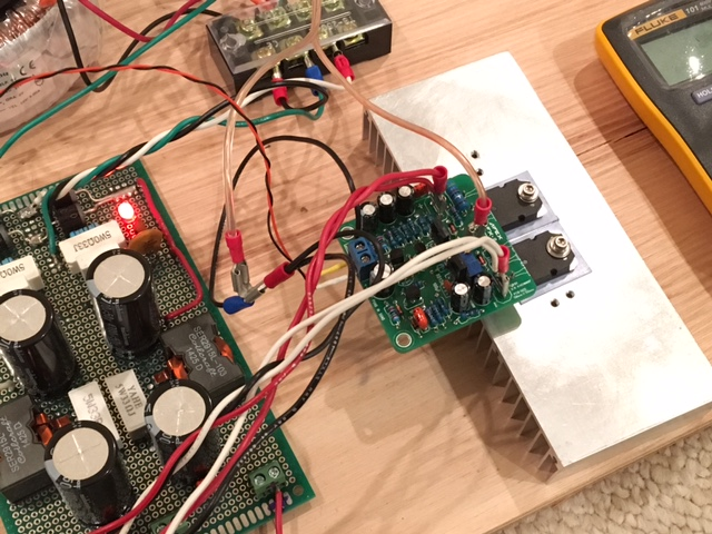

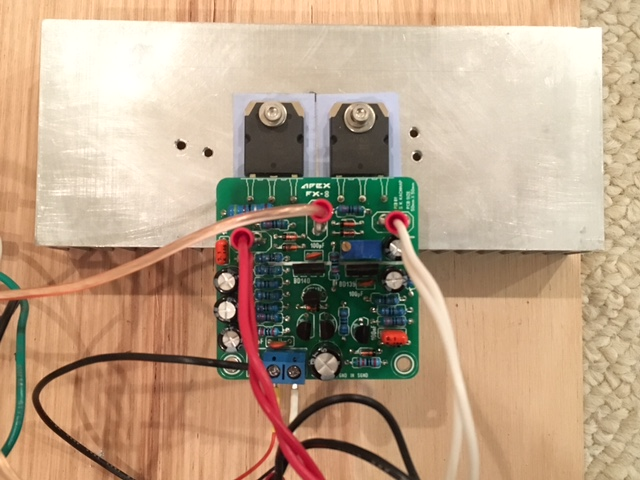

5cm Square FX8 First Sound
The Hitachi lateral FETs came in today. I installed a pair of 10ohm safety resistors in series with the power rails so that I can measure the quiescent bias current. I set the pot at about midpoint. Flipped the switch and observed about 550mA bias so quickly adjusted the pot down to 100mA current. The offset voltage was -15mV and there is no adjustment for that other than matching the LTP stage (which I forgot to do). -15mV is very livable though. I am using a Dx PSU with 250VA 25V toroid for 35.6v rails.
Removed the safety resistors, hooked up the speaker and gave it input from my CD player (laoded with a Suzanne Vega track) headphone out (like a pre-amp to control volume). Flipped the switch and sweet music plays!
Sounds real nice, very clear, no sign of distortion.
The heatsinks feel average warmth for a class AB at 100mA bias (probably circa 45C at moderate volume). Seems like a good place to be. The BD139/140's do feel a bit hot - probably needs a small heatsink as was shown on the silkscreen.
Anyhow, this is a nice compact amp, I really like it and will build up 5 more units for a 6 channel active amp.
