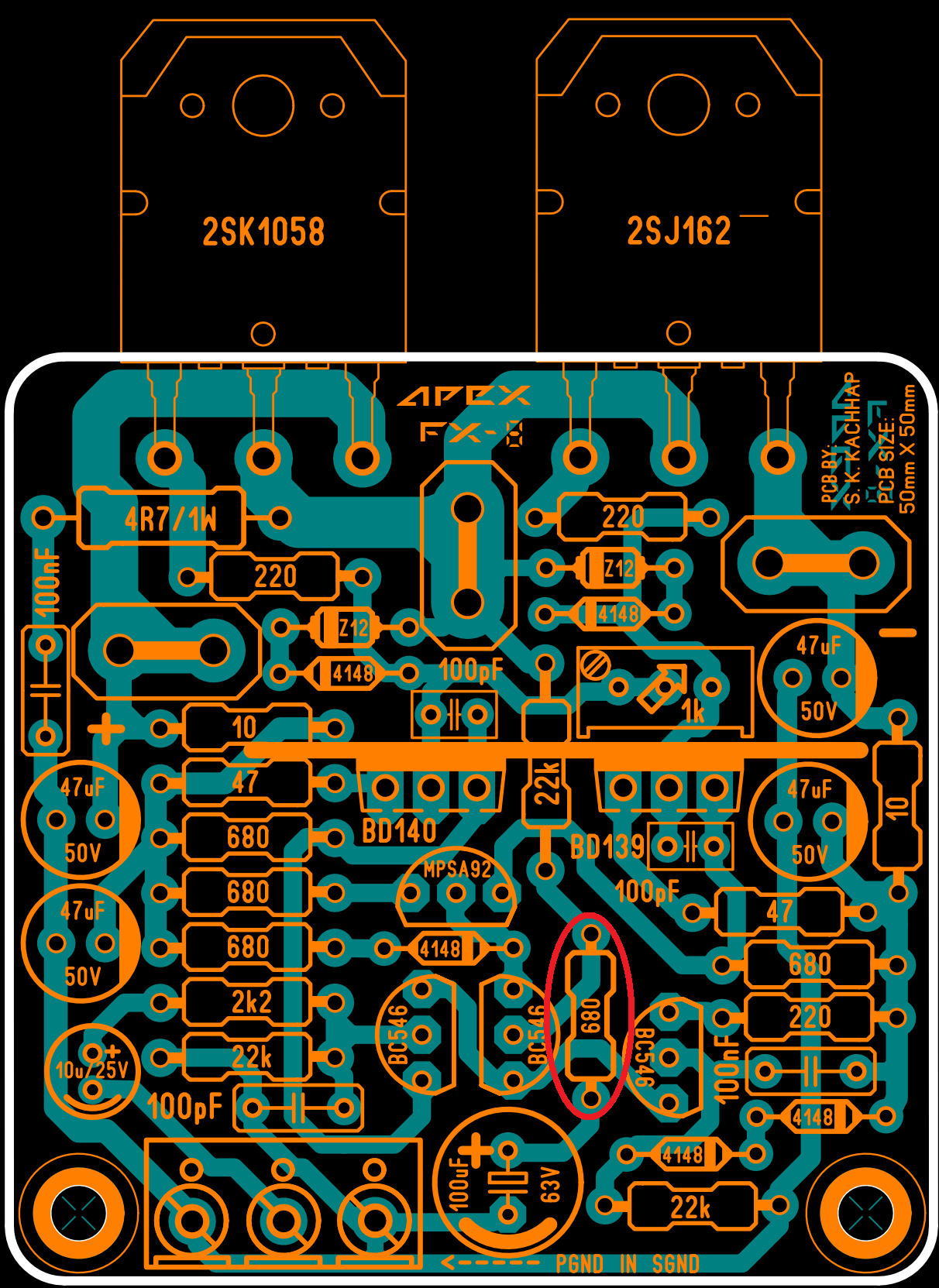

What resistors should I change if I want to get a little more gain out of the FX8? Actually, I am running all 20k resistors in place of 22k's since I did not have any on hand. That may be affecting the feedback resistor and gain somewhat. My pre-amp was not able to drive it to clipping.
The feedback resistors are 22k from output to LTP base, and the 680R from the base in series with (100uF) cap to input ground. Gain is more or less 22k/680=32x. If you use 20k gain becomes lower: 20k/680=29x. You can use 20k/620=32x or if you want higher gain: 20k/560=36x.
Replace 680R with 330R or add another 680R in parallel with exsisting.

I just checked the DX Super A.. Feedback is 56k/1k2 = 56X. That is really high. My DX Super A is the highest gain amp I have. On my A/B setup the volume pot has to be reduced quite a bit to make it even with other amps. So this makes me wonder why you feel the need to clip the FX8? If you need that many dBs maybe you should build a more powerful amp.
I have the regular Dx - not sure if that is different from Dx Super A. I am actually good with volume wise for most music. I was planning on using this to drive a mid bass unit in a 3 way active system and need an honest 60watts out of it (into 5ohm load). Hence I was stress testing it and found I could not get the output of the PC's DAC to push it above 33watts.

I am happy if I can get between 26dB and 30dB. Based in parts in my FX8, it should be about 29dB so maybe my PC DAC just needs a pre-amp.
