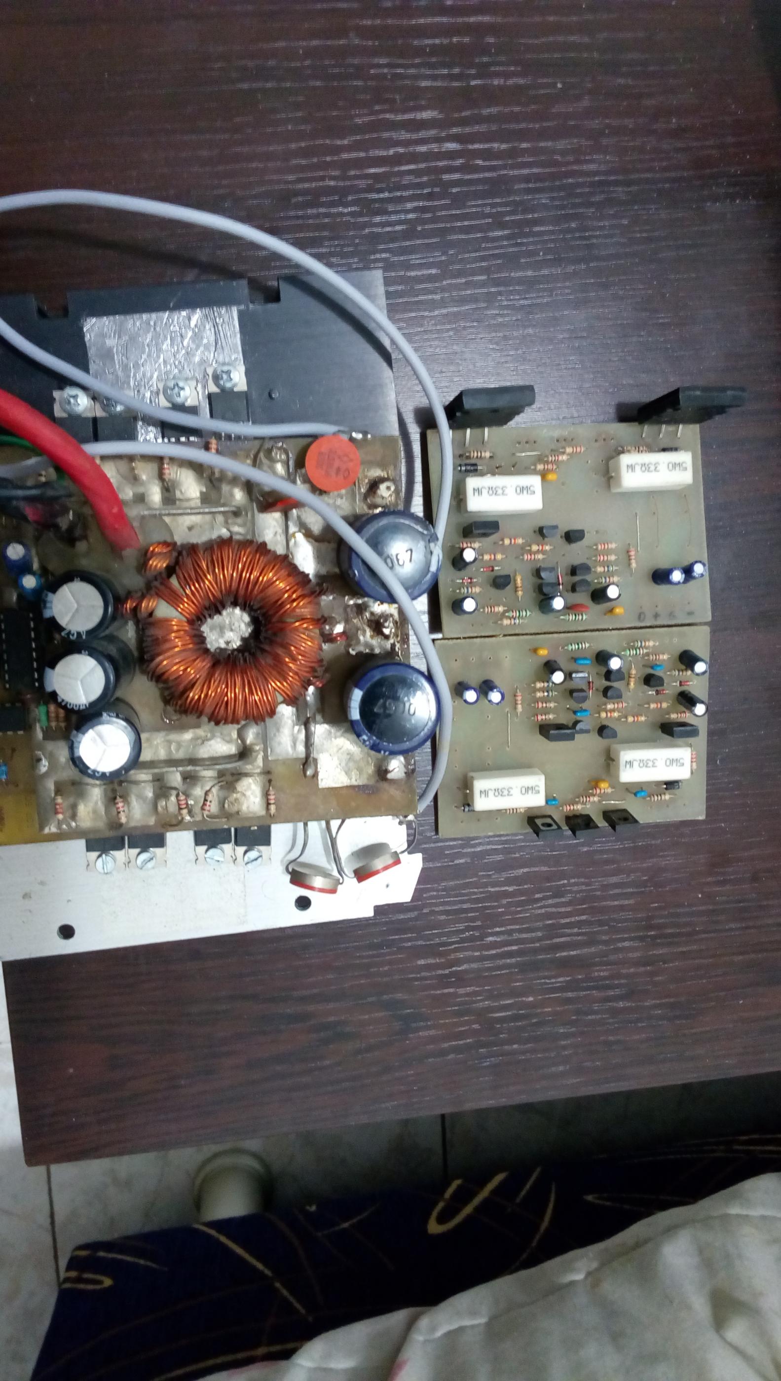

sir APEX , how work protect of AX14P ?
I am ready for install in car .
SMPS +- 40V and four AX14 .
It will disconect speakers if load is under 2 ohm and in case of short circuit ? And if there is overload output transisstor
Regards !

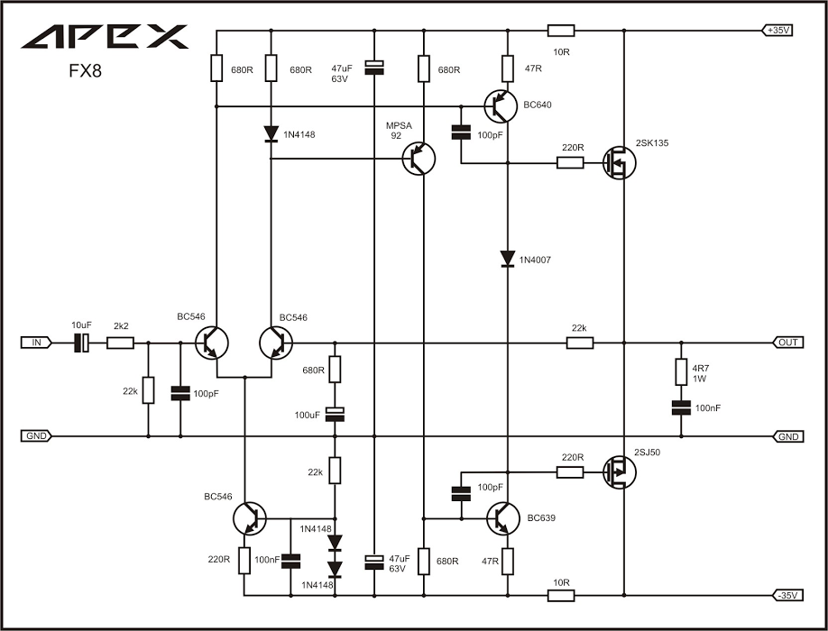

I left the feedback resistor alone (20kohm in my case vs the 22k specified because I did not have any 22k's). I changed the 680ohm as suggested by Apex to 330. This is not the feedback resistor (don't what you call it?).
You can increase gain by increasing the series FB resistor (22k) or by lowering the shunt FB resistor (680). Lowering the shunt resistor is better. My preference is to lower both 22k and 680 (That's also what you did with 20k/330).
But 20k/330=61x is too high. Distortion will be high at high volume.

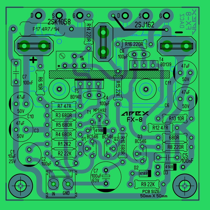

FX8 board as Headphone Amp?

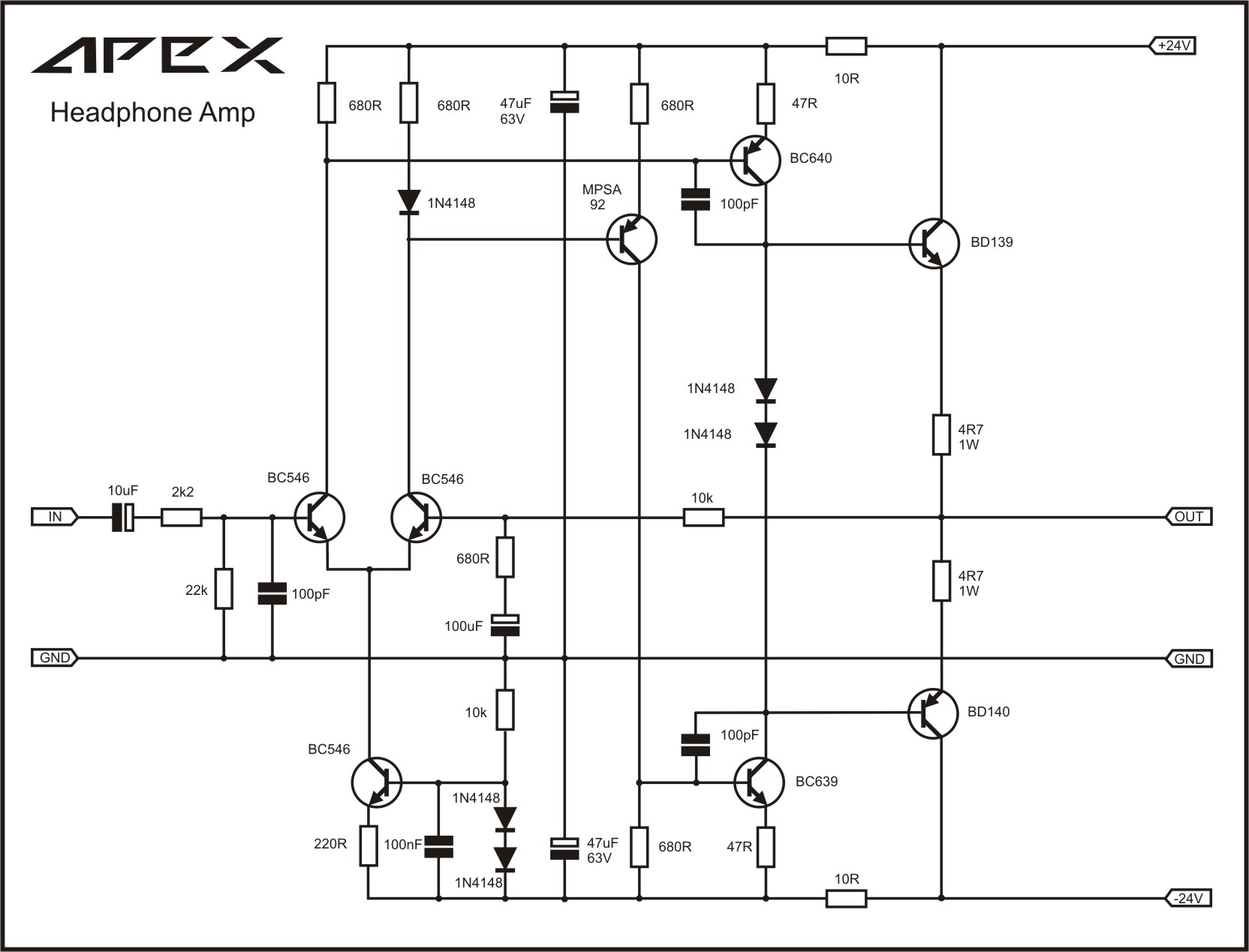

I don't have the exact FX8 schematic with the Zener diode and bias adjust pot, but the basic FX8 schematic seems very similar to the (PX6 pre-amp) and Headphone Amp. So similar that use of the very compact 50mm x 50mm PCB's that I already have with a substitution of the output lateral FETs with a BD139/140 and addition of emitter resistors and the base resistors would turn the FX8 board to a headphone board? For Preamp, just leave off the OPS.
Here are the three side by side (or on top of one another).
FX8:
Headphone Amp:
PX6 Preamp:
I agree 61x is too high. Meh... maybe go back to 30.5x with a 10k on Fb and 330R on shunt?
