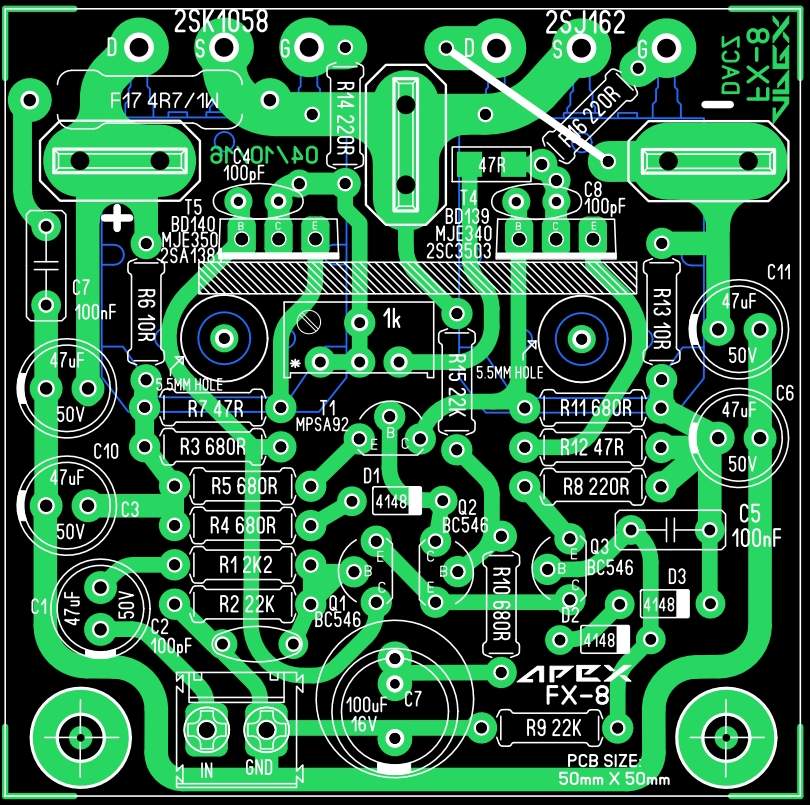

lastly here is a better layout of my fx8

2sa/c To92 transistors are ECBis 2sc2240 a good replacement for bc546?

BC54x are CBE
they don't fit !!!
BC54x are CBE
they don't fit !!!
yes AndrewT i'm aware of that.. what i'm asking is "if it is a good replacement".
What are the two 5.5mm holes for in the center of the board?
Why do you claim this is a better layout?
for fixing the output transistor.. i said "My FX8" i didn't claim it is better than other.
OK, I see now. I hadn't noticed that you reversed the pinout of the output transistors. I like it. This will be very nice for a multichannel amp. Thanks for sharing.

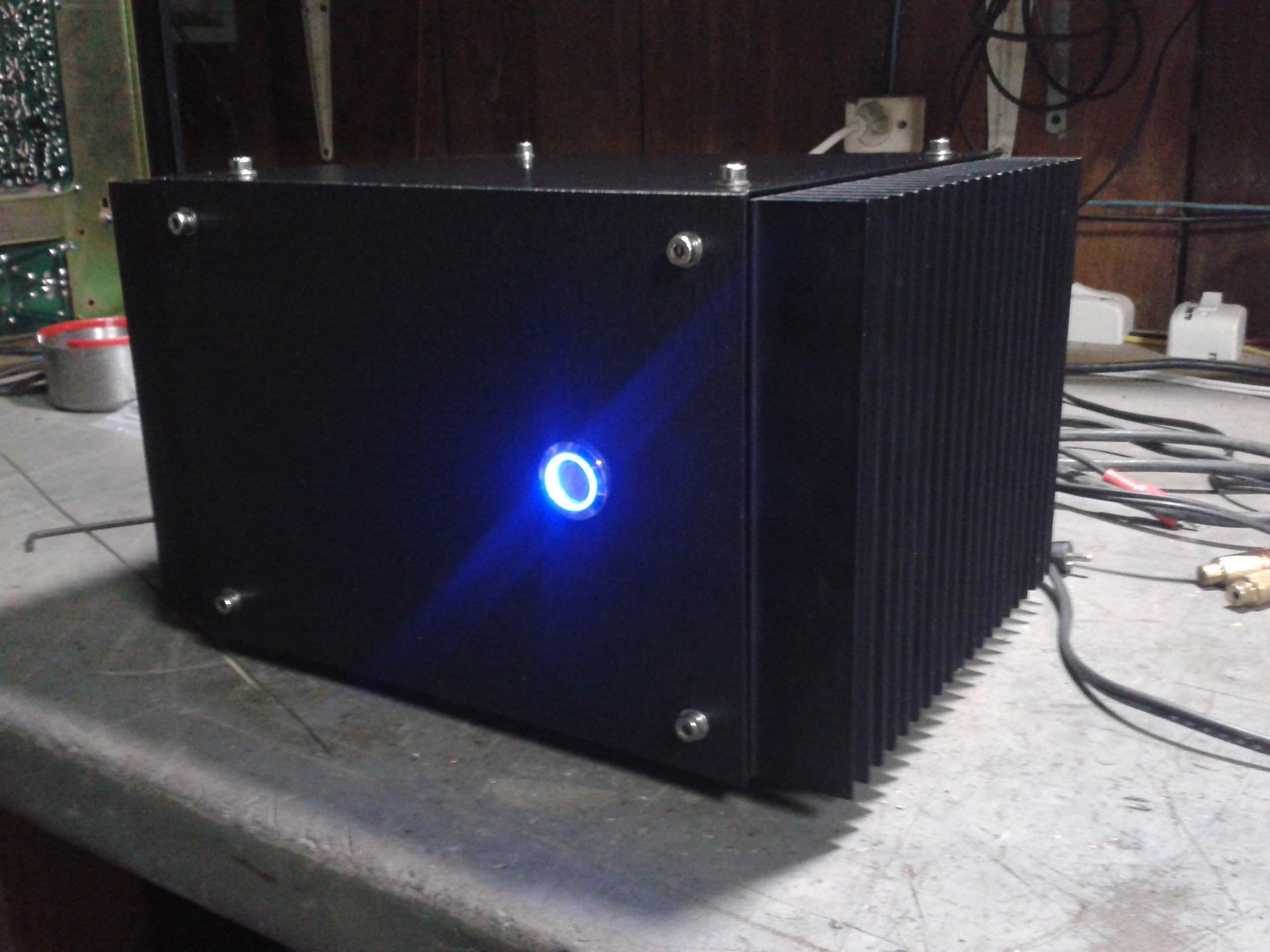

AX11 in action
https://www.youtube.com/watch?v=Zj8FkU1qIt8
Thanks for sharing!
