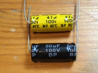

I have 47uF non polarized electrolytic cap to try as input cap. Is that better than polarized one? You called them BP caps (bipolar ?)
Yes, NP (non-polar) is better than "polarized" ones. But from my examples (caps on hand), BP (bi-polar) is better than NP.
NP is like putting 2 caps back to back: min-pos-pos-min.
BP is like: pos-min-min-pos.
I have tried using 2 caps (good quality ones) back to back but the result is inferior.

Ok, so I never knew the distinction between BP and NP caps - just thought they meant the same thing and either works the same way. Luckily, I have both on hand and will put the 100uF BP's in to see how that works.

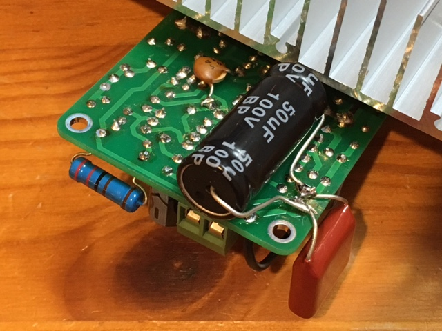

Ideally, those Wima's would be sweet to have. For now, I will try the 50uF BP's with 1uF film caps in parallel. Hopefully, this will sound decent until some 4.7uF film caps come in. I also swapped out the 56pF for 5.6pF caps on FB resistor and for grins, put in a 2w 22kohm resistor to keep the Johnson noise low. 🙂
Edit: Just realized the 22k's are actually 2.2k's - would this be a problem to run 10 times more current here? Certainly, the resistor can handle the power.

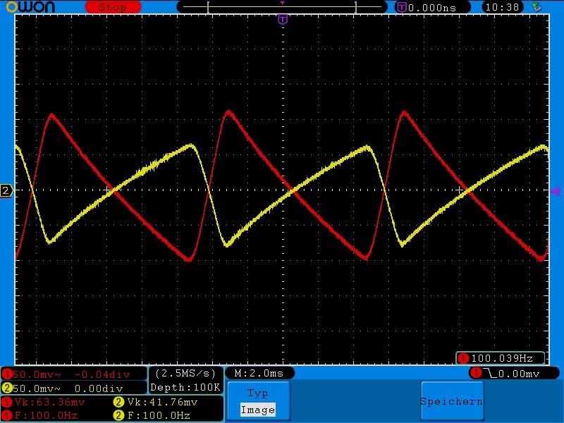

Just hooked up the FX100 Supply (PSP100) with 2x1.500µF to two APEX A23 Boards (20mA idle) with additional 2x2.500µF each. As expected for the relatively low capacitance i'm getting quite a lot of 100 Hz hum on my speakers. The rail voltages have 60mV and 40mV ripple (the positive is higher because of the current draw of the psp 100 relays). Hum on the Speakers is about 2mV as far as I could correctly mesure that.
Do you think an upgrade to 2x20.000µF would eliminate the hum satisfactory?

I hooked up the FX8 with the above mods. So the 50uF BP + 1uF film cap certainly made a difference - it's like a new amp for the better. Substantial improvement in perceived sound quality from standpoint of bass extension. Highs still clear and midrange has amazing fluid like smoothness and clarity. Dynamics have improved too - overall this has been the Bomb of a mod. I am going to give more time to sink in, but first impressions with about 4 songs so far have really impressed me. Definitely a super amp 😀
I am not sure if the 4.7pF made a difference but certainly this amp has very clear percussive and transients are very sharp and clear.

I don't agree on what is being stated for the electrolytics.
An electrolytic capacitor is polarised.
One can buy polarised and bi-polar.
Plastic film is not polarised although some plastic film have a tiny polarising effect which we normally ignore.
Plastic is therefore usually referred to as non polar.
A bi-polar electrolytic cannot be non polar.
The yellow electrolytic shown in post7026 is printed incorrectly. It is not NP. it is bi-polar.
I have some bi-polar electrolytics that are printed non polar or NP. These manufacturers don't know how to describe their own product ! They are bi-polar.

So it doesn't matter if they are -ve +ve +ve -ve. Vs +ve -ve -ve +ve as far as internally how they are connected?
Regardless, the large value of the cap (50uF) is probably what is making it sound great. I am really liking the sound of the FX8 with this upgrade. Highly recommended.
If it makes any difference - I have a huge 50uF 450v industrial motor run oil filled film cap that is not electrolytic and not polarized. I should hook it up for a comparison 🙂

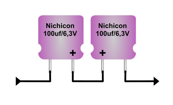

Hi xrk! You can try this:
USF0J101MDD Nichicon | Mouser
It has 2,5mm lead spacing only. Put 2 of them in series as can be seen in the picture. They cost less than 1 EUR. 🙂
Thanks Egra, but I think my packaged 50uF seems (internally two 100uF back to back) to be working very well.
