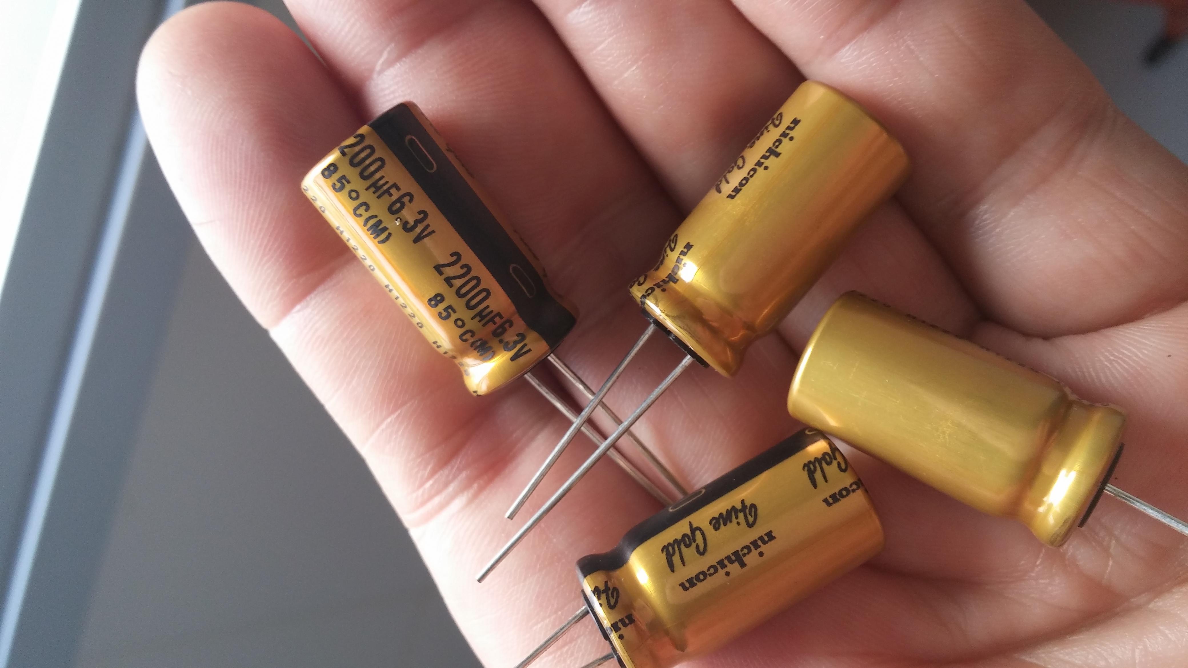

1. You could try using 10uF nichicon 'muse' Bi-polar (datasheet claims "suited for audio signal circuits").http://www.mouser.com/ds/2/293/e-ues-876267.pdf .

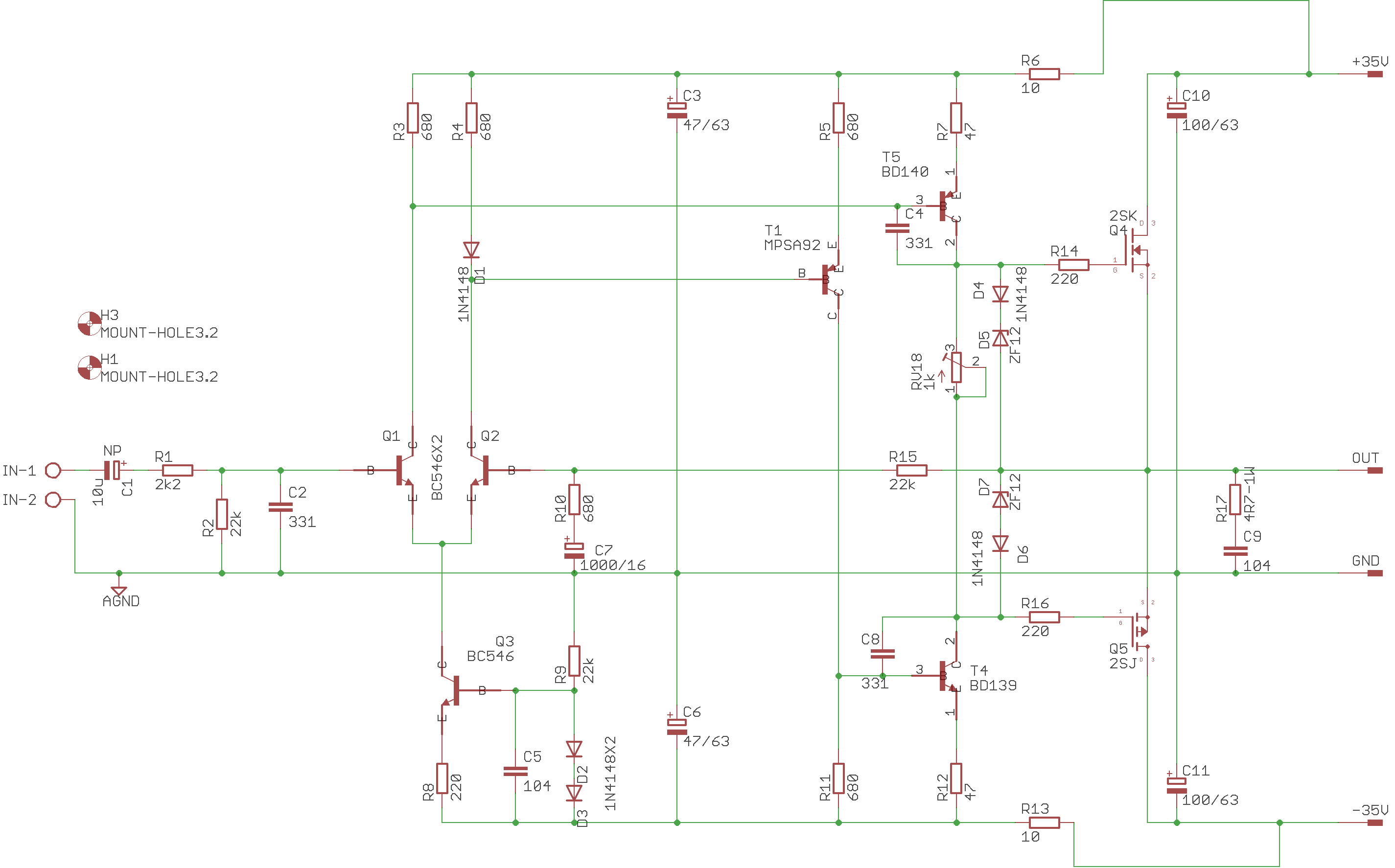

Here is the reference schematic on which my build is based and also sonal's layout. you could mark up your changes in paint.

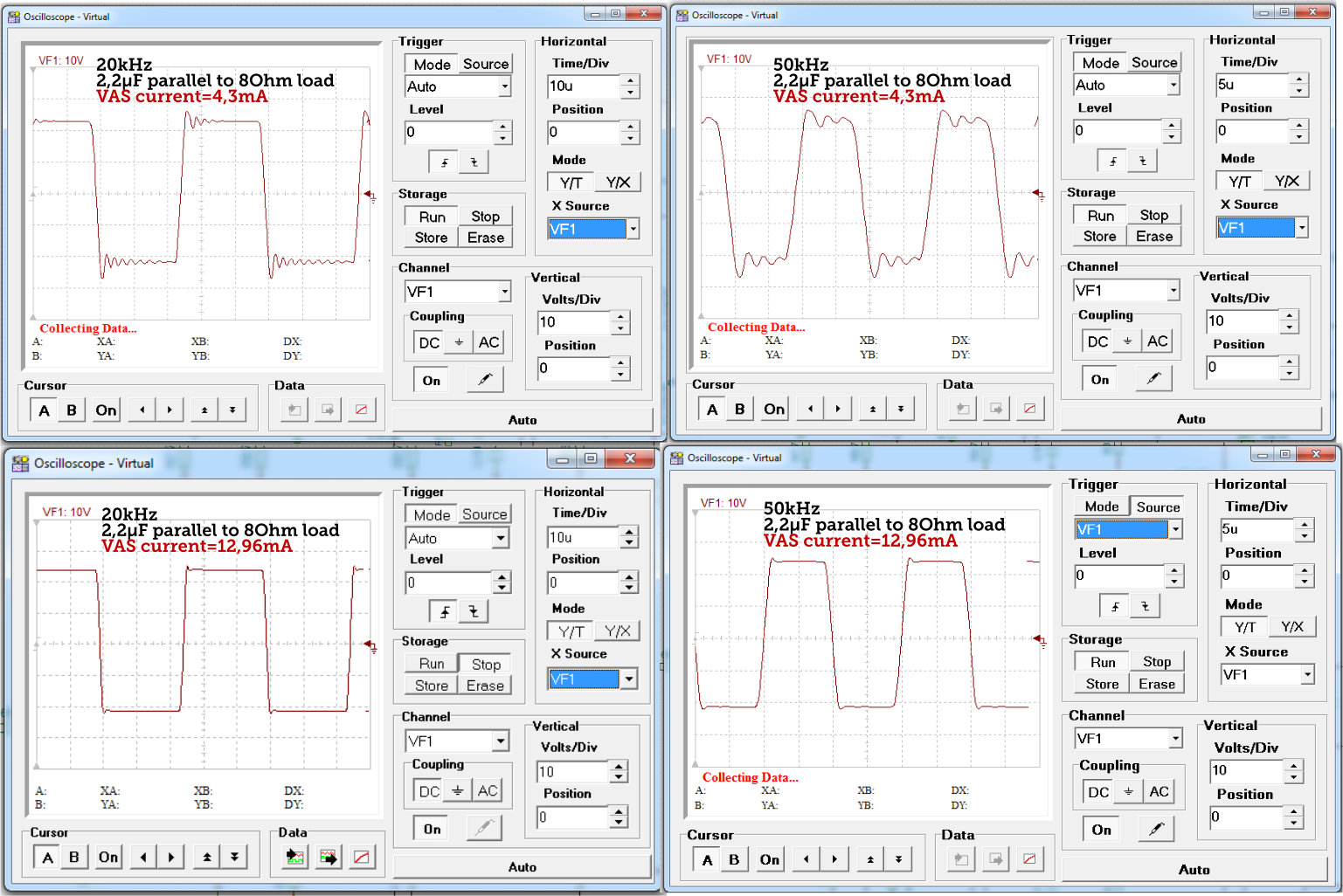

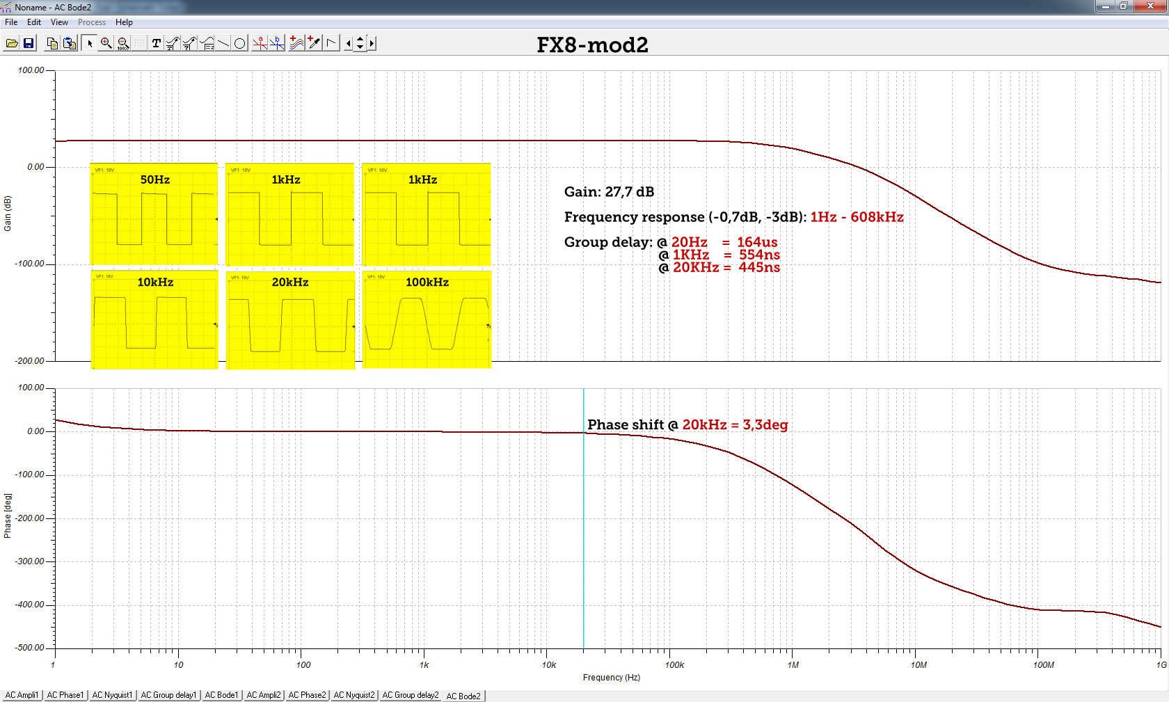

Until xrk's schematic will arrive I share the latest simulation of my FX8 mod, which shows excellent result. If I increase the VAS current from 4,3mA to 13mA FX8 can handle capacitive loads incredibly good. How is it possible?

Some parameters
That's a TINA plot - can you please share TINA file?
How do you increase the VAS current? I accidentally played it with R9 being set at 2.2k vs 22k and maybe I am imagining it but it sounded very effortless yet powerful. I realized my mistake in reading the 5 band color code and swapped back to 20k. But when that 2.2k was in - it did not sound for the worse at all.
That's pretty impressive square wave driving a capacitive load. I actually have other (non audio applications) where this is useful. Let me update schematic with what is actually built. If I get TINA file I can do it directly rather than markup in paint.

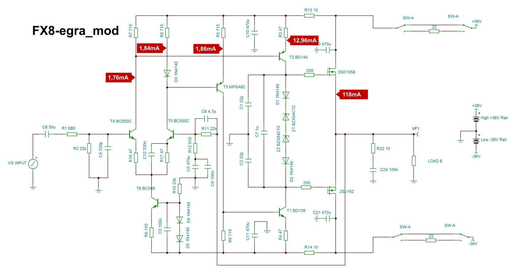

Here is my latest. TINA file attached.

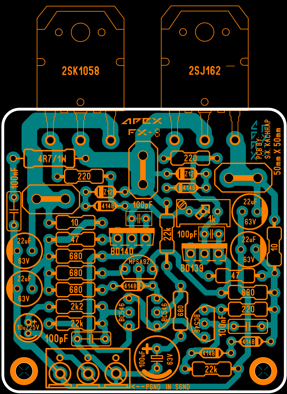

Thank you! This does not have the potentiometer in it like the one I had made based on the Gerber files provided by Prasi. Would it be possible for you to model the 5cm x 5cm FX8 with potentiometer?

The board I am using is based on this file:
http://www.diyaudio.com/forums/soli...imate-fidelity-amplifier-651.html#post4641314
And the schematic is here as given by Prasi above:
I will take a crack at putting this schematic into TINA but am new and slow.
My amp uses 51uF on input cap and all 22k resistors are swapped out for 2k. I also have 4.7pF across R15. R10 is 550ohms. Otherwise the same. I am indeed using 100uF 63v cap and all 47uF caps are 63v rated.

Yes, this is DIY, but before doing any experimenting, i feel one should build according to designed/working sch, and then take experimentation further. one thing that u should first do, is to change all 22k res to 22k and 100u63v to 1000u/16v. you never know, the treasure is hidden in original map (schematic)
Ok, but the map printed on the silkscreen says 100uF 63v. 😕
100u63V is the min that you can use ...., but to have accurate sound (based on measurements by Terry), I have said at least in two posts and Mr. Miles in one post originally and Terry in his test... "To improve 50Hz response, you use 1000uF16V". I had recommended to you directly in one of the post, if memory serves right. and also to Benz!
