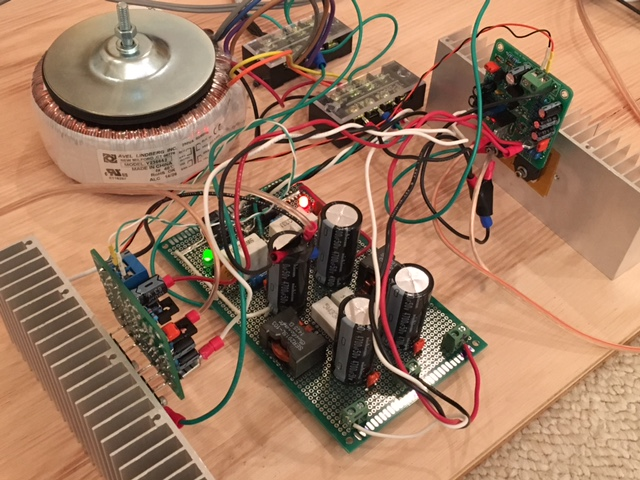

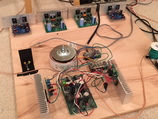

Thanks for clearing up that whole Zener diode thing. I guess I found out that it works fine with it and affords extra external protection for these pricey lateral FETs.
I built up the second unit and adjusted gain to be 36x (20k/550R) and this gain is perfect - great dynamics and no audible distortion. I was missing a 1k pot so used a 5k pot and found that you really have to twist on the screw to get the right bias. When I first turned it on I had 25v across the 10ohm external safety resistor and it took a lot of turning to get it to 1v for 100mA bias.
Listening to it now, maybe on 5 tracks total, so far, very very good amp - actually, excellent amp. Very happy with it. Stereo sounds great.
You can see this is the test bed with a Dx and inverted JFET Circlophone in background.
Closeup of FX8:
