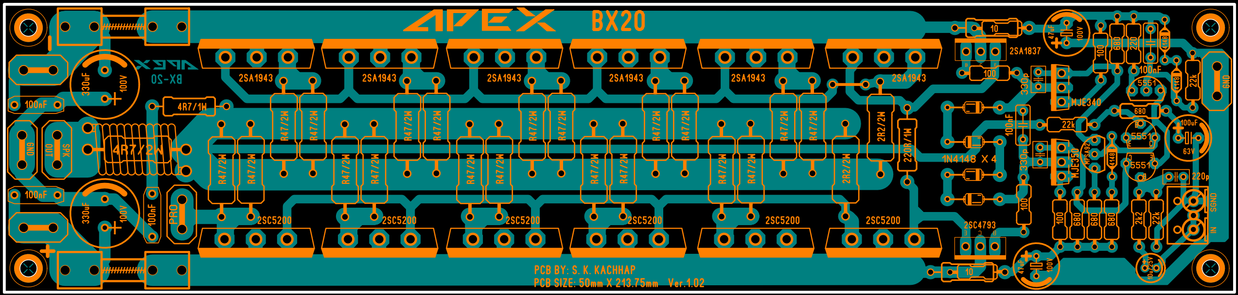

100W Ultimate Fidelity Amplifier
Sprint and pdf files for BX-20.
I'll post AX15TEF 2,3 and 4 pair version later.

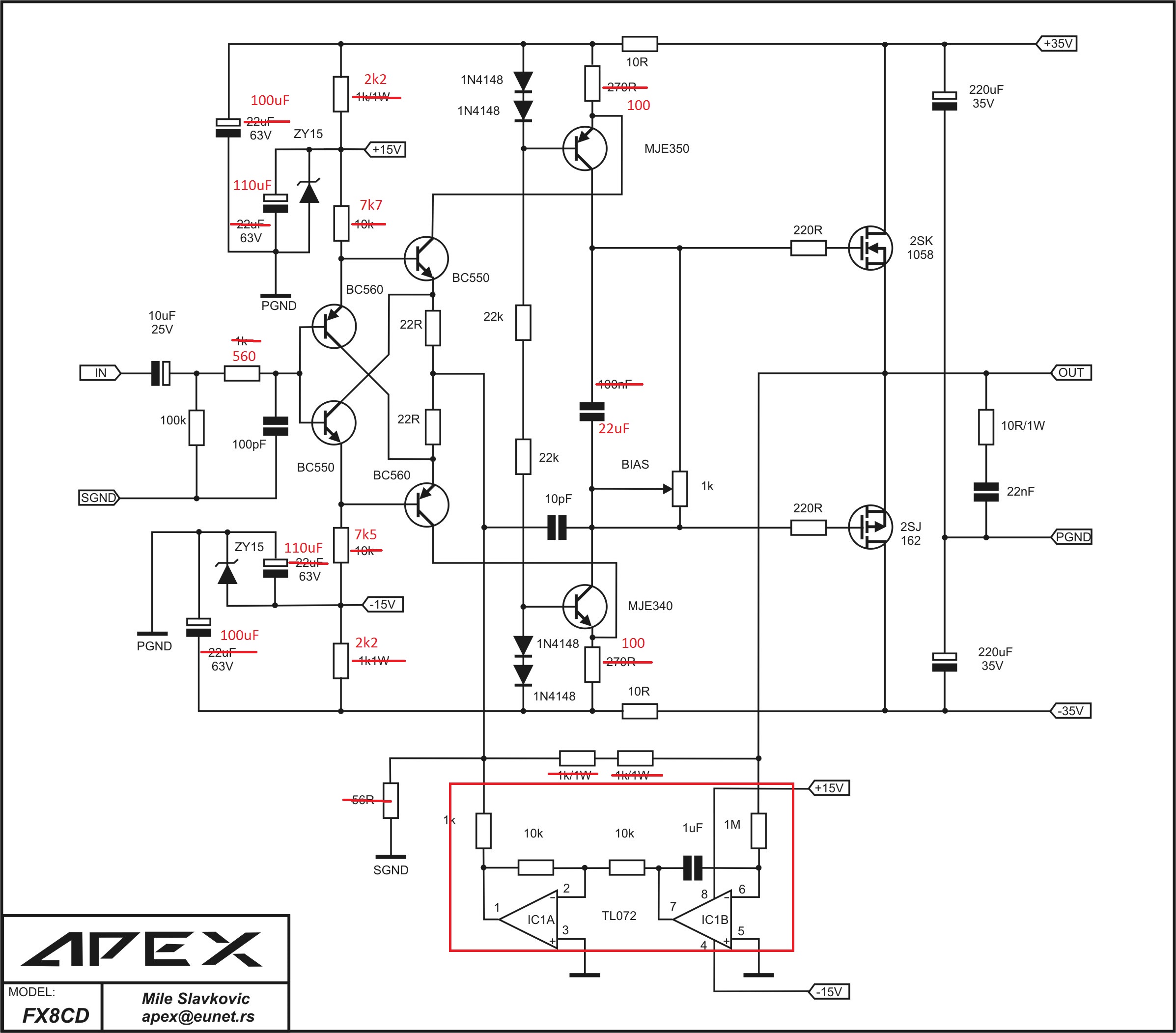

Nice pcb, but you must replace resistors value (270R with 100R...) Use values from Dragans simulated schematic of FX11 for input stage, output stage with 2SJ/2SK is ok.
10pF misisng on your pcb...
Regards
Dragan changed a lot of values on the FX11, not just the 270R. Are you saying you circuit will not work as drawn? I can add the 10p easily enough on the bottom of the board. I will submit a new layout with the changes I see in Dragan's before I go any further.
FX8CD and FX11 is just idea and not tested. I must do simulation, there is some problems like rail sticking... wait with building this project...
Regards

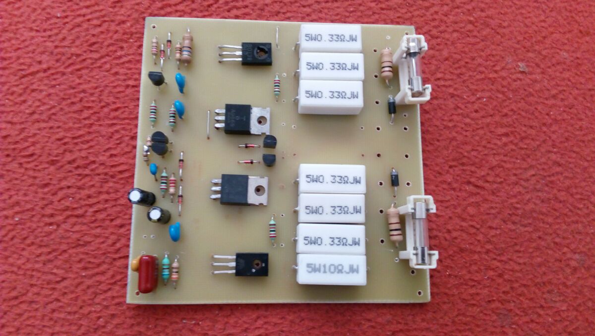

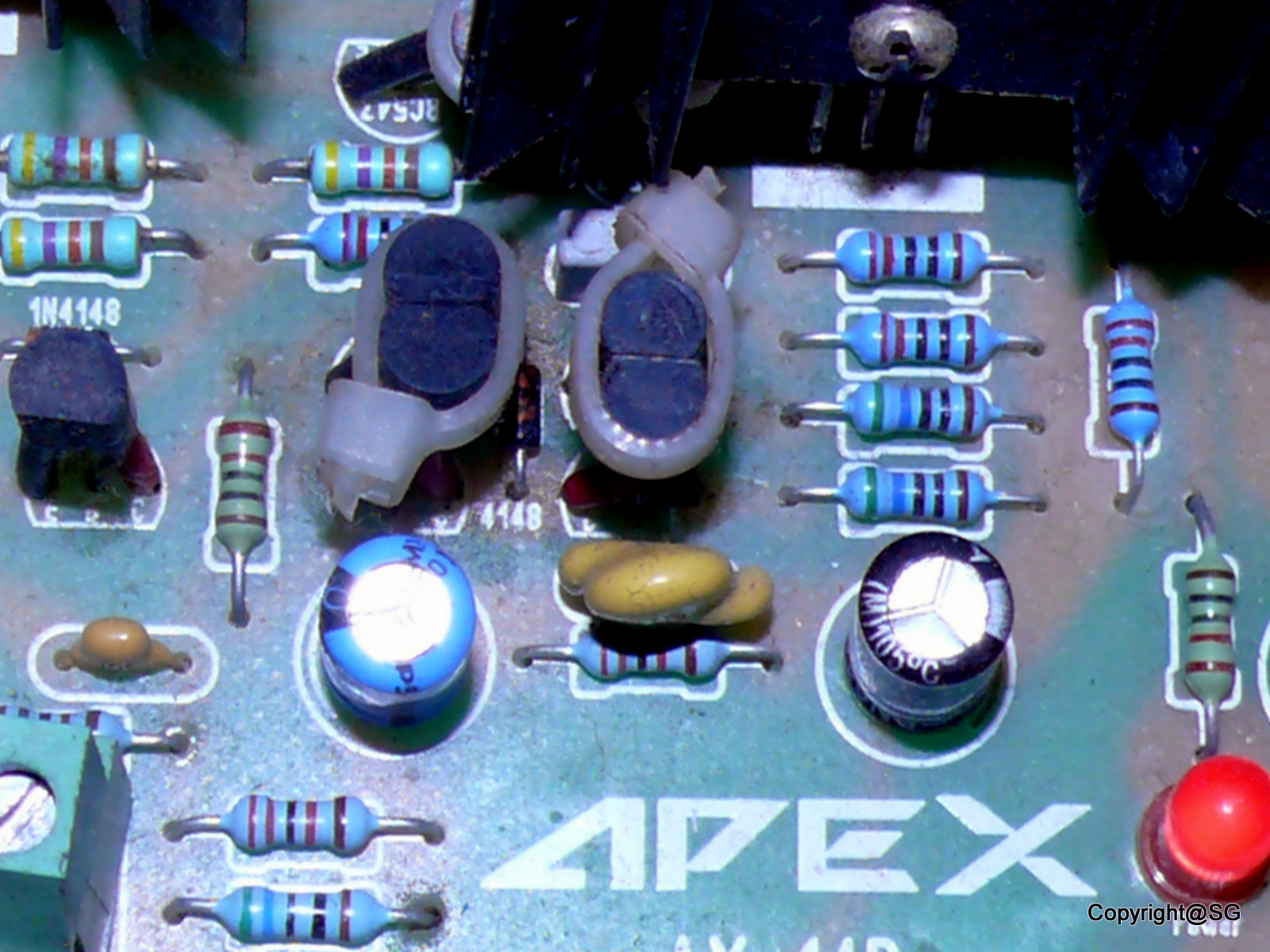

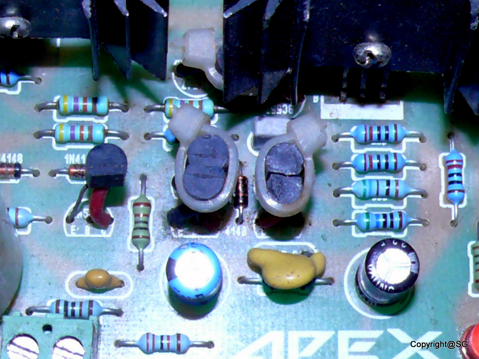

Just wanted to update on the thermal coupling, As per suggestions I changed the coupling devices and have had it now for 4 days.
The Offset has come down by a wee bit,It now stands at -2.5mv (earlier -2.8 to -3mv) on one channel and -1.8mv (earlier 2.2 to 2.4mv) on the other.
Also one thing I have noticed over the period of a month or so since the Amp was built and was to put to play,The Bias keeps decreasing.
I had kept the bias approx 81ma (27mv) and it keeps dropping to 25-26mv,I have set it multiple times but it still continues to drop,Is it normal ??
Regards.
