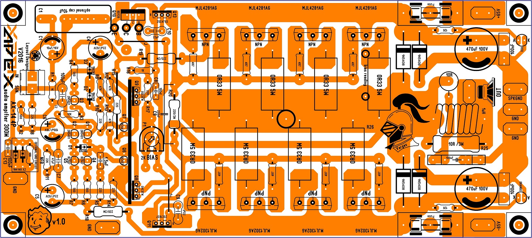

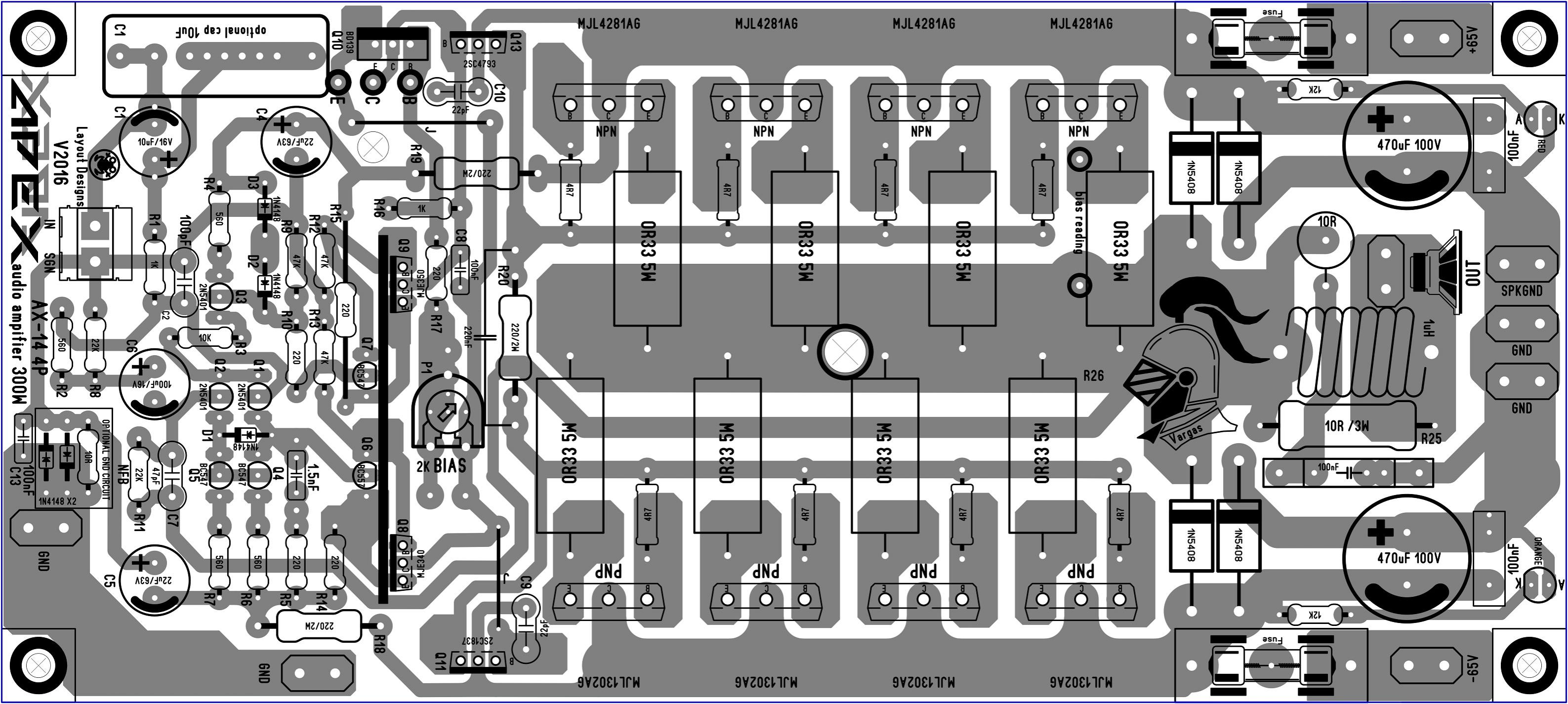

I have a question guys I'm trying to figure how much bias adjustment I need to have for 4 pairs using the AX-14 circuit IPS and I only adding 3 more pairs and I'm thinking that bias would be different, I place a volt meter reading on one of the emitter resistors to read mV there what would be the correct adjustment for 4 pairs output using 65V DC supply ? I mean close enough approximation 🙂

You must use triple emiter folower to drive 4 pairs like in AX20 or BX20.
Regards

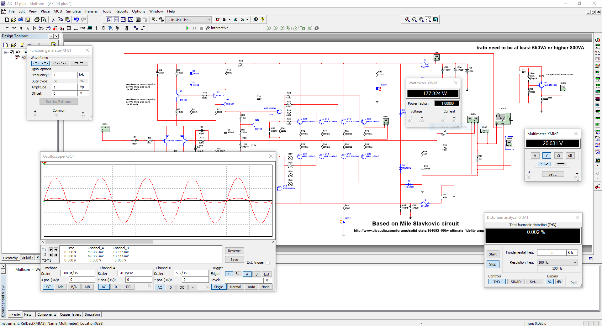

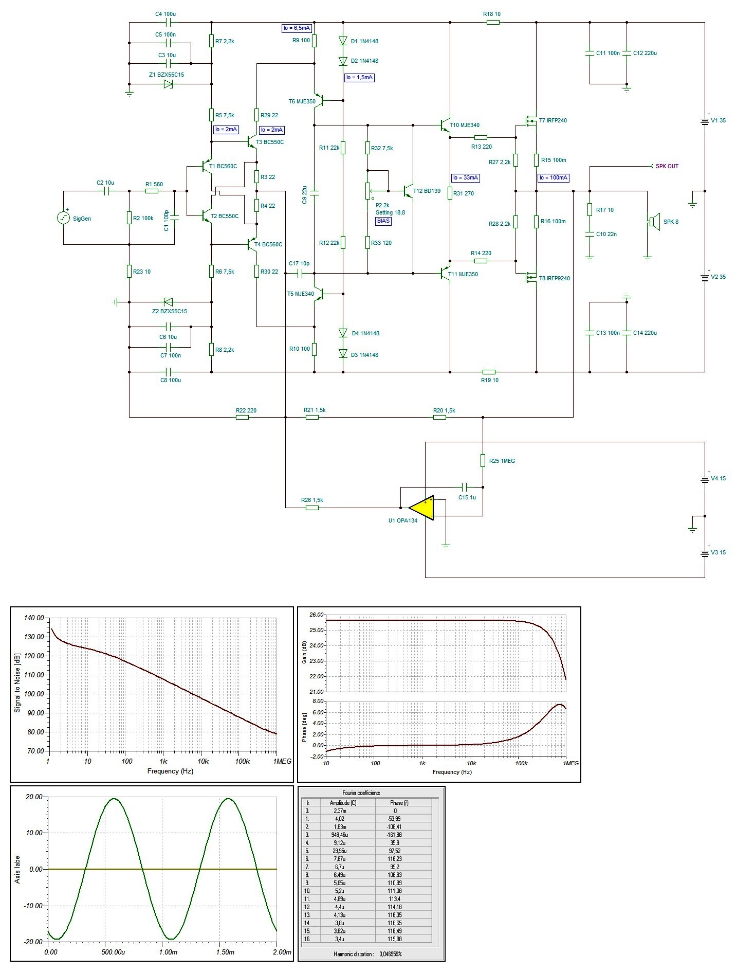

oh I see I think I can give the layout that option on the PCB I will figure that out later I have to " brainstorm " for a while 😛 but, the good think is that on simulation as it is I think it does responds really well 🙂 I'm not searching to get lot of power just a bit more

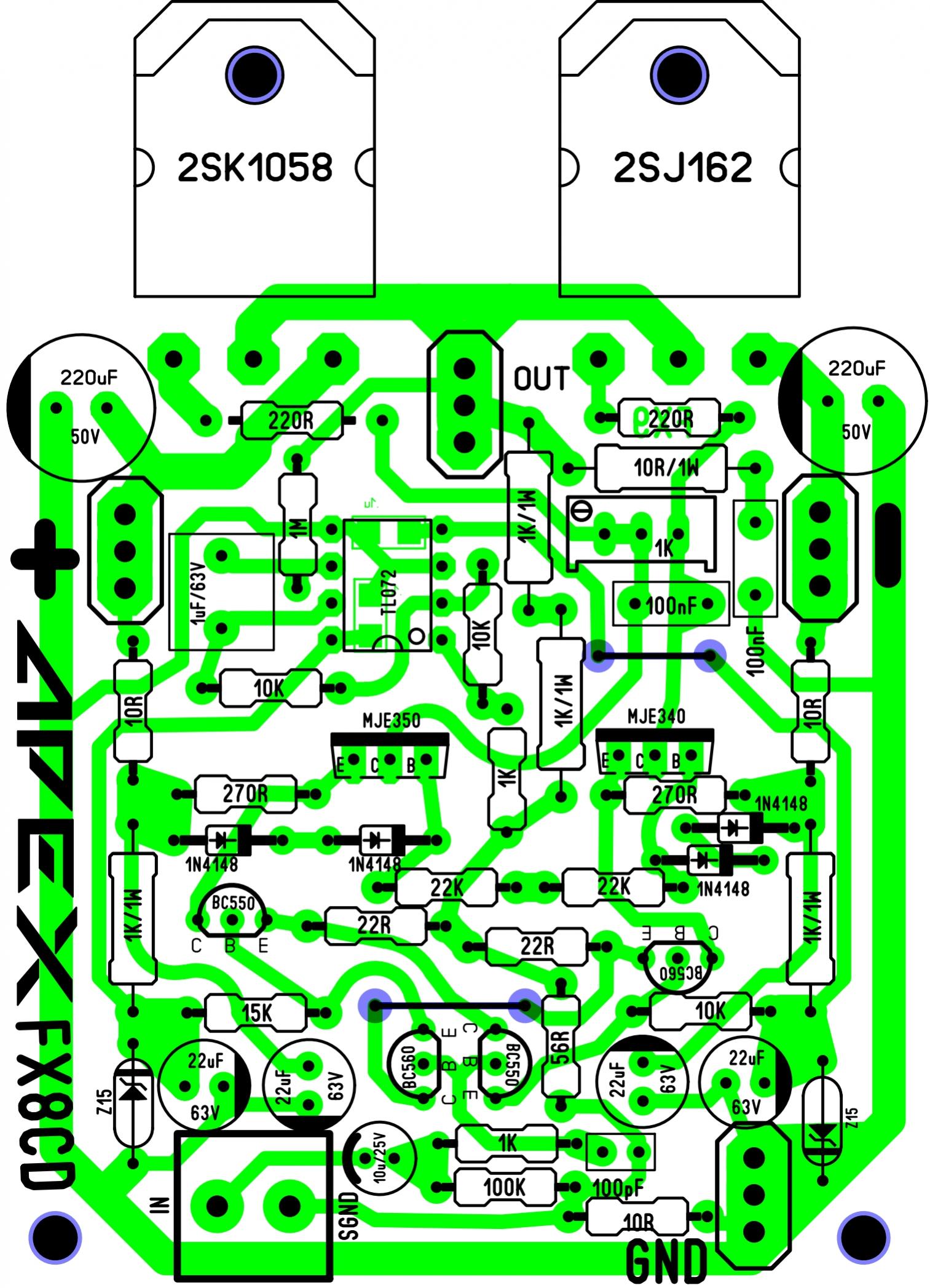

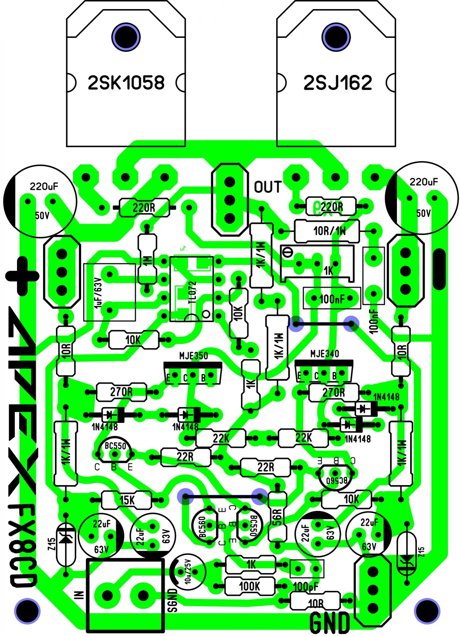

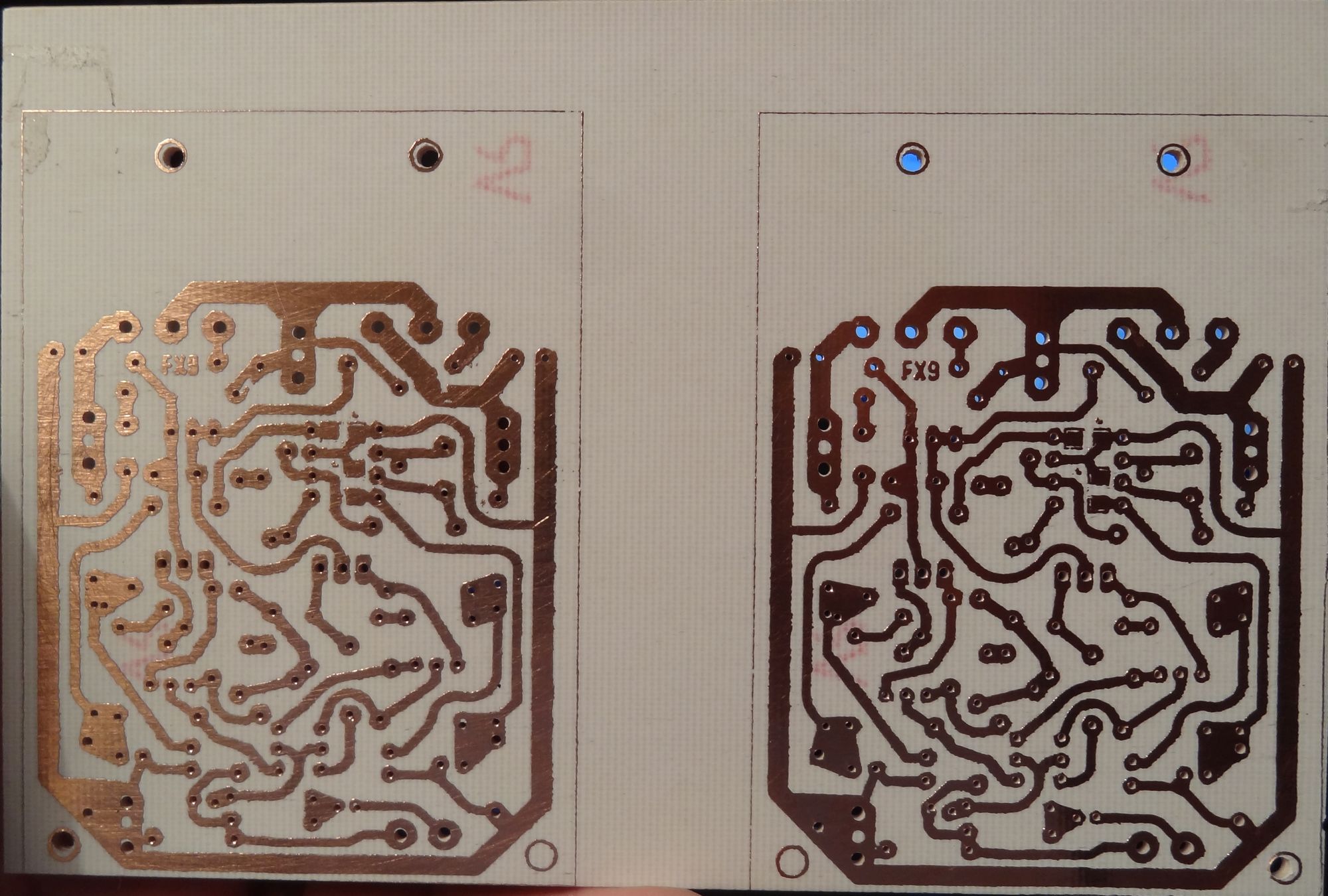

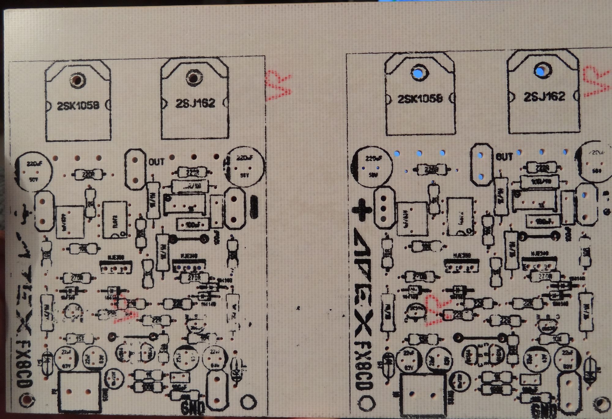

OK I etched a pair. Tomorrow I'll try to get them populated.
Hmm, I just noticed I forgot to change the label on the foil side. I'll take care of that now. 😉
Nice pcb, but you must replace resistors value (270R with 100R...) Use values from Dragans simulated schematic of FX11 for input stage, output stage with 2SJ/2SK is ok.
10pF misisng on your pcb...
Regards
