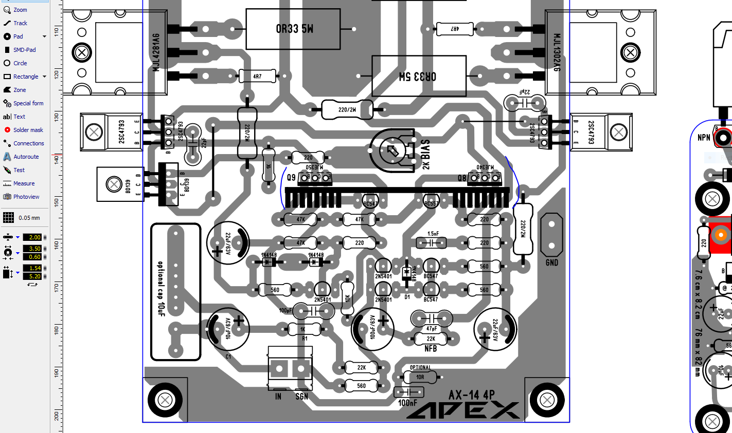

sprint layout PCB AX11TEF not tested
Nice layout!. It is indeed possible (with few mods) to separate i/p ground and power gnd on your layout. nice🙂. But don't know if that is required as most APEX layouts recently seem to have them combined.

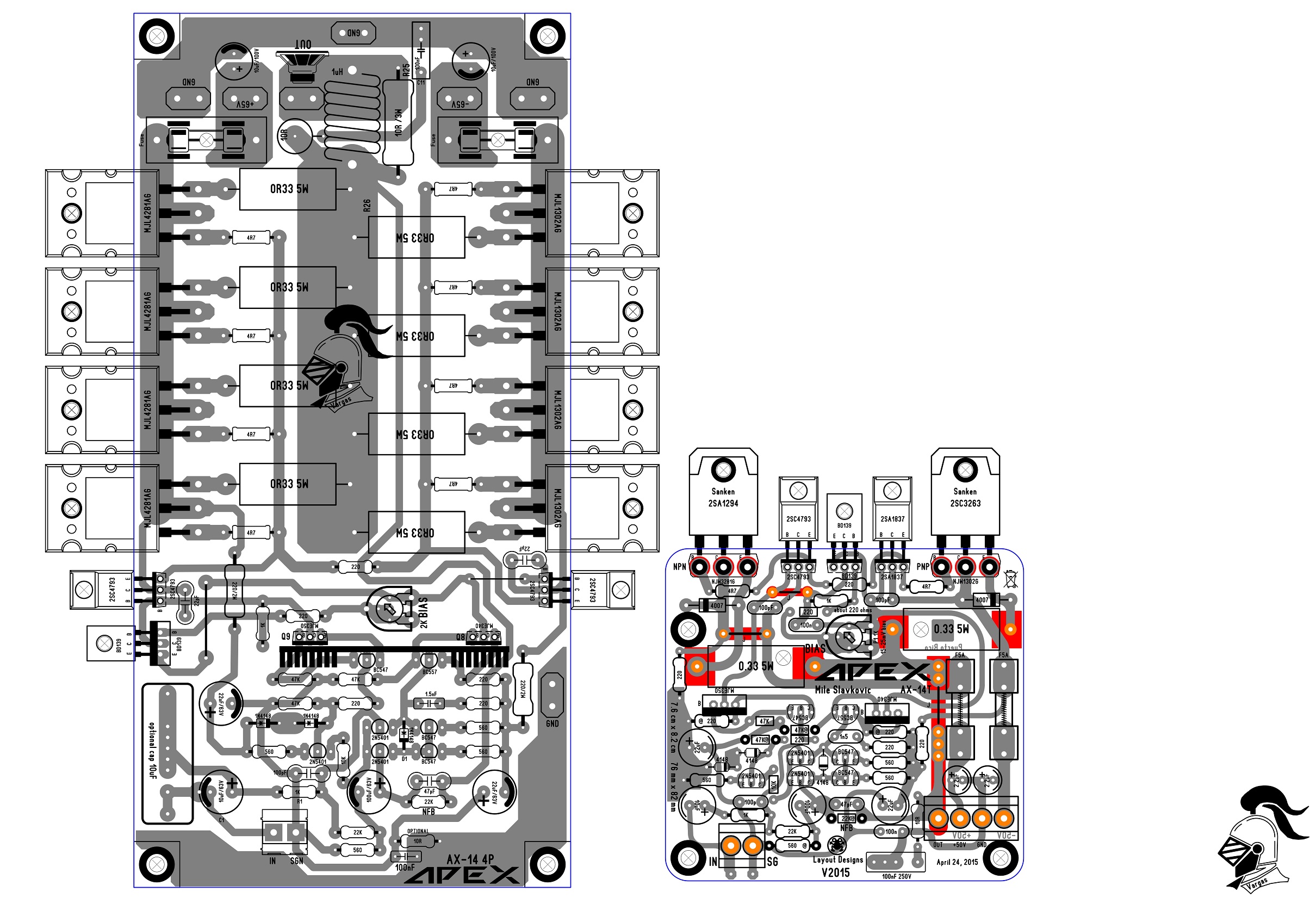

Layout for Apex BX20. I'll make one more version of BX20.

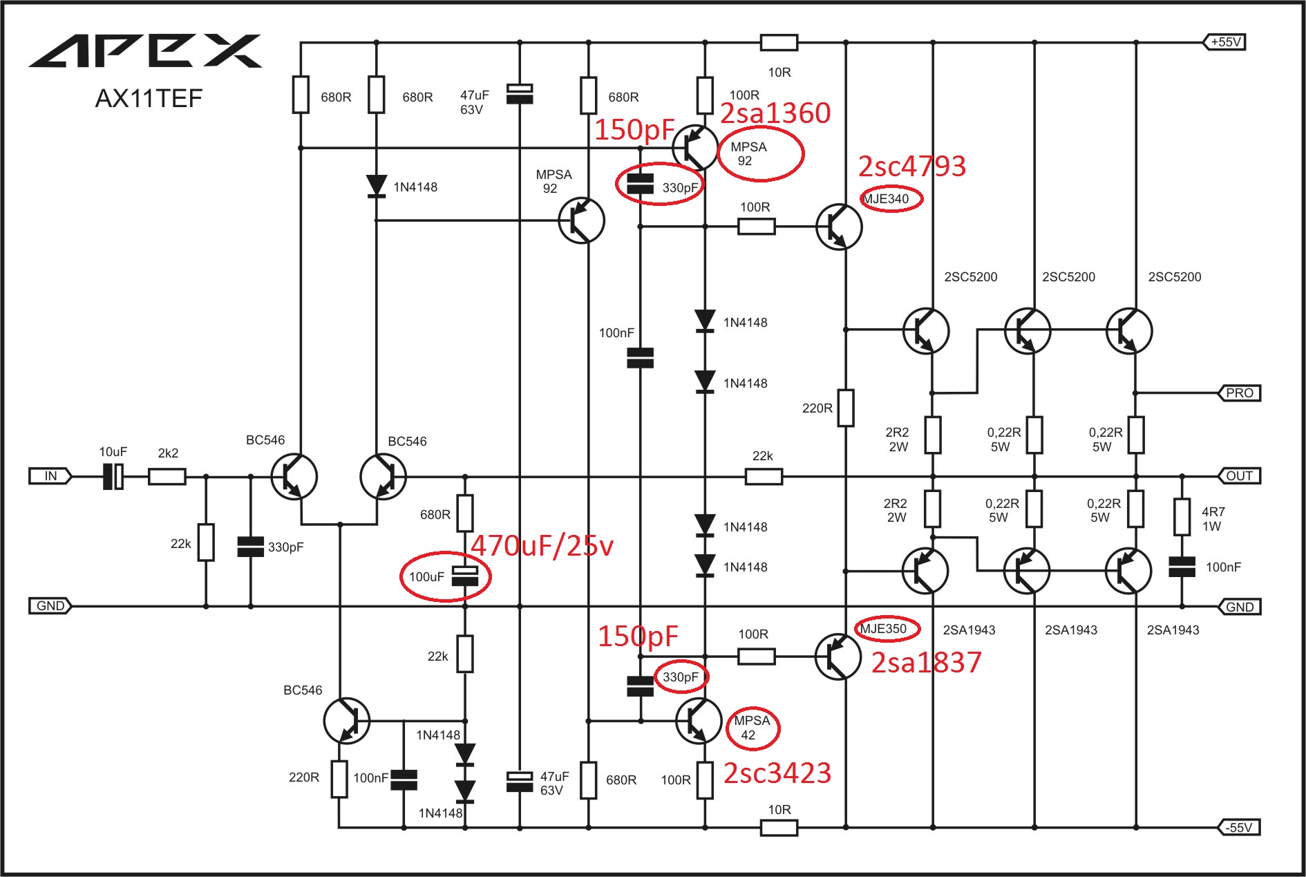

Thanks. Any recommended alternatives as these are kind of hard to get from a regular supplier like Mouser and Digikey. They seem to be availnale on eBay only.
Dont buy the latfets off the bay. You might end up getting the "TOSHIBA" ones😀.

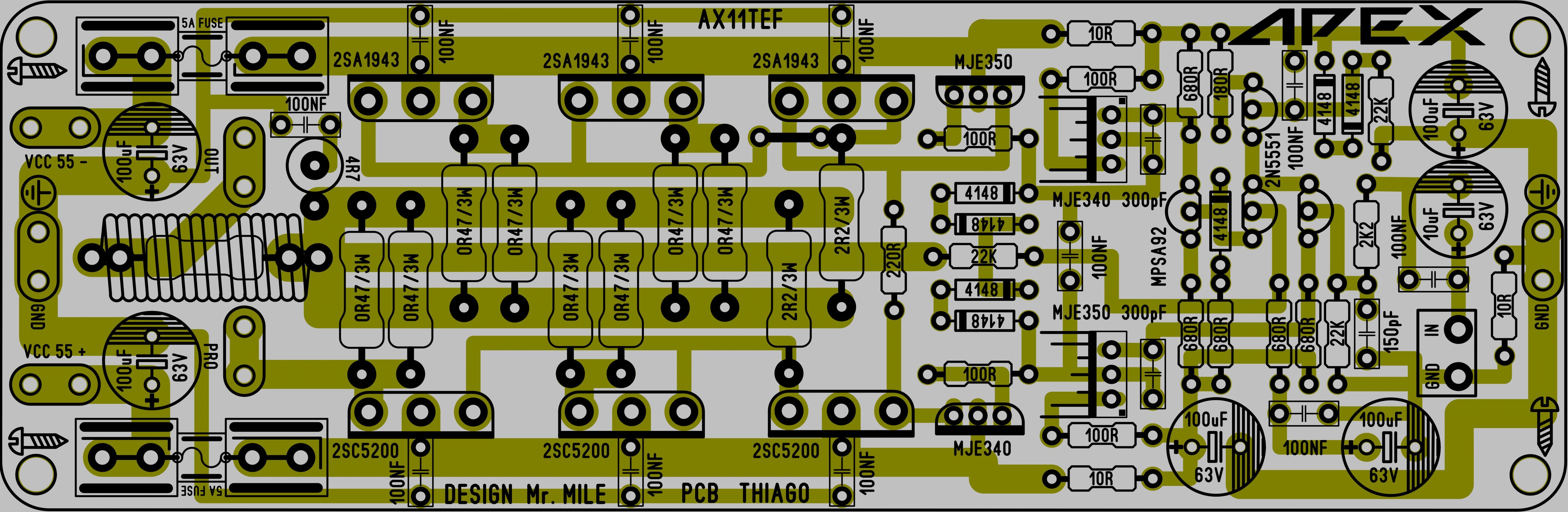

Nice pcb, thanks. You have wrong notification for outputs 2SA1943 instead 2SA1940 and 10R/1W work with 1mW disipation so you don't need 1W resistors, 0,25W will be ok.

Done. Thanks
"to separate i/p ground and power gnd on your layout"
Done. Thanks

No you can't replace Lateral mosfet with vertical mosfet. You can use other lateral mosfets from Exicon or Semelab.
I am getting confusing info here because I am seeing that IRFP240/9240 are lateral MOSFET's. They are actually used in many Pass class A amps.
Where does it say they are vertical topology?
IRFP240/9240 are not Lateral mos but vertical ones....
Marc
Ok I see it now. The vertical hexfets can be used for audio but need a very high bias current bordering on heater class A operation to be linear.

sir, what is the rms power output in 4 /2ohoms speaker if I use 55 0 55v/1000va transformer in apex bx20 amps?
400W/4R 650W/2R

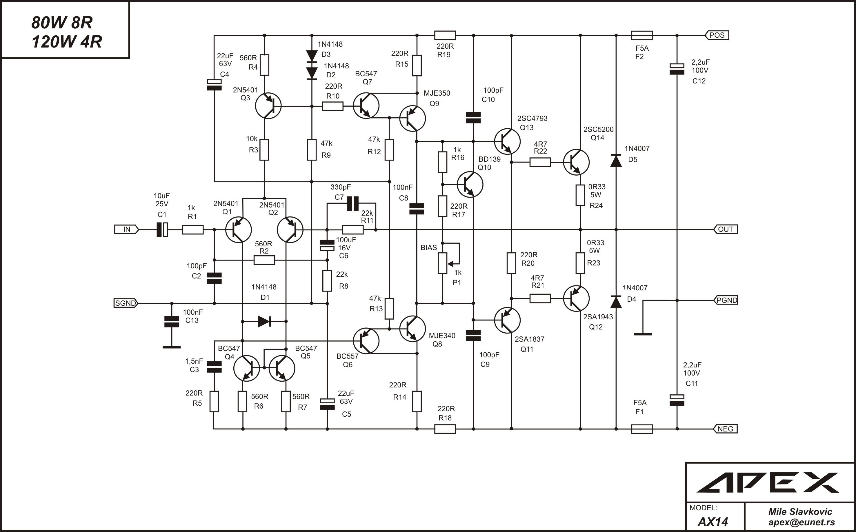

this might be a silly question but but anyway here we go, my question is does Q8 and Q9 need to be thermally couple together or is not really needed ?
No need but you can thermally couple Q1-Q2, Q4-Q5 and Q8-Q9.
Am no expert Jaun,But I did try both the options and definitely there is an advantage in coupling them thermally !!
Without coupling I got a DC offset of -20-40mv and after coupling I got -2mv !!
Regards.
Regards.
Regards.
thank for the replay I will try this way thank again 🙂 uhm -2mv amazing indeed !
No need to thank as I/we have to thank you for all the help and support that have providing/ed
Am sorry but there was a small mistake in my post above,When I say thermal coupling,I just put both on a same heatsink (as opposed to attaching both face to face) Q8&9 that is,Where as Q1-2,4-5,6-7 I coupled it treditionally (put them face to face,It was mother of all pain as the layout is not designed for the same,In the bargain broke legs multiple devices 😛). Q6-7 might not yeild any postive result but I still went for it just cause..............
If you match them then almost 0 Dc offset is possible,I myself without matching got almost -0.9mv at one point before breaking the legs
Hope this helps and I have not caused any problems with my above post.
Regards.
thank for the replay I will try this way thank again uhm -2mv amazing indeed !
Regards.
