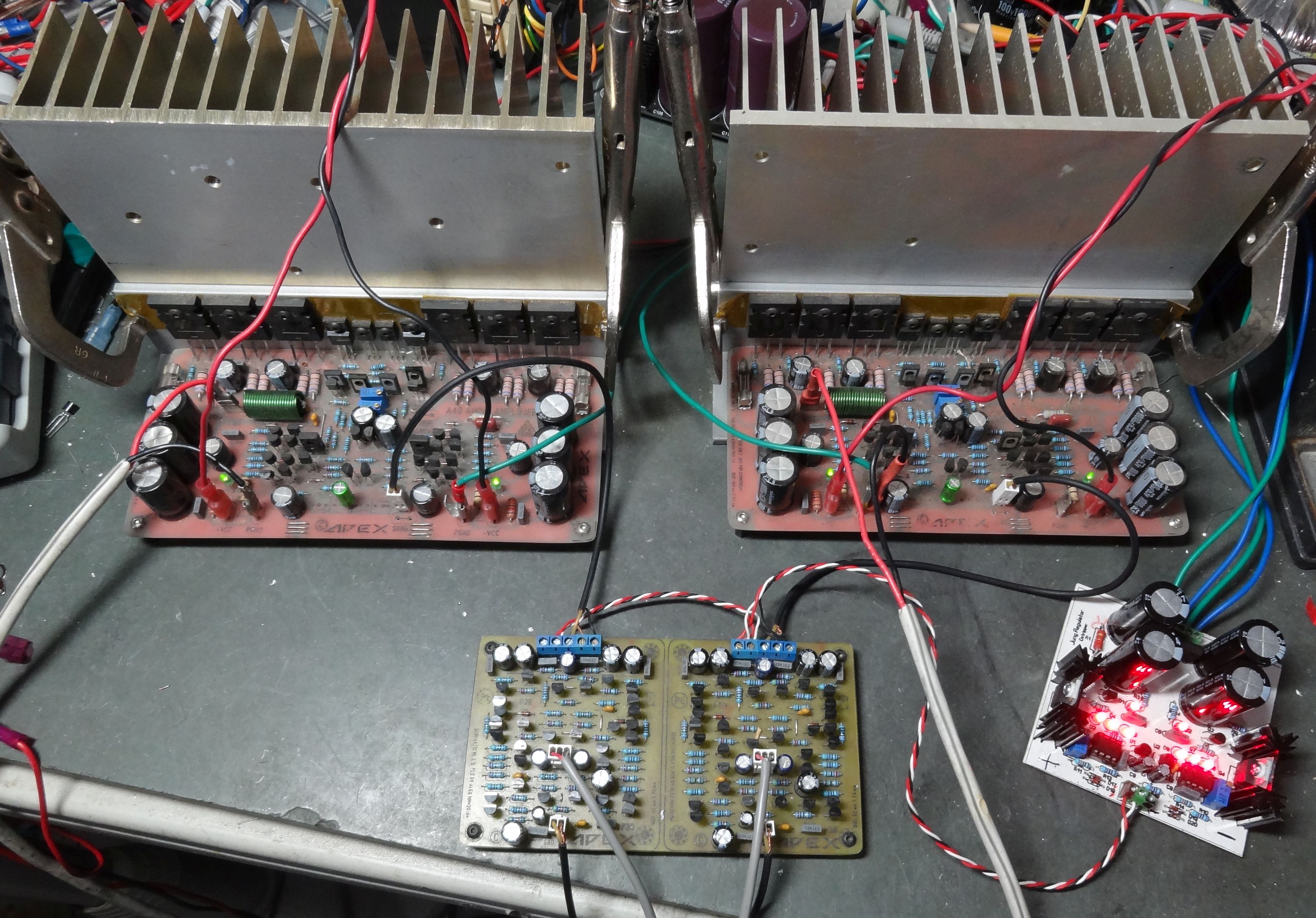

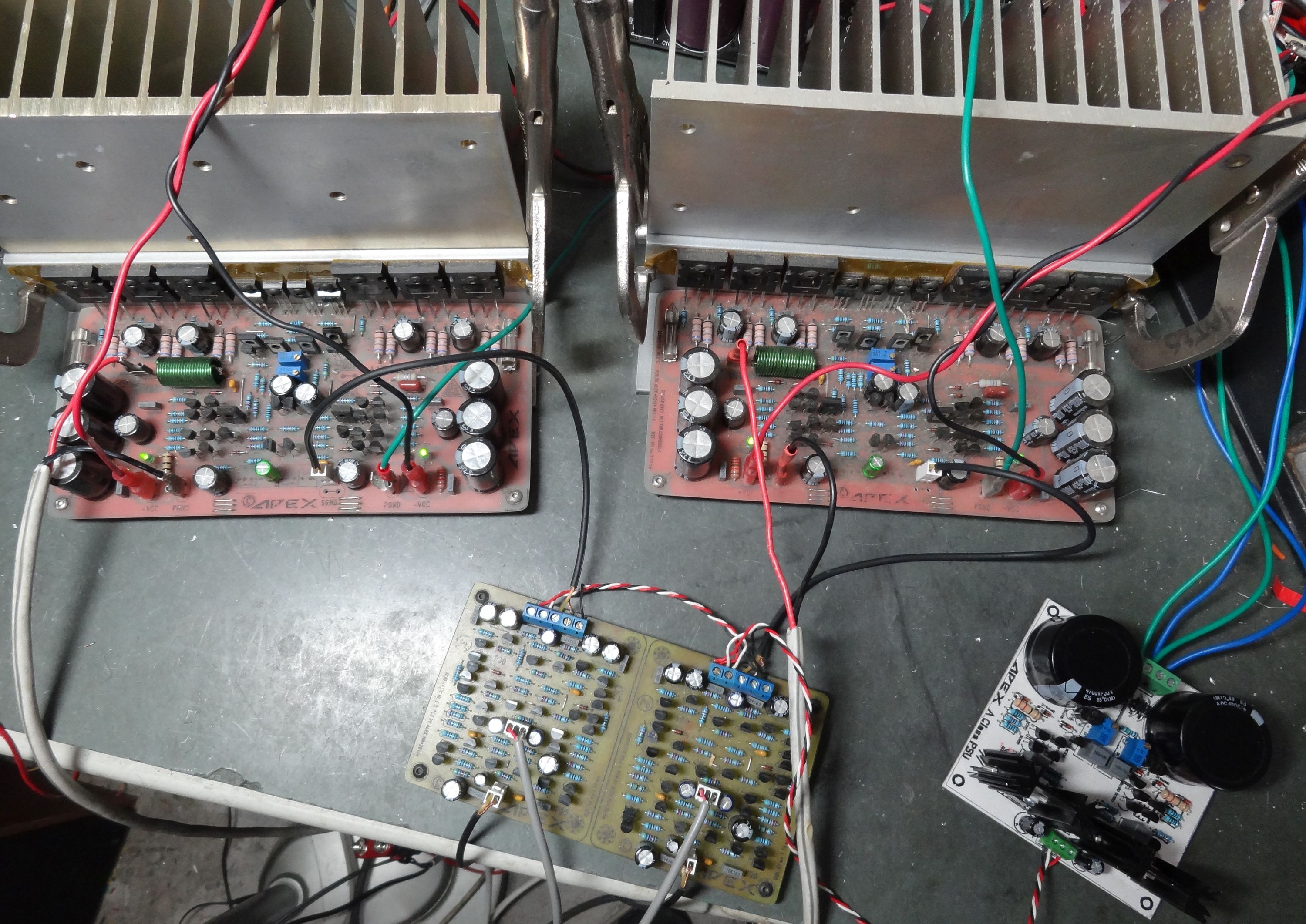

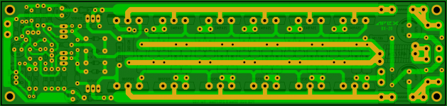

Hi Mile,
I don't think I had ever tried the A40 together with the P30 so this morning I hooked them up. OH MY!!!! Talk about a power house. This thing was rattling my windows. I don't remember the last time I felt bass like that. Like someone was punching me in the chest. I have got to get this in a cabinet. Too good to reside in the amp pile. Thanks for suggesting it.
Blessings, Terry

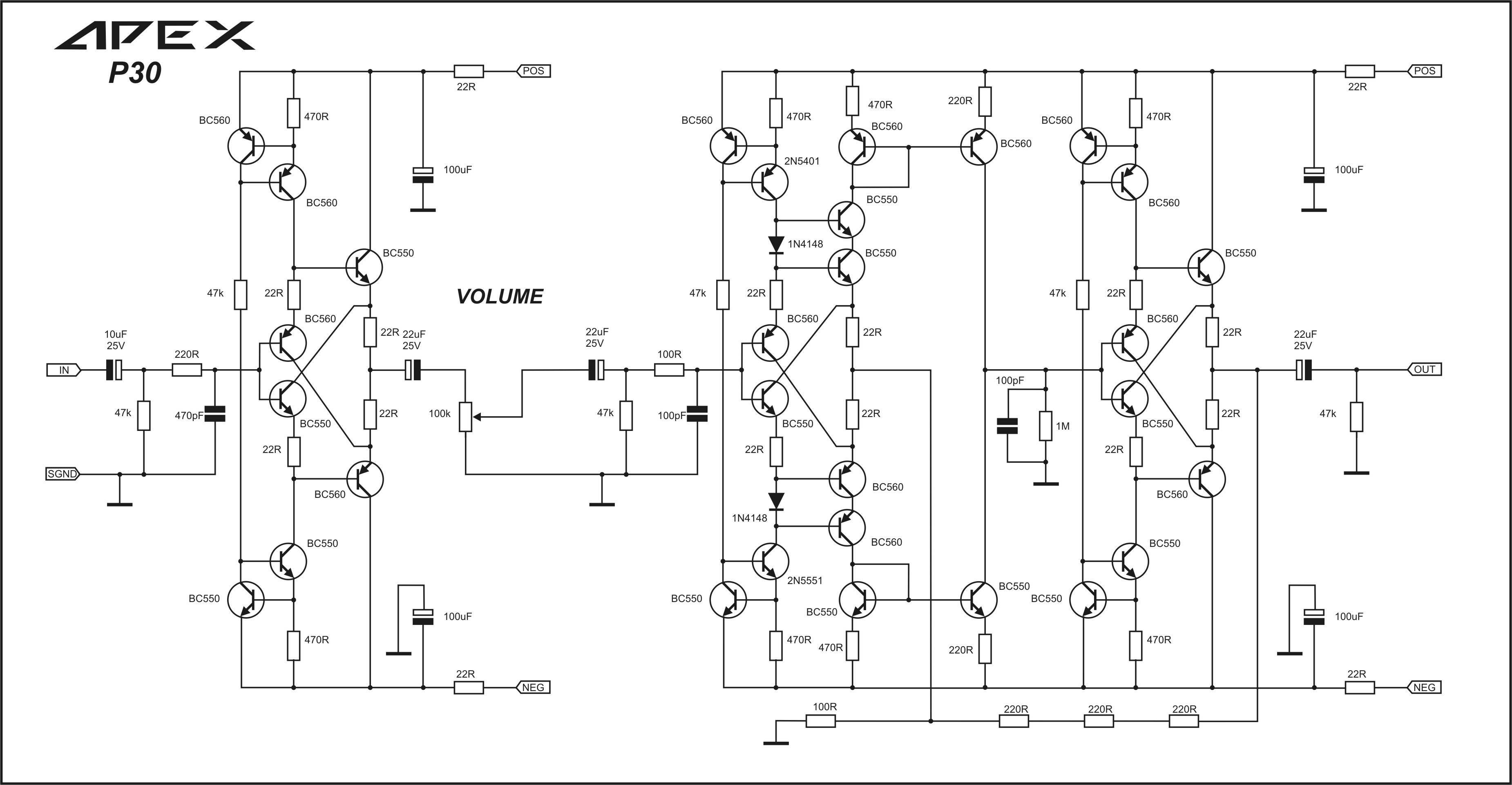

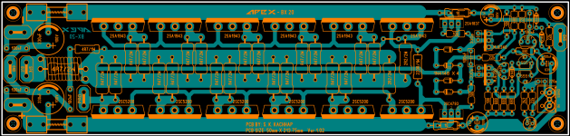

Hi Mile,
I noticed today that I have some offset on the output of the P30. There is no adjustment. Where would I make changes to correct this? The A40 has an input cap so it isn't an issue but some amps are DC coupled so it would be for those.

CFA topology have high DC offset without DC servo circuit, P30 use output cap so +/-1V before cap is not problem. Use nonpolar/bipolar 22uF output cap as Dragan already suggest.
Regards
