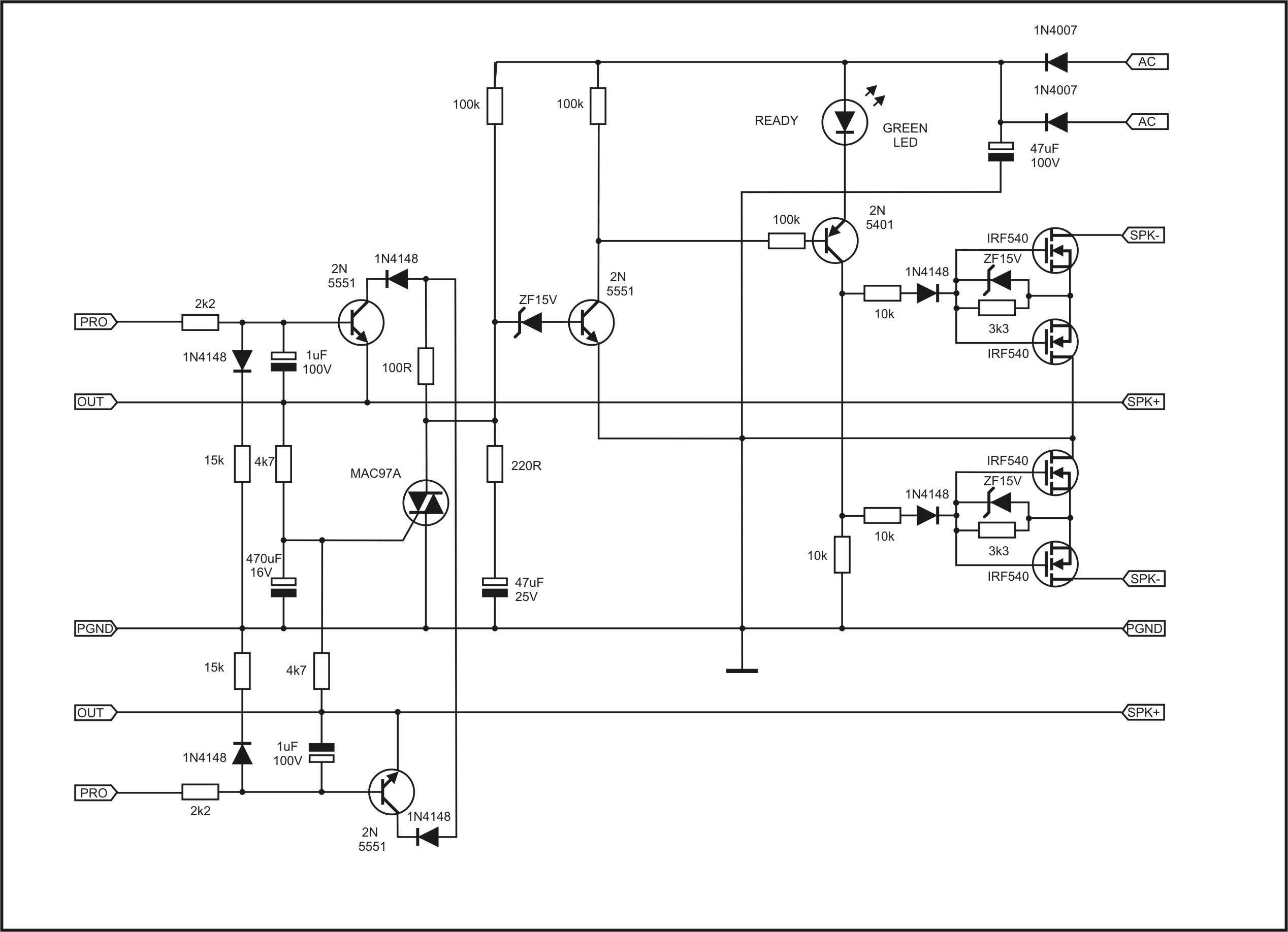

Remove 2k2 resistor (in parallel with 470uF) and protect will detect +/-1V DC offset, use 100uF instead 470uF if you want fast protect... Short circuit protect work only with amp and input signal connected.
Hi Mile,
I pulled the 2k2 and now it will trip the speaker instantly with +1.5vdc from PGND to speaker in/out. However, it takes at least -6vdc to cause it to trip.

Use this circuit with TO92 triac instead transistors for DC detect.

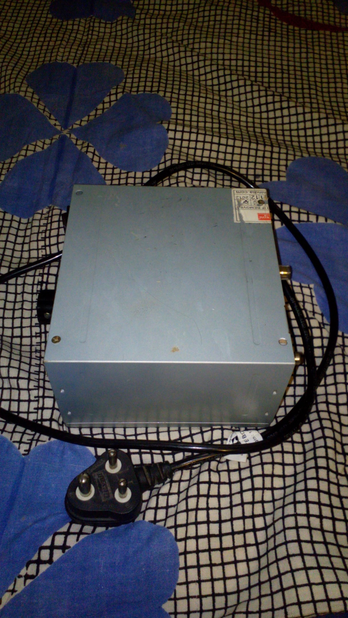

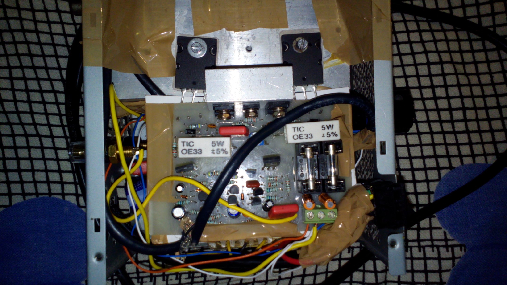

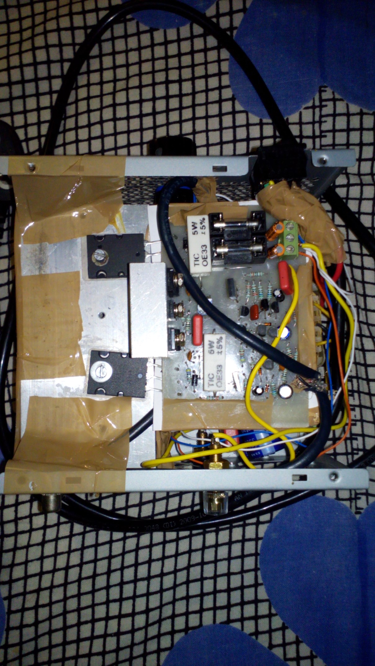

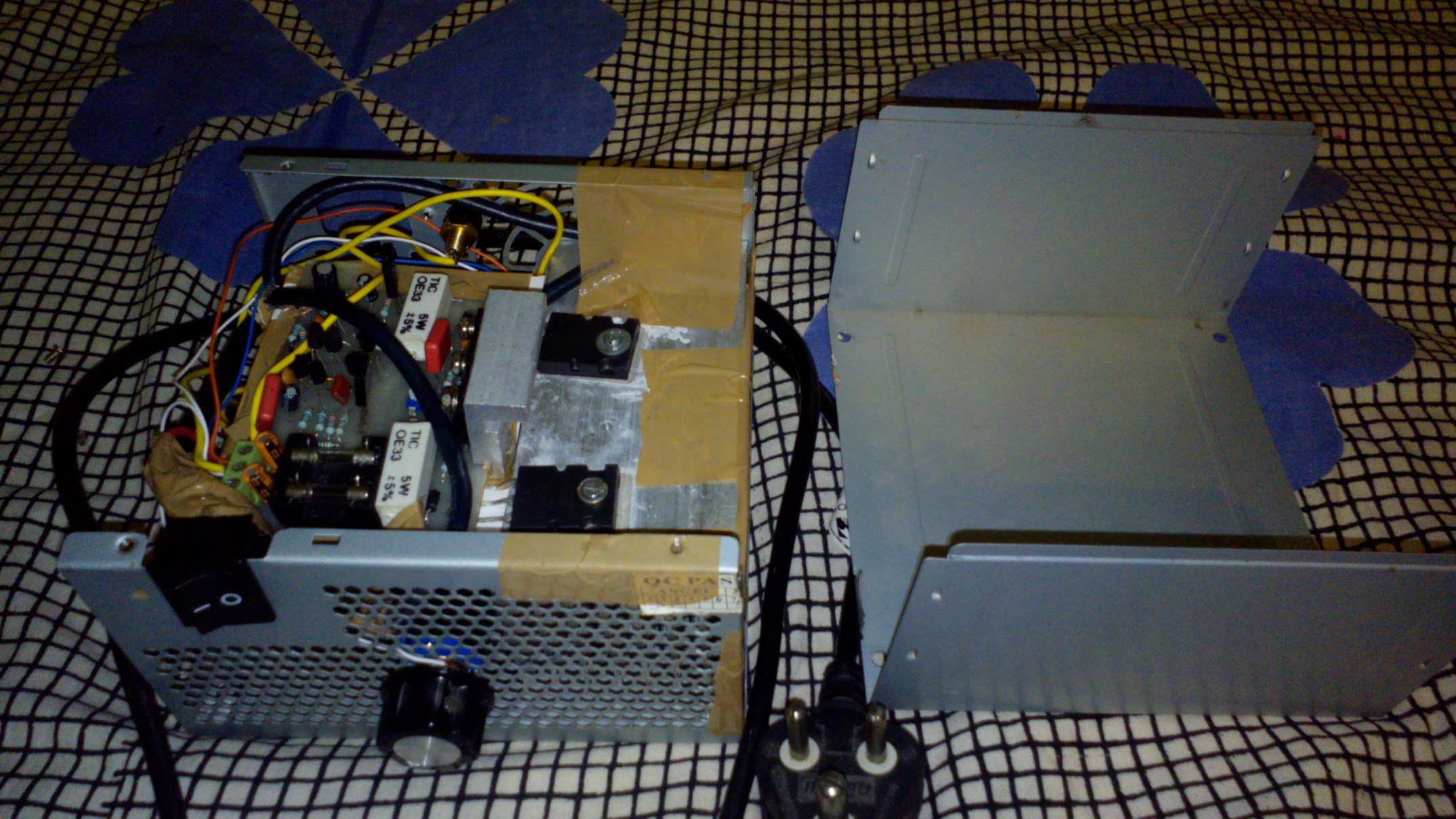

My AX-14 Diy in computer PSU running
I must say very innovative and unique build. BTW what was the problem earlier and how did u solve it?

The new build fault of bulb lighting up was a mistake i put ttc5200 in the tta1943 slot i changed it started to work.
The old bakelite i build earlier was i put a lower value that is 20pf puff instead of 33pf capacitor which started heating the output transistor c5200/a1943 very fast after some time it gave speaker output of 14vdc look llke some small transistor got damaged. I fixed it by building again.
BD139 vbe multiplier should be mounted on same heatsink along with 2SC5200/2SA1943. Add zobel network at output as suggested by miles.
My concern is amp module directly mounted over EI transformer.

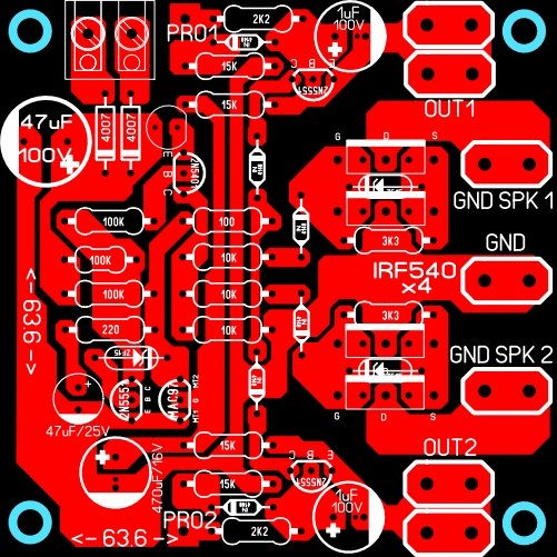

PCB from latest SSR protect schematic.
Please check
Sprint layout file attached
Hi C08bm,
I think Mr. Miles suggested to reduce 470uF to 100uF for faster response. also only one 1n4007.

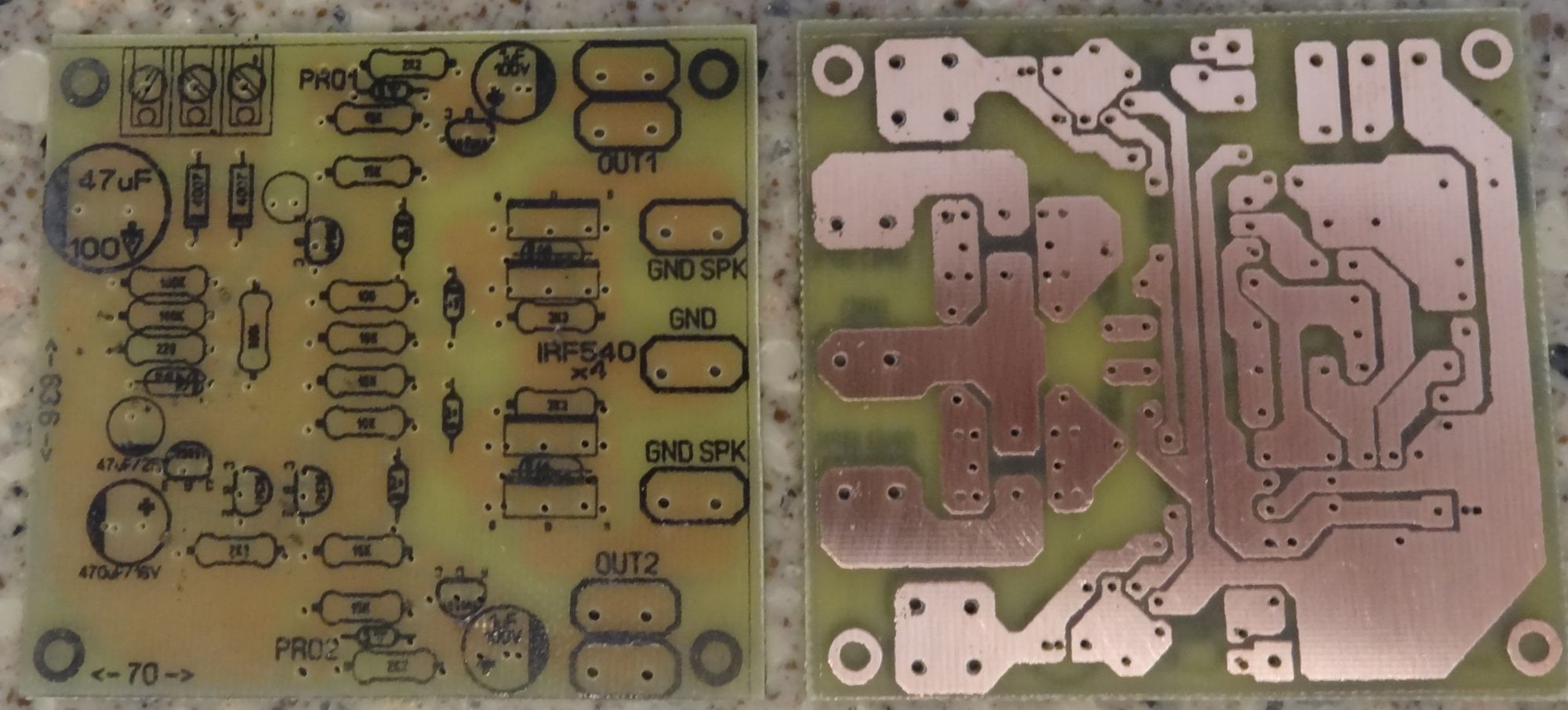

I etched a pair.
I'll try one when the MAC97a's arrive.
