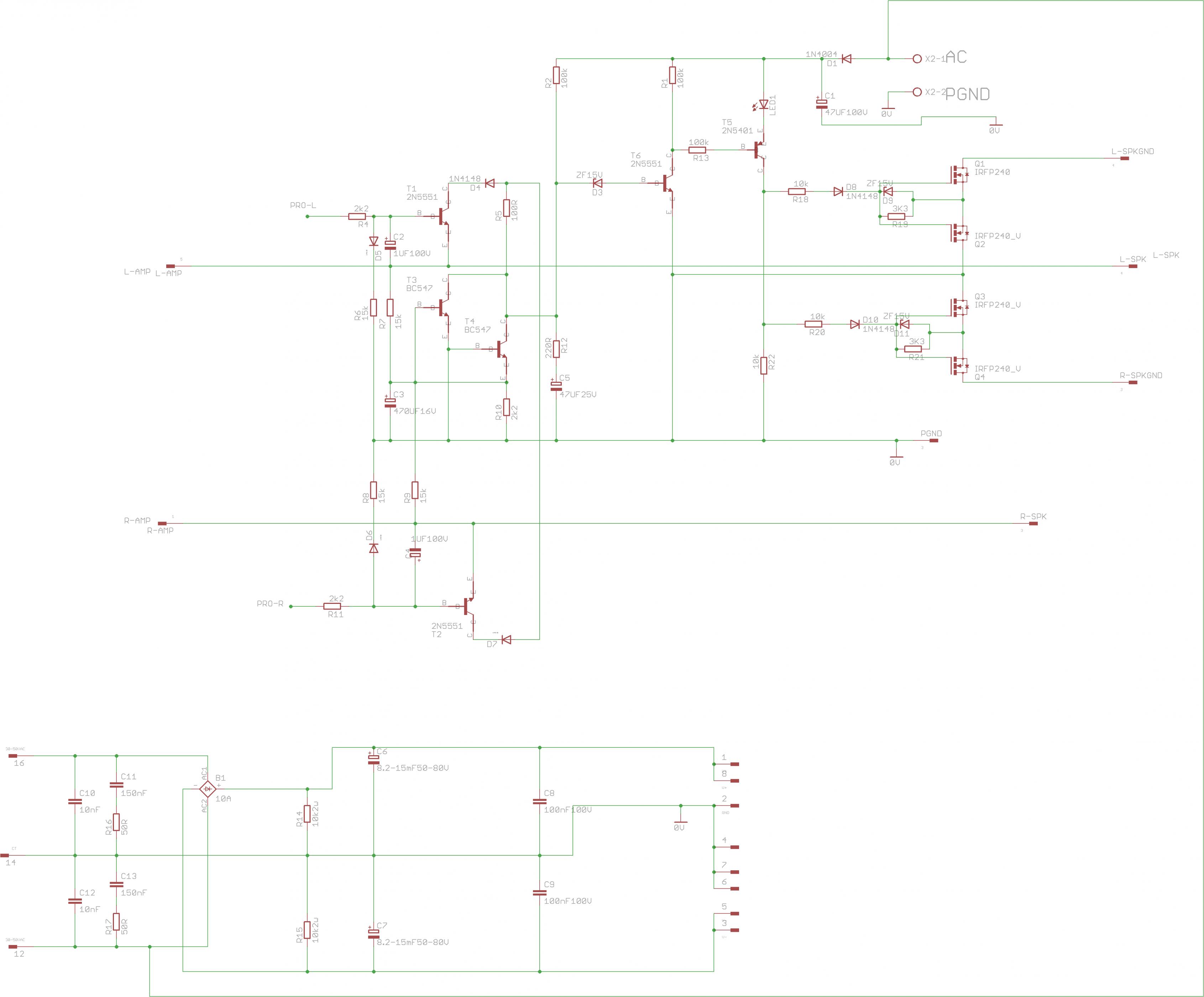

Hi Mile,
Can you please check the layout in post #5504? I am testing it and I have 150mV offset. I measured and pin #4 is pulled down to 0.3V. If I pull the IC then pin #4 goes to 15V but pin #7 drops to 3V and the offset goes to 15V. If my layout is right then something is wrong with the circuit.
Thanks, TerryThe -IN is sensitive to pick up.
Keep it's resistor very close to the -IN pin.
What is rail voltage? Replace R17 and R18 with 470R/2W to get +15V on pin 7 and -15V on pin 4... can you post pictures?

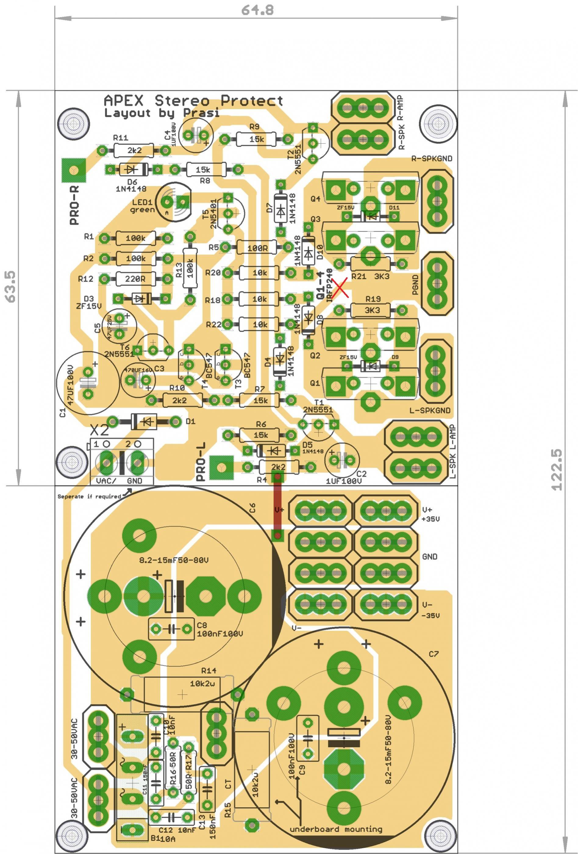

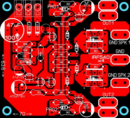

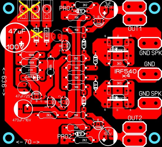

Hi c08bm,
shouldnt the PGND be connected with the drain of mosfets as in schematic and alexmm layout ?
regards'
prasi
I considered ground to be linked on PSU, but it can go also with grounds linked on protection board
Alex is according to schematic,c08bm isn't.
Where is c08bm's off from the schematic?

Hi Mile,
That seems to be the answer. I was testing at +-47V. I raised it to +-55V and now I have +-16V at the zeners. However, 39V/1k is 1.5w so obviously my 1W resistors are not sufficient. I may take your advice and lower R17 and R18 anyway because I think +-55V is a little high for a single pair of outputs.
Hi Mile,
With single pair use +/-35V, +/-40V is maximum, and R17,18 can be 470R/2W...
You can use single AC and only one 1N4007 to supply protect and with only one GND connection from main PSU.
Yes, but all ground traces must be connected on the board right?

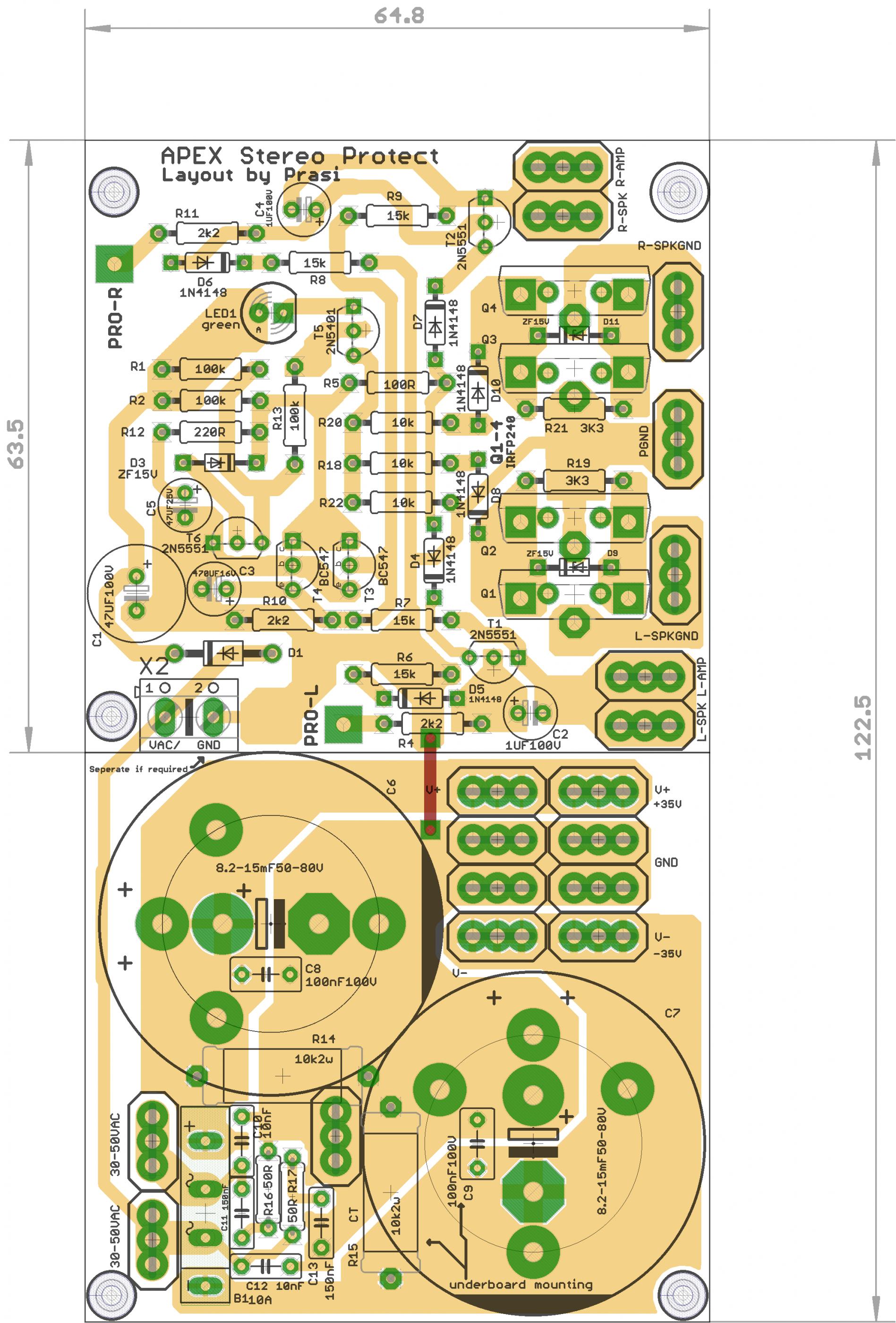

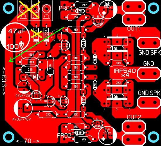

Is these not the PS ground (green arrow)?
I ask because that is connected to the capacitor etc and you X-ed out ..
I think we need that
Yes like on pcb from post #5562
Like this? I have connected the ground traces on the PSU to Protect with a jumper. only one of the ground connectors can be used here (jumper, 2 pin connector or faston connector).
Yes, like that and use only PGND to psu GND connection or use red jumper and cut this trace.
I just tested the protection circuit. It takes at least 9Vdc on the output to activate it and that takes almost a full second. 12vdc takes just as long. Shorting the speaker terminals does nothing. I don't have an amp hooked up to it so that may make a difference.
oops!.(speakers would be fried by the time protect comes into play. ) may be some components need adjustment in values, Mr. Mile can suggest something.

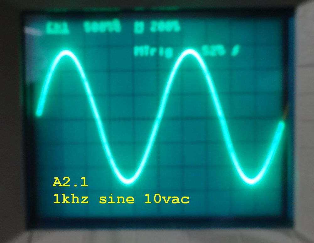

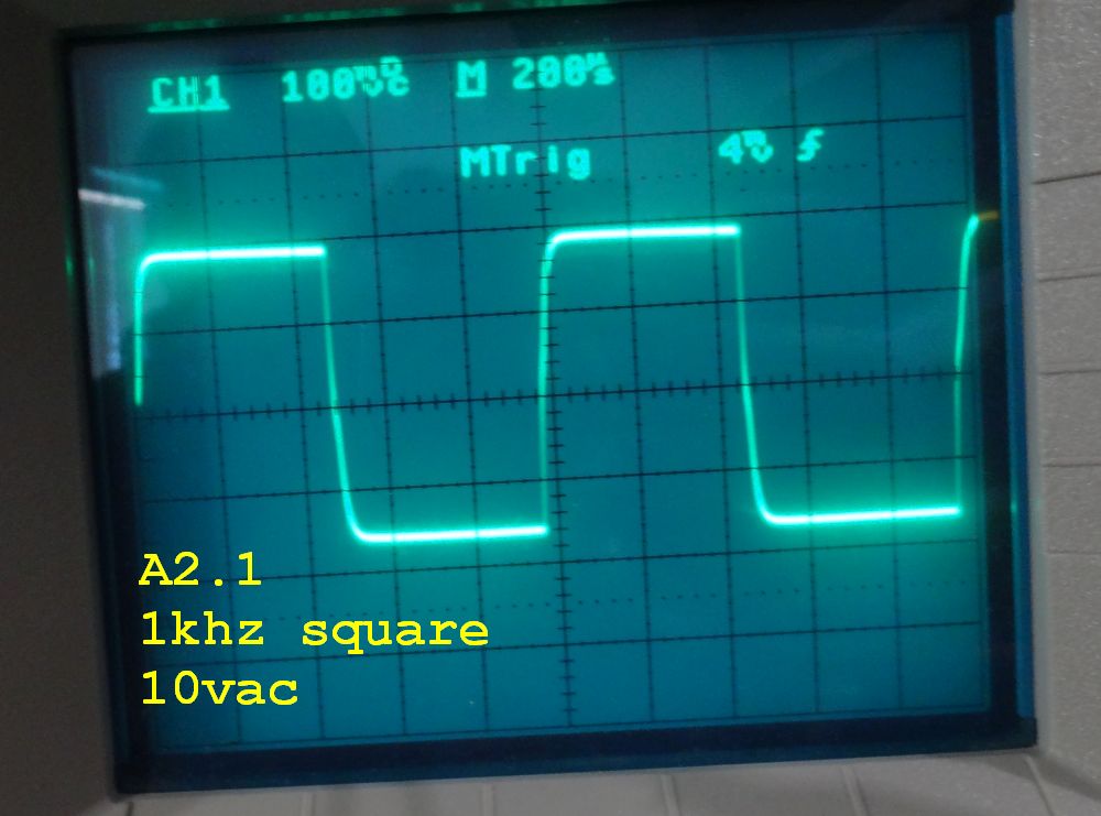

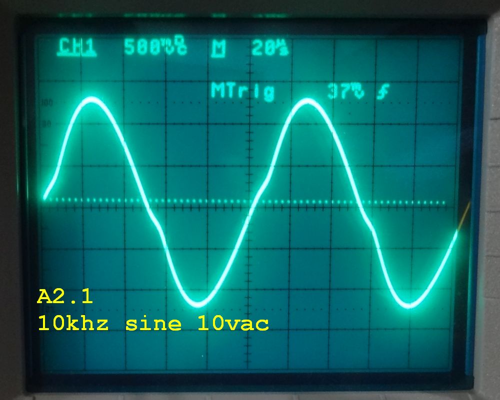

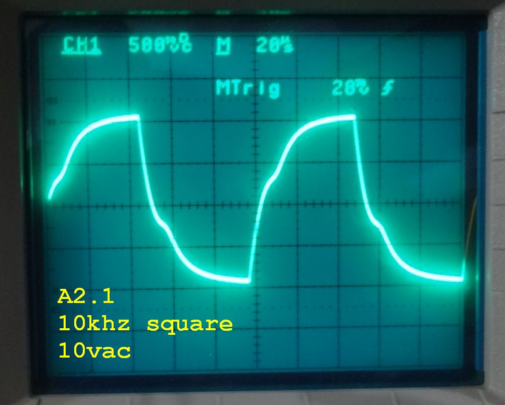

Hii Mile.
I discovered the issue with the zeners. I didn't have the input shorted. Once I did that the offset issue went away. However there are other issues that need to be worked out. Bias is too low. Only 26mA per rail at the fuse. Gain is very low, only about 16x. Square waves are very rounded. Do you have some recommendations?
Thanks, Terry
Lowering 470uf should make protection faster.
Pro pin must be connected across positive emitor resistor for short circuit detector to work.One way to test it is to short speaker terminals and put pro pin to positive voltage
Remove 2k2 resistor (in parallel with 470uF) and protect will detect +/-1V DC offset, use 100uF instead 470uF if you want fast protect... Short circuit protect work only with amp and input signal connected.
Hii Mile.
Thanks, Terry
Use 500R (1k) trim pot instead 1N4148 diode to set bias. Amp is overcompensated for working prototype...
