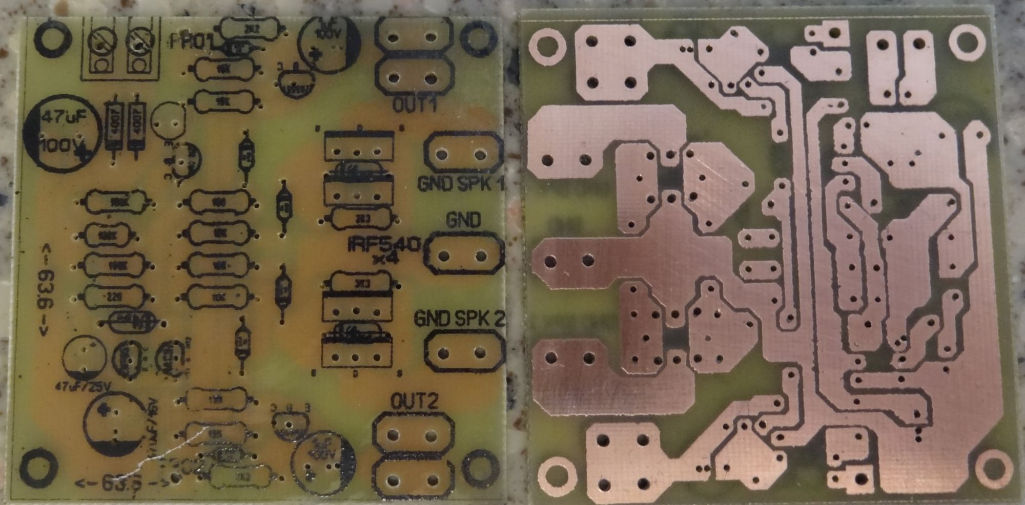

I was wrong. I etched the wrong ones. Too many downloads. 😀 I etched a new pair. I will catch the 4k7 when I populate.
Blessings, Terry

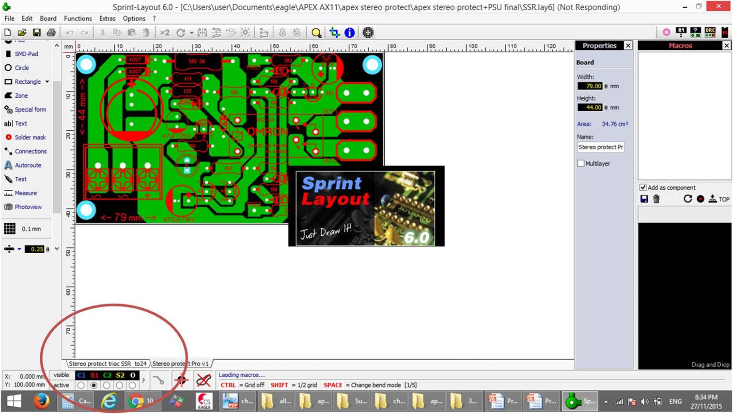

The circuit actually works with the changes suggested in post #5579. It will trip instantly with +1v5dc on the output. I tested another dc protect unit that I have and it works the same way. +1v5 and -6V to trip. Probably not an issue as 6v won't hurt a speaker.

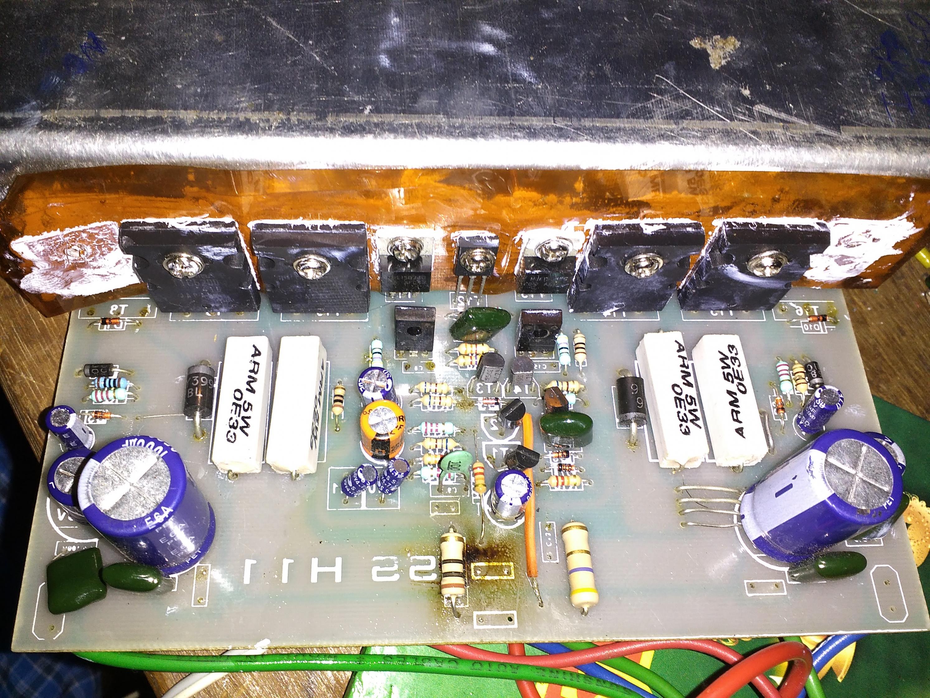

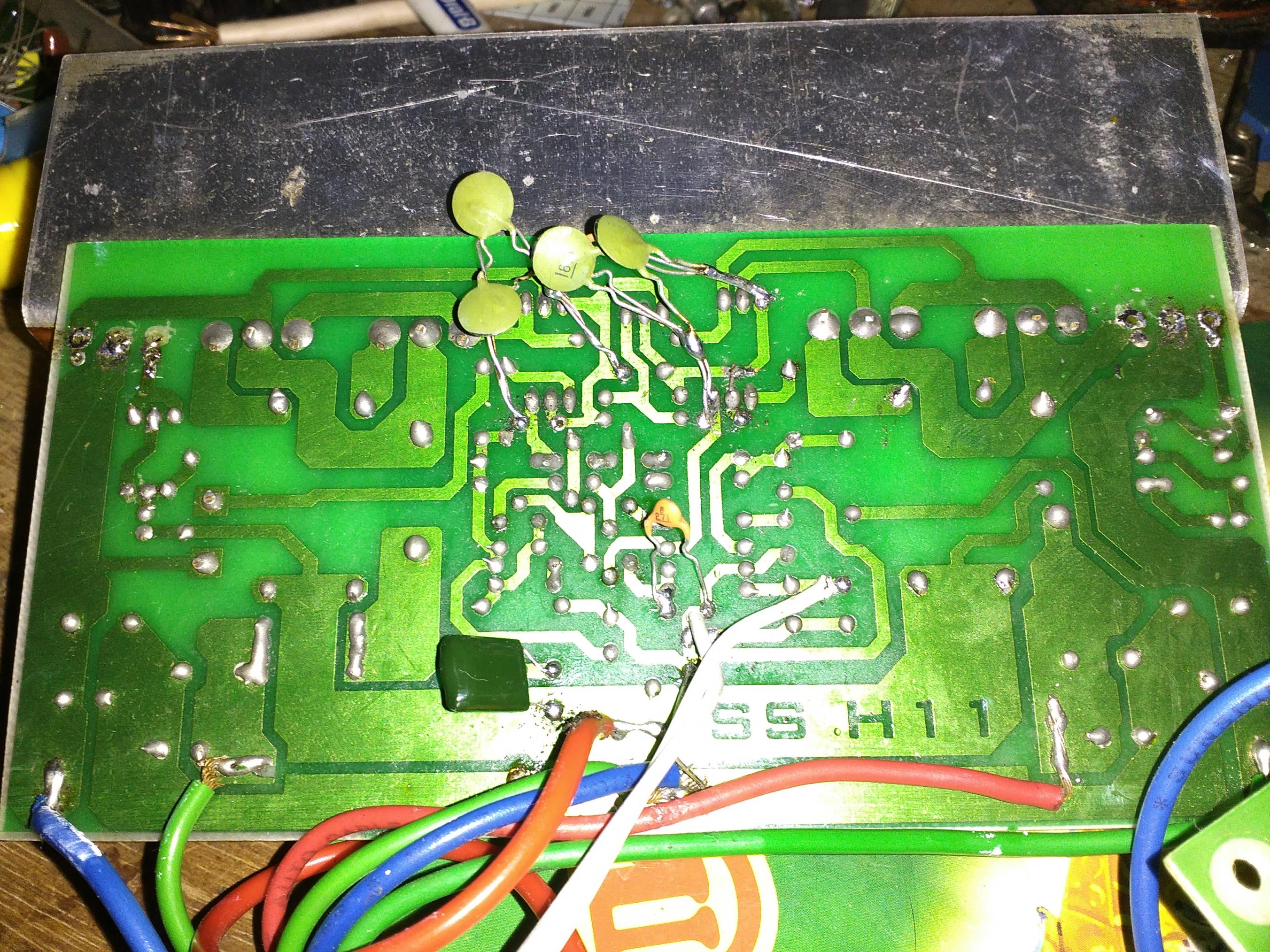

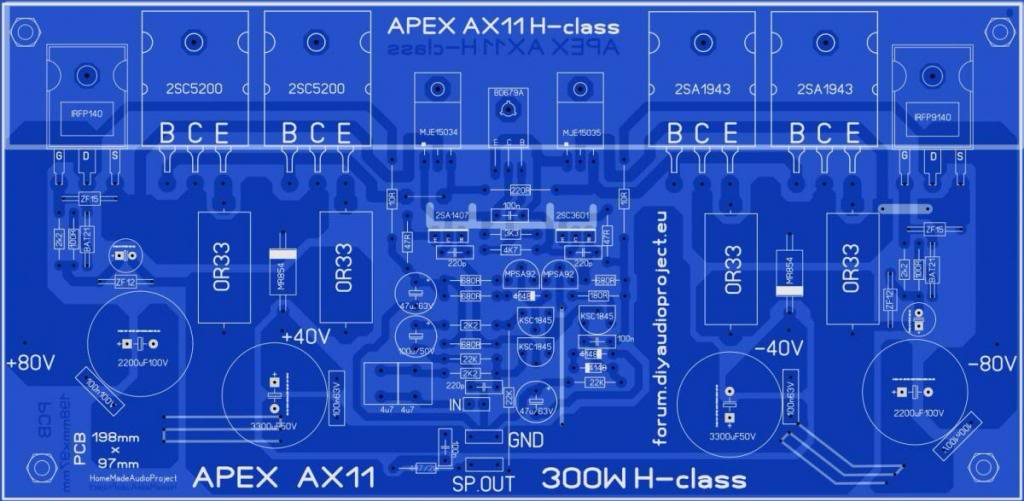

hi

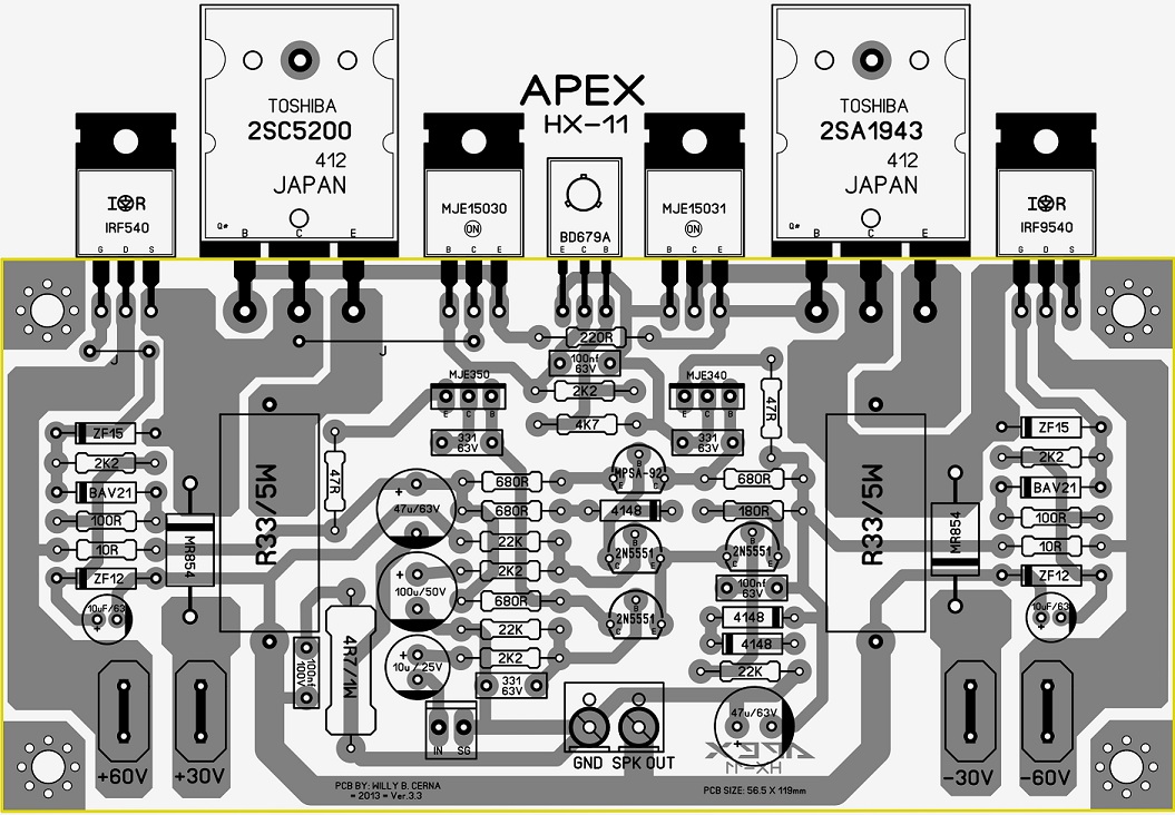

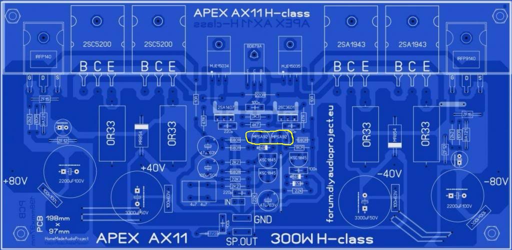

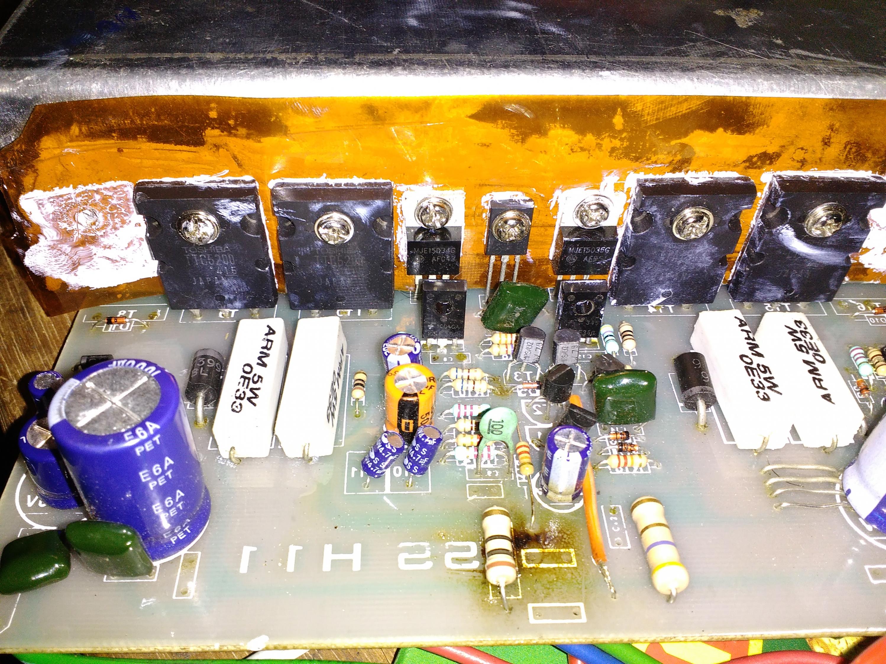

i am working on apex 11. i could not get the correct response , i am getting the poor bass response and getting the high hf response. ie i am getting 19 volts at 100 hz and 55 volts at 10k.
i have given 30 volts at low rail and 60 volts at high rail voltage.
please help me to correct my errors
