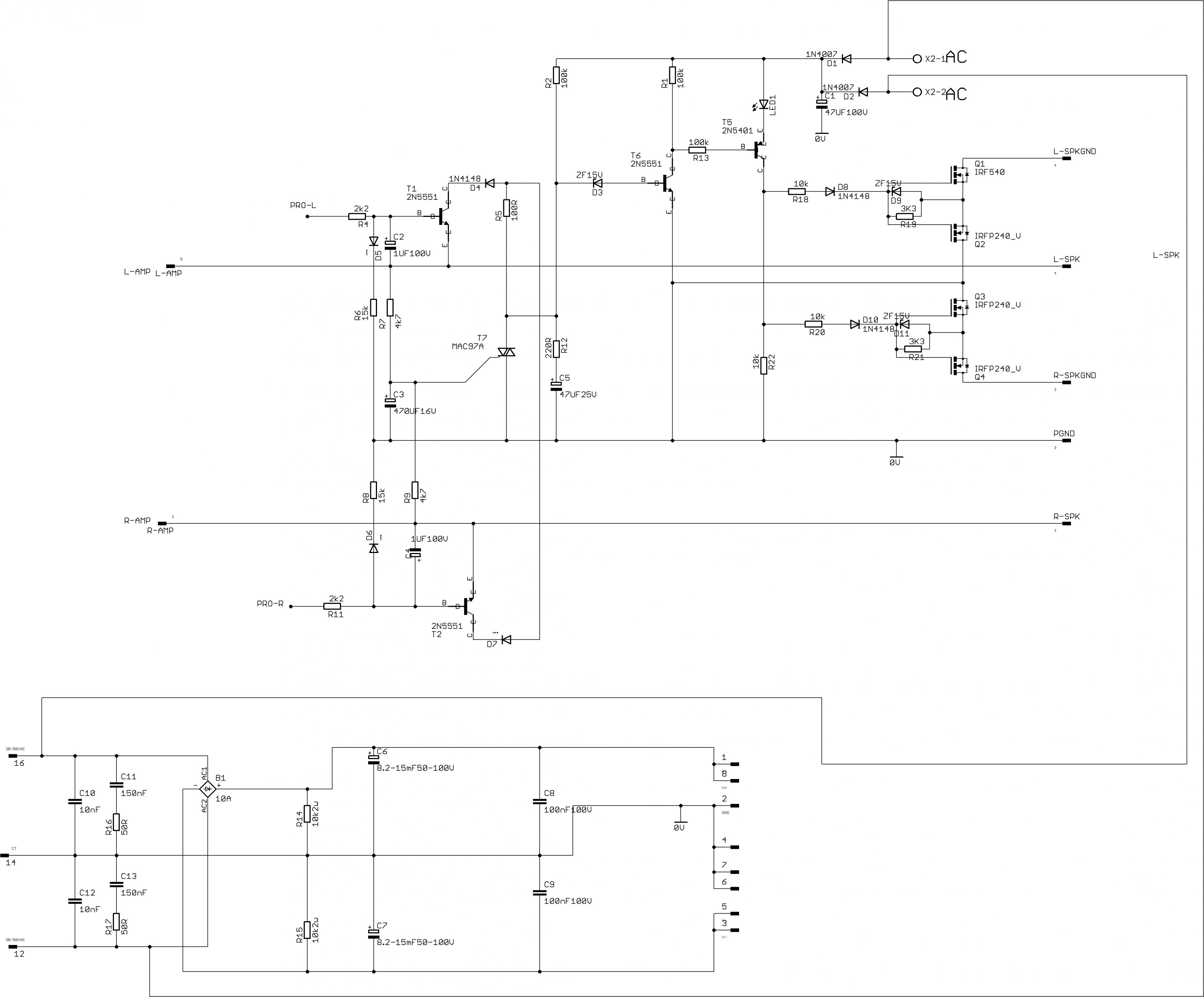

PCB from latest SSR protect schematic.
Please check
Sprint layout file attached
Hear is my implementation of Apex SSR+PSU for those interested in combining PSU and Protect in one PCB.

PCB Not tested but consistent with schematic, Attached .

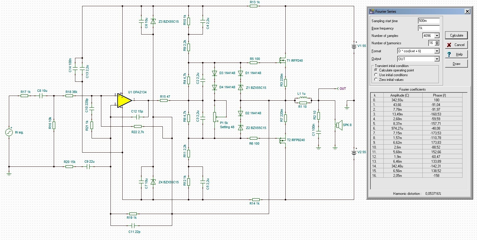

You are still testing at +-55V. Too high for one pair of outputs. How does it look at +-36V?A2 simulation with IRFP240/9240...
How do you handle thermal compensation?
Thanks, Terry
Thanks, Terry
This is only simulation, 1N4148 will be replaced with Vbe multiplayer like in F100
Then it will be A3.😅
Yes or A5 if I add Vbe multiplayer on A4 🙂
