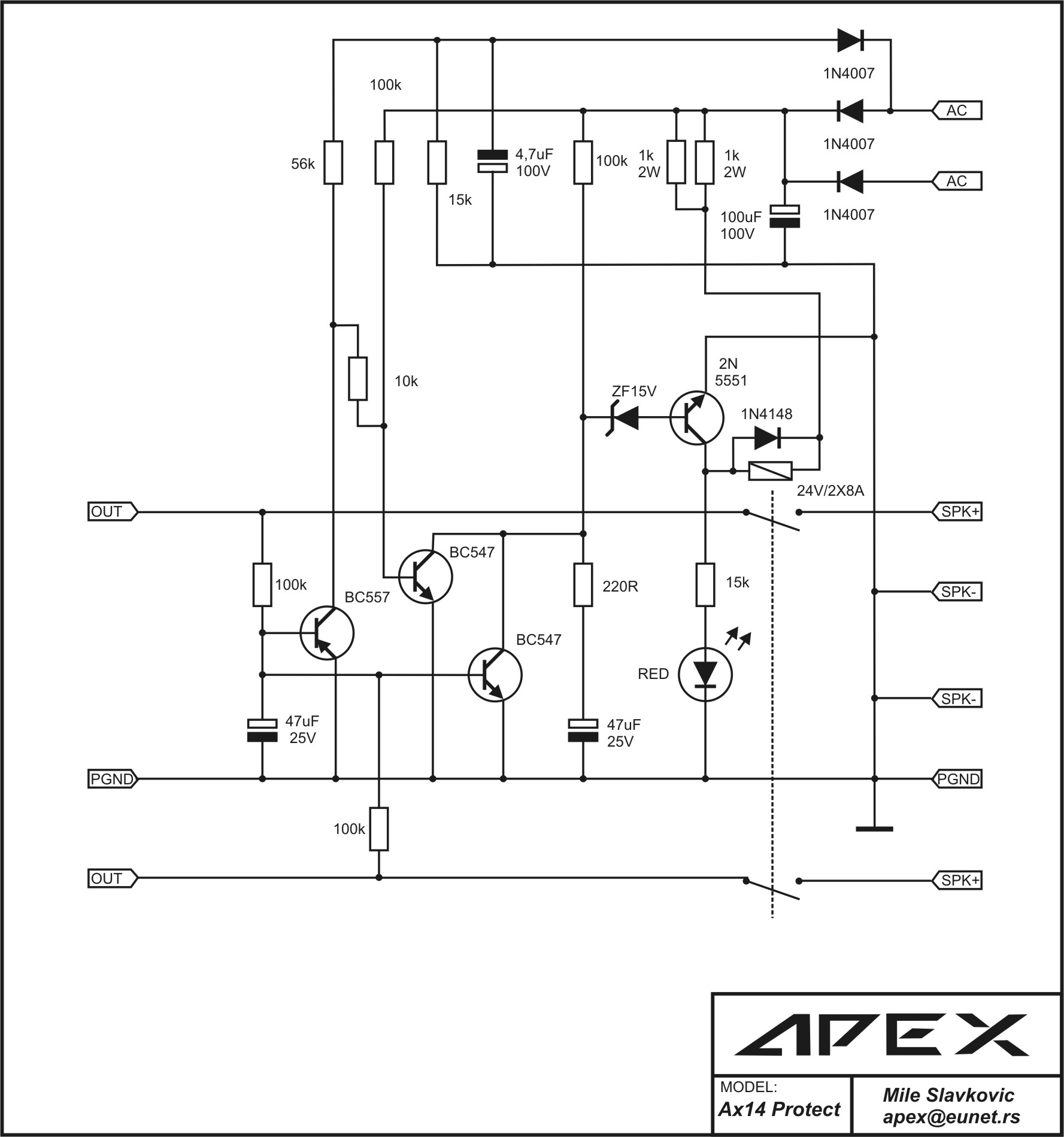

This DC protect have AC off detect circuit to fast switch off relay and about +/-1V DC detect circuit.
The question is what is the probability that the output of the amplifier have +/-7V DC offset. Many protections have similar circuit for dc detection (working amp have output DC offset about +/-50mV max and broken is on rail voltage about +/-50V). If necessary I can modify circuit to have the +/-1V DC sensitivity.
Please do it!🙂
