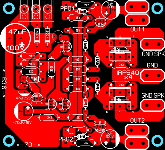

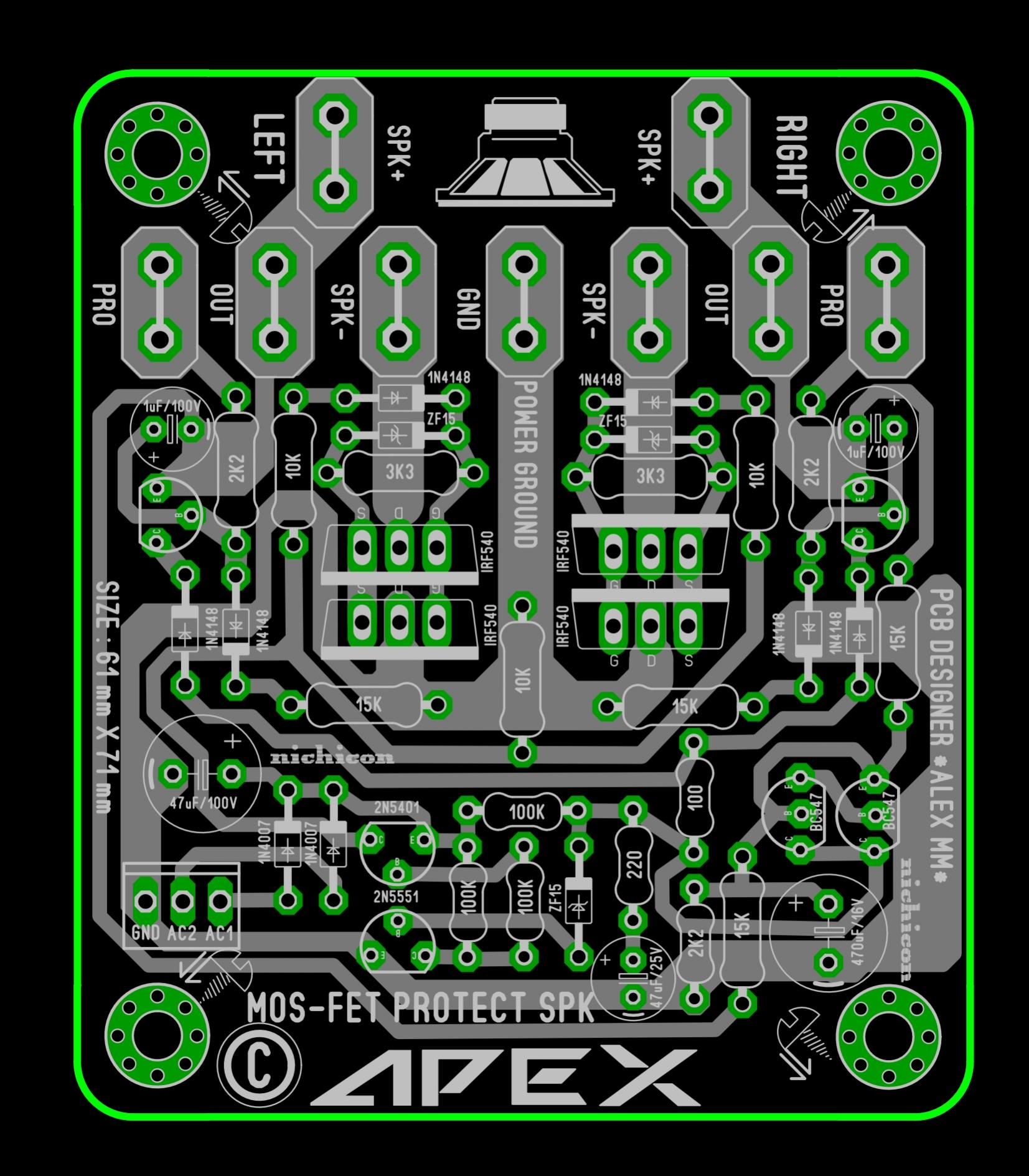

PCB rev 1.0 mosfet APEX protect
Another PCB layout for mosfet relay protect ,not tested yet 🙂
Regards,Alex

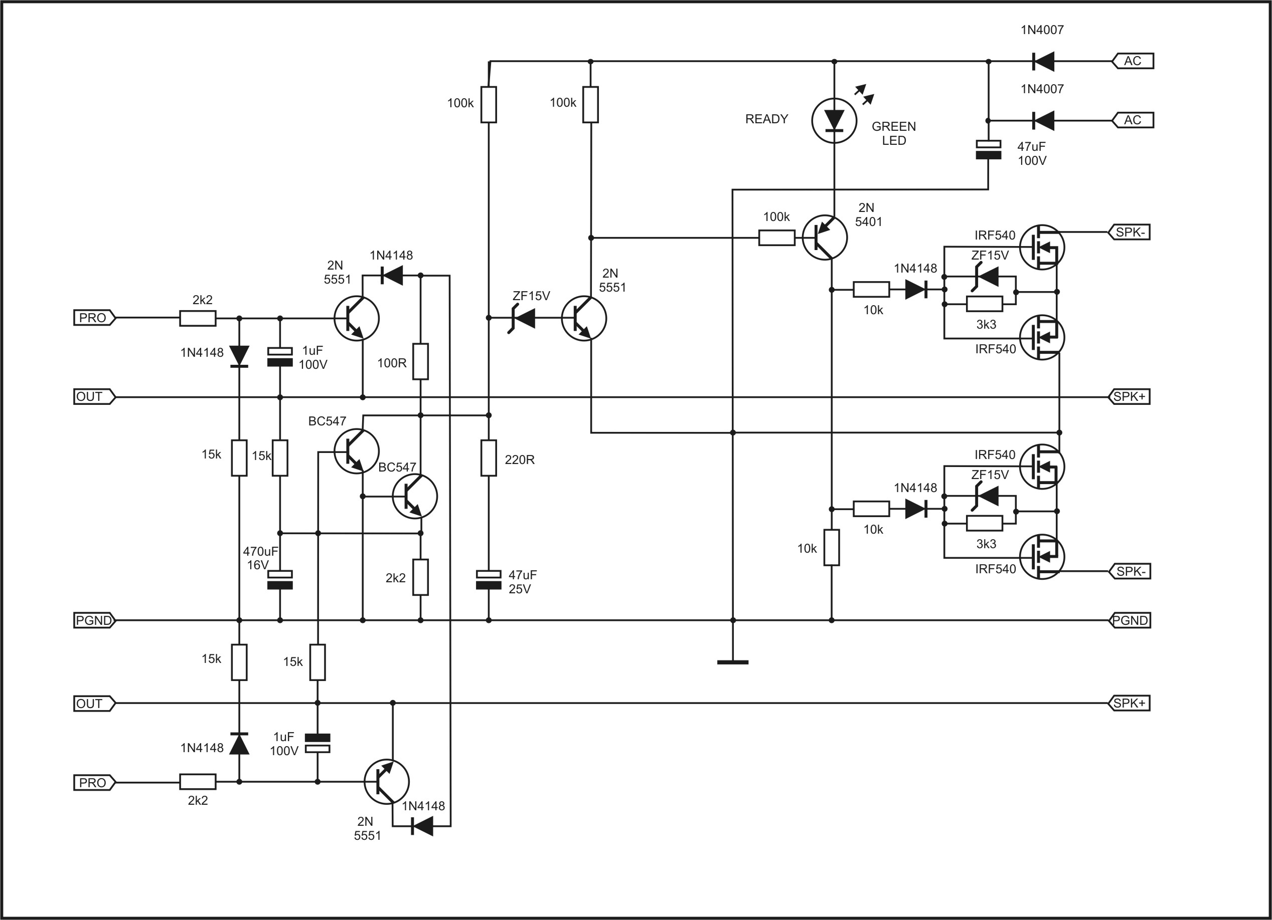

There is two more mistakes 100k instead 3k3 and protect LED must be connect like this.
Hi Mile,
Thanks for the correction. I see Alex has the 3k3. Is the LED an added feature? I don't see it on the schematic. I thought c08bm just added it to show on condition.
Thanks, Terry
Does this look correct now?

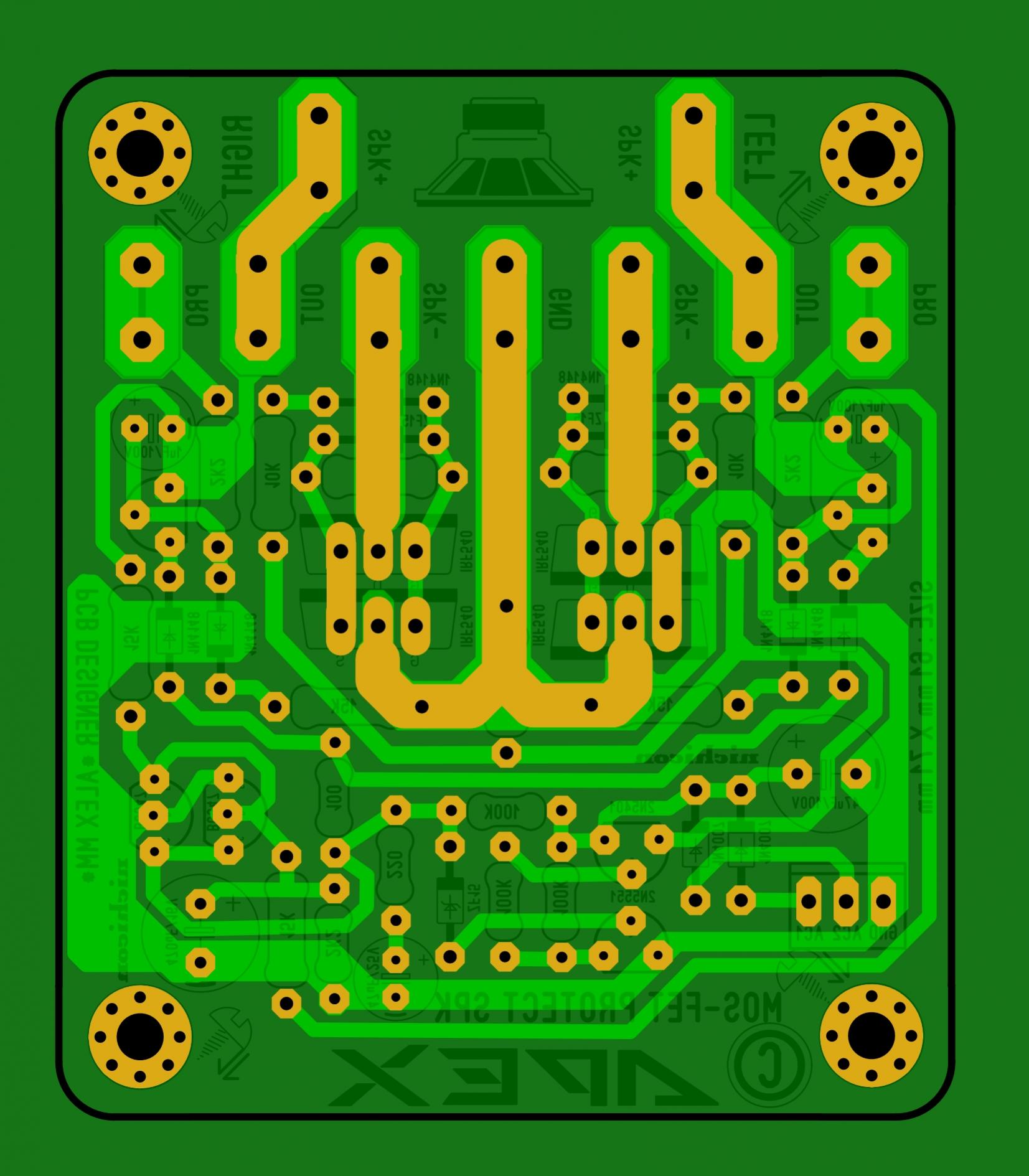

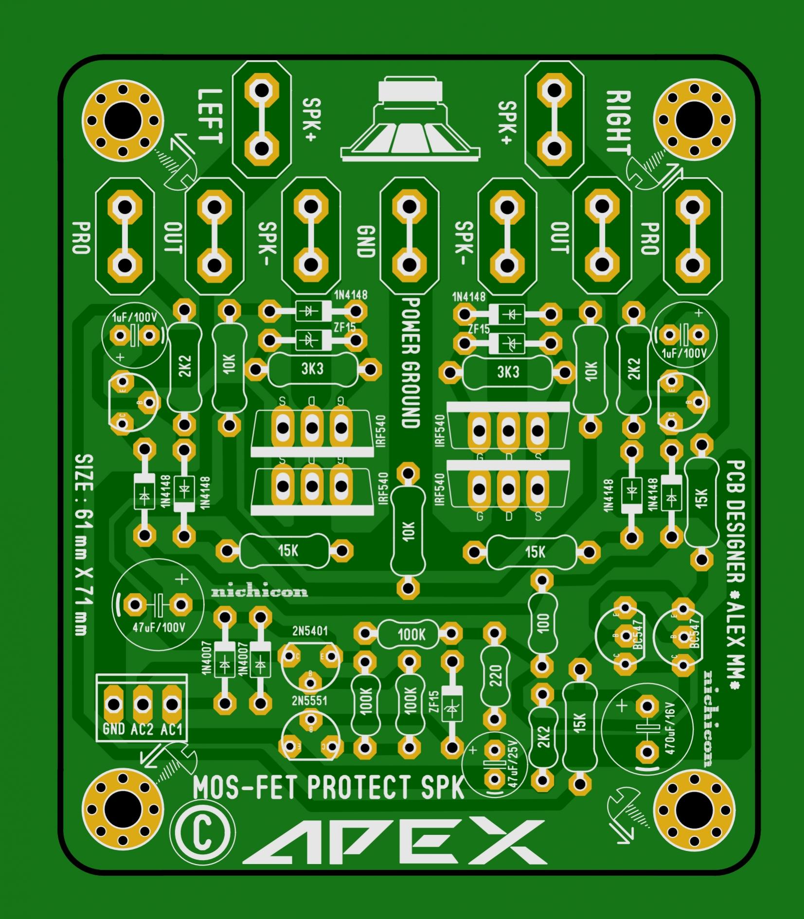

Led was from protection with usual relay schematic, didn't think it trough.

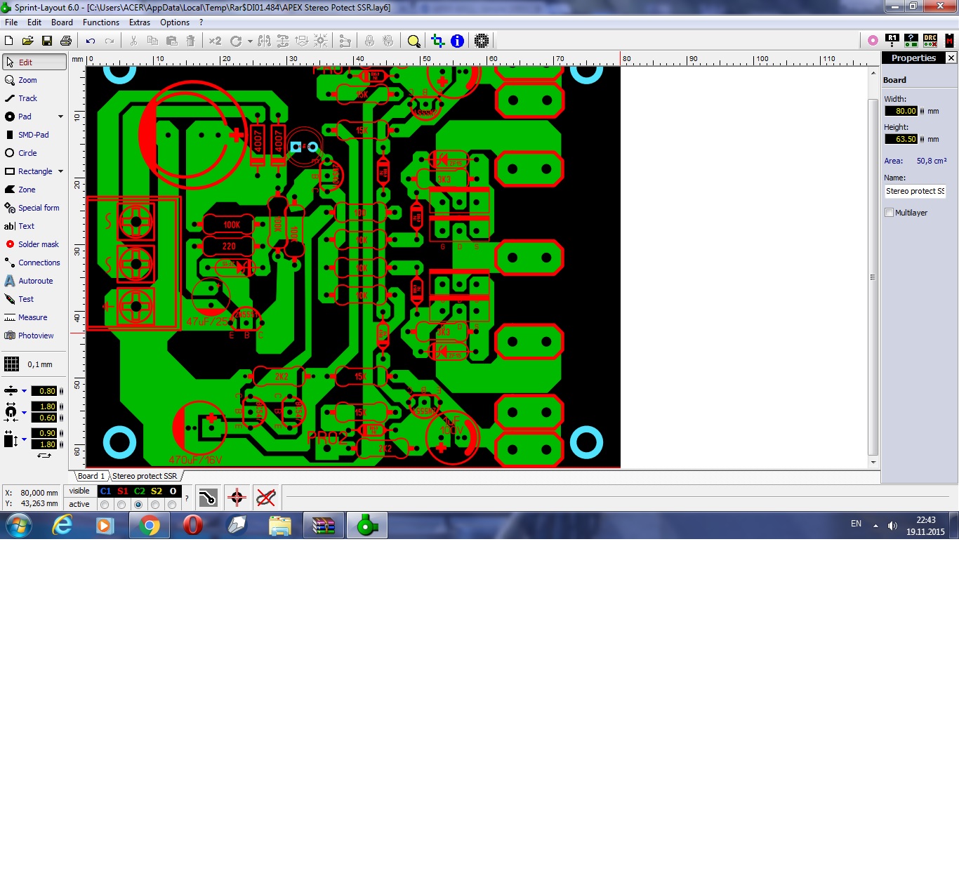

Also i run out of to220 mosfets so i modified to fit to247 ones (like IRFP 240, but also fits to220 ones) and made board smaller.
Sorry for wrong pcb mr Terry
Sprint layout file attached

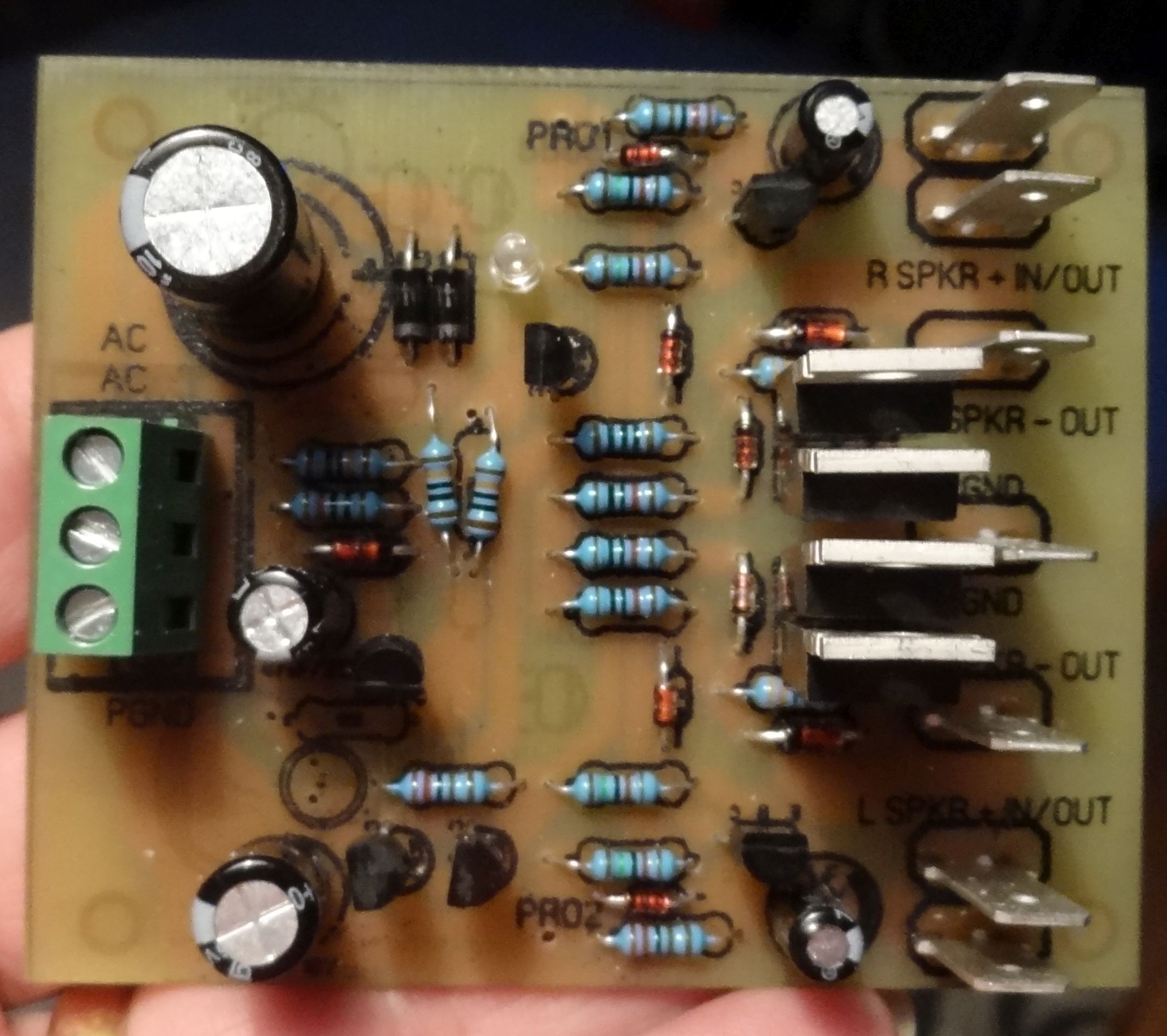

Hey that looks good. No problem on the layout. I was able to work around it. It happens a lot with me because I like to jump right in. I have it all populated and will test in the morning.

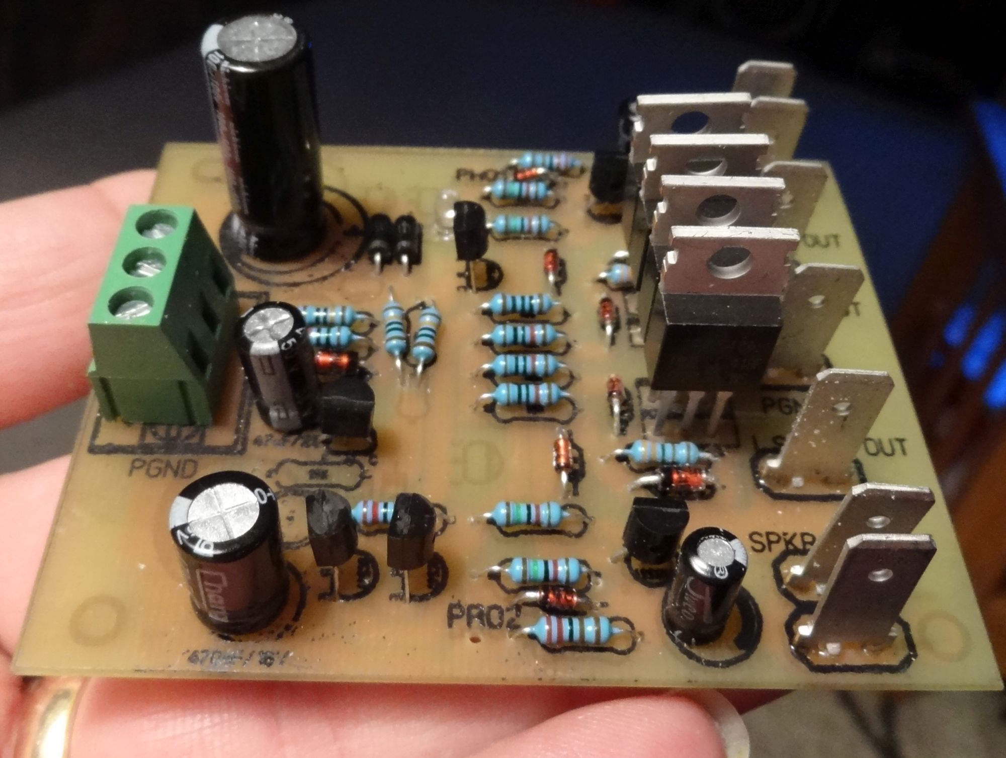

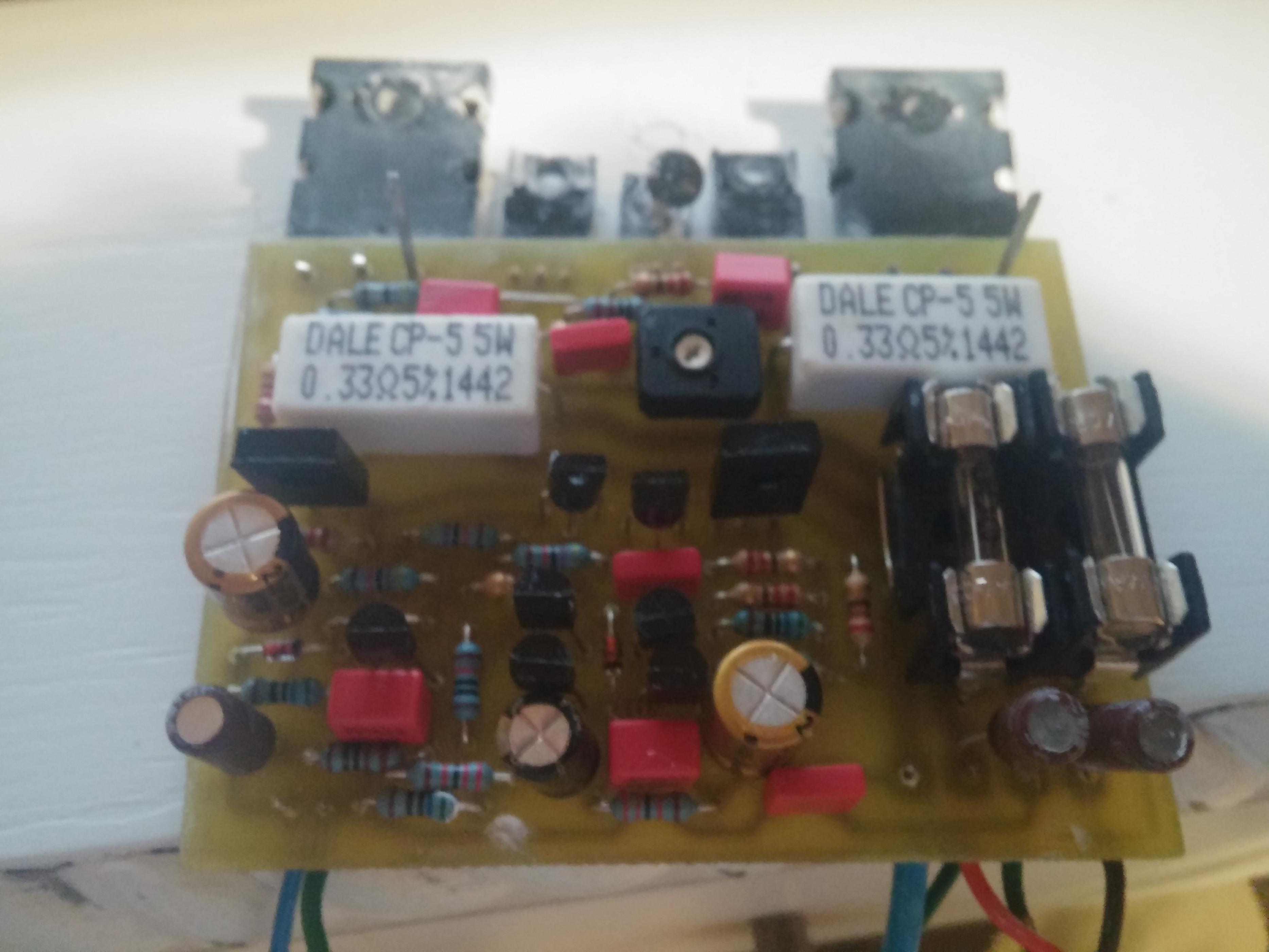

Can some one with fresher eyes take a look and see i missed something, this is my second channel and when turned on my light bulb will go bright and my psu doesn't even work(led wont even light on). Thanks for the help.

Hi c08bm,
shouldnt the PGND be connected with the drain of mosfets as in schematic and alexmm layout ?
regards'
prasi

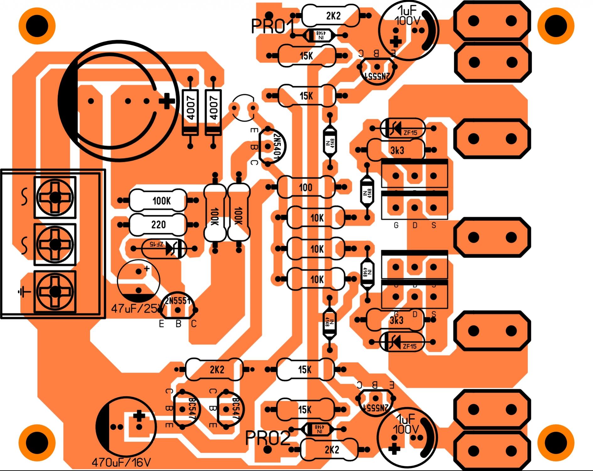

Hi Mile,
Can you please check the layout in post #5504? I am testing it and I have 150mV offset. I measured and pin #4 is pulled down to 0.3V. If I pull the IC then pin #4 goes to 15V but pin #7 drops to 3V and the offset goes to 15V. If my layout is right then something is wrong with the circuit.
Thanks, TerryThe -IN is sensitive to pick up.
Keep it's resistor very close to the -IN pin.
