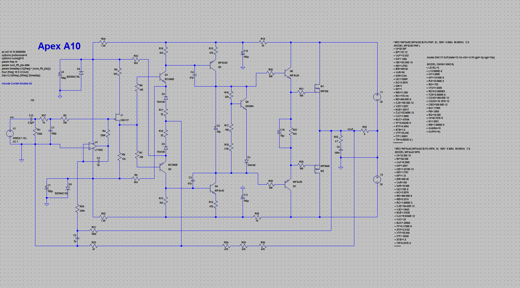

It shows 25V output in the ltspice sim.
source of 2sk117 jfet is at 2V, see posted .op gotta go now
Yeah, I know the voltages are all wrong. I'm attaching an updated file. It doesn't work either. I changed the OP and added a model for the 2SK117.
Anyone?

I went over your layout with a highlighter and found no errors. I still can't get the spice file to work. Mile says it works in Multisim but I don't have that program so I can't test it there. I do think the input needs the resistor that AndrewT suggested. All the amps I have built have that resistor. Most have an input cap as well that this one doesn't have. I'm glad we started with this one before jumping into the tube version. If this won't work, the tube probably won't either. I'm sure we'll get it working and probably learn something along the way.
Blessings, Terry
Did you open the revised file from post 5045? If that one is wrong can you fix it and see if it will run properly?
Edit ; I just checked and the opamp in mile's schematic is tied to the negative pin. Please check my schematic against Mile's.
Thanks, Terry

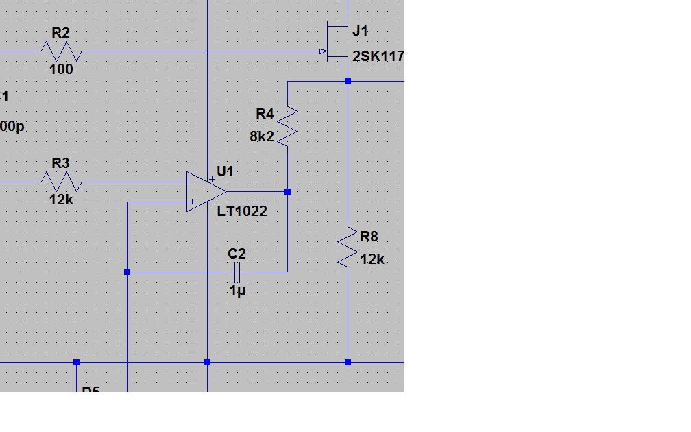

This picture coming from the revised schematic. C2 is wrong for sure. I had no time to play with the schematic yet...
Sajti

Hi Terry, that's the right spirit! 🙂
Greetings Olaf
.................. I do think the input needs the resistor that AndrewT suggested. All the amps I have built have that resistor. Most have an input cap as well that this one doesn't have................
I think you are referring to a resistor between Signal Ground and Power Ground?
If so, then it is only necessary when you have a multi-channel power amplifier.
If you are testing a Mono-Block, then that loop current reducing resistance has no purpose. There is no loop that needs the current to be attenuated.
The basic sch is correct for a mono-block.
The Signal Ground to Power Ground link is shown just below V3 at the input.
It is this link that would need a resistance value when building a two channel, or multi-channel, power amplifier. And for a faulty source, this resistance needs a pair of safety inverse parallel diodes to take Fault Current to Chassis and thence to PE.

No, I'm talking about the 1k resistor ahead of the 330p cap. It's not there in Mile's schematic. I added it to the spice file. It's the one that Olaf added with an SMD. The ground lift resistor you refer to is missing but you still need to run an extra wire from input ground to star. Kind of a hassle when you use a pin header plug like I did.
That is true, but the inverting, and non-inverting input of the opamp is opposite.
I just played a bit, and You can see my revision attached.
