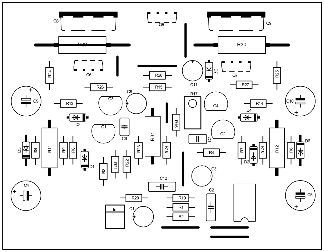

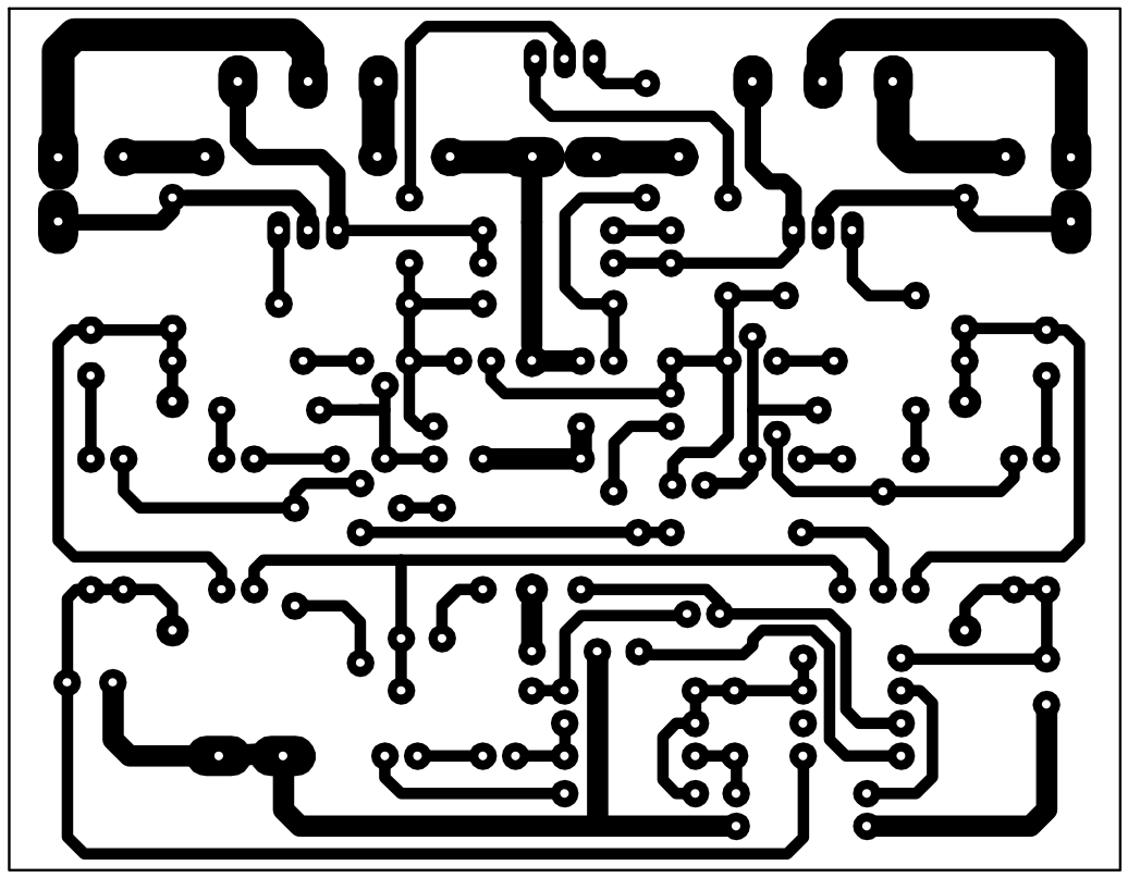

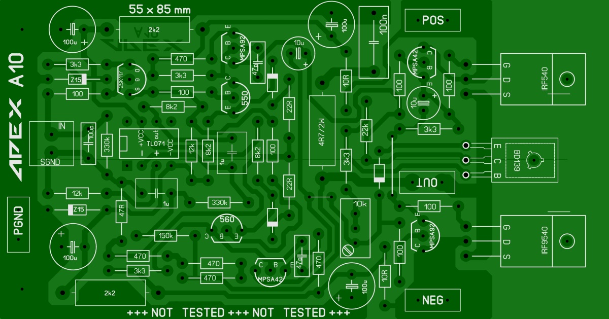

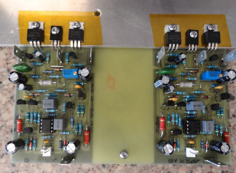

Very first design for the A10. Advice is very welcome.
Next is the detailed examination of the first layout and then we will make a prototype
Regards Olaf

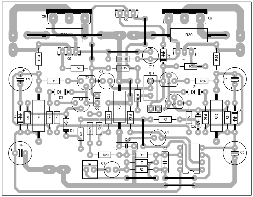

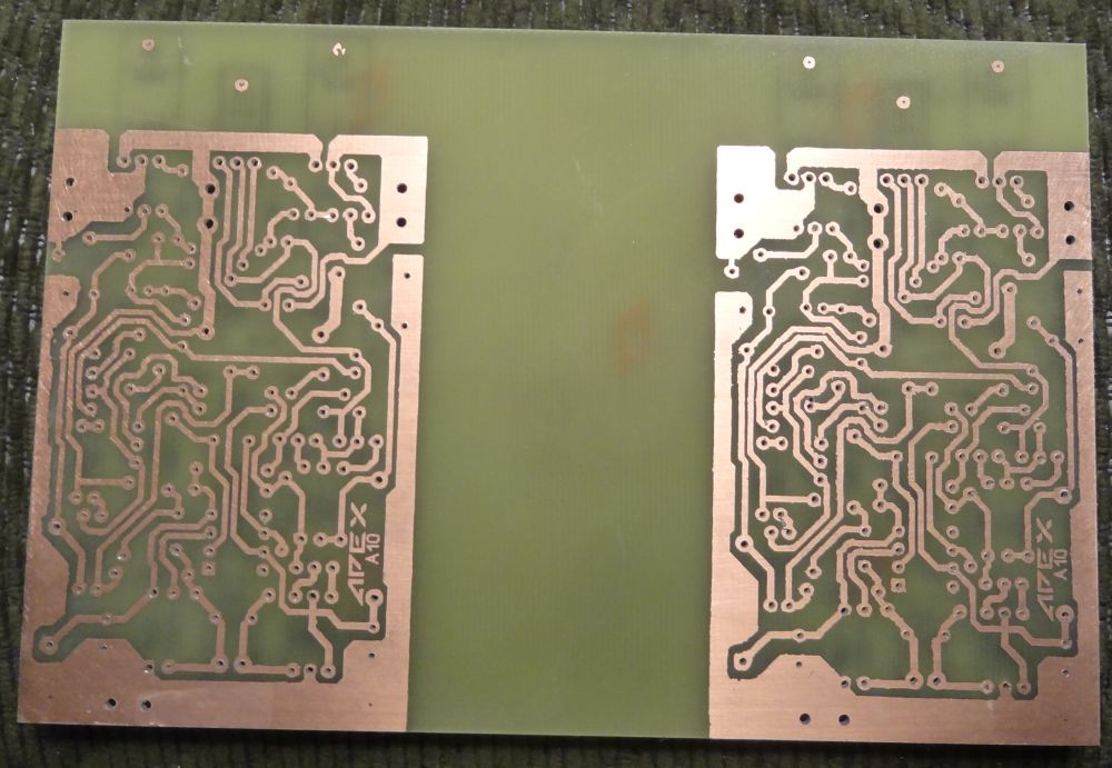

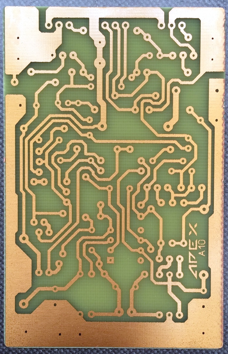

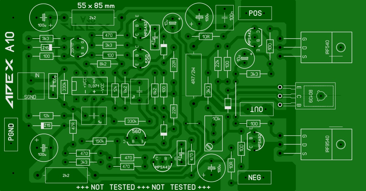

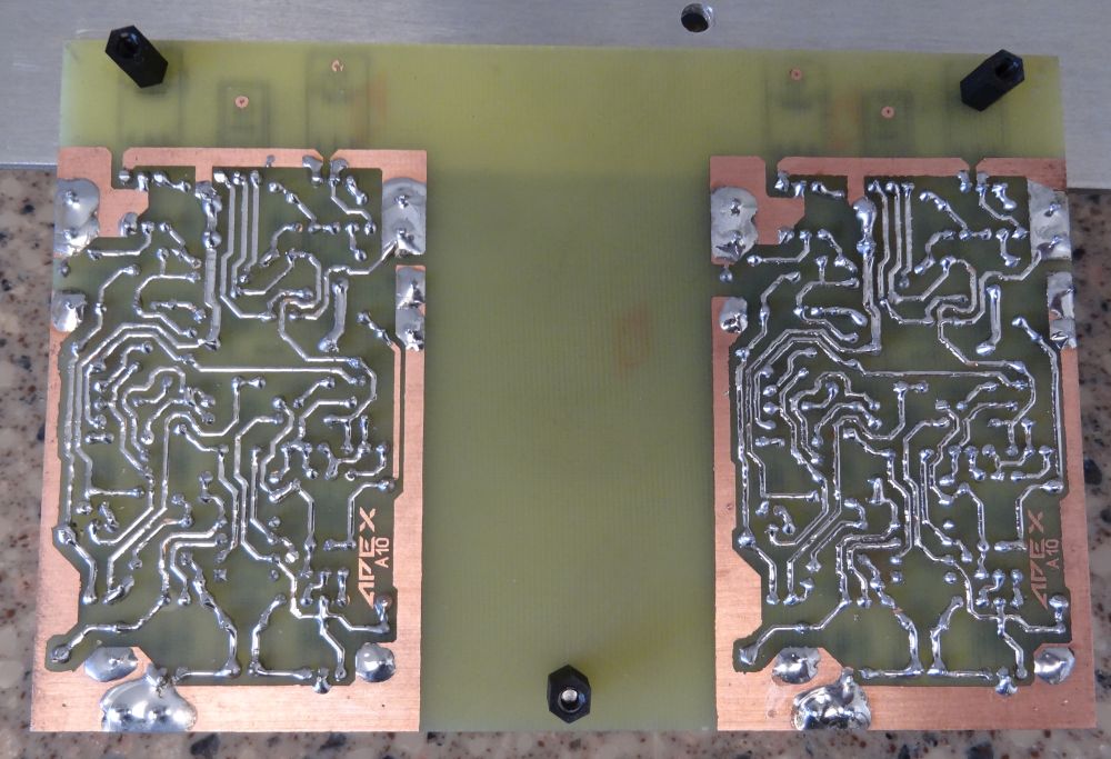

A10 First Layout

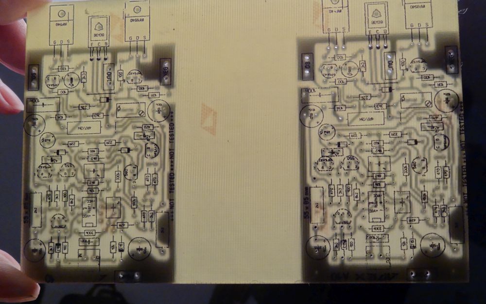

here is the first layout. I have found an error and corrected and etched the first PCB. For those who want to test it (Hi Terry ), here are the Print Files.
Please note: No warranty! Not tested yet!
Hope, I will find the time this weekend to assemble the board.
Regards Olaf

Thanks Olaf,
Ready to populate. Wish me luck
After if you want there to my version of A9 with TIP142 / 147!Thanks Olaf,
Hi Terry, looks really good. I started assembling and will report.
regards Olaf

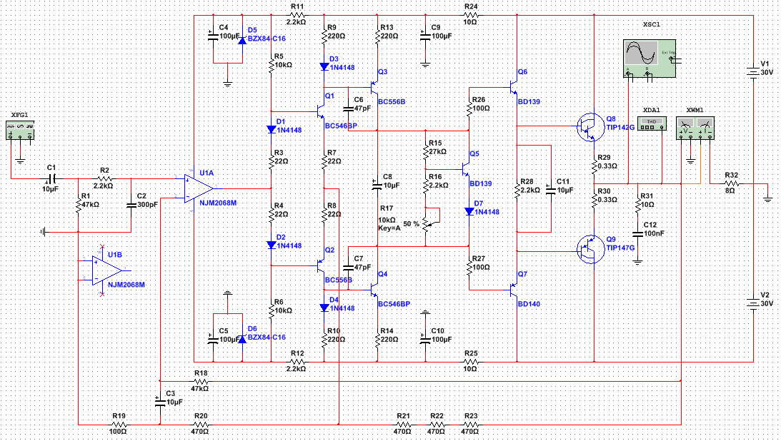

VAS current can be ti high for MPSA... use 2k2 instead 3k3...

Hello ApexAudio!
The simulation gives very good results.
Thank you!
Not yet because I just finished drawing and I wanted to ask your opinion on a slightly modified scheme.Nice work, is it tested?
Regards
Thank you!

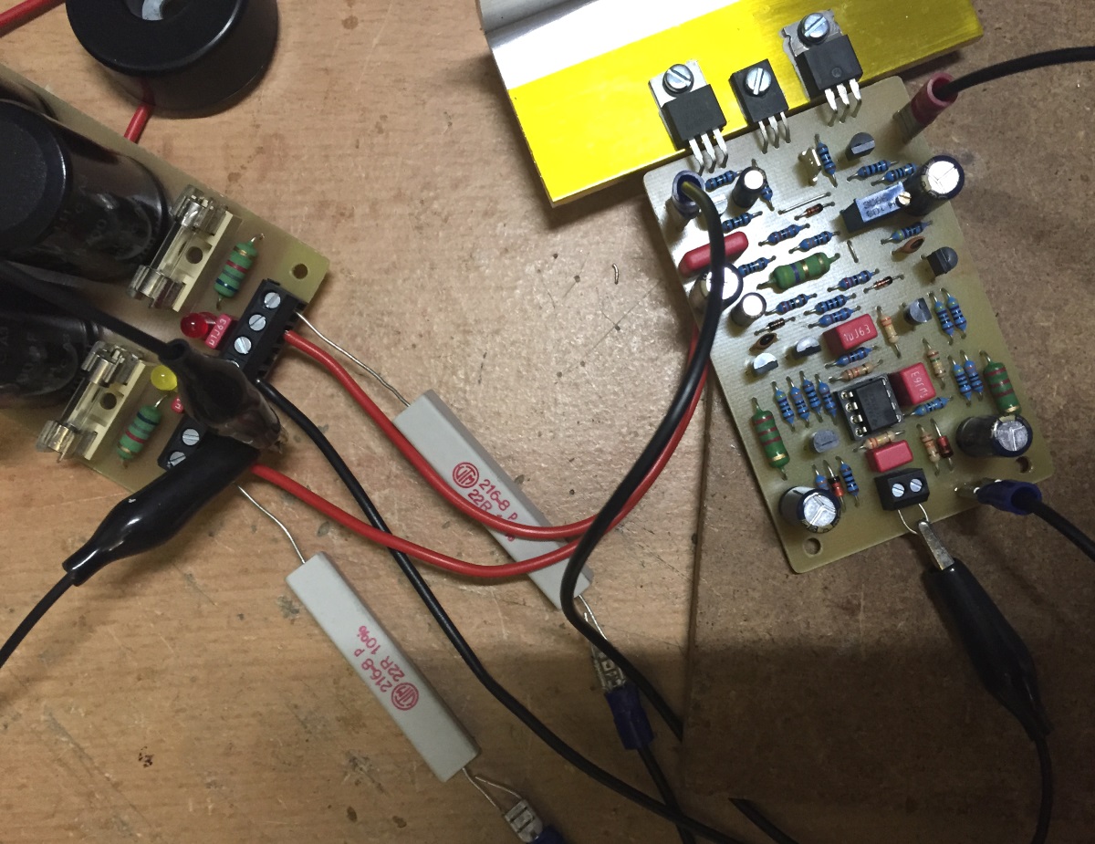

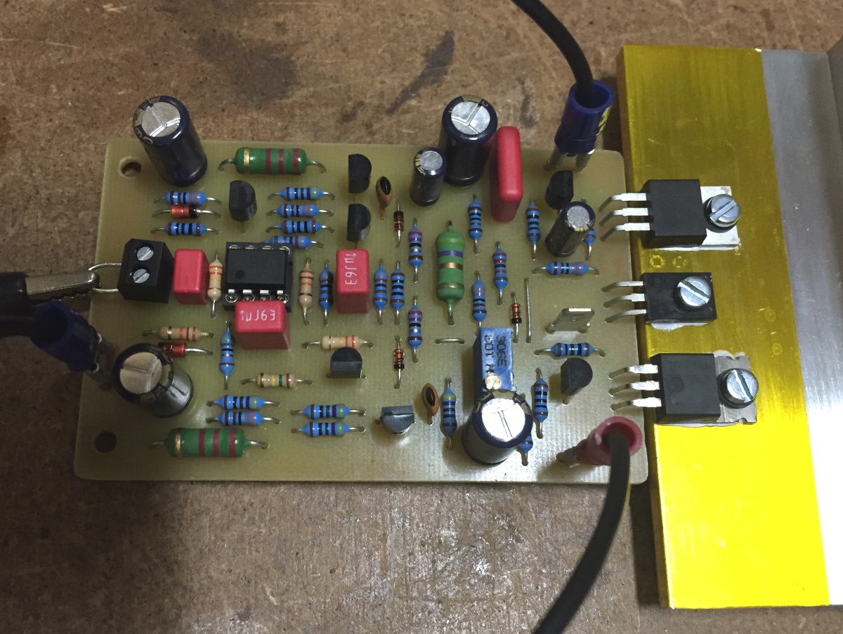

In trubble
Hi, I started testing.
Voltage is +- 25V DC. Input is shorted and connected to PGND.
Offset is constant around 5V DC.
Quiescent current is adjustable with Poti between 10 and 30 mA measured over the 22R in both rails.
I will change the 3k3 to 2k2. Any suggestions?
regards Olaf
regards Olaf
It means trouble - not trubble! Sorry.
With +/-25V 3k3 will bwe ok, but 2k2/2W for zeners must be under 1k... measure voltages on TL071 pins... add 47pF on drivers if you have hf instability...
I have +-13V at TL071, seems not ok. But I will check this.With +/-25V 3k3 will bwe ok, but 2k2/2W for zeners must be under 1k... measure voltages on TL071 pins... add 47pF on drivers if you have hf instability...
Thanks for advice.
regards Olaf

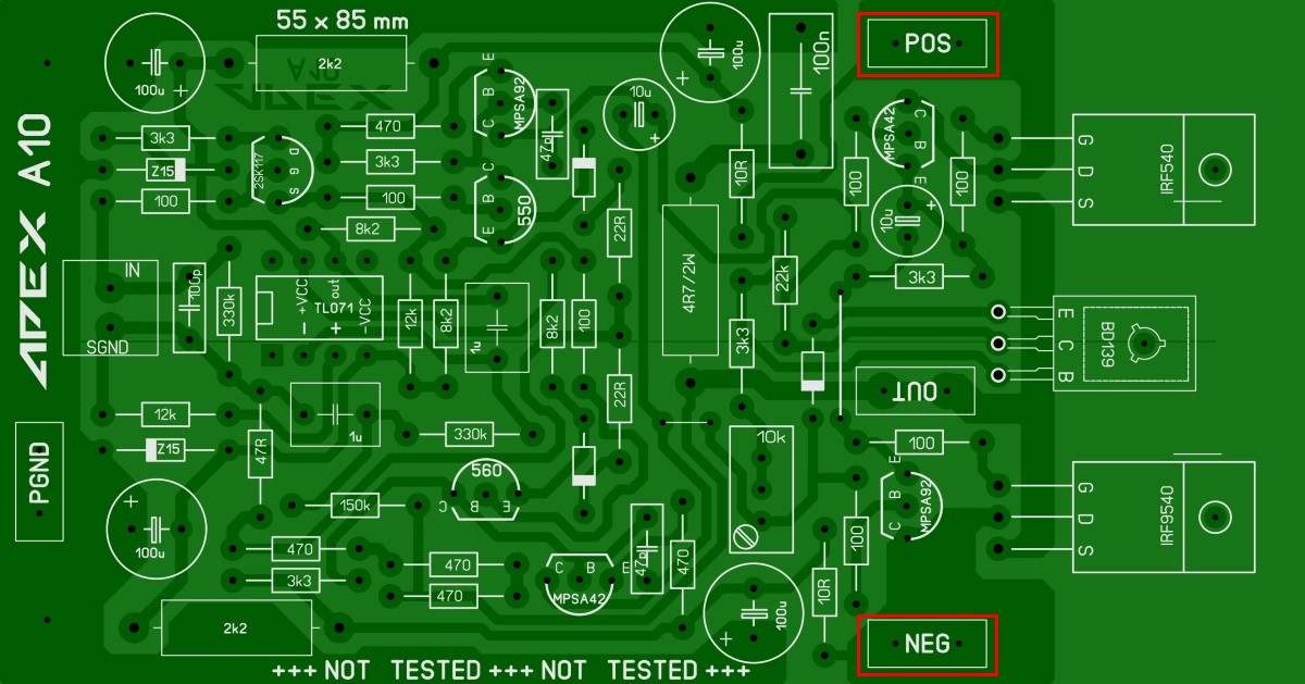

Hi, polarity is ok. I took the cables without looking at the colors .Hello olafk!
If the colors in the photo are correct, there a reverse polarity compared to your PCB.
Red: POS - Blue: NEG. It's correct?
Thanks Olaf
