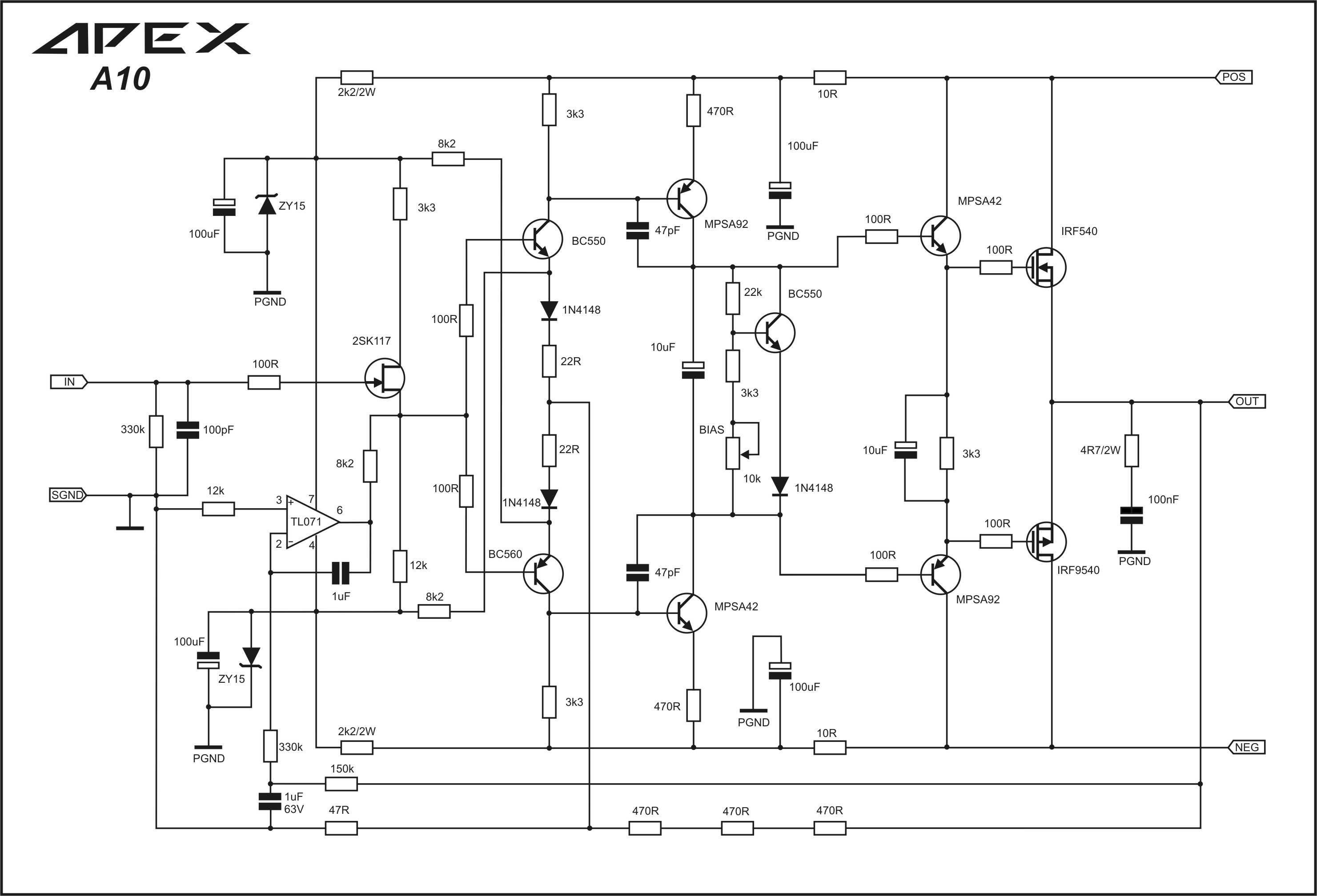

100W Ultimate Fidelity Amplifier

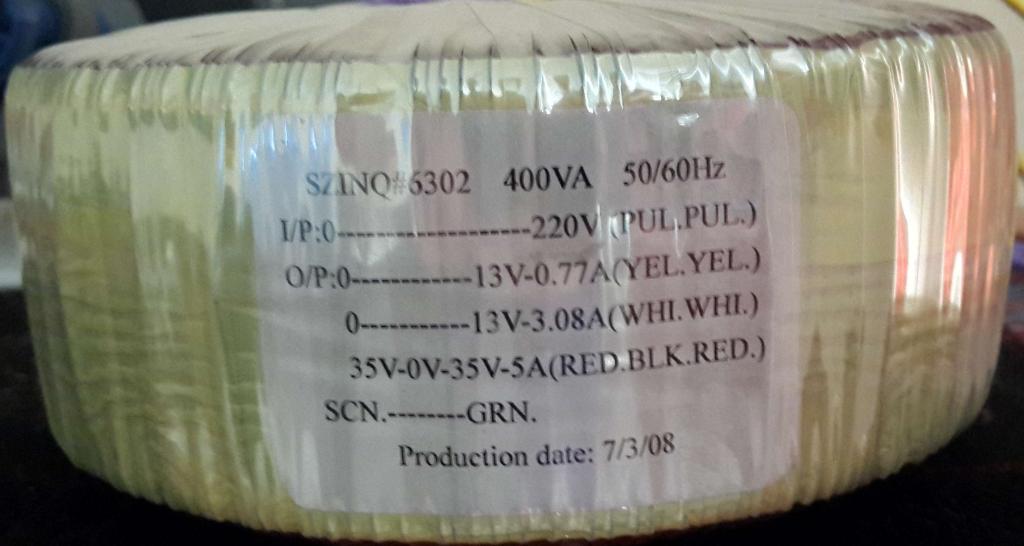

hi, I have 35-0-35 400va transformers
, will these work for these amps, I have about 50off them
The transformers have 2 x 13v outputs and 1 35-0-35 output
35 - 0 - 35 @ 5A
13v @ 1A and 5A
C9, C10 value
Any body already have LTspice simulation file on this circuit?
For a typical two stage amplifier, C9 and C10 is bad for performance and stability. I would like to change them to 0 if possible.
Regular pole splitting compensation is not used here, what is the consideration?

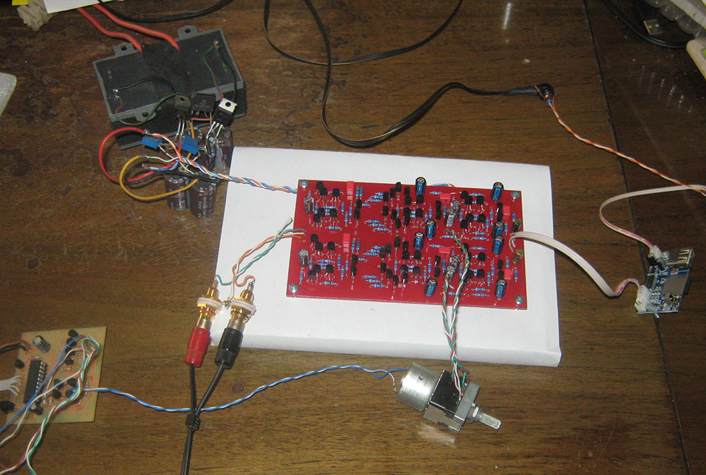

I made this amplifier for test my home DIY speakers (two way TL).
