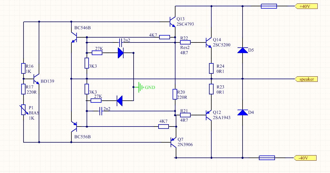

This is the output stage on apex 100 W amplifier with current protection /short circuit/
what do you think ?

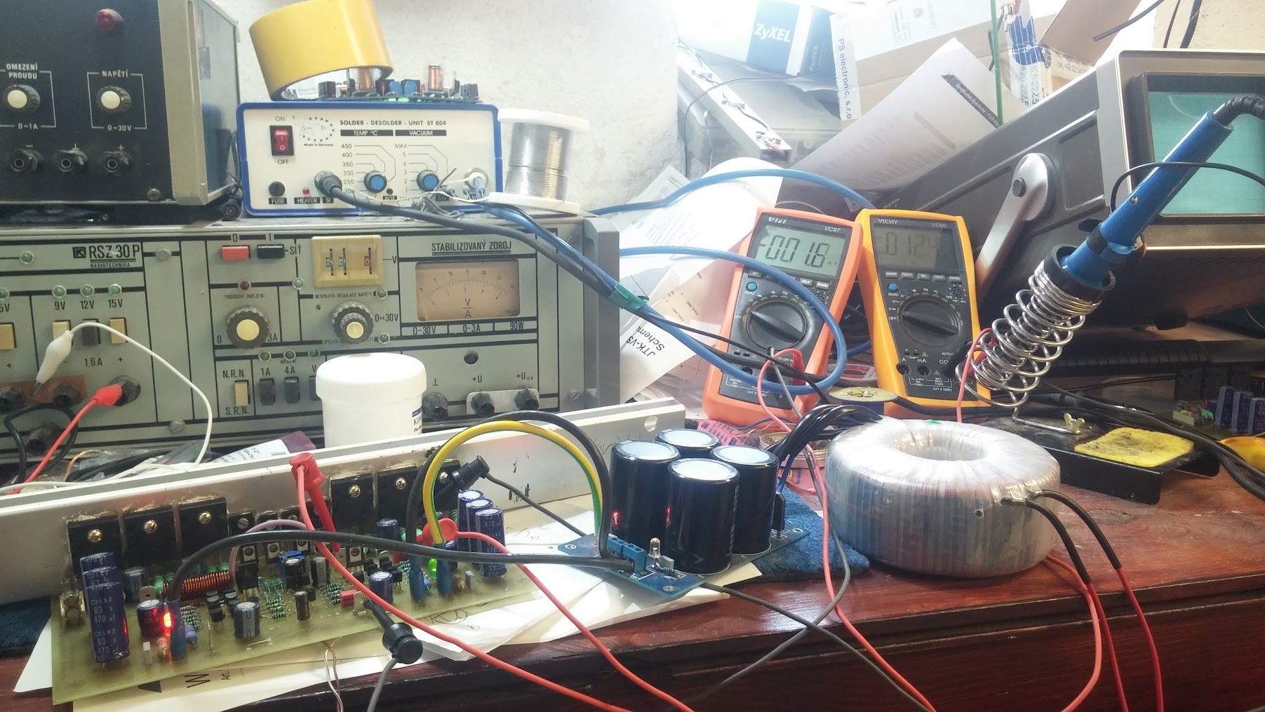

Тoday I solder protection under this circuit and everything works.
I short output and nothing burns

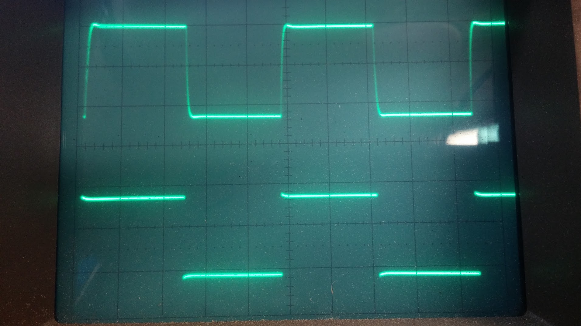

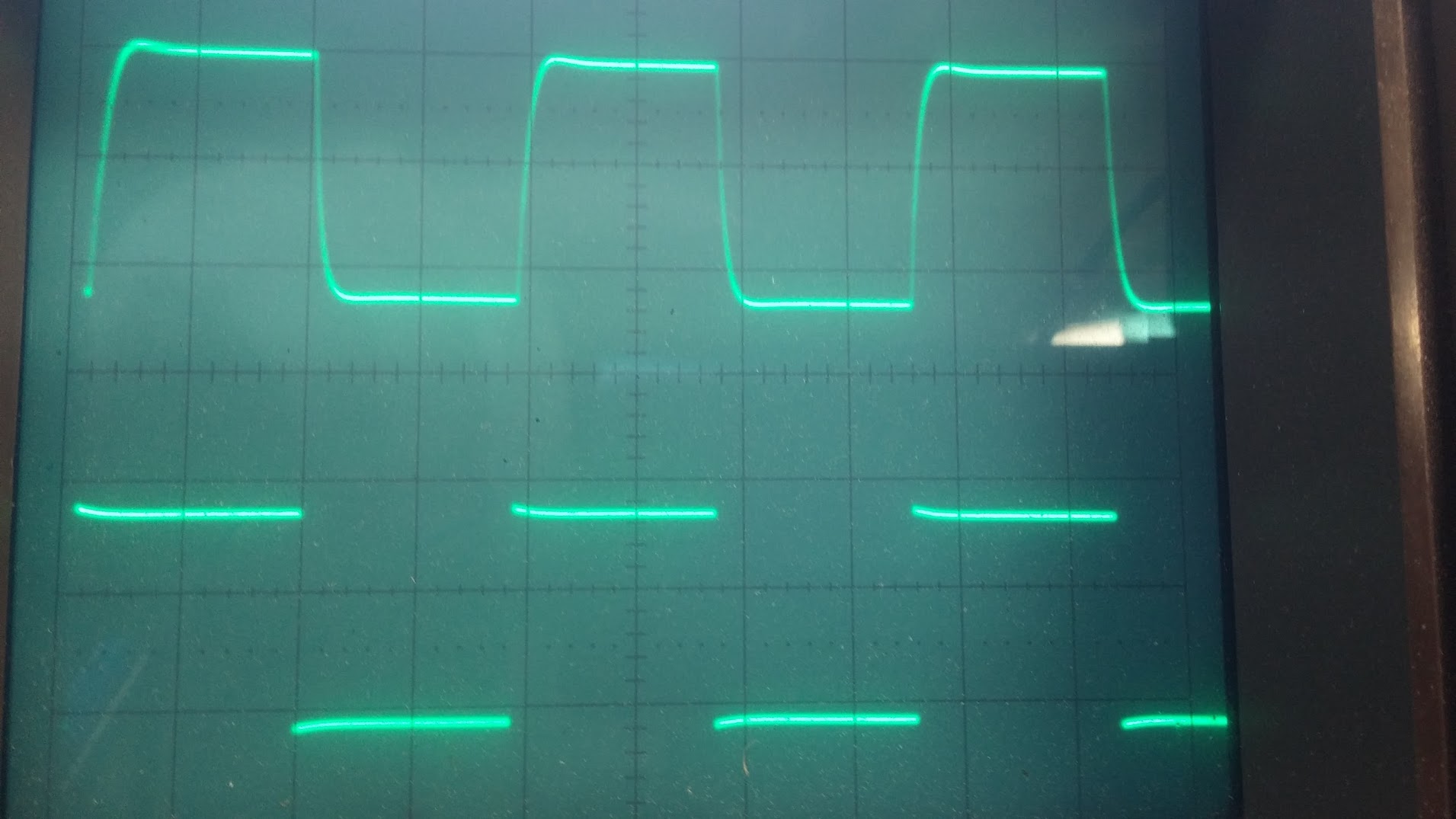

So I finally revived A40 .. square at 20khz and 50khz...very clear sound with good bass..
